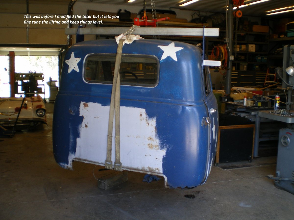

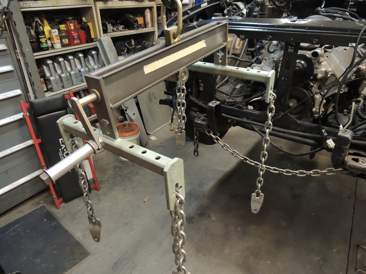

    I modified a Harbor Freight engine tilter. It lets you get attachment points that are spread further apart and keep from bending things attached to the engine. Engine stays level side to side but can still be tilted. It also works well for pulling pick up beds of your frame and even for lifting cabs and bodies. Works a lot better than the basic tilter.

    That is like a “ spreader bar” used in industry. It’s the best way to lift most any bulky or heavy object. I built one to lift the 2000 lbs beds I used to install on new trucks and another one to lift the zero turn mowers I used to sell. Once you use a properly designed spreader bar, you will never use anything else! The reason the carb plate is so popular is because it’s quick and easy! The spreader bars take a little time, but give better performance.
    ekimmerbo , you have a nice shop and excellent fab skills. I bet your shop is a pleasure to work in!

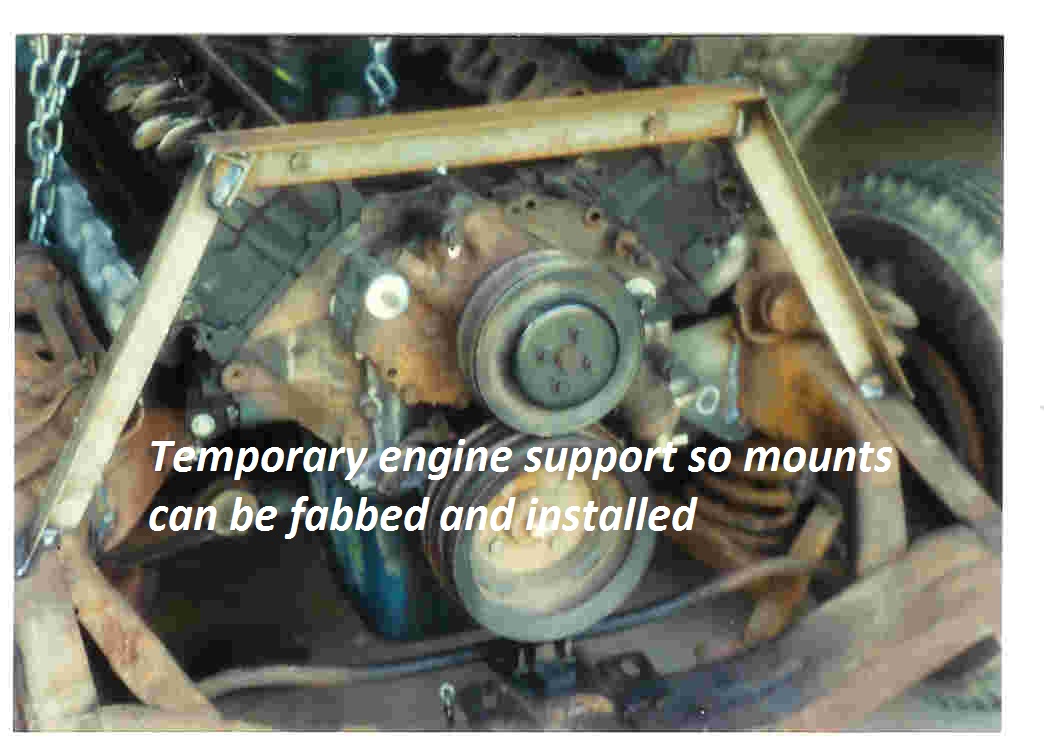

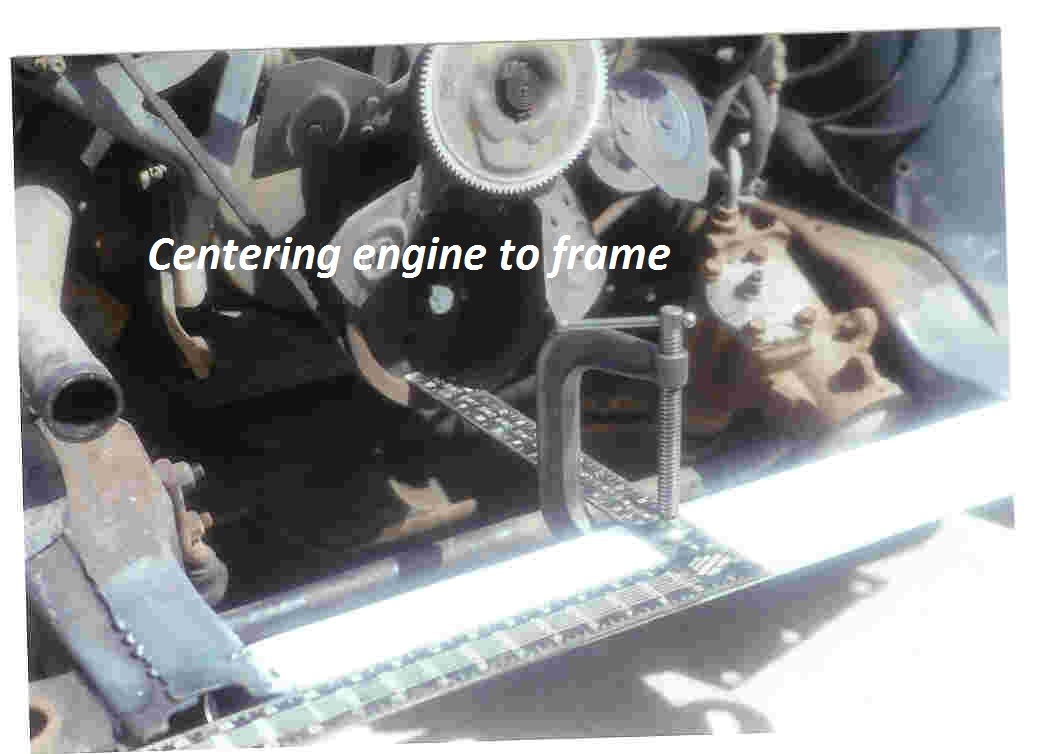

    Here are some pictures from years ago showing the value of an engine tilter when performing an engine swap. I like to set the engine and transmission in place using a cobbled up temporary trans mount.to center the trans in the frame..
    Then I take the tilter loose and mount it sideways on the engine. At the time I had a cherry picker. Now I have an overhead crane, but it still works the same way. The car needs to be on stands that won't interfere with the cherry picker being moved about. Anyway, the tilter is turned sideways and the cherry picker is inserted from the side of the vehicle. You now have control of the engines positioning in all three axis. The temp trans mount holds the trans on center and :
    1. As you push the cherry picker from left to right you can center the engine in the frame.
    2. By raising and lowering the cherry picker you can find the best angle for the engine/trans.
    3. By adjusting the tilter you can level the valve covers side to side.
    Once the engine is "exactly" where you want, cobble up a simple angle iron bracket that you can bolt to the heads and tack weld to the frame. Now the engine is stabilized exactly where you want, remove the cherry picker and start making mounts for the engine. No more jambing wood under each side and having it shift as you work.
    It works really well.

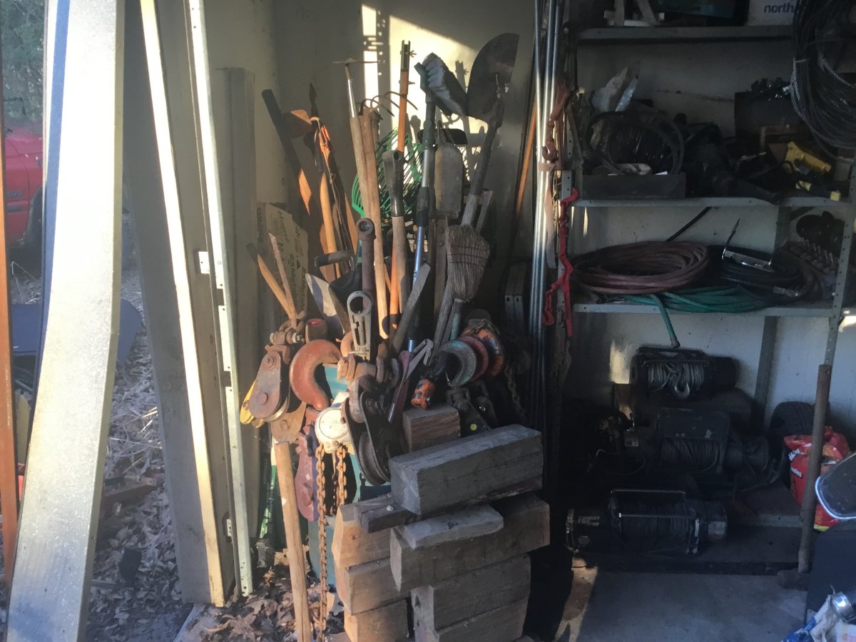

    I agree a nice shop with good tools, organized, makes any job more pleasurable. When I was a youngan , I had to do things by myself, as I had no brothers and lived way out in the country. My closet friend was 3/4 miles away. So I learned how to make tools/ machines work for me to get things done that would normally take two or more people. Might take me a little while to get it done that way, but I did it! This skill has served me well all my life.
    I have used this knowledge in retrieving stuck vehicles. Many times I have been requested to come get a stuck vehicle way back in the sticks, with my 1/4 ton vehicle . One time I had to travel 150 miles to do the job. Sometimes the owner of the stuck equipment will tell me “ I don’t think you brought enough truck!” I tell them “we’ll see!”. I have never left any one in the woods!
    Pic is some of the equipment I use.

    I really like the modified engine tilter using spreader bars and am going to build one similar. Thinking it'll be especially useful (convenient and safer) for pulling and installing engines with transmissions attached. Lift plates are just too scary for me.

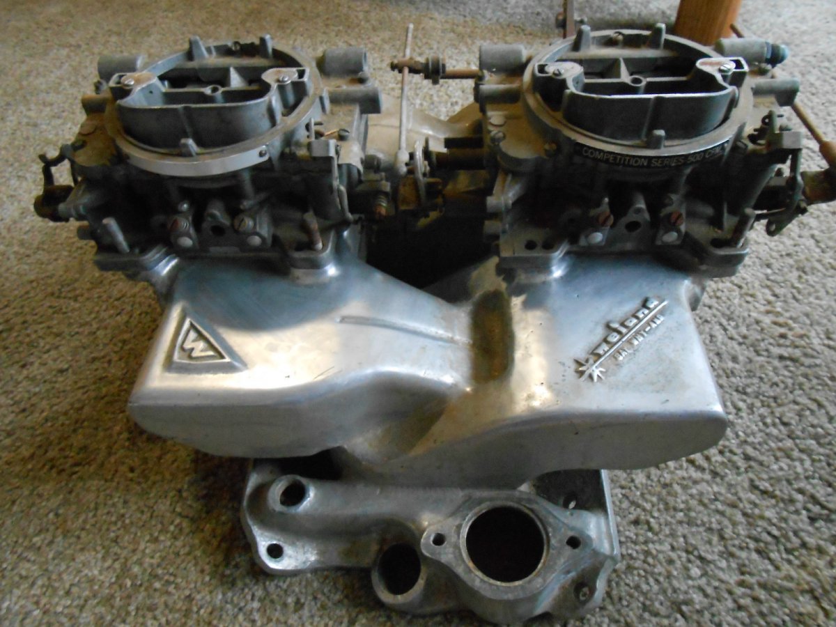

    I went out a dug out my intake pad, you can see by the cob webs, I haven’t used it in a while. Not that I haven’t changed a few engines lately, but they were at the race car shop, and my friend has several of those thin plates.
    Maybe some one here could figure how much more stress torquing the bolts to 30 ft/ lbs vs just snugging them down. It’s beyond my knowledge.
