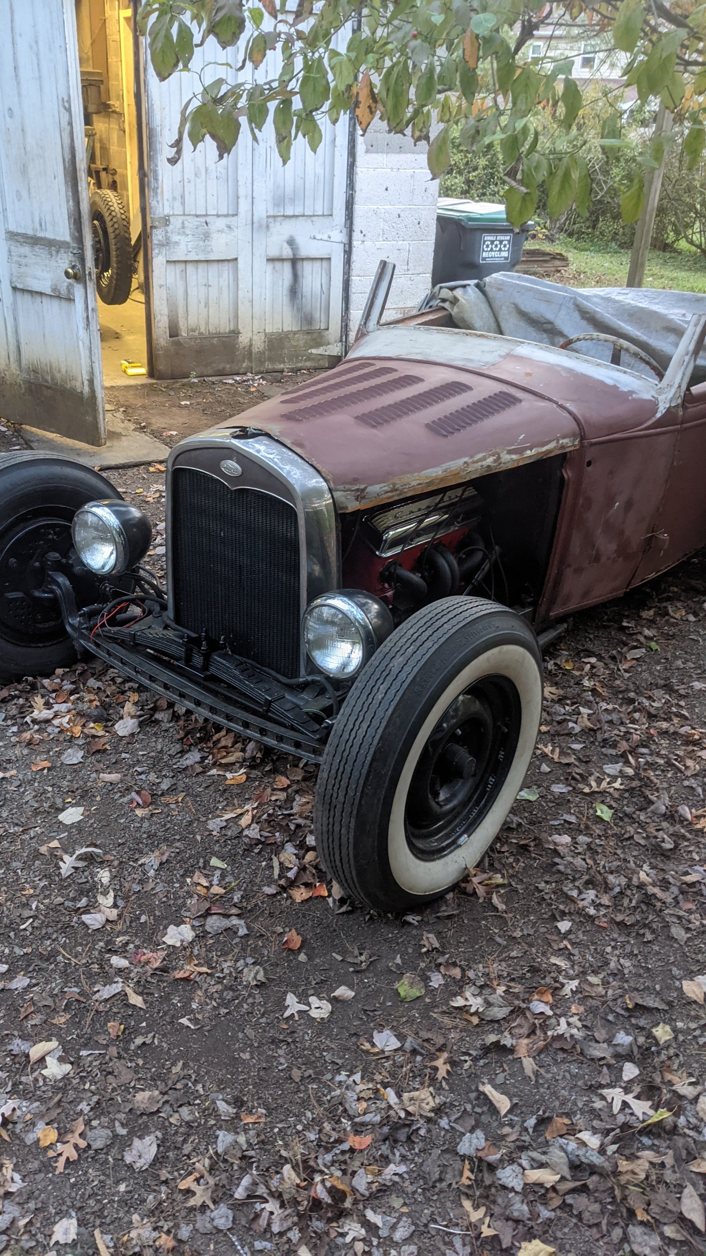

    So is my frontend a "suicide"? Sort of a hybrid?

    no, I don't think so. if your spring breaks it will just clunk down on top of the axle and you can still drive to the side of the road or slowly to get it off the road

    I would add that the setup in post #23 would typically be referred to as a suicide-style or suicide perch front end. Essentially any design where there isn't either a crossmember or framerails over the axle could qualify.
