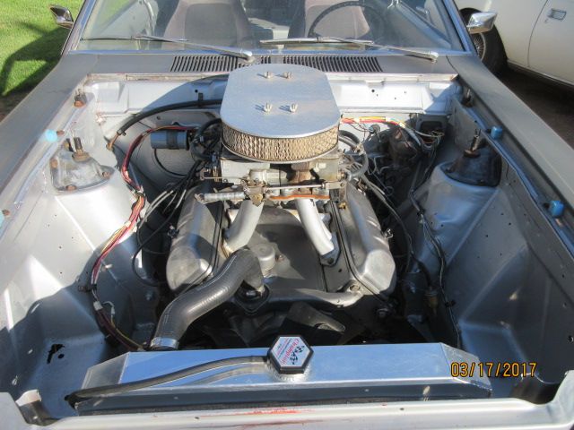

    Since it's a dry intake manifold, and the engine has a separate valley cover, it would be one of the simplest to fabricate. Also, are you familiar with Bill Kraft Rambler that built a drag car in 1964?

    Old post but…I know a guy that converted a later after market intake to fit. I believe 2” spacers were fabricated to match up the ports but he used an edelbrock air gap.
