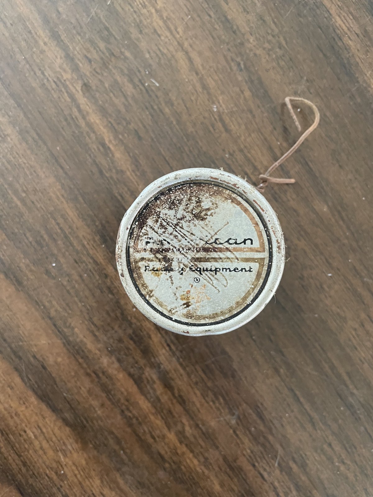

    There are two different ones.
    Small for the Anglia spindle version
    Large for the early Ford version.
    The large ones should be available from an auto parts store.
  3. If I remember right early Datsun drum brake truck caps fit the Anglia wheels. Wow, that was a long time ago.

    This is an example of the Anglia style cap : 0AE40120-A3F5-41AA-A3D1-0D9B0989A34B.jpeg 2C56C62B-B7C5-4DAC-B567-AEA2DA67E009.jpeg EF8A6A7D-CE6D-4983-A5E5-1FD412C30B80.jpeg

    I am sourcing some to fit spindle mount Halibrands, they are 1-15/16. Looks like NAPA BK7302409.
