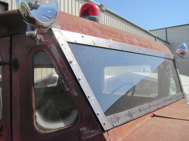

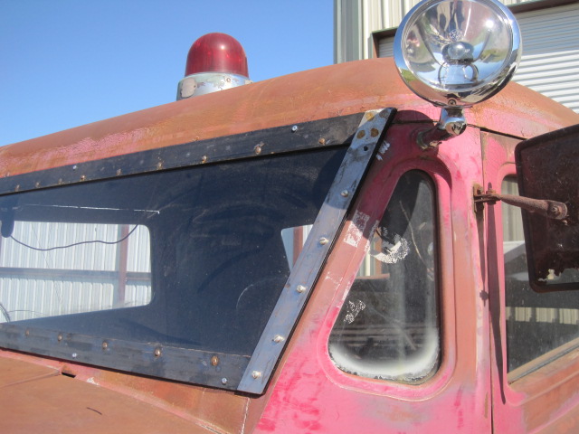

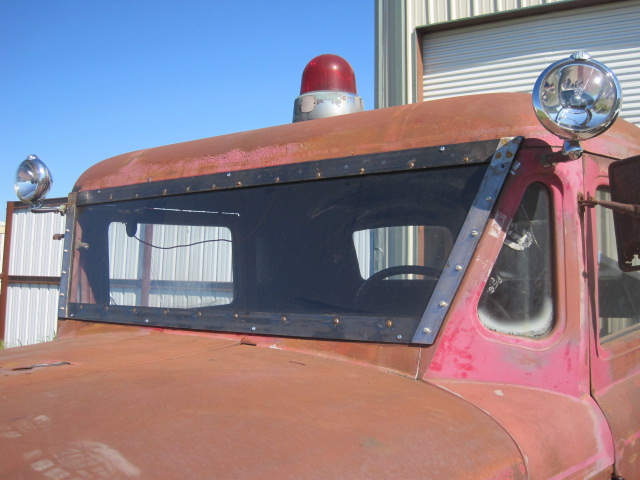

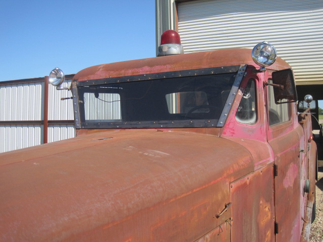

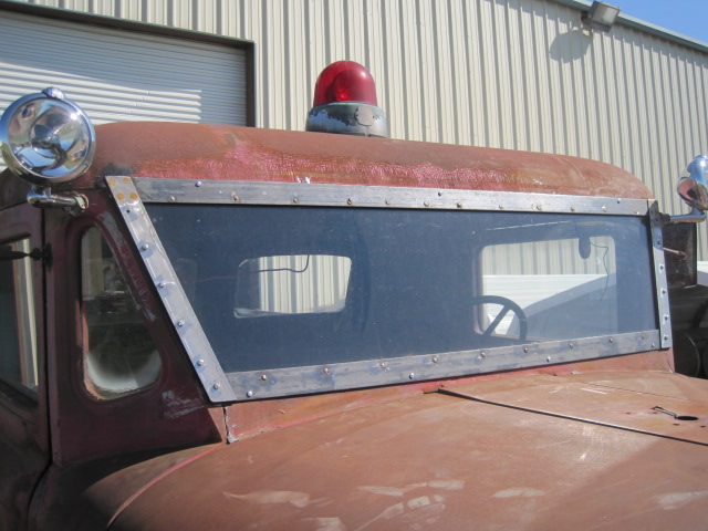

    Not much time to work on these days. I finally made a windshield frame. windshield invader ebay 001.JPG

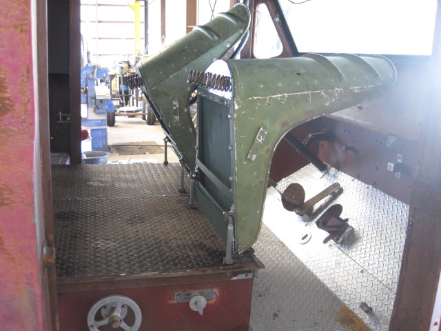

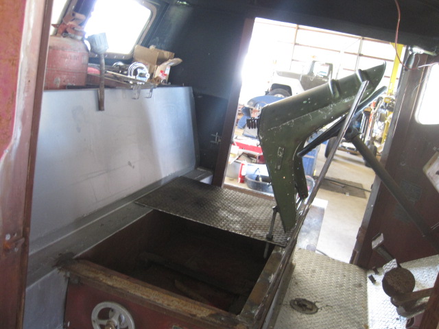

    After months of thinking and alot of days fabing got some progress on the interior. One of a kind bomber seats. They are comfortable too !!!!!!!!!!1 inch flat iron frames top and bottom sandwich the seat lip, 3/4 round bar in front top frame for legs, all welded together in alot of places after bolted together. The wire mesh is only set in with 2 screws and is flexable too. U metal edges welded to park bench type wire mesh up high in the front because of the 3/4 round bar. The side edges are not touching the seat bottom.
  12. saveoursteel
    Joined: Feb 24, 2010
    Posts: 50
    saveoursteel
    Going to put a air conditioner under the box some day soon. Cut out under the seat and probally add some expanded metal for grid (thinking again) . Real air condition seats. The back springs are from a antique wooded wheel chair, cut in half to make 4 out of 2 springs.

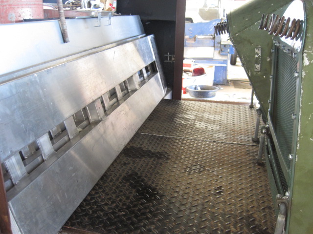

    saveoursteel
    Great place for the ramps to be stored !!!!!!!!!!
