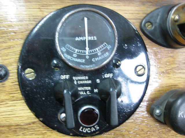

  21. Stueeee
    Joined: Oct 21, 2015
    Posts: 315
    Stueeee
    from Kent, UK
    Vetteson. Your ammeter which is pegged is probably quite repairable. Here's the one on my truck when I bought it in the USA 15 years ago. Pegged at full charge as you can see: 68A Alty; this ammeter's full scale deflection is 40A. When there's a flat battery, this will happen every time you start the motor.
    But these instrument are quite tough internally, a "Moving Iron" ammeter is most unlikely to be burnt out because the frame which the current p***es through is usually made of a fairly chunky br*** pressing. If you remove the gl*** on the instrument and gently dislodge the needle from the edge of the scale it is likely to return to it's central point. Even if the needle is actually bent, as long is the pivot mechanism isn't broken, you can "bend it straight" so that the needle rests back in the centre. It should work properly again after this treatment. That's what I did on my truck ammeter, it's still working fine 15 years later, along with the apparently controversial shunt setup which ensures that the needle can't get pegged again even when the Alty is giving its all.

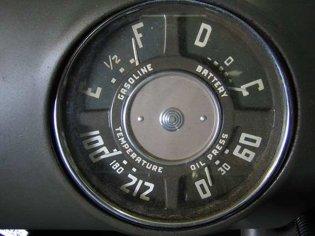

  24. vetteson
    Joined: Oct 7, 2010
    Posts: 301
    vetteson
    Yow :eek:, I've learned more about auto electronics in the past week than I I've learned, well, ever.
    I bit of clarification, I wanted to retrofit original Corvette style gauges in my '56 Corvette. Very expensive. Then I learned that the gauges installed in early 'vettes are actually '49-50 Pontiac gauges, slightly modified to fit Corvette dashes. First I bought a fully gauged 1950 Pontiac gauge cluster for $50 to see if it was true. True. I bought two NOS Pontiac gauges for $30, one was the ammeter, the other water temp. I was able to "restore" the original Pontiac oil pressure gauge face and installed it with the ammeter. As we know the ammeter lots its mind, but the 70 year old oil pressure gauge works, and no leaks! Happy dance. Solution, I found and bought a reproduction voltmeter (yes, someone makes it for dopes like me) that appears similar to the other period gauges (in a '56 Corvette).
