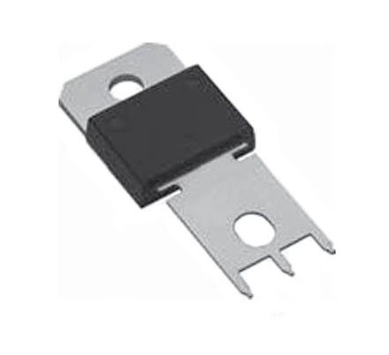

    The ammeter is generally limited to 35a [over that is "Chernobyl"] but you can run an alternator safely by making a Diode Shunt using a Vishay 150a diode .[or a pair]
    This shunt is connected parallel direct from the Alternator to the battery.
    The principles behind a "diode" is they have a fixed voltage "forward drop" required to open them. [approx 1.13 v]
    90% of the time the alternator is just maintaining the battery and running accessories so the diode remains closed.
    The ammeter has a progressive voltage drop, so current will take the path of least resistance through the ammeter [so it's scale will remain unaltered]
    When the ammeter is pegged out at maximum value the voltage drop across the ammeter exceeds the voltage drop of the diode , so the shunt starts flowing the excess current [there is actually a point of equilibrium where both are flowing]
    Another plus is if the ammeter totally fails the electrical system flows all charge/discharge via the shunt [it won't leave you stranded on the side of the road]
    On my friends Chevy pickup we mounted 2 x diodes [back to back and parallel] so it flowed both directions.
    This was mounted to a plastic board and hidden inside an old regulator box
    90% of the time the ammeter is only showing low values [and all current is flowing via the ammeter] but we have had it pegged out to maximum a few times with the battery being used to jump start others , but it always recovers back to normal
    https://nz.rs-online.com/web/p/schottky-diodes-rectifiers/3952594
    The alternative is disconnect the ammeter and simply charge direct to the battery. BUT the addition of a simple diode allows the instrument to function normally without chopping up an oem dashboard.

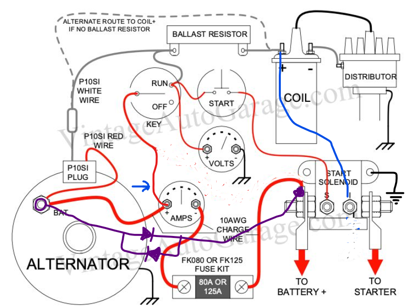

    This diagram is busy and you have to decide what is relevant but it shows how an ammeter is normally wired up and how a volt meter is hooked up. You have to be able to mentally separate things and see what is relevant to what you want to do though.

    The problem with the above schematic is the way the ignition switch power feed is connected [it only shows charge through the ammeter and not discharge]
    If the ignition feed wire is moved [as below] it will read both ways and the ammeter shows charge/discharge to the battery.
    If there are accessories that draw a lot of current from the alternator ,it doesn't flow back through the ammeter to the battery as long as the Alt can keep up [if the alt can't keep up, it shows discharge at the ammeter]
    edit:
    A 2-way diode shunt is added in purple [2-way provides a safety net if the ammeter has a total break in the circuit and is basically a wire connected direct from the alt to the battery]

    On your schematic the ammeter will show charging any time the engine is running. It won't reflect the load of the accessories. If you turn the key off and turn on the headlights, the ammeter will not show a discharge. As you turn on accessories the meter will show more and more charge. The idea of an ammeter is to see the current flow to the battery.

  19. The ammeter does not display the 'load'. What it's supposed to show is the charging current with the motor running or a discharge current if there's issues with the charging system or the motor isn't running. If everything is working the way it should and the battery is charged, this will typically be about 1 to 3 amps to the plus side of the meter. A pretty small meter deflection. Right after starting or charging a low battery it can show more until the battery is charged. The meter will 'blip' when turning on a load like the headlights but quickly drop back as the regulator adjusts.
    The 'corrected' drawing @Kerrynzl posted is correct (well, except for that useless fuse). Here's a factory drawing showing the same thing...
    The alternator output and ignition switch and/or unswitched fuse panel power go to one side of the ammeter, the battery to the other side. It MUST be connected that way for the ammeter to function correctly, this will be true no matter what brand/type alternator you use. If with the ignition off and turning on a load like the lights, the meter reads to the positive side, reverse the connections at the meter.
