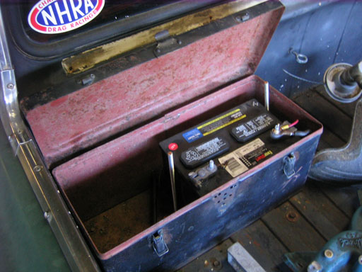

    You know what kills me... he asked about WHAT BOX TO USE and NOT whether or not you approve of his decision...
    My buddy used an old tool box in the bed of his Ranchero. I may steal the idea someday....

    Afraid he is right, not smoking. That is why a battery will have a CCA (cold cranking amps) number on it. The battery manufacture want you to know the most cranking Amps when the battery is cold and slower to crank. Heat is also bad on batts and will make them put off more Hydrogen (which is also explosive), so seal the box and vent with a hose through the floor like said before. Vibration is also a big battery killer, so make sure it is secure in your box. 00 cable to the frame at the rear will be perfectly fine. Oh and please dont cut up an old cooler for a batt box, It will just hold in battery heat anyways.

    Pitts64, hot rodding is what you make of it. Do you own thing and make your car tailored to what pleases you! I can offer a little advice. I've done 12V work on hundreds of cars professionally. There is nothing wrong with putting your battery in a "metal box". A few things to considers though: Make sure the battery is secure and has no chance of pos. terminal arching on the metal box. Running a ground wire back to the block is okay, but not necessary. Just make sure you have a braided ground wire from your block to your frame.

    We used an old cooler and sprayed the inside with rubberized undercoating so there would be no bare metal/places for anything to arc.

    77 degrees plus or minus 3 degrees is the optimum temp for batteries.
    Heat gives them a shorter life span and cold decreases the capacity, temp extremes aren't good either way.
    They vent Hydrogen gas when they are charging.
    Put the battery where you want and don't listen to most of these guys it won't matter much either way.

    FWIW, one of my OT cars, 1990 BMW E30 M3, has the battery in the trunk from the factory. It's mounted far right corner, low down in the fender well. It's not in a box per se. It has a plastic cover that's nowhere near airtight. It uses a vented battery, I think an Interstate MT-91, inexpensive and easy to find. Vent line runs to the out side. Positive cable is a home run up to a power distribution block under the hood. Ground cable goes to a lug right next to the battery.

    I think this is a cool idea and will probably do it on my bug. I will do something to the bottom side of the lid so there is no accidental contact.
