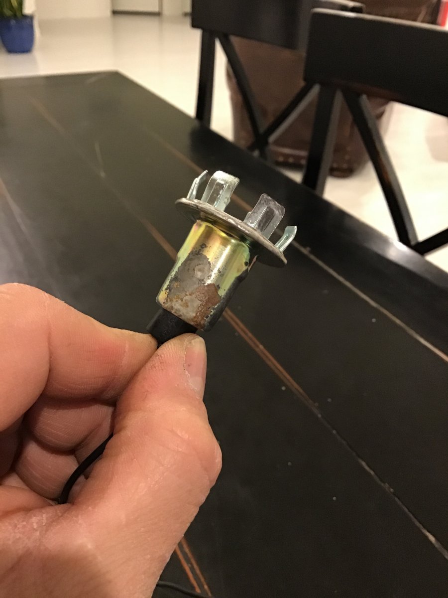

    image.jpg image.jpg Take a look at this... it my p***enger side tail light socket. It got my curiosity when I was testing my lights for draw and notice break,turn,and running light weren’t working right.
    I didn’t think tail light socket can go bad, maybe this was drawing current, grounding?

    The light socket won't be causing problems when the lights are turned off. there is no power to it.

    I had my neighbor charge my battery since I wore it down working on the lights. I replaced the bad socket. Now my tail lights work perfect, I actually didn’t know they weren’t working till I wanted to test the amps to see if my meter was working. As of noon my meter read the battery at 12.33v. I’ll post we’re its at tomorrow morning. FYI my milliamperes are still at .13
