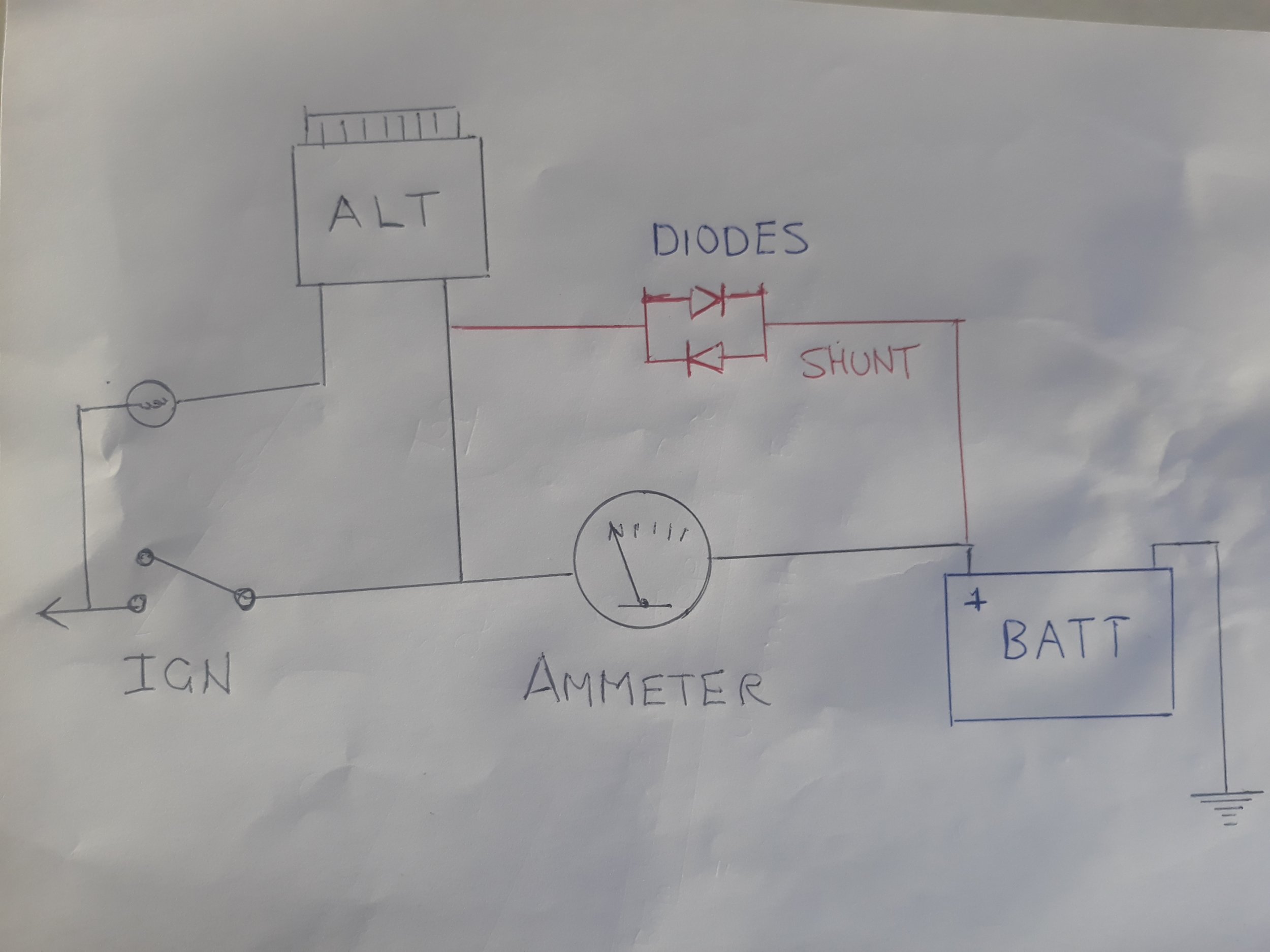

    Kerrynzl
    Make a "diode shunt" that byp***es the Amp Gauge when the current exceeds 20a
    Normal usage [< 20a] the Ammeter has less voltage drop than the forward drop of the diode [so the ammeter reads as normal ]
    when the ammeter is ma**ed out the voltage drop equalizes with the diodes so the shunt acts like an "electrical relief valve" [this is usually the battery recovering from excessive cranking]
    And if you totally Chernobyl your ammeter, you won't be left stranded on the roadside.

  8. Kerrynzl
    Joined: Jun 20, 2010
    Posts: 3,619
    Kerrynzl
    Use 2 Vishay diodes mounted "back to back" on a phenolic block.[using bolts and spacer tubes with wires that have eyes on the ends]
    It doesn't matter which wire goes where because it flows both ways.
    One wire direct to the Alt and the other wire direct to the battery.
    On my friends old Chevy pickup wr mounted this inside a gutted out external regulator box.
    https://nz.rs-online.com/web/p/schottky-diodes-rectifiers/8184553
    This has a forward drop of 0.83v
    You need to measure the voltage drop across your ammeter [with lights / heater fan etc on]
    If the voltage drop across your ammeter is greater [eg 1.0v] use a 150a Vishay diode.
    The 80a diode is actually safer but the ammeter wont reach full readings before the diode equilibrium occurs

  12. Kerrynzl
    Posts: 3,619
    Kerrynzl
    Why ????
    When there is a ****load less work making a shunt [and you don't really need to crawl under the dash]
    @deucepickup32 @Charlie Stephens @squirrel
    The diode shunt does not alter the values of the ammeter. It acts like an "electrical relief valve" when the amp draw/flow is greater than the ammeter's capability
    A simplified explanation here..............
    The Diode has a fixed value forward drop [eg: 1v] so 12v in = 11v out or 13.5v in 12.5v out
    Whereas the ammeter has a non-linear voltage drop. And usually the max voltage drop is about 1v to 1.15v at full values.
    99% of the time the ammeter current is below 10a so the voltage drop is very little [so it's business as usual]
    The diode will not flow any current because it is met with a greater voltage on the output side
    when the amps across the ammeter increase , so does the voltage drop. It gets to a point of equilibrium where both the ammeter AND the diode flow current.
    As the amps increase even more the ammeter stays at this value and all the extra excess flows via the diode
    Electricity takes the path of least resistance.
    With normal usage [20a or less depending on the ammeter] the ammeter shunt might as well not be there. It is only needed for protection in high current flow situations like recharging a flat battery etc.
    @Charlie Stephens an ammeter has a built in shunt, by adding a wire you have altered this resistance.
    Whereas a diode acts like a fixed value on/off switch [simplified term]
    The diode is only used for its forward drop values [voltage needed to allow flow] not for it's one way blocking values
    We made one on my friend Chris's Chevy pickup [he didn't want to butcher the dash AND he likes all his gauges to be working]
    If you can buy a cheap "off the shelf" voltmeter solution , I would always recommend this [but some of us don't want to butcher our "orphan" vehicles

  14. Kerrynzl
    Posts: 3,619
    Kerrynzl
    The diode isn't byp***ing the ammeter until the voltage drop across the ammeter is equal / exceeds the forward drop of the diode. [the path of least resistance is via the ammeter]
    Usually this happens when the ammeter is near ma**ed out [this voltage drop can be measured]
    We found the max voltage drop on an early Chevy pickup ammeter was 1.15v drop. The forward drop of the diode we used was 1.12v to "open" it to allow flow.
    So just shy of the ammeter being fully pegged to the limit, both were sharing current. Any more current would go through the diode [that could handle 100a]
    In a low current situation [eg: a 0.3v voltage drop] there could be 12.5v on one side of the ammeter and 12.2v on the other.
    But the diode would have 12.5v on one side and 11.38v on the other [1.12v forward drop]
    It cannot flow current [11.38v into 12.2v]
    99% of the time the ammeter would read it's normal charge and discharge. We didn't care if the ammeter would read the excess current, we just didn't want to fry it.
    Putting a larger alternator on a vehicle will not fry the ammeter unless there is load [eg: after being jump started from a flat battery]
    This example the diode saves the ammeter [and wiring]
    Electricity always flows the path of least resistance

  17. Kerrynzl
    Posts: 3,619
    Kerrynzl
    So you have to do math in your head while driving to figure out the charge or discharge through the gauge.
    With a diode shunt it does not affect the values of the ammeter while the voltage drop is less than the diode forward drop.
    Eg: if a 20a ammeter is reading 15a charge, that is how much is flowing back to the battery.
    If it gets to 20a is flowing it is reading 20a
    BUT when 40a is flowing to the battery the ammeter is still only reading 20a.
    When the battery gets recharged, and the load drops back to less than 20a the ammeter reads as per normal.[eg: 10a]
    The only true way to get 100% accuracy is to have a matching ammeter to the charging system. So chose your poison??
    Do you want it 100% accurate within a normal range [most of the time]
    Or do you want it partially accurate 100% of the time
    The diode shunt irrelevant to the size of the alternator [as long as the shunt wire can handle the excess of amp load] .

  29. Kerrynzl
    Posts: 3,619
    Kerrynzl
    I'll do a tech article if I ever make one again. [the last one I made was in 2017 ]
    I got the idea from a friend who played around with Chryslers , he was a bit of a "mad scientist" that played with this sort of thing. [originally he made a manual byp*** shunt with an on/off switch in it, for excess cranking]
    But the wiring [connecting ] is very simple. A wire at each end of the diode that is connected to the Alt output / Battery.
    You can use one diode as long as it is flowing towards the battery.
    We used 2 diodes back to back to make the shunt not polarity dependant AND as a safety backup if the ammeter totally failed
    Ammeters usually NEVER go full discharge [eg 20a] 20a x 12v = 240w so if you had 2 x 120w sealed beam headlights on full beam it would show 20a discharge with the engine not running.
    If you look at the schematic in post # 2 the Alt / Gen goes on the upstream side of the ammeter, so any heavy loads [eg heater, headlights etc] are being fed /maintained by the charging system.
    Apart from the shunt, this is a standard layout for automotive ammeters.
    The Ammeter only measures battery charge/discharge. So any major battery discharge [eg cranking a stubborn engine] is the only time the ammeter sees excess current.
    I used 2 x phenolic blocks approx. 1/4" thick and 2" x 3" size.
    In one block I drilled 2 holes [countersunk] through and used countersunk cap screws up from underneath.
    The 2 screws had the diodes [back to back] with small tube spacers.
    Under the nuts [of the screws]the wires were attached with "eyes" on them.
    The 2nd phenolic spacer was glued under the other to prevent the cap screw heads short circuiting
    It is important that none of these components short circuit.
    skip65, deucepickup32 and Algoma56 like this.
