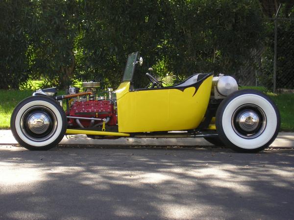

    this is what i meant...

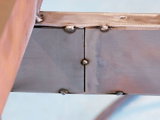

    Plating the frame is the easiest way to "box" one.
    Note in the image that the plates are sunk in slightly to give a fillet weld that can be ground down without losing strength. However before boxing the frame you have to consider the steering box mount, engine and transmission mounts and where they will be mounted. Since you do not have access to the inside to bolt something on you will have to run a tube through it in order to mount something on the side or top. If you are boxing it, now is the time to weld on radius arm mounts and rear control arm and panhard bar mounts. During and after it has cooled check your frame for straightness in two planes, with x measurements.
