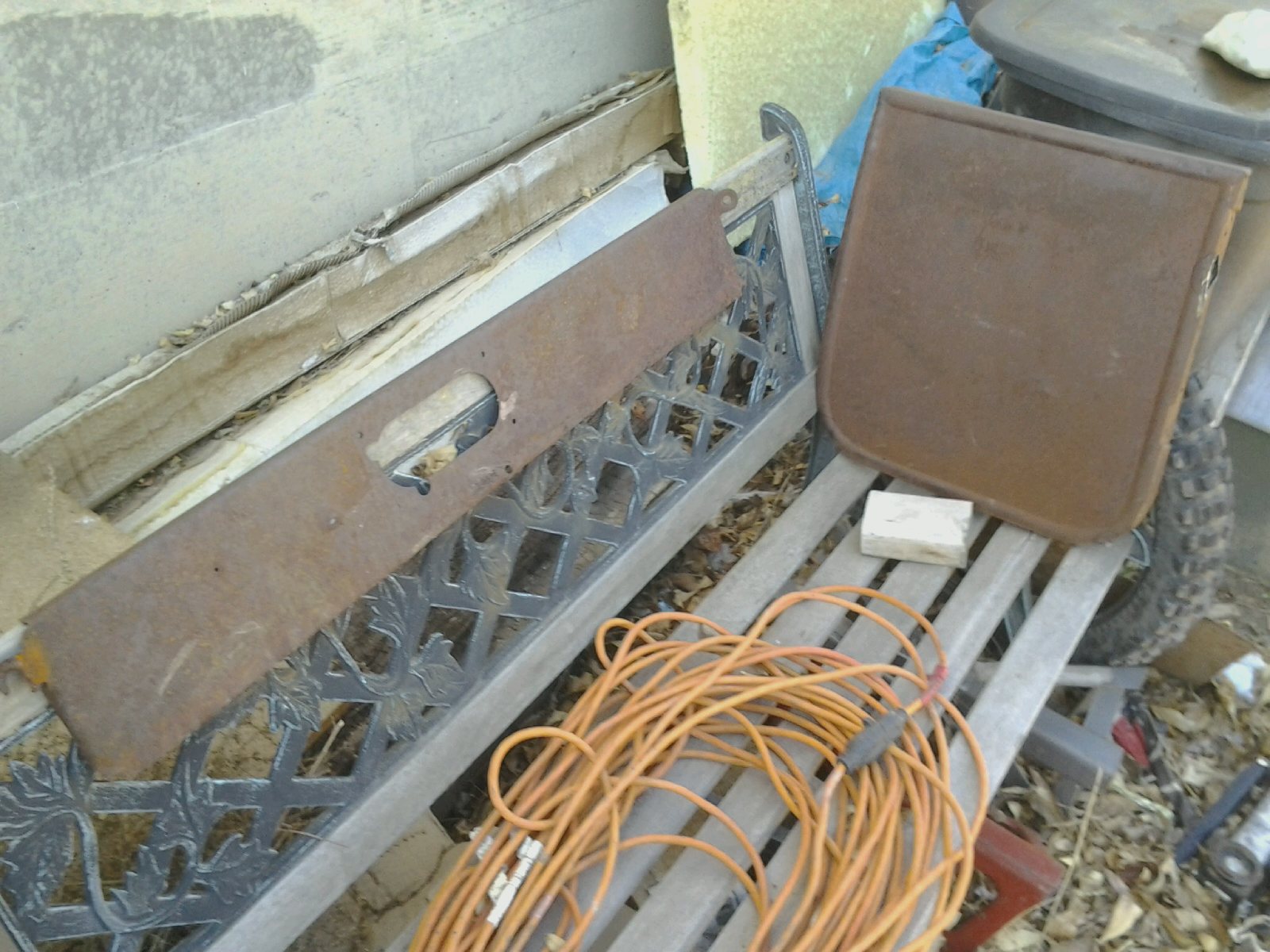

    Got a dash for that bucket?.... Want one? : ) FREEBIE!!! Or i swear, it'll lay here quietly rusting...

    Really!!! I don't have one... I would love to use that on my car!!!!! Your truly amazing!!!!

    el caballo loco

    Hey there!!!! I just got it haha it wonderful!!! Thanks again so very much for it!^_^ I will be sending the money out tomorrow if that's ok!?
