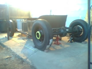

    Amy, it is always hard to try to tell someone else how they should build THEIR car, but I think you are making a good decision in building a whole new frame for your car. In the end it will make your life so much easier.
    As for the dimensions, it all depends on how you want your car to sit. The frame in the top picture is from my Son's T bucket, so it sits a little high in the back, like a T bucket usually does. But the frame in the second picture is from my old 23 modified, and I wanted it as low as possible, hence the higher kickup in the back.
    What I like to do is set the body on some blocks at the height I want it to end up at, then I prop the motor in front of the firewall where everything clears and it looks good, and then I put some old tires in place where they look ok, and then I sit back in a chair and stare at the car for a long time. If there is something that looks odd I move stuff around until it looks good to me.
    The next thing I do is I build a mockup frame out of 2 x 4 lumber. Wood is easy to work with and cheap, plus you can cut it up and modify it until you get it to be what you need. As a starting point, the front crossmember is usually about 24 inches and the back one is usually about 27 inches (for the body you have) but that is subject to your own set up,
    Once the frame is built out of wood sit back in the chair again and stare some more (I actually just like to sit down a lot :eek:) and see how it appeals to you with the wooden frame in the picture. Allow some extra room at the radiator because things always get tight there once you start putting the radiator and fan in place.
    Your car looks really good the way it is sitting, all you need to do is make a good strong frame to support it all. We're all pulling for you here. :)

    Arthur and Don have given you sound advice. The T frame does not have enough channel ( the height of the frame rail ) to support the weight and torque of the Y-Block motor even if you box it. You could use a Model A frame and box it, but starting from scratch with 2 X 4 tubing allows you to "build to suit". Follow Don's advice and mock it up, sit back and move stuff around until you get the look YOU want. Remember, "traditional" means using original or original type parts ( depending on the decade you are shooting for) and your imagination. What you have looks good, keep at it, you'll make it!

    Building a "safe" car is more important than going "traditional". The first time you hit the thottle hard and see the frame twist - you'll see what I'm talking about.

    I would keep and use the T frame. You could box the front and fab up a K or X member that welds or bolts in. Nothing wrong with tube rails, but it would be nice to see a T with an origonal frame for a change.

    Amy IMHO going with the new frame setup is the best choice. The original frame was not designed to handle the torque of an engine like your Y-block and trying to use it would probably cause more headaches down the road. Build a new frame that is capable of handling the Y-block and sell the original frame to help offset the costs.

    Gotta put my vote in for going with new stuff. You could make the stocker work, but it would always be "not quite" as stiff as it could be. The work that would be necessary to make it work would be about double that of making a good, new frame. Do you have an idea of what you want this car to look like? Anybody's historic car perhaps? I find it pretty easy to figure out frame kick and wheelbase and such when I know what someone is looking for, and what they are finalized on for suspension.

    After seeing all the "ditch the T frame it won't be safe" comments I went out and measured the T rails that I have stashed out on the trailer. The wall thickness of those rails is the same or heavier than the normal tubing wall thickness that gets used on most T bucket frame rails.
    I would agree that the rails need to be boxed but a couple of strips of the right width 3/16 cold roll should work fine for that and not be a budget breaker nor a time killer.
    It would probably be a lot less work to run to the steel yard and buy 150.00 worth of 2x4 tubing and build a frame but I don't know if it would end up being that much stronger or any safer.

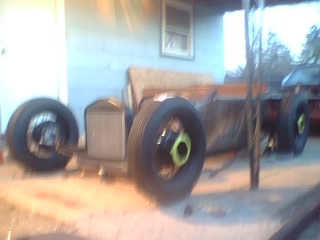

    Okay guys.. It's decided... I am keeping my T frame and putting a flathead in it... I am here at the Rolex Monterey Motorsports Reunion with some of the best race cars, also the t-bucket MOON EYES car, it's running a 292 with a 9" rear end only sitting on a 1924 T-frame and never having a problem.. Also! Elmer Snyder told me that the model T frames are stronger then the model A frames because of the metel they used! He also runs a T frame on his dragster! So I have been talked into keeping my original frame and I couldn't be happier! I thought that keeping my frame would be nothing more of a dream, and for a legend of drag racing to give me the thumbs up I couldn't be more happy!
    Also I finely now know what colors I'm Going with! I know it's kinda far from now but I'm still excited!! That's just say I'm naming her The Cherry Bomb!!
    Tell me what you guys think!!
