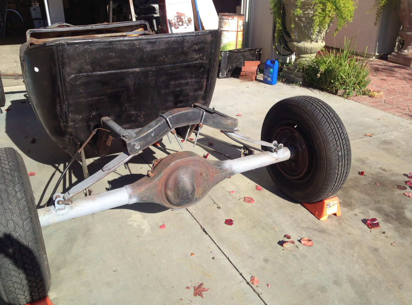

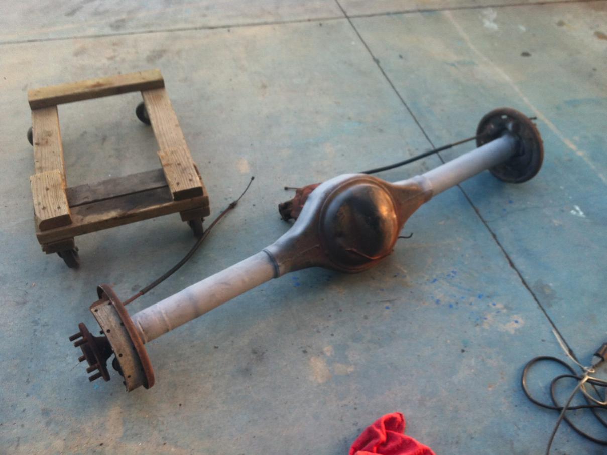

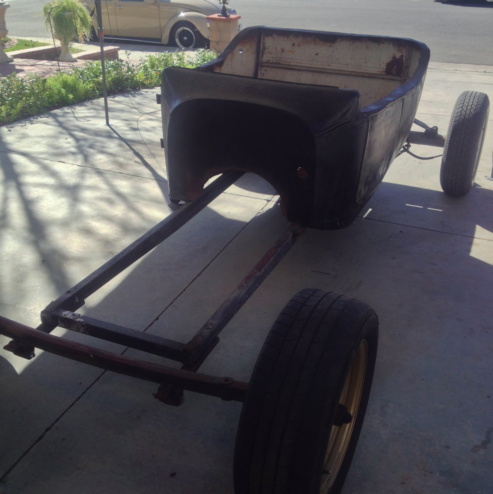

    Hey everyone! It has been awhile... lots of stuff going on (moved, new job, getting married!) But I am still pushing forward on the the Nash-T Roadster!
    The most exciting thing is that it is now a roller!
    It is still essentially just mocked up but it does give us a great idea of the final design. We went ahead and "Z'd" the frame. Mounted the Model A buggy spring, and got the rear radius arms attached!
    Screen shot 2014-07-02 at 5.45.11 PM.png Screen shot 2014-07-02 at 5.45.44 PM.png Screen shot 2014-07-02 at 5.46.18 PM.png Screen shot 2014-07-02 at 5.46.36 PM.png
    Next we got the front axle mounted. We graciously stole from our friend Old6rodder here a copied the front axle design he did on his flying brick. We also have two Model T wishbones that we are going to split and use for radius arms for the front of the T.

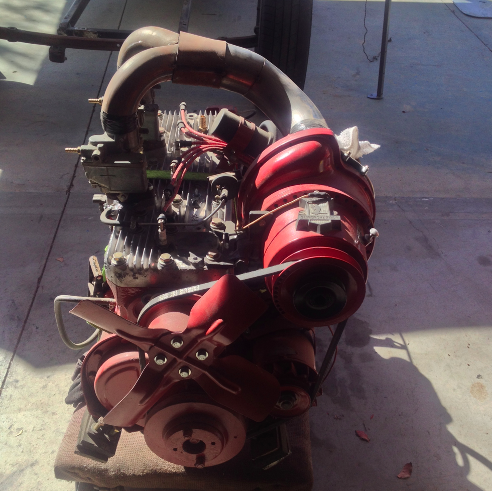

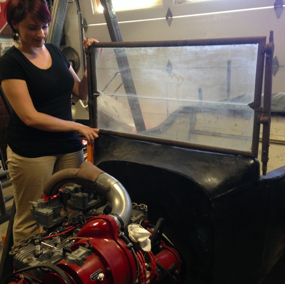

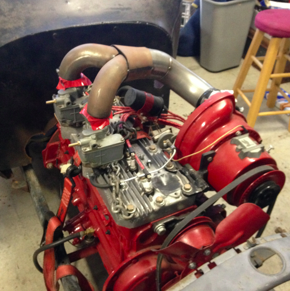

    Next we are starting to mock the Nash flathead 6 engine in the T. We have decided to change the transmission from the factory Nash 3 speed, to an early ford toploader. We have to do some experimenting but we feel optimistic we can build an adaptor (maybe with some help!)
    Screen shot 2014-07-02 at 5.47.38 PM.png Screen shot 2014-07-02 at 5.47.45 PM.png Screen shot 2014-07-02 at 5.48.00 PM.png Screen shot 2014-07-02 at 5.48.44 PM.png
    Some exciting new additions to the build is a windshield that I was able to get from our friend Dave. It fits great, and is starting to give the T a brand new look!
