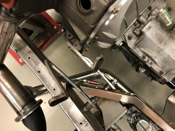

    I needed to run the exhaust between the ladder bars and driveshaft to be in a better position to go up and over the rear axle housing.
    The best place to cross over to get between the ladder bars and driveshaft was just behind the front mounts for the ladder bars.
    I was able to sneak under the bars with just about 3/4" clearance. Not much space is needed because the up and down ladder bar travel at the front mounts is minimal.
    After crossing under the ladder bars I made a rolling 45* offset to raise the mufflers above the bottom of the bars to sort of hide them. I used v-band clamps on each end of the mufflers.
    I needed an exhaust hanger on the muffler outlet so I added 1" tube steel crossmember across the frame that I'll use to mount the hanger bracket.
    Up and over. I had just enough room to leave enough space for full upward travel of the axle housing and have about 1" clearance to the floor.

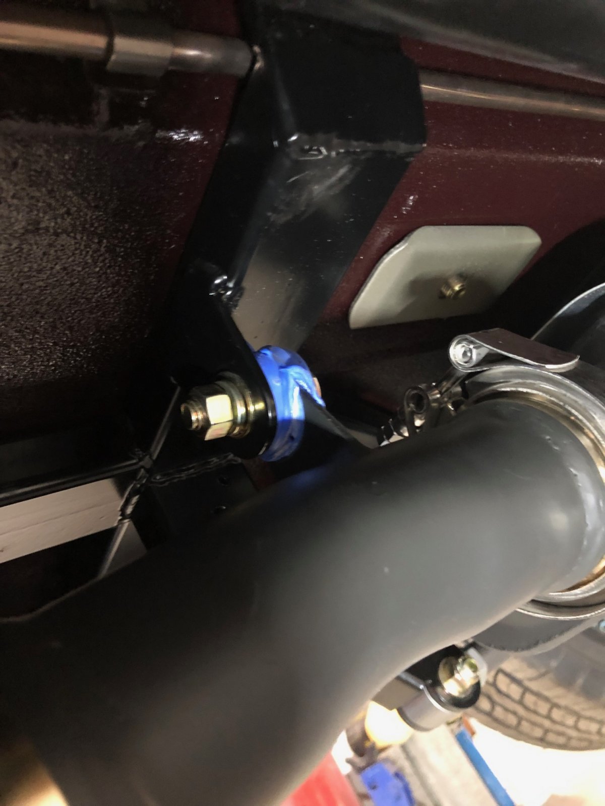

    I found these stainless steel exhaust hanger brackets at Summit, they come already notched for the size tubing I'm using. They are easy to install and have a nice clean look.

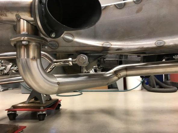

    I wanted a more finished look for the tubing ends, so I machined a pair of fittings that slip into the exhaust outlets.

  13. Be aware, those blue grommets can melt if too close to heat. Keep an eye;)
    warhorseracing likes this.

    rockable
    I had problems with those hangers. The plastic cold flowed and ended up with metal on metal. Changed like he'll when I went over a bump. I like the way they look but did not have good luck with them on my application. Good luck!

    Those grommets are supposed to be made of high temp silicone rubber, but I'll have to wait and see if they hold up. I'm worried more about the front hanger since it will see the hottest temps.

    I checked on the McMaster-Carr website and they have high temp silicone grommets that are rated for up to 500 degrees F. (260 deg. C). If the rubber grommets that came with the hangers are rated the same, they might be ok.

    Plastic is molded by melting it and squirting it into a mold under high pressure, then cooling it. This is plastic, albeit with a higher melting point. As it gets heated up, it loses strength and flows. The weight of the exhaust causes it to flow. Soon, you will be metal on metal.
    They did not work for me and I'm pretty sure they aren't going to work for you. With all the care and precision you've put into this fabrication, I'm guessing you won't be happy with it clanging around every time you hit a bump nor with the resonance that will occur with metal to metal. Time to seek out another alternative, IMO.

    Well looks like I'm going to have to rethink this. The hanger closest to the motor probably won't survive very long, so that one will have to be changed. I think if the grommet is moved farther away from the exhaust pipe like the last hanger at the back, there is a better chance that the grommets won't melt. I'll play around with some ideas and come up with a better design of the front and middle hangers.
    Thanks to everyone who responded with a warning about these hangers, I would have left them as is and most probably been very disappointed after the car is finished and find out that I would have to make changes then if no one had said anything.

    I am trying to remember where I got some High Temp grommets I used on my last build. They replaced the ones like you have and have held up for 3000 miles. At my old age it takes a while?

    There are no "pretty" solutions that I have found. These are the best type at isolation and durability. You can use 3/8" SS rod in place of the carbon steel and paint the brackets. If you find something better, post it up. I'm interested.

    I'd like to stick with the grommets and make longer brackets on the exhaust pipes to move them farther from the heat.
