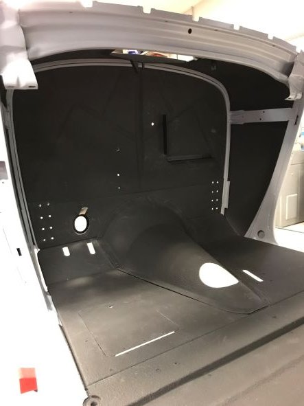

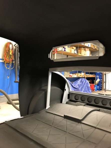

    Hi guys, sorry for lack of updates I have been working on the car since my last post but I just didn't get around to showing my progress here. Here are some updates showing what I got done.

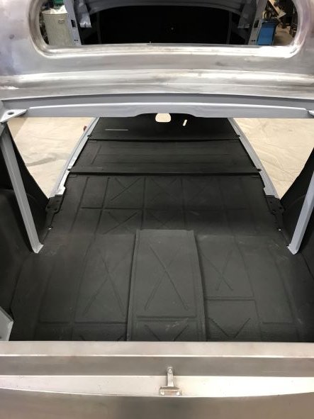

    After I epoxy primed the interior I wanted to add a sound and heat barrier to the inside. I have used the peal and stick sound-insulation sheets in my 55 Chevy build, but I found that to be a pain to install. I decided to try LizardSkin sound control and ceramic insulation instead. I used the LizardSkin application spray gun and shot two coats of the sound control on first like the instructions said. After two days of dry time, I sprayed on two coats of the ceramic insulation.
    This stuff was much easier to apply than the peal and stick sheets like Hushmat. It took longer to mask the car off than to spray on the coating. I used two gallons of each, and it was just enough to do the areas seen in the photos.
    One nice thing about LizardSkin is that it gets into all the nooks and crannies and forms a single even layer of coverage. It does go on surprisingly thick, the final dry thickness is about .080 inches. Also it is very durable. You can work on the inside of the car without damaging the coating.

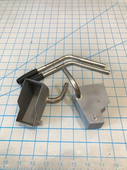

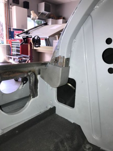

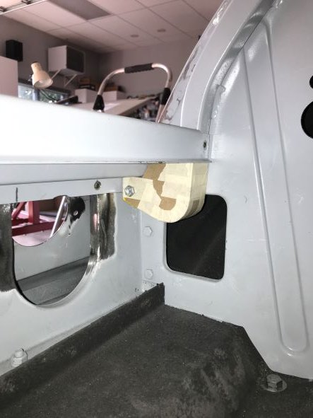

    There didn't seem to be any way to stop water from entering the trunk where the drip rails along the sides of the trunk opening meet the tailpan.
    I was looking through the Brookville catalog and saw a stainless steel trunk drain listed. I had no idea what this part was, because my body didn't come with any stainless steel trunk parts. While at the NSRA show in York, I stopped by the Brookville booth and saw this.
    These are the trunk drains listed in the catalog. Nice pieces but for $195 I said no way. Time to make some cardboard mockups and see what I can come up with.
    This will work. I decided to use mild steel instead of stainless for these pieces, I don't have to worry about them rusting since they will be painted and will probably never see rain.
    Here are the sheet metal cutouts used to make the drain cups.
    The finished parts with the drain tubes. I brazed in a drain tube and a 1/4-20 bolt to attach the cup to the inner trunk side.
    Here they are installed with the drain tubes dumping out through the trunk floor.

    Will you need to caulk the drain box along the edge to seal it to the B,ville body?

    Yes it will need caulk to make it leak free. Also the filler piece just below the bottom edge of the trunk lid opening that bolts in above the drain cups will need to be sealed along it's whole length where it meets the tail pan. Any water falling off the bottom edge of the trunk lid will go into that space and flow over to the sides into the drain cups.

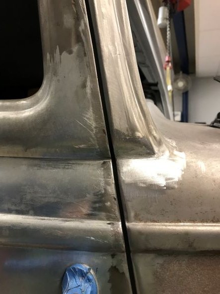

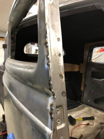

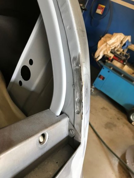

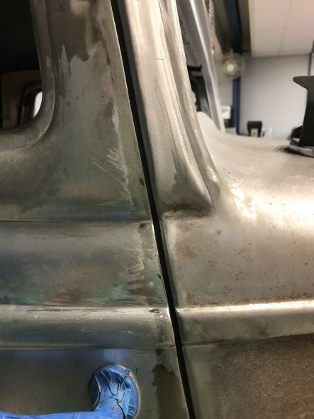

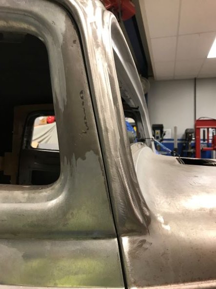

    One area that needed a lot of attention was door fitment. I played around with shimming the body mounts to get the door gaps right, but no matter what I tried I could not get even gaps around both doors.

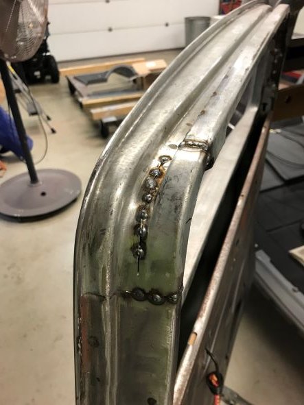

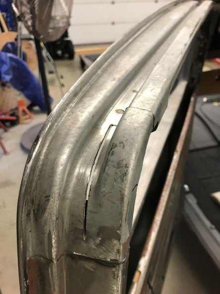

    On the p***enger door at the top front corner the inner door frame was actually hitting the A- pillar.
    I made some cuts to the top of the inner door and was able to move that section back to give clearance to the A-pillar to allow the door to fit better.

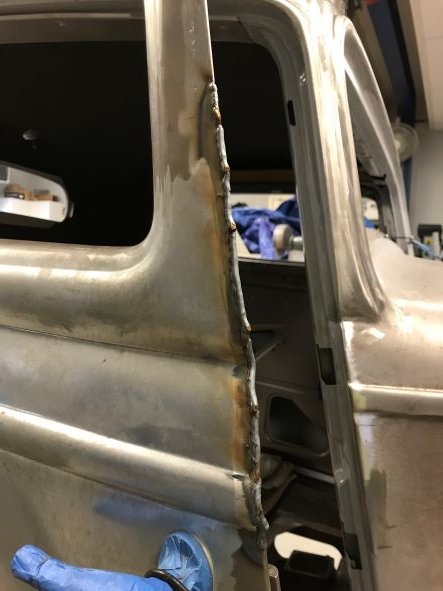

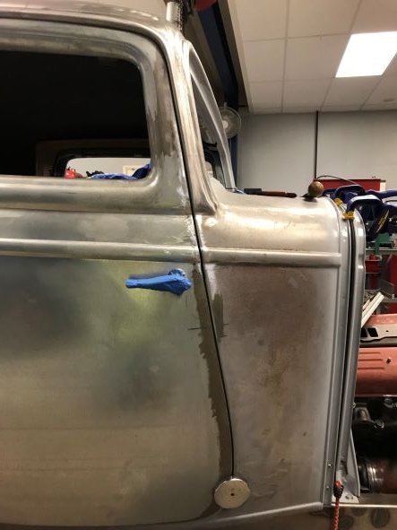

    Now to fix the gap problems. The door gaps were very inconsistent around both doors. Tight in some spots or to wide in others.
    I ground the door edges back at the tight spot beyond were they should be and tacked them together.
    Added a bunch of weld and I kept grinding away until the gaps were straight and even. I used a paint stirring stick as a gage for the gap width.

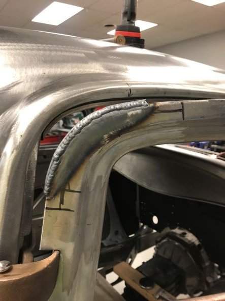

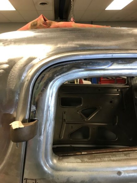

    The upper rear corner gap on the p***enger door was huge.
    I shaped a piece of welding rod to fit the curve and welded it on. More grinding and the gap looks good.

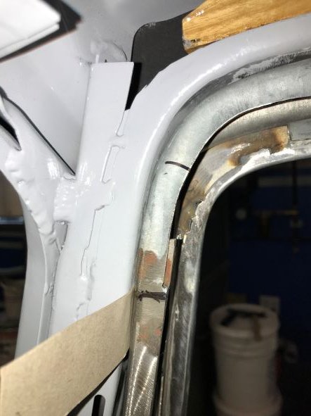

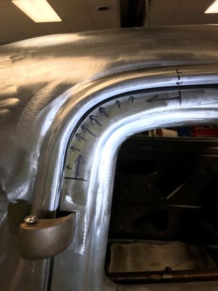

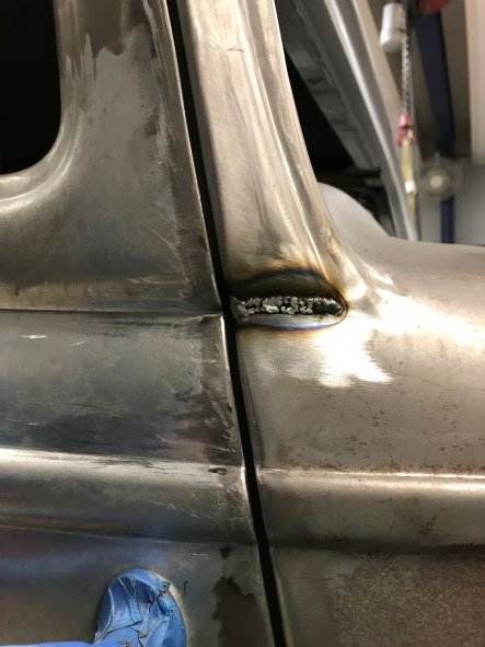

    I couldn't get both body moldings on the p***enger door to line up. The body line on the door under the window opening was lower than the matching line at the bottom of the A-pillar post.
    I added metal to the bottom of the A-pillar and ground it down until the lines matched.
    lucky ink, Woogeroo, alfin32 and 10 others like this.

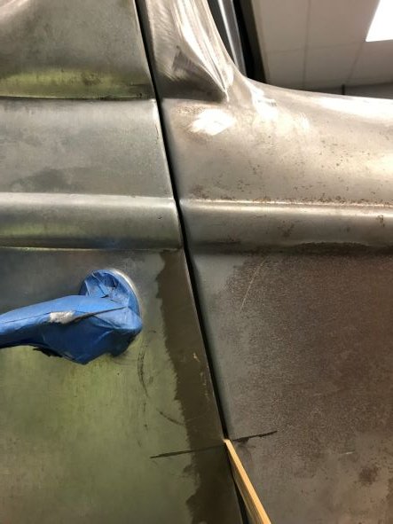

    Here are some pics of the driver door showing the inconsistent gap spacing. I fixed them the same way as the p***enger side.
    After getting the doors to fit good, it was time to spray two coats of epoxy primer on all the bare metal.

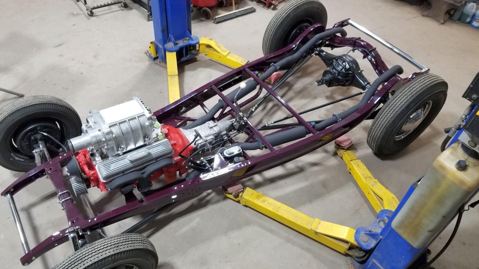

    Here are some photos of the body work that I did earlier this year. First I sprayed two coats of epoxy primer over the body and frame. I let the primer dry for a few days then lightly sanded it to give me an idea of where the high and low spots were before covering areas with a skim coat of filler.
    I evened up the trunk lid and quarter panels and got the trunk gaps looking good with some filler work.

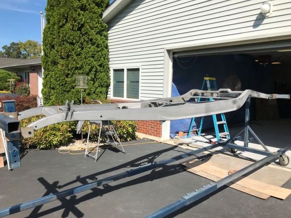

    Here is a shot of the frame in primer. I did skim coat the whole frame with filler, and was surprised to see just how far off it was from being straight and smooth.
    brEad, lucky ink, GordonC and 3 others like this.

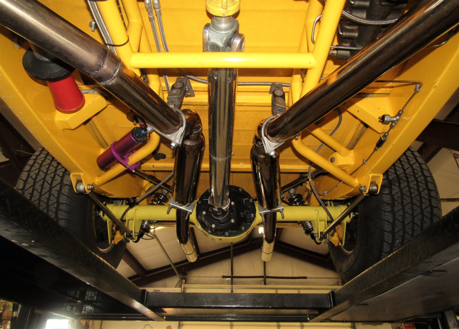

    [I needed to run the exhaust between the ladder bars and driveshaft to be in a better position to go up and over the rear axle housing.
    I simply can't understand the reason for running the pipes over the axles. In the end, the pipes are at the same level anyway. IMG_0419.JPG
  27. clem
    Joined: Dec 20, 2006
    Posts: 4,702
    clem
    More ground clearance.
    Cleaner look to finished car.
    Most cars have the exhausts tucked up out of harms way and out of view.
    When I see pipes under the rear axle, I always wonder why the builder didn’t spend a little more time to tidy it up and do it ‘correctly ‘.
    But each individual can do it the way that they are comfortable with……….

  28. Baron
    Joined: Aug 13, 2004
    Posts: 3,672
    Baron
    I agree. Exhasut should be heard and not seen. 20211031_132600 a.jpg 20191117_123255.jpg

  30. SDS
    Joined: Apr 28, 2011
    Posts: 1,073
    SDS
    Tail pipes tucked up under the frame rails, nice and neat - that's the number one reason to go up over the axle
