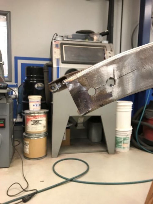

    from PA, USA
    That's what The HAMB is all about, seeing what others have done and using that information for your own builds. I've done it many times myself.
    I'm glad my thread helped.
    INVISIBLEKID and loudbang like this.
  5. clem
    Joined: Dec 20, 2006
    Posts: 4,596
    clem
    maybe start a separate thread on the matter ?

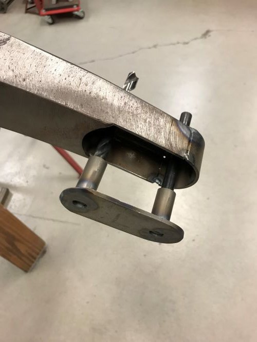

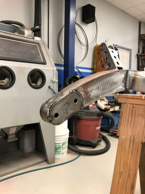

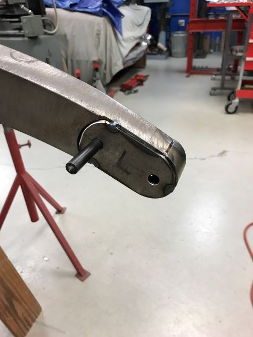

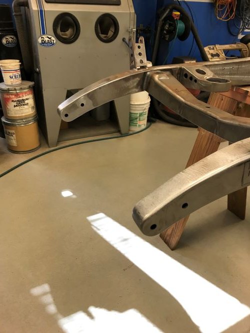

    I forgot to add these photos of the front frame horns getting boxed in like the rear of the frame. I don't like the open look of the frame horns like the factory left them.

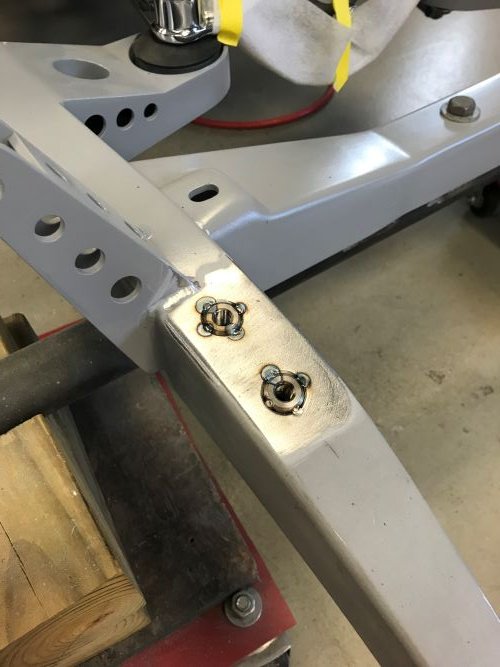

    I added threaded fittings to the front frame horns to bolt the headlight stands to.

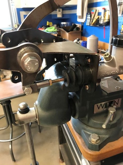

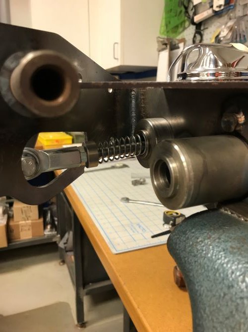

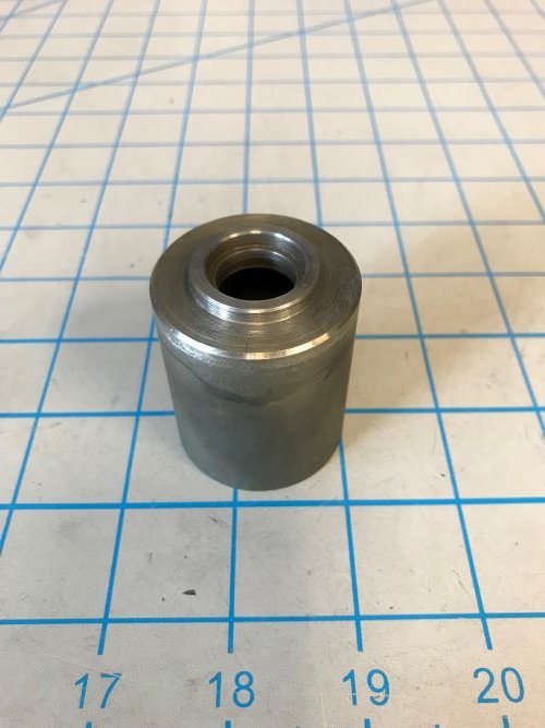

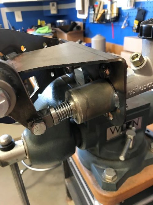

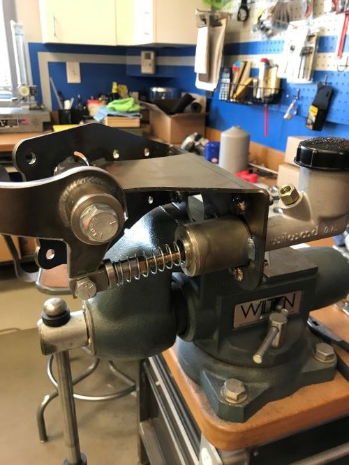

    Here are some mods I made to the brake and clutch master cylinder and pedal mount bracket. I was looking for a way to add the return springs for the clutch and brake pedals, and wanted to hide them from view. Here is what I came up with.
    I made a cover to go over the bellows on the clutch master cylinder that served as a perch for the return spring that is in line and over the actuator rod.
    I did the same for the brake pedal.
    This is a nice neat and hidden way to add brake and clutch pedal return springs.
    I have to play with different stiffness springs to get the right amount of return pressure.

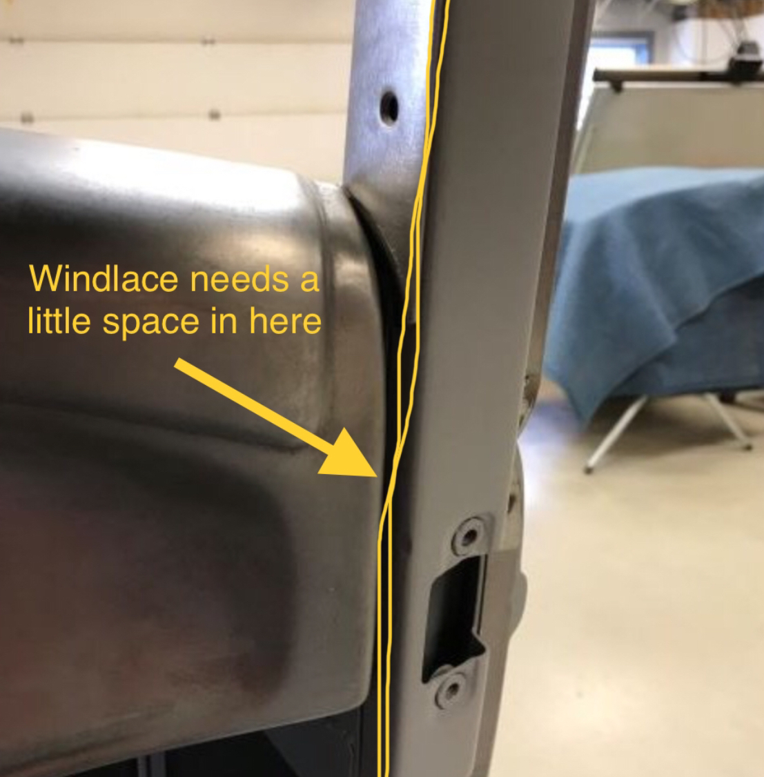

    Food for thought (just in case you’re doing an interior with windlace around the doors at some point).
    better pic to show what I’m getting at
    lucky ink, lurker mick and pprather like this.

    Joe Walsh beat me to the windlace clearance!
    I fitted my safety latches to the scuttle / A post principally because of the fear of closing the door with the latch pin protruding. I can live with paint damage to the door jam rather more than to the outer surface of the scuttle. Limiting the action or length of pin might help with it in the door. I don't envy you trying to fit the latch in that rather inaccessible frontal area in the door!!

    I'm actually trying to eliminate using any windlace around the dash and doors. I like the cleaner look of tight fitting pieces without the windlace filling the gaps. Kinda like my 55 Chevy where the windlace ends just below the dash. I talked to the upholsterer and we are going to try to finished the interior without the windlace for a more custom look.
    brEad and David Gersic like this.

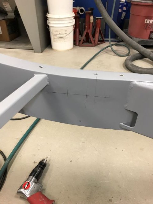

    from PA, USA

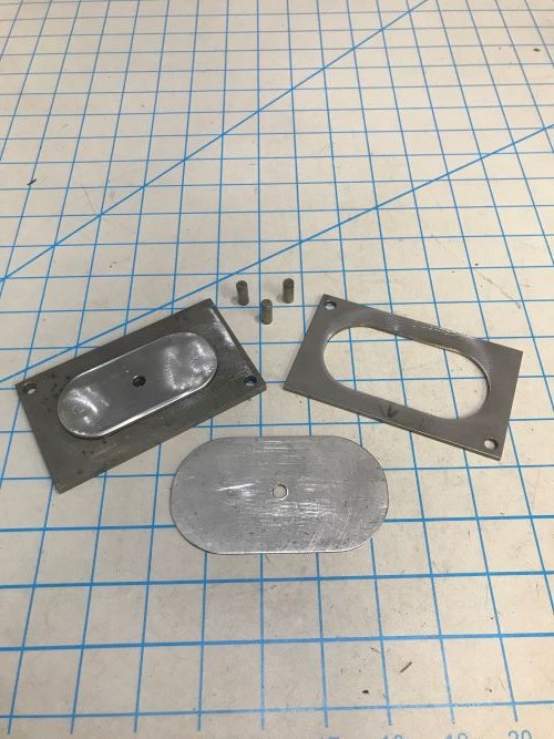

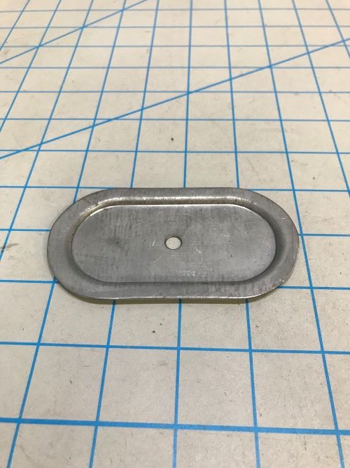

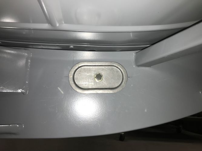

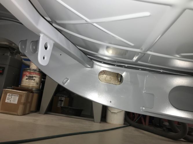

    I'll be routing the wires for the headlights and turn signals through the frame to keep them hidden. I couldn't find a good spot to bring the wires out of the frame into the cowl area under the dash. The only place that worked was to come up through the top of the frame into the passenger compartment behind the door down by the support for the B-pillar wood. An access hole was needed in the frame so that the wires could be directed up through the top of the frame. I made an access hole on both sides of the frame just below the rear of the door.
    The holes will make it easier to fish the wires to the front of the frame for the headlights and turn signals. I'm also running the battery cables from the trunk to the starter motor and ground lug through the frame on the drivers side and the access hole will help with that also.
    Of course now I need to make a cover for the hole. I made a die and stamped out the covers for the access holes.

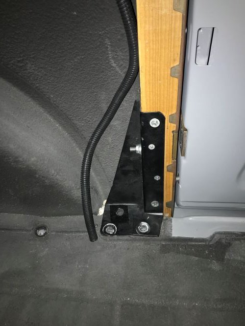

    Here is a shot of where the wire conduit will come up from the frame through the floor.
    I found that the conduit can be routed up along the wood support up over the top of the door and fished down through the A-pillar to get underneath the dash where the connection need to be made.
    A long way to go for headlight wiring, but it will work and the wires stay hidden.
