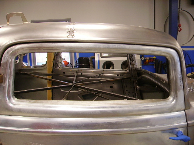

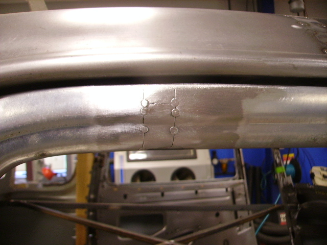

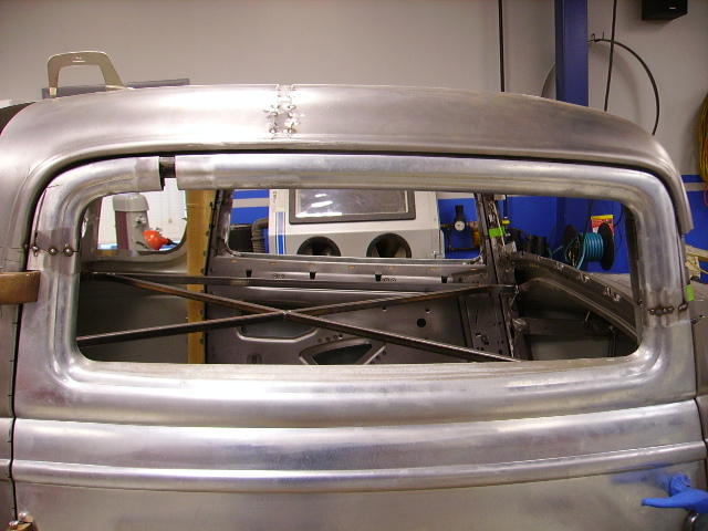

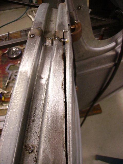

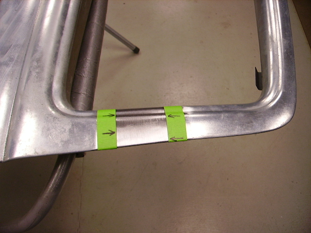

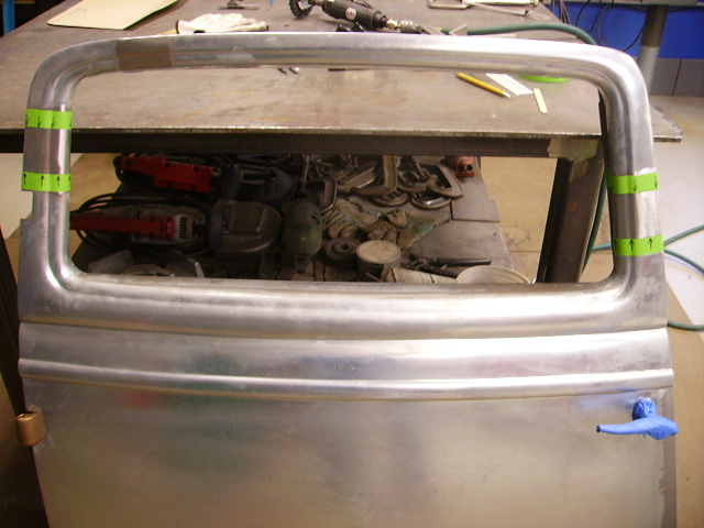

    I got out of order with the sail panel install. I actually did the door chop before that, so let's get back on track and see how that went.

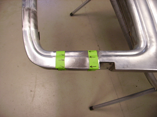

    Here are the cut lines (2 1/2") for the doors. I used photos in one of Flop's threads to help locate the best place to cut.
    The doors were put back on and the chopped pieces tacked in place. I also made the door stretch cut at the top. Gonna have to make a fill piece to fill that gap. All the work on the door chop was done with the doors on the car, constantly checking to make the top door gap as even as possible.
    Had to make some relief cuts to get the front and back edges lined up.

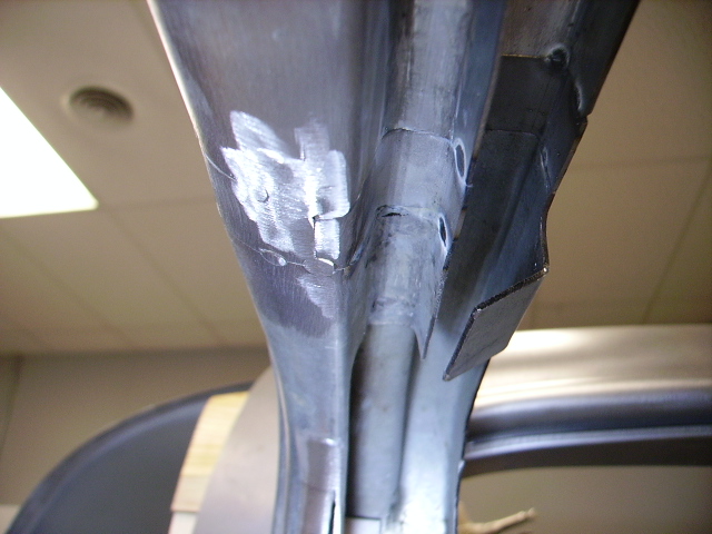

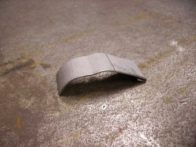

    Gotta fill that gap on the door top. Make another press die and stamp out a piece? There is an easier way. The 2 1/2" piece that was cut out of the rear part of the door above the hinge has a profile very close to the outer skin of the door top. I used the outer skin of it to make a fill piece.

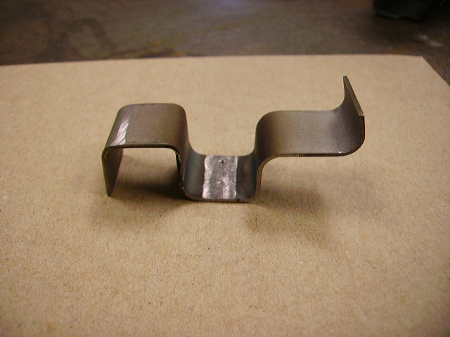

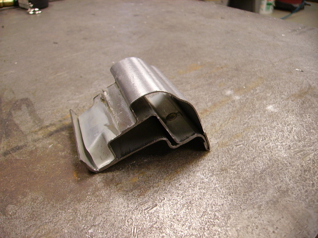

    The fill pieces for the inner door structure looked simple enough, but turned out to be difficult to make. Thanks to Brookville or Henry Ford, every corner bend on the piece was a different radius. I had to make different radius dies for every corner to match the door. It was very hard to get each leg of the bends to match the door dimensions. Lot's of trial and error here. I made many pieces before I was able to get ones that fit.
    The pieces still needed some adjustment when they were tacked in.
    The lower fill piece.
    Here is another tip I got from Flop's threads. This shows the long cut on the top of the door needed to pull the top edge out to match the rear part. Probably would have been upset that the top edges were out of line by this much if I didn't see Flop's fix first. Thanks Flop.
    Lot's of welding on a door chop. Outer skins, inner structure some areas that are hard to reach. It's important to weld all cut seams to regain full strength of the door frame. Here is the finished product. Turned out good.
    The door gaps turned out ok. There are still some door gap issues to address, some from the factory some from the chop. I'll deal with those at a later time.
    I think that's enough for today. There is a lot of pics to study.
    Next up I'll be moving on to filling the roof opening.
    Thanks for looking.

    Posts: 40,342

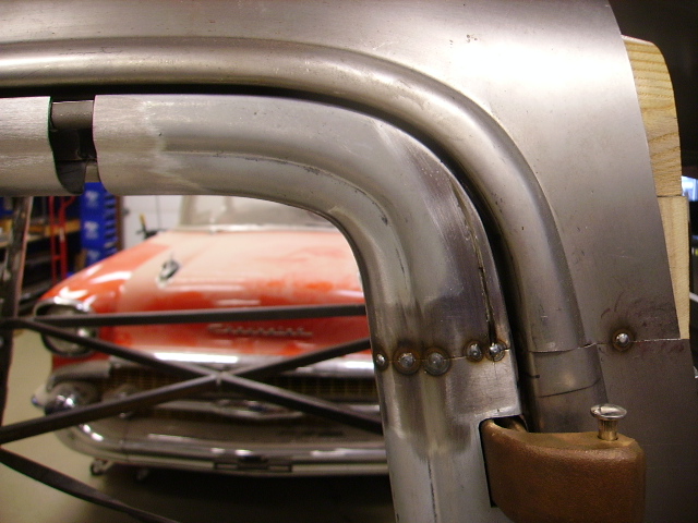

    Pretty nice round welds in this photo. Are they spot welds hammered or just ground down that way?

    Those are tack welds made with a mig welder. I always grind them down almost flush so that they are easier to fuse in with the finish weld.
