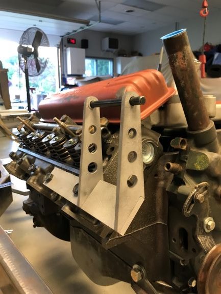

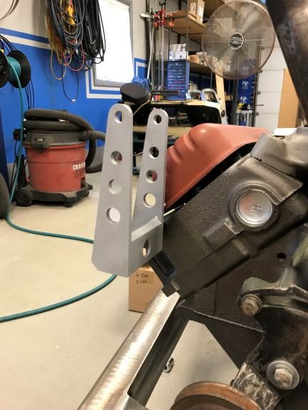

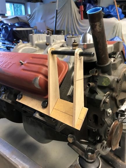

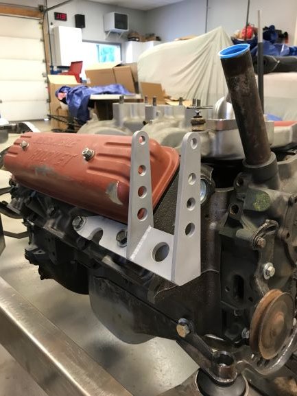

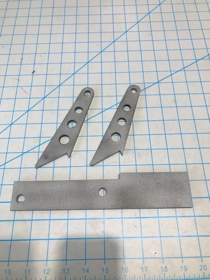

    I know this won't be considered traditional, but I really wanted to have A/C in the car. There are no install kits that I know of for a 49 Olds in a deuce coupe, so it's all home brew fabricating to make it happen.
    I thought of different ways to mount the A/C compressor, but the best way I found was to build off of the two head bolts above the number 2 cylinder.
    Here is a mockup made from 1/4" hardboard.
    Here are the real parts cut out and set in place.

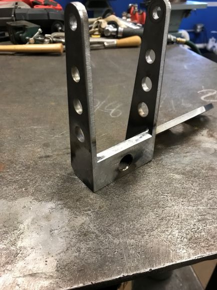

    Something didn't look right to me, the part looked like it was missing something. I added gussets and a fill piece between them.
    The part looks more finished and stronger now.
    I cut out a notch for the spark plug wire and beveled the end to make it look better.
    This turned out to be a very sturdy mount. I thought I would have to add more bracing but it's good the way it is.
    I made sure the compressor pulley lined up with the front pulley groove on the water pump and crank.

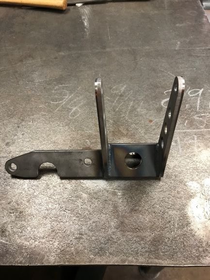

    I'm using an alternator that looks like the generator that was originally used with the Olds motor. I mounted it on the Edelbrock manifold with the bracket that came with the original intake manifold. I thought that the alternator sat to high compared to the A/C compressor, or to close to the carbs depending on where it was swung.
    I modified the original bracket to move the alternator down and towards the driver side.
    I made these small tabs to bolt to the manifold and welded them to the bracket.
    This puts the alternator in a better spot. It looks more even with the compressor and gives me more room to fit the carbs and linkage without looking crowded.
