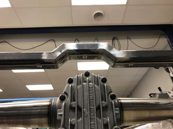

    I actually anticipated having to add more bracing to the compressor bracket, but after mounting the compressor I was surprised how sturdy this bracket is. The piece with the spark plug cutout is 5/16" thick, I can grab the compressor and try to bend and twist the bracket but there is almost no movement. I'm confident in my welds and I feel that this will work fine as is.
    I do appreciate your input.

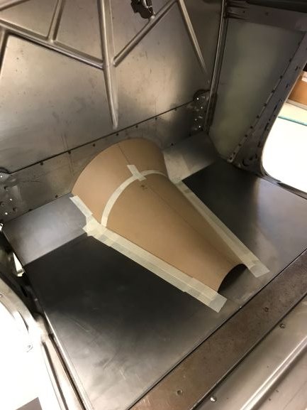

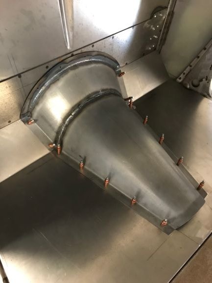

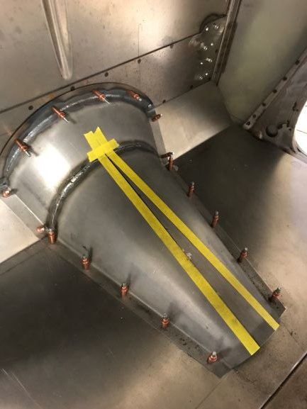

    Nice trans tunnel!

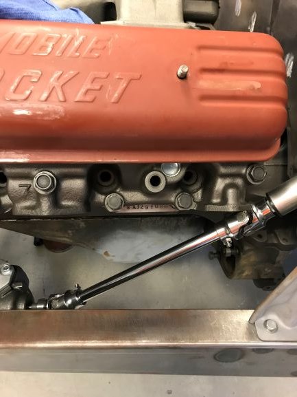

    Did you give clearance for removal of the trans-to-engine bolts, or are you relying on the trans tunnel being removable?
  6. Bcap55
    Joined: Oct 5, 2009
    Posts: 348
    Bcap55
    from PA, USA
    I didn't consider leaving room to get to the trans bolts. My main concern was to keep the trans tunnel as small and compact as possible. I was worried that a larger tunnel would take up to much foot space and make it hard and uncomfortable to use a firewall mounted throttle pedal. The trans tunnel will be bolted in so it can be removed.
  7. SDS
    Joined: Apr 28, 2011
    Posts: 1,073
    SDS

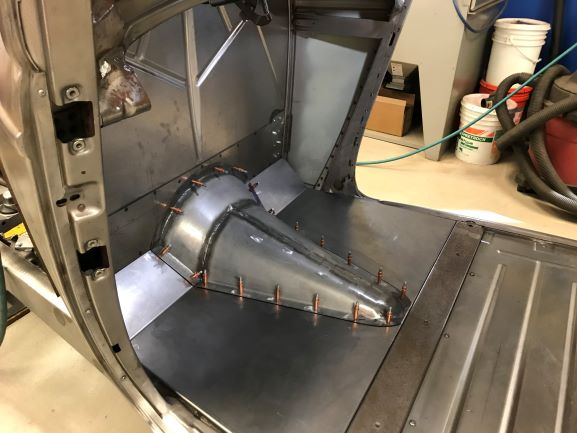

    What is the thickness of the steel you use to fabricate the tunnel?
  8. Bcap55
    Joined: Oct 5, 2009
    Posts: 348
    Bcap55
    from PA, USA

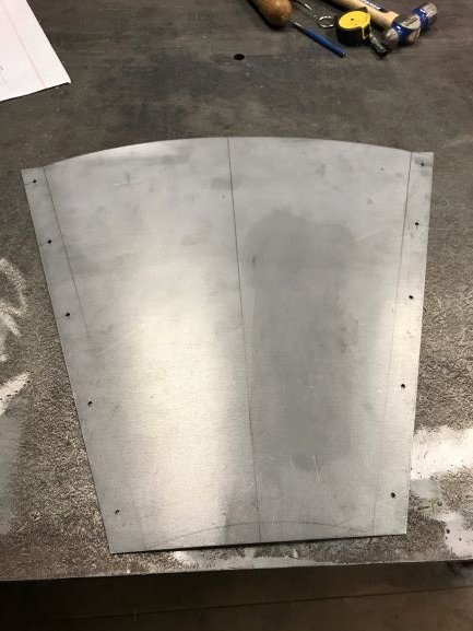

    I used 18 gauge. My slip roller had a hard time forming the cone shapes, If I was to do this again I would use 20 gauge.

    I built my floor and tunnel out of 10ga. Hand formed over an oxy bottle. Crude by most standards, but it’s ridged 6D4A3398-1F6E-407B-834A-90CF37F548A1.jpeg

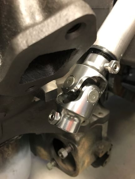

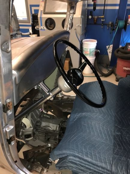

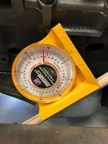

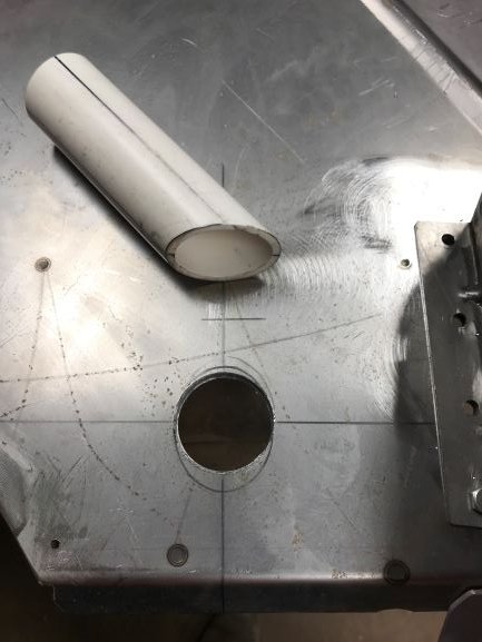

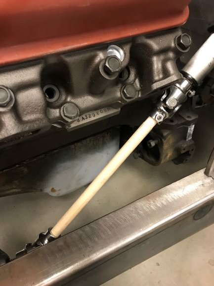

    I see that you used a 30-in steering column - do you think your steering shaft angle was would have been cured by a 32-in column? In my case, with a small block Chevy, I think I have more clearance around the steering shaft because my engine is more narrow and my exhaust ports don't stick out like the Olds. I'm 6 ft 6 in and am trying to squeeze every inch out of my seat mounting situation to get room in the p***enger compartment. With the price of everything going through the roof right now, I'm considering buying a steering column without mocking it up... Some people say to get a 30-in, some people say to get a 32-in.
    Thoughts?
  12. Bcap55
    Joined: Oct 5, 2009
    Posts: 348
    Bcap55
    from PA, USA

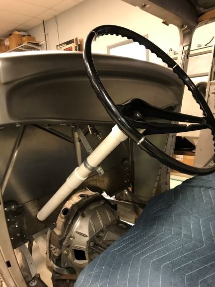

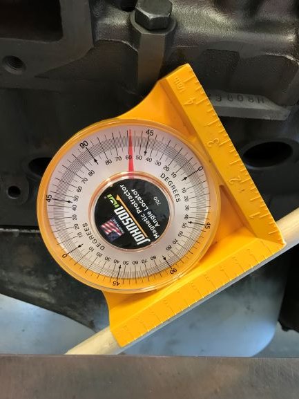

    I don't think a longer column would help with the steering shaft angle. I'm 5 ft 8 in. and I like to drive while sitting close to the steering wheel. A longer column would have placed the steering wheel to far back and to high for me.
    I followed other peoples advice and set up the seat and pedals in the car and used the pvc pipe to test different positions until I found what was most comfortable for me. Then I measured to find what column length I needed. This also allowed me to find the best spot to go through the firewall. You will have an easier time getting past a the SBC head than an Olds.
    Take the time to do a mockup you don't want to wind up with a column that doesn't fit or makes driving uncomfortable.

    Thanks for the advice - I work in product development and see the current supply chain issues & shortages first hand (before it will affect consumers). The price of Limeworks columns has nearly doubled and I'm already running into issues with getting my hands on a lot of the parts I need. By Christmas, this problem will be dire.
    As such I'm racing to get the parts to complete this and may just buy a 30" column.

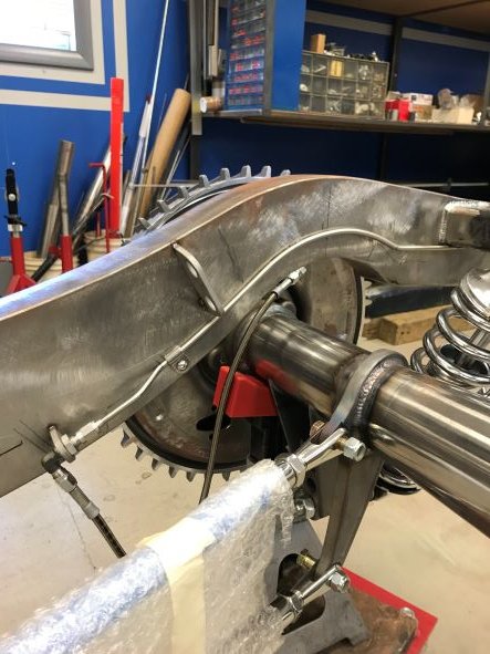

    I got the brake lines and part of the fuel lines installed.

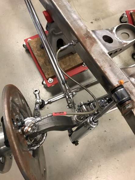

    Here are photos of the brake lines. I used 3/16" OD stainless lines from Earl's. They make very good tubing for brake and fuel lines. The tubing is seamless (no weld seam on the inside) which makes it ideal for single 37* AN flares and it is also annealed which makes it easy to bend.
    IMG_1899.JPG IMG_1900.JPG IMG_1901.JPG IMG_1902.JPG IMG_1903.JPG IMG_1905.JPG IMG_1906.JPG

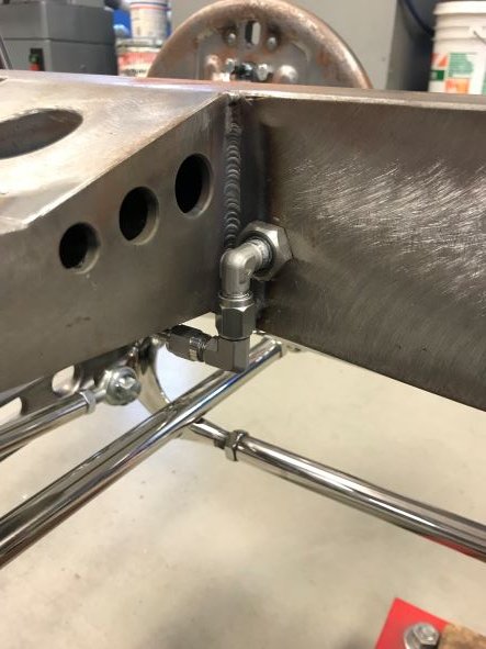

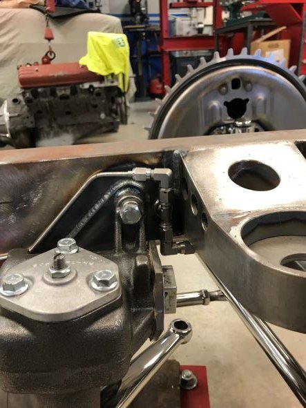

    I used thru frame fittings to connect the braided brake hoses to the front drum brakes. This is not the correct length hose, I just used a spare I had laying around to get an idea on how the hoses would be routed.

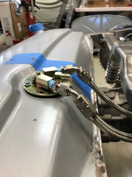

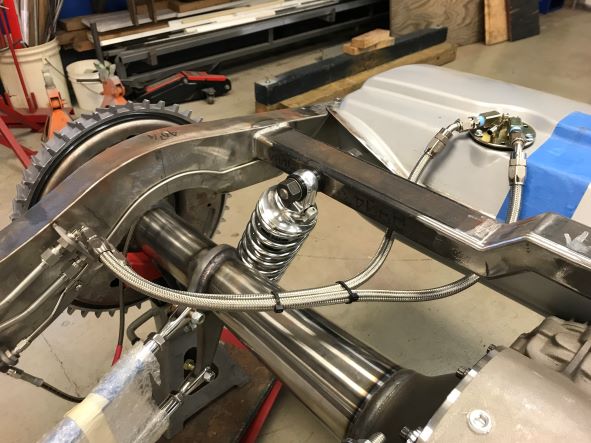

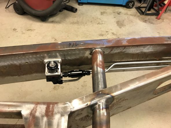

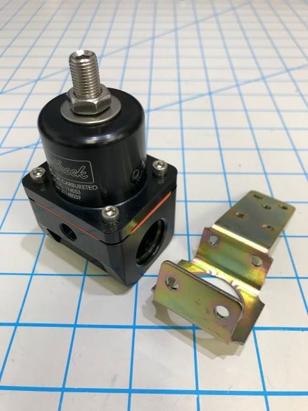

    Since I am using an in tank electric fuel pump, I needed to have a pressure regulator in the fuel supply line to reduce the pressure to the Stromberg carbs I'll be using. The fuel tank and pump are from Tanks Inc., and they recommended that an Edelbrock byp*** regulator should be used. The regulator comes with a mounting bracket, but I couldn't use it in my application.
    I made a new one from a piece of aluminum angle cut down to fit.
    Here is how I ran the supply and return lines from the regulator to the tank.
    I need to order clamps to hold the lines in place.

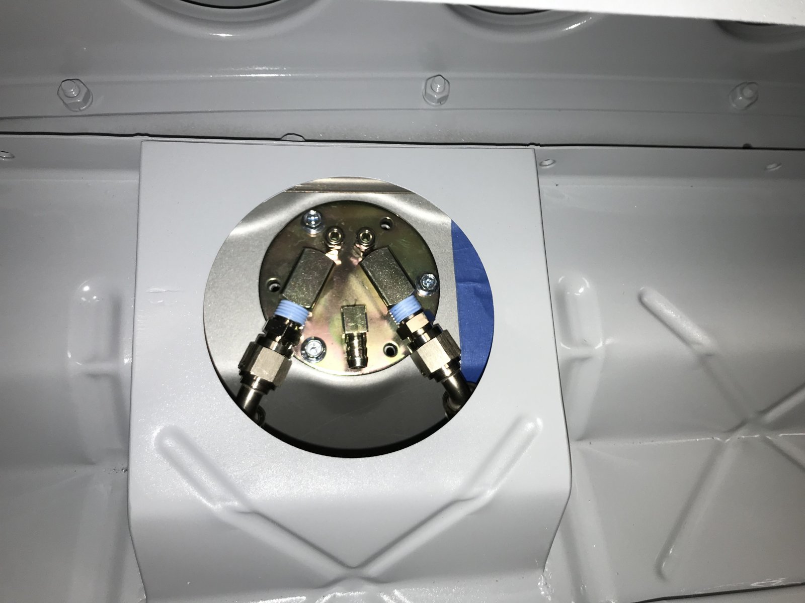

    Here is a view of the tank connections through the access hole in the trunk. There is enough room to disconnect the fuel lines and remove the pump.

  17. loudbang
    Posts: 40,347
    Any thought as to how you are going to adjust that regulator once the body is in place?
    The 39 guy, brady1929 and pprather like this.

    from PA, USA
    You're right , not enough room to adjust the set screw on the regulator. I will replace the set screw with a hex head cap screw so that it can be adjusted with an open end wrench from underneath the car. Or I may just tack weld a nut onto the end of the set screw.

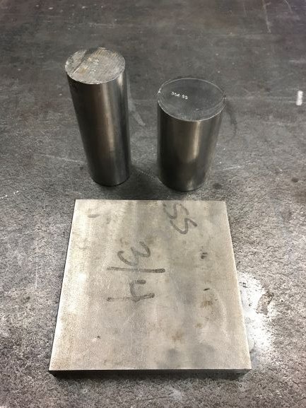

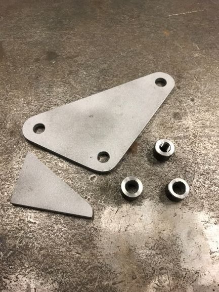

    I wanted to use a flange joint to connect the exhaust to the header. The header is made of mild steel and will be ceramic coated and the the exhaust pipes and mufflers will be stainless so I needed two mild steel flanges and two stainless steel ones. I wanted to keep the flanges as small as possible for the right look, and I could not find any ready made ones in the size I was looking for so I decided to make my own.
    I liked the look of three hole flanges and also they can be made smaller in length than two hole flanges, so I made a template for the flange in a size that should work and not look to big.
    Here is a photo of the template and the flange blanks being drilled for the three bolt hole pattern. I drilled 1/4" holes that will be enlarged to 5/16" later.
    This photo shows how I tack welded the mild steel blank to the stainless steel blank. This way I can drill and bore the pieces together so they match. I bored the centers to 2 1/4" for a tight fit to the tubing.
    Here I use 1/4" dowel pins to locate the template on the blanks and scribe the shape of the flanges on the pieces.
    I bolted the pieces together and rough cut the flanges out on my band saw. I used a belt sander to clean up the rough cuts down to the scribe lines. I wound up with four matching flanges.
    I used a 2 1/8" hole saw to make the bottom outlet hole on the header.
    I used a short piece of the 2 1/4" exhaust tube to space the flange off of the header. I used a 3 1/4" hole saw in the mill to make a 10 Deg. fish mouth cut in the tube which gave me a very nice fit up.
    I only welded the inside of the flange to tubing to keep the flange face from distorting and also to give the outside a cleaner look.

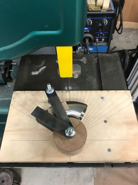

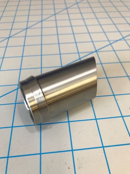

    I needed a way to accurately miter the 90 deg. fittings to the angles needed to route the exhaust pipes under the car, so I came up with this simple cutting fixture to use on my bandsaw. I bolted a stack of wooden circles that match the inside radius of the fittings to a piece of plywood. I marked out angles every 5 deg. on each side of center to help set the fitting to whatever angle needs to be cut. I added a piece of flat stock with a stop welded to it so that once set multiple fittings can be mitered to the same angle. Another piece of flat stock across the top of the fitting is tightened down to hold it in place.
    I added a piece of flat stock to the bottom of the plywood to ride in the slot in the table.
    I made a few cuts with it and it works well, the angles are accurate and the fitting ends are nice and square.
    This works best with a fine tooth (24 tpi) bandsaw blade.

    That's way cool (you have a metal bandsaw at your house!). I hack away at mine with a cutoff wheel with a four inch grinder, MIG everything together, grind the welds out with a 40 grit flap disc and then Cerakote the exhaust.
    You could easily sell a more production-friendly version of that jig.
