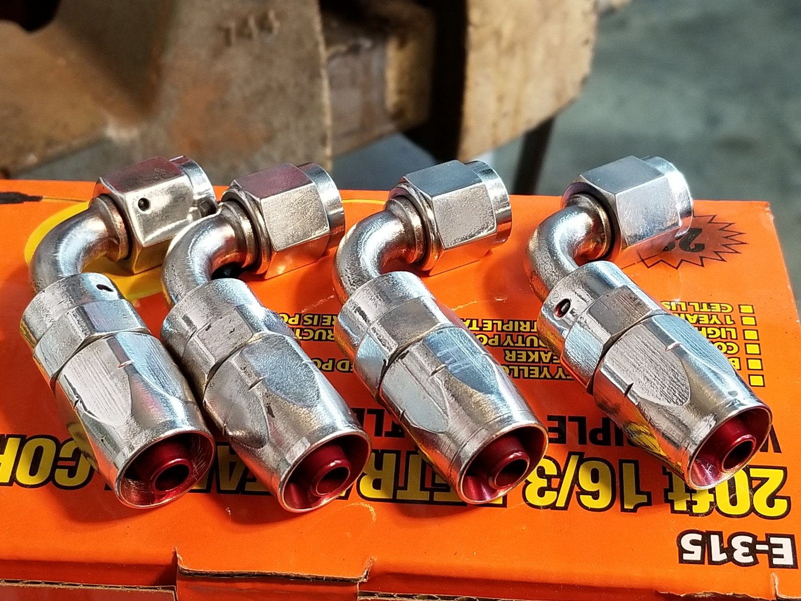

    I use Aeroquip and have never had issues, why skimp on something that could possibly burn your car down to the ground ???
    If you don't like the red/blue just wire wheel it off, I just did these. 20210718_171215.jpg

  23. jimmy six
    Joined: Mar 21, 2006
    Posts: 17,056
    jimmy six
    EZ off oven cleaner works good too. I have some clearkote in a brush bottle I use after removing all the coloring..
    mad mikey, Blade58 and lake_harley like this.
  24. swade41
    Joined: Apr 6, 2004
    Posts: 14,466
    swade41
    from Buffalo,NY
    I bought a generic brand, but it still had the caustic acid in it, and it did nothing after 20 minutes and using a br*** brush.
    Plus I was a little skeptical on if it would harm the inner rubber seal on the swivel fittings, so after it didn't work on that junk fitting I decided to wire wheel the fittings I was using.
    mad mikey likes this.
