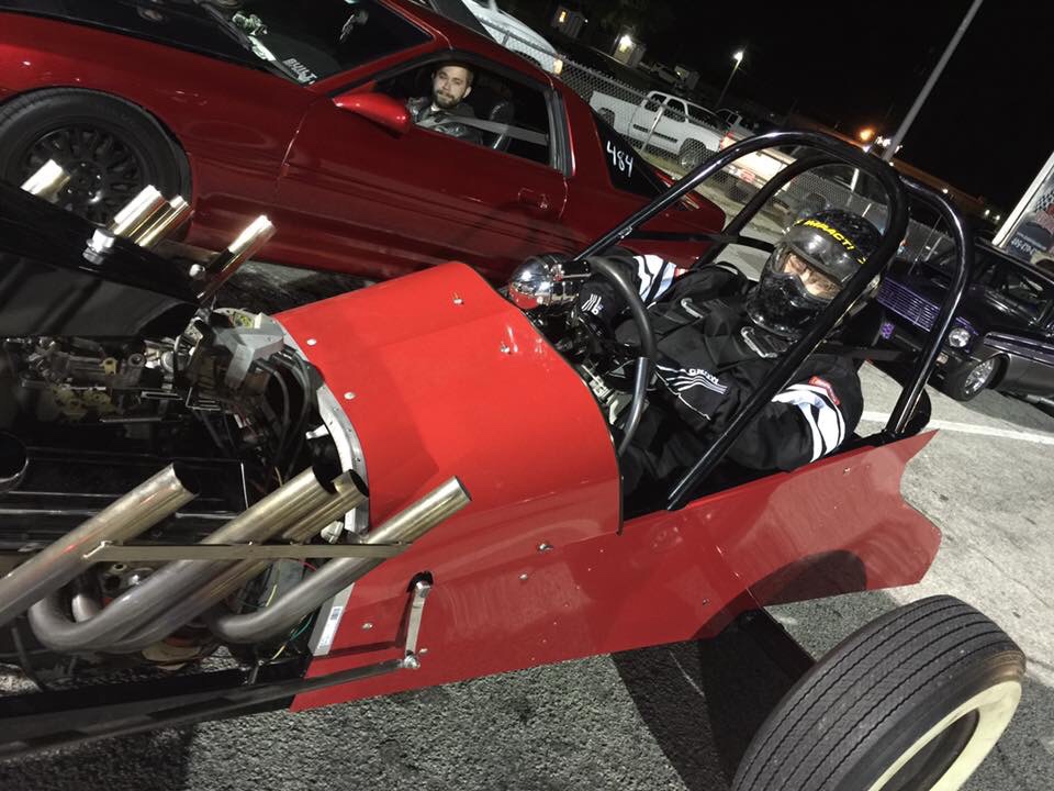

  20. Harry506
    Joined: Oct 14, 2014
    Posts: 58
    Harry506
    Got my first win last weekend in my $3200 race car...
  21. bobw
    Joined: Mar 24, 2006
    Posts: 2,376
    bobw
    Winning is good! You should win best appearing car too.
