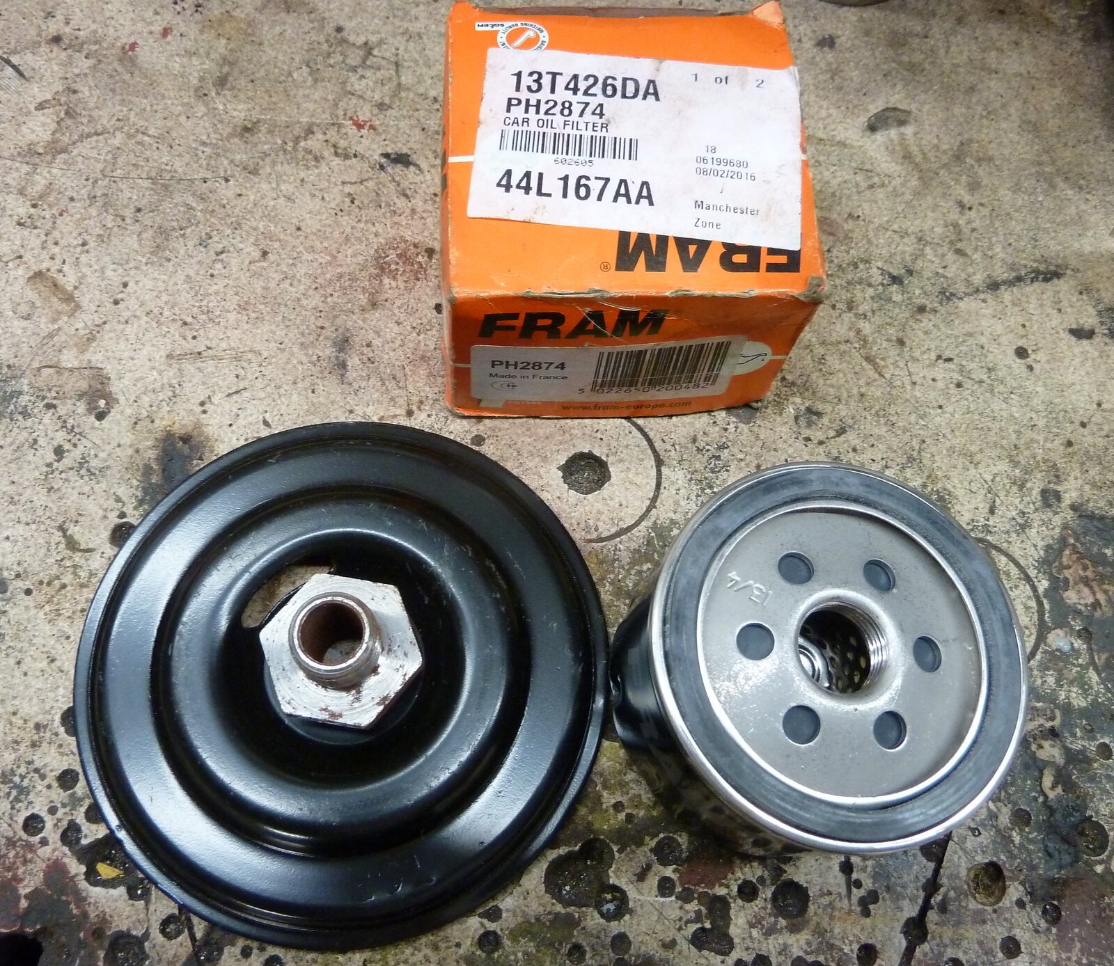

    By the way - I know you didn't ask this, but you can get a screw on Y-Block oil filter that is half the length of the usual filters. For the benefit of others who may have space issues, the part number is FRAM PH2874. Not so sure how good they are at filtering though as they are so small!
