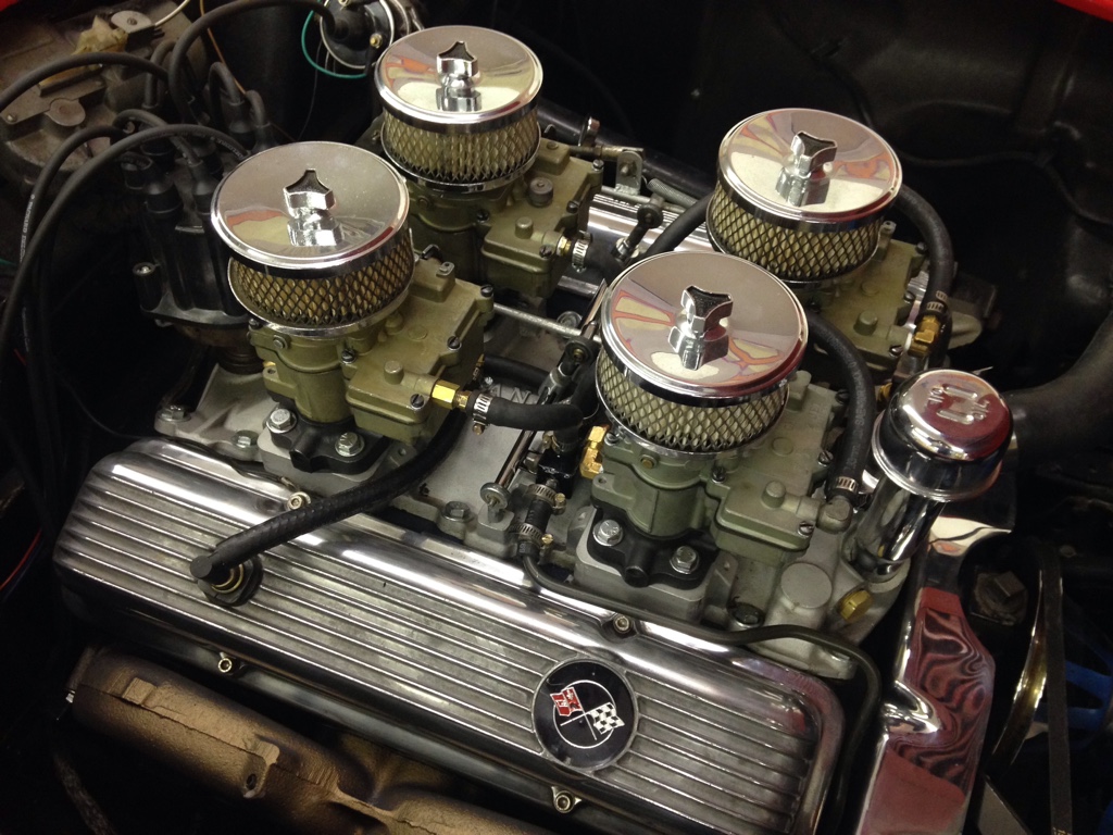

    A lot of people say that modern manifolds make more hp. I put a man a fre on my corvette a few weeks back. I took off an edelbrock street master and an Afb. I have no proof but the seat of the pants feel is like it has 50 more hp with the man a fre. Might be wishful thinking on my part, but I wouldn't go back to a 4 barrel on a bet. Btw, it has a 70 lt1 350 with the off road angle plug heads and I goes damned good ImageUploadedByH.A.M.B.1462926503.130732.jpg

    Compared to a SBC streetmaster, it should, that intake was a real pooch.;):D I have never run a Man-A-Fre myself, but everything I have heard from guys who should know says the Man-A-Fre really does make pretty good power though. It would be interesting to compare it to a Z-28 intake, I would bet that from around 4500-5000, the Man-A-Fre is stronger.

    Anyone have a source for the chrome oil breathers like the one on Moriarity's Man-A-Fre? I've been looking for one...
