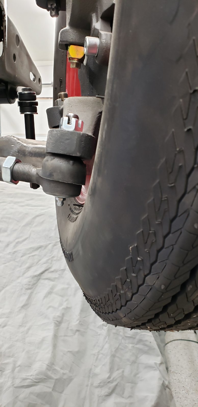

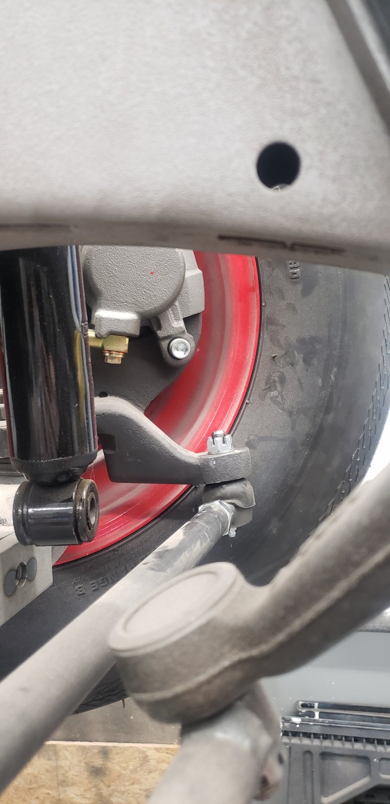

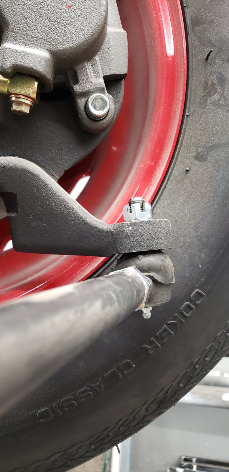

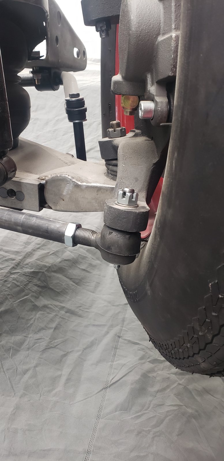

    Gentleman, I am 10 yrs into a 5 yr frame off build and am still only working on the frame! My issue is this: I have 1/4" gap between my front tie rod ends and the tire walls. (there's no rim clearance issues)
    I have one piece 1st gen Camaro disc brake spindles with 2" drop and the beefier upgraded Mercury steering linkage set-up. I'm running G78's on 15" x 6" rims with 3.75" back spacing. I tried 1/4" spacers but that bombed due to lug nut stud length not allowing nearly enough bite.
    Options I've garnered so far:
    1. Keep my G78's and get new 15 x 5" rims that will allow for smaller back spacing but possibly run the risk of fender clearance issues in the future (assuming I get that far someday!).
    2. Keep my current nice red powder coated rims and change all 4 tires to 710-15's which have a narrower width. (those bitches are pricey!!!)
    3. Try to find and replace wheel studs with longer ones that will allow the spacers to work.. That seems like a less desirable "fix" overall.
    Any other ideas or suggestions? Anything I'm missing?
    What is a generally accepted minimum clearance amount between tire sidewalls and tie rod ends?
    Thanx

    ...and post some pictures.
    My guess is that the tie rod is real close to the rim, where the tire sidewall won't be able to flex, so 1/4" gap might actually be OK. But I'm just guessing, because you didn't give us any pictures.

    Fair point:
    20221213_143724.jpg 20221213_143512.jpg 20221212_121837.jpg 20221213_143400.jpg

    That wouldn't worry me in the least. After a spin around the block you'll be able to see if there was any contact, which I doubt there would be, but if so I'd go with a smaller tire.

    He has Camaro spindles, I think they are cast iron, can't heat and bend those. 1/4 inch of clearance in that area should not be a problem, not much or any tire flexing that close to the rim...
