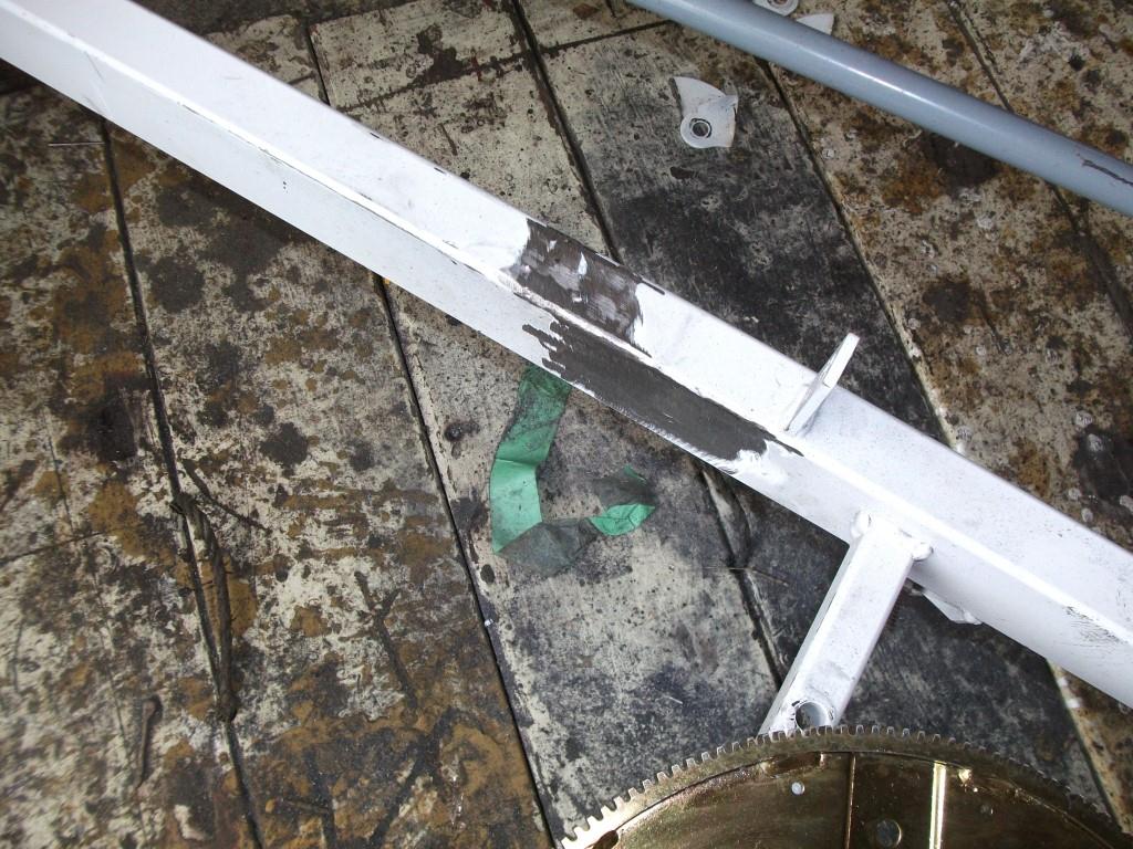

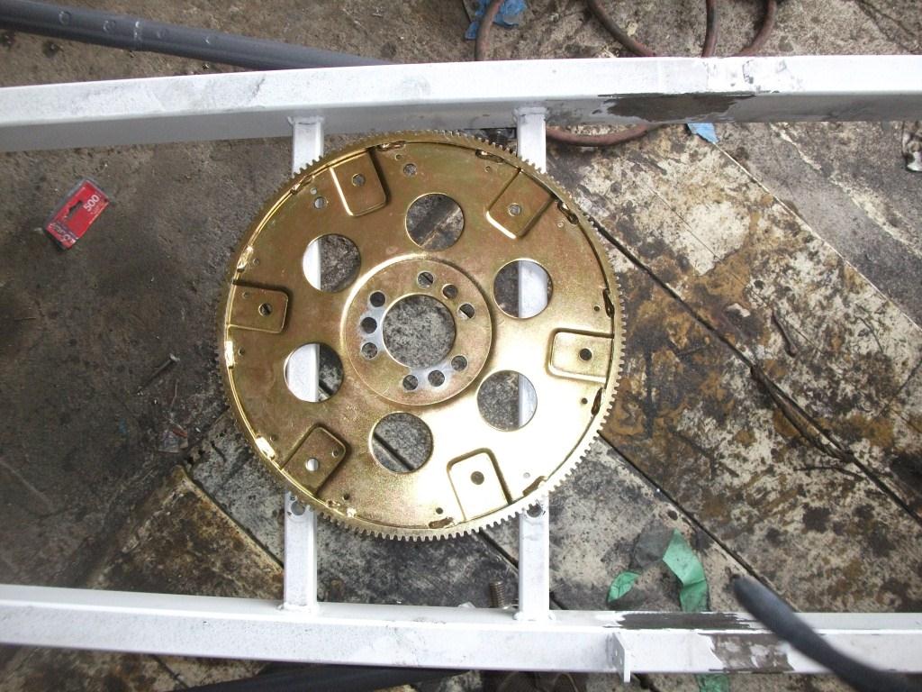

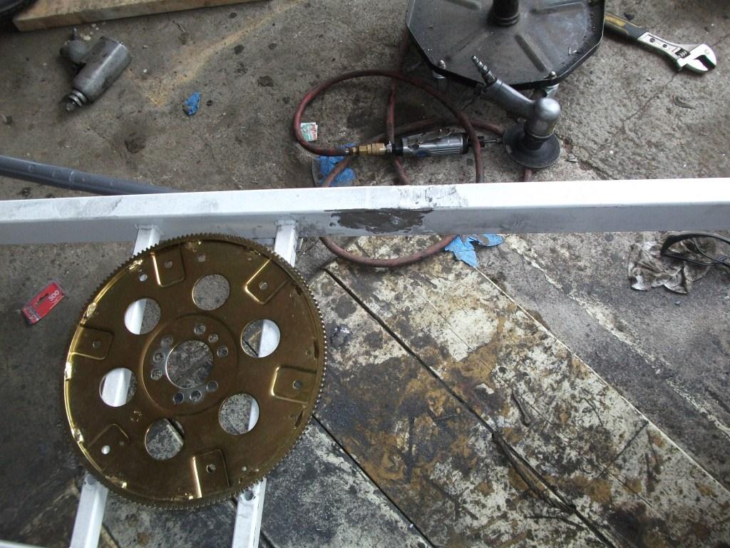

    Well cut the crossmember off today along with a couple tabs(didnt really like doing it) it will be kept and possibly used in the future as may use it as a additional front engine mount support to the boat mount tabs in the front of the engine.
    also drilled the pressure plate to fit with the 1/2 bolts and the 3 dowels turned out good had to clean off the old autodrill.its old but drills really well , just dont get caught up in it cause it will eat you

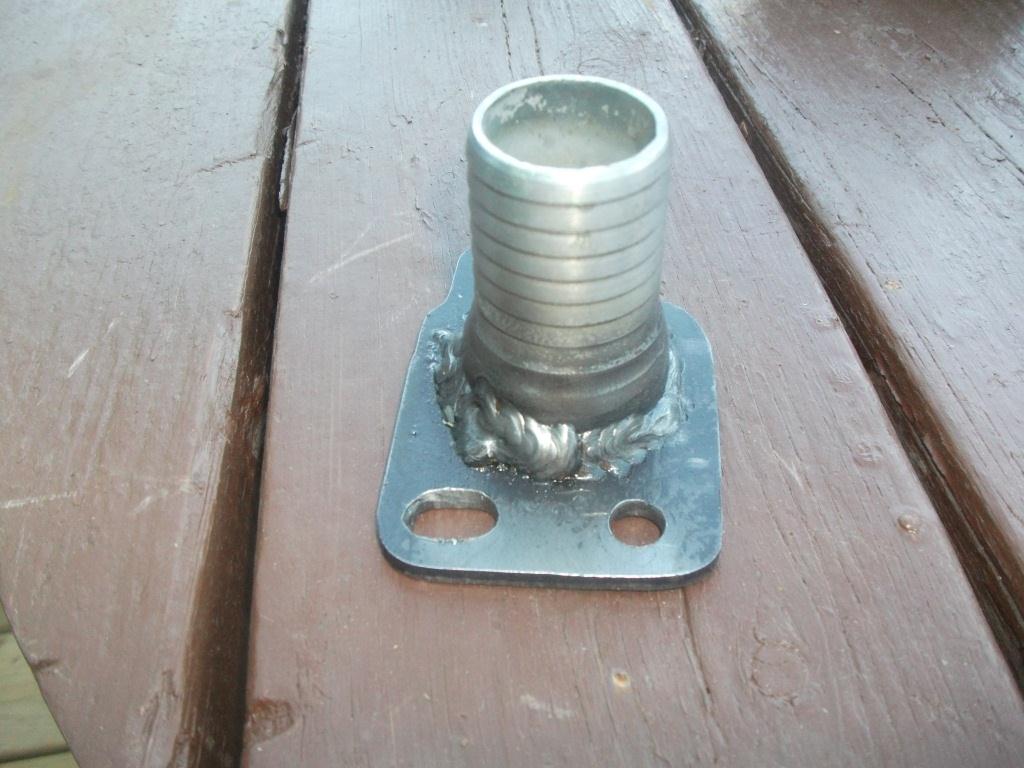

    My dad was around this weekend and helped me move some heavy stuff got a little bit done just for some background i was hurt pretty bad in a motorcycle accident on June 2nd was in ICU for a week smashed up my chest and broke my collar bone cant lift much more and 5 pounds right now as ribs still really sore . if it wasnt for the wife and kids helping me move thngs id never get anything done.

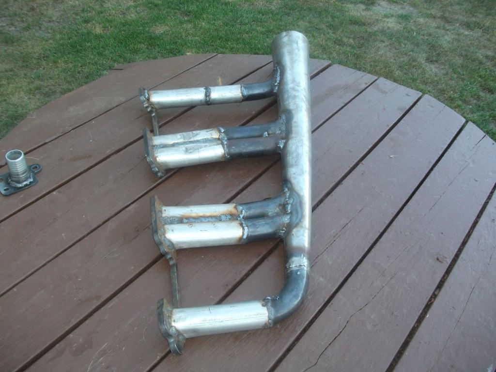

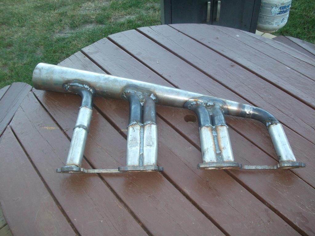

    a themostat housing with a copling to match the little aluminum rad I have and started on the headers.
    dont look too close at the welds i have a lot of grinding to do, the will look just fine once i wrap them with black heat wrap i could not get the header tubes to weld good. too much heat blow through too little gobby , I got them welded up on the head took them off and today did a little grinding and touchup on some parts and they came together about 1/2 to 3/4 of an inch. Should have left them on the head.
    I will have to get inventive to get the front flange back where it was. patience patience

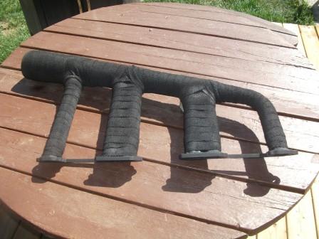

    Got a few more things done , the header is finished and looks real good here are a couple pics one before and after heat paint

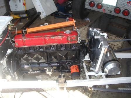

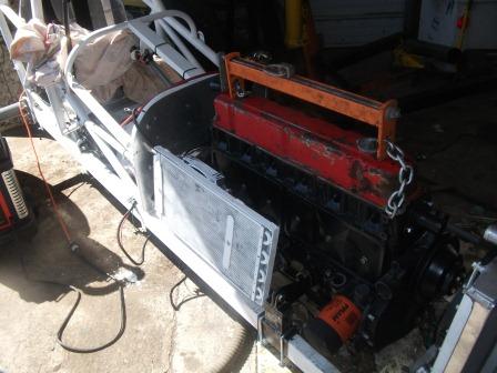

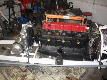

    got the rad and fuel tank mocked up along with motor mounts

    Ya Al, nice to see you back on the thread. Motor looks nice moved forward. How far is the motor/trans holes from the firewall?
    What did you end up with for pan to ground Clarence?

    Sorry old28 diddnt read everything the engine is about 4 inches from the firewall and i have 3 to 1/2 clearance on the oilpan.
