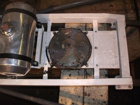

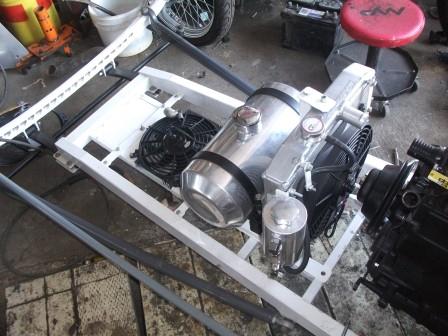

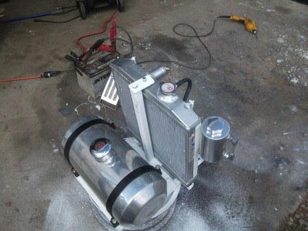

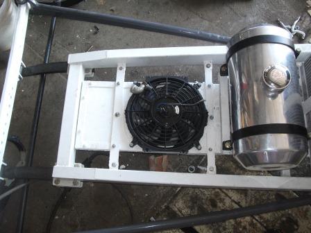

    here are some pics of the fueltank plus the trans cooler mounted

    I like how you have mounted radiator, fuel tank & trans cooler to plates and cross members so you can unbolt and remove them for engine removal.
    Trans cooler looks real nice layed in the front.

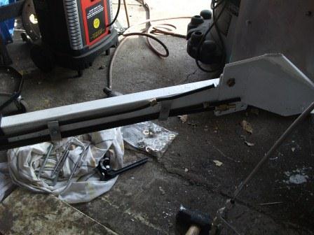

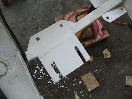

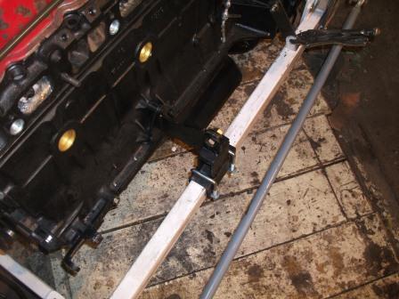

    ch***is is done built the new trans mount made it a slider so i can get the engine and trans mounted easier. also welded 1/4 nuts on the rt inner frame rail so i can make some mounts for the fuel lines and trans lines. started bending 3/8 line for the fuel and trans. easier said than done but will get it accomplished. they will look nice as long as i can get them to look match fairly well

    Good idea on the slider Al, should make install a little easyer. Make sure you have some pictures of the line to frame clamp setup when you get them in.;)

    After taking the ***y in and out a couple times i figured out the slider should work good. Am going to pick up some 1/2 flat aluminum tomorrow and make up some clamps for the lines. have a small tubing bender handle and can get a good radius but cant make it real tight without kinking .

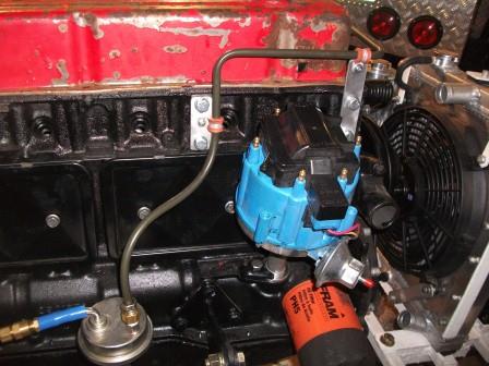

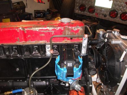

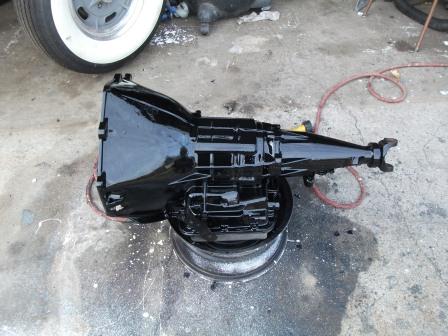

    made some little alum brackets for the steel lines the trans cooler lines turned out good , dont look at the fuel line I will be making another one of those as it was ruined before i got the new bender.

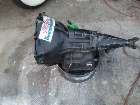

    Took the trans pan off and put a new filter and the deep alum pan on. pan was pretty clean with only a little stuff in the filter. got it painted up and ready to go back on the engine once i get the converter on . Will take a chance on it as is. I have seen a lot worse

    Line brackets look real neat & clean, that should make local tech happy.
    If that is a true "Mike's Transmission PG" should be a nice unit. Their shop is an hour from were I live. I have been running Mike's PG for 35+ years and have never had a failure. Real nice people to work with.

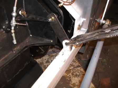

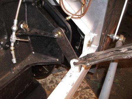

    well helicoil and a bunch of red lock***e to the rescue worked great , got the engine in this morning for the last time trans lines hooked up started work on the homemade midplate braces very simple they will work fine . got my 1 wire alternator and found that it and the alt mount are not friends about a 1/4 out. may just cut the alt back as opposed to building a new bracket as the existing is so nice and clean. my nice br*** wingnuts for the sidepanels showed up will look pretty good

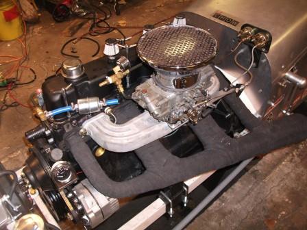

    more progress intake and exhaust on plus fuel lines all mounted got from fuel tank to near carb with only 2 inches of fuel line. Need to get the carb on now as i may need a different fuel log for it as the low profile one i have isnt going to cut it.

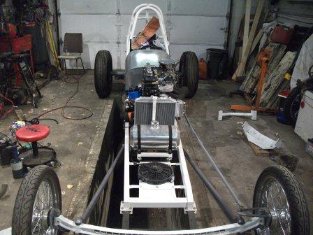

  13. It's looking really good, nice job. I like the tower you built for the radiator.
    I really like the improvements you've made and I'm sure the car will be easier to run, and quicker.

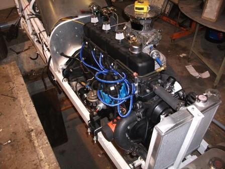

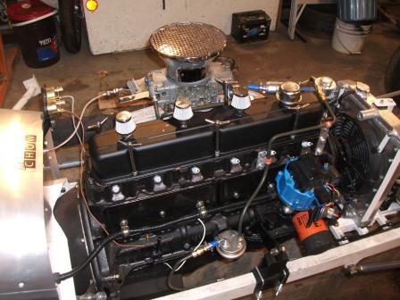

    Made some progress, got the emgine wiring done and a few things ****oned up going to start to tackle the interior wiring. my valve cover turned out pretty good . Got a 6 fuse panel for under the cowl will tacke that next
  19. Old28
    Joined: Jan 11, 2009
    Posts: 1,390
    Old28
    AL, looks real nice, I really like that motor set out a few inches so you can get to bolts a lot easier. Makes for a little more leg room also. I used the same 6 fuse unit and it worked out well. Is winter got a hold on you guys yet?

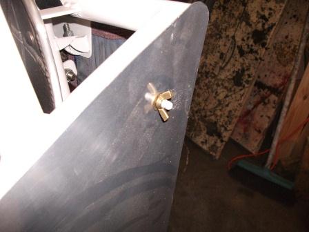

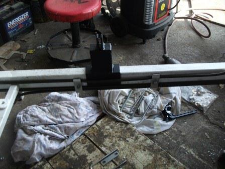

    Worked on the car today we had a quick heat wave today up to 32 f
    Had to cut off my shifter mount off and have to move it up and right against the upper rail . I dont have much room inside the car and since my bike accident I seem to have a lot less shoulder mobility to squeeze in and out of the cage. am going to move my switch panel also to give me more room yet.
    I have to figure out a neutral park starter curcit for the shifter yet.

    Glad you had a chance to work on the car. 32 degree heat wave, you are having a tough winter so far.
    The shape and placement of your cage looks to be a little tight and with your injury I'm sure it is hard getting in & out of. Maybe when you get ever thing moved it will help. Keep at it, I know you will figure it out.;)

    got rad hoses and plug wires on the engine wires look a little snakey, have some loom ideas in mind.
    also screened the front trans cooler fan, have seen a few of those get wrecked from a pebble being thrown up and falling in the blades ruining them.
