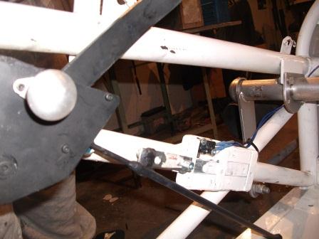

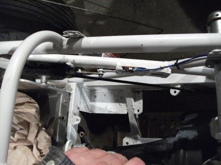

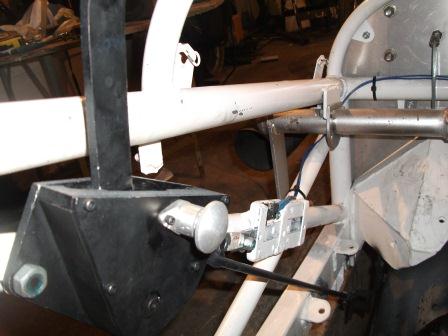

    Made some progress during a little heat wave here. Moved the auto shifter from the rt side to left side plus converted it to a manual rod shifter direct to the transmission. Also made a neutral/park starter lockout setup that attaches to the rod . It all works real good.Am going to build another shift rod as the 1st was a scab together unit to see if he thing would work. Got some more wireing put together also

    Take a few pictures of the new shifter setup when you are done, would like to see how you did it. Sounds real nice and no cable.:)

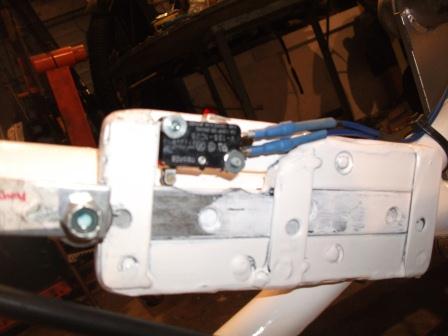

    It works really good and does not bind at all, the rail slides in a slot and then i marked off park and neutral so the micro switch is acivated on those spots . Like i said I am going to make up another shift rod with a heavier rod that goes inside the shifter. For this one i just used the end of the original cable rod which is a little light. Its very simple but works.

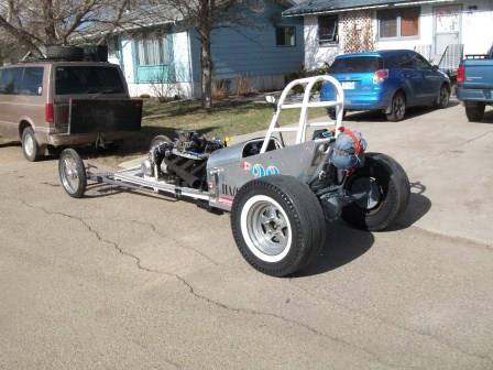

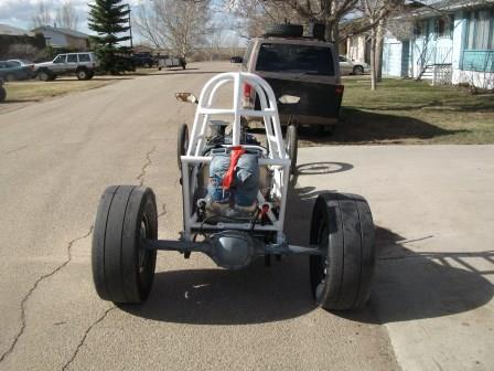

    iTs getting warmer worked a bit more n the car

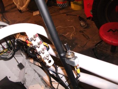

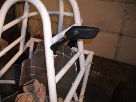

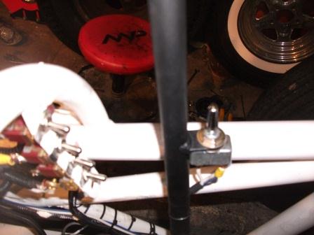

    After speaking to another dragster owner put some motorcycle mirrors on the car yesterday afternoon and finished up most of the wiring. Put a trans brake switch in also lower down on the brake lever am goingt o see how it works once i get a trans brake.As i am going to to race the car i might as well put one in.
    Now to modify the bottom ****ter shield to fit the powerglide. I think it would be good to have it.

    Car is looking great. I use a push ****on micro switch for my transbrake cars. I generally put them out of the way so the can not be activated down track. I know a guy who put it on the shifter knob and got a nice set of seatbelt stripes when he activated it getting ready to shift. Not knocking where you have it but I would hate for that to happen to you. It could sure make a good day of drag racing bad in a hurry.

    Yeah I kind of thought that too about accidental activation but it is pretty low on the handle. I am going to try it there and see how it goes i actually thought of putting it lower still on the handle . I am trying to find a comfortable place. Got the flywheel shield put together turned out well. paint is drying.

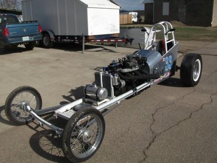

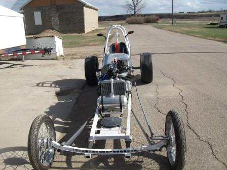

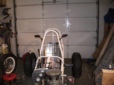

    trans is in and ****oned up picked up driveshaft today, built another armoured battery box for the car as a spare that would fit on the back above the diffy. I designed it as a bolt on . I am leery about the starting capacity of the 375 amp optima. I am going to go the optima but will keep the other box in the wings jut in case. just a few more things before i light the thing up spring is here now finally :)

    got it up and running today set valves and timing and ****oned it up. Like the holley double pumper really good trottle response jetting seems good only issue i see is i have only 3 lbs of fuel pressure (a little on he light side) seems to fill and operate fine but will see on a 1/4 blast. Have a few wires to get tied up and a few little things to do but looks good . sounds awsum. Freinds down a few blocks heard it fire up and were over lookie looing.
    It sounds like a old fighter plane at certain rpm an nice deep drone .

    Al, that is one fine looking ride. I know the weather is still bad back your way, but when do you think it will be on your local raceway? I love the pie crust slicks. I talked to Skip a lot about that engine and piston combination and will be very interested in your run sheet times. Let us all know when you make your first p***es.:D
    You need to get a photo into (old6rodder) so he can put the car in the HA/GR & SDRA Photo Thread.:) You don't need times to start, he will update them as you send them.;)
