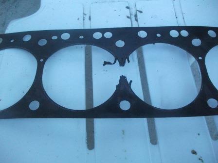

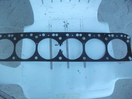

    I seem to have made a mistake on the head gasket as I did not not retorque and the manual says after a heat cycle to do so.
    3 and 4 have little to no comp think blown in between will tear it down this week and hope nothing else

    I had the 8 inch pie crust tires on it, they are not as sticky as my Hoosier but still pretty good I have a hd gasket ordered (should have been there to start with) as per the books recommendation and will retorque it this time. 1.70 60 ft times .
    Up here in the Hinterland sometimes getting parts like a hd 6 cyl head gasket takes up to 3 weeks. Hope its here sooner am going to get some smaller jets too as have 63s Front in it now and it still is rich but getting better.

    so that's how to blow a head gasket;)
  26. RoadRunner5
    Joined: Jun 5, 2013
    Posts: 76
    RoadRunner5
    That's not very pretty, I hope that it did not hurt the iron?
  27. canadianal
    Joined: May 15, 2012
    Posts: 164
    canadianal
    from canada
    nope looks fine
