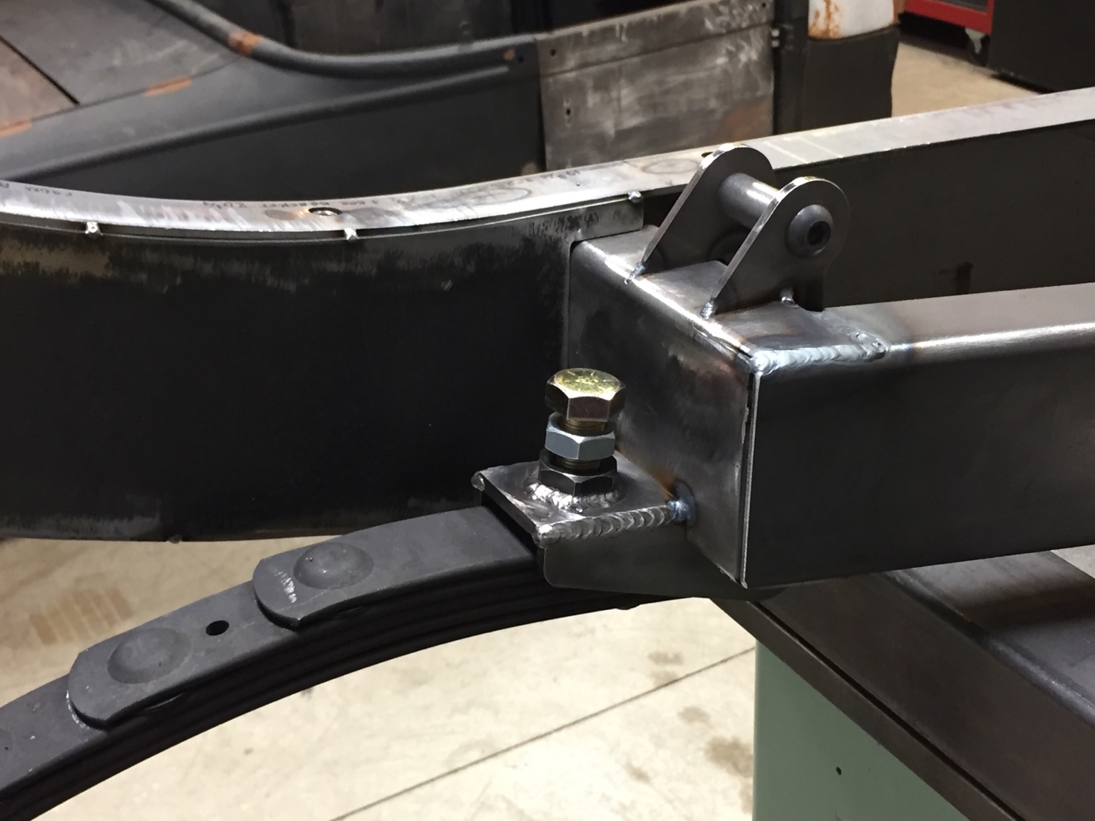

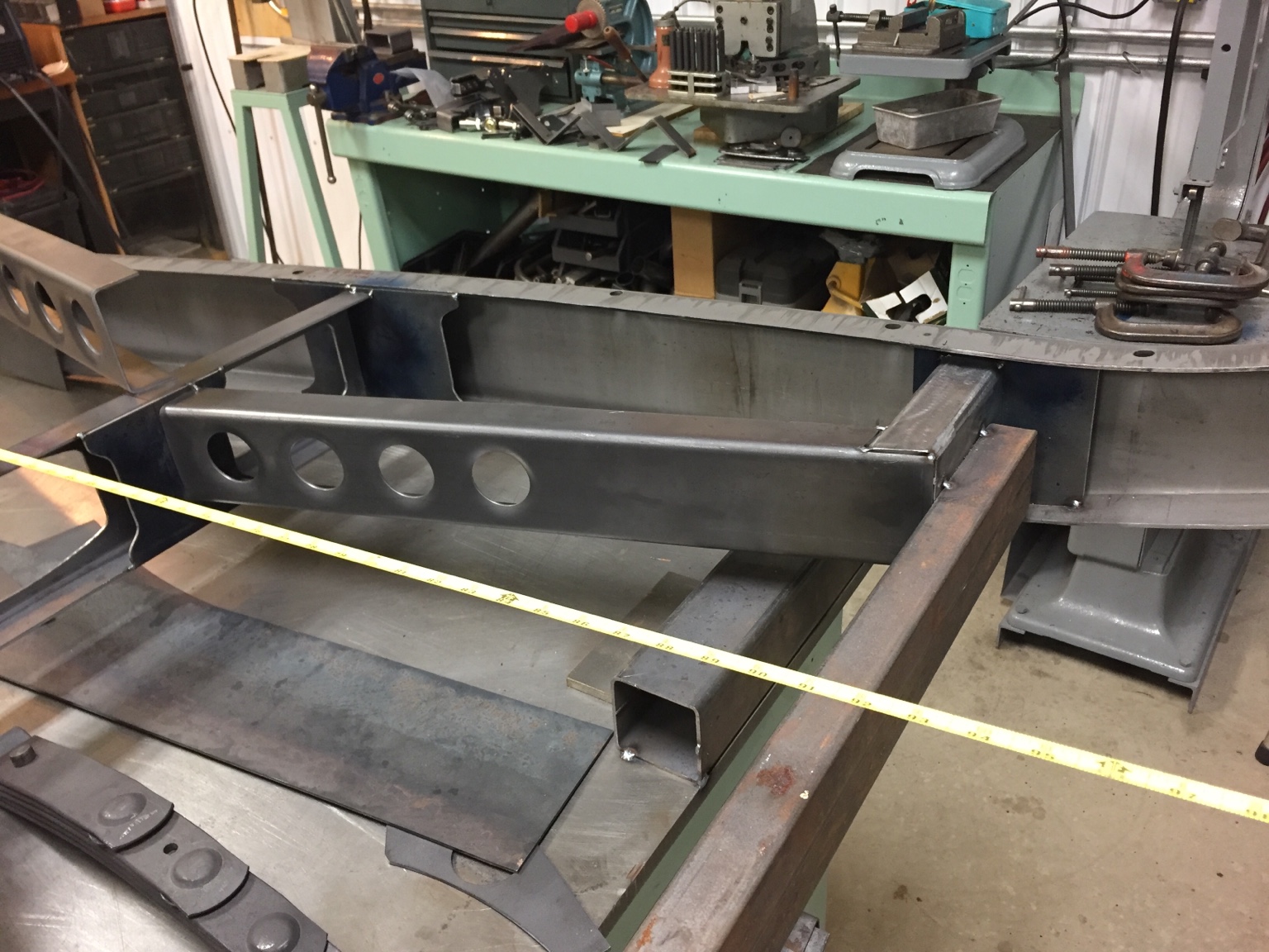

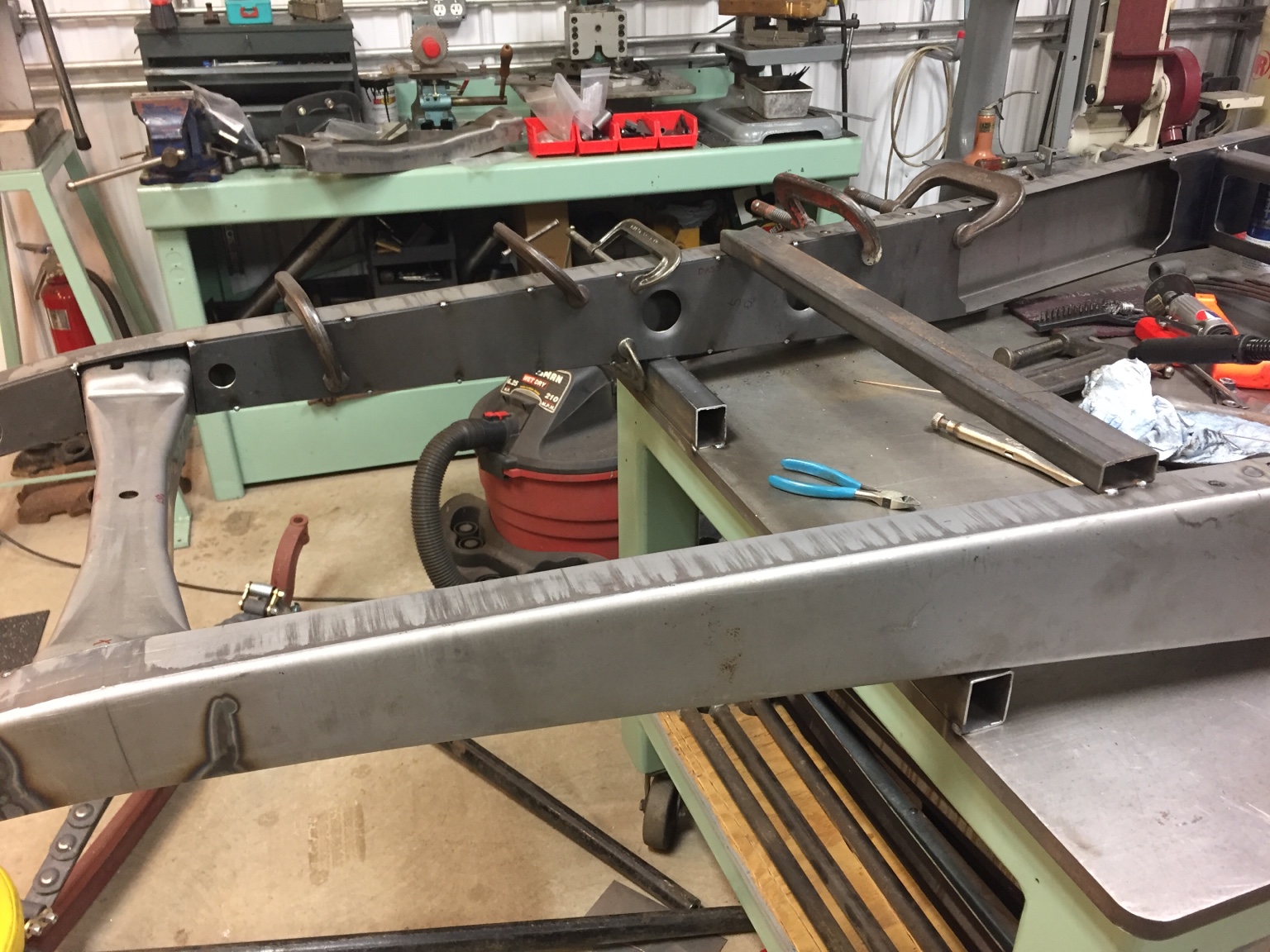

    .....slow but steady. I didn't like the crossmember that was tieing the spring pockets together. So I tacked another tube in to hold it together, and cut it out, and replace it with something a little more fitting style-wise.
    I made some boxing plates for the mid crossmember, got them tacked , and I have the rear legs fitted and tacked in place. Dimensionally thing are coming out nice.
