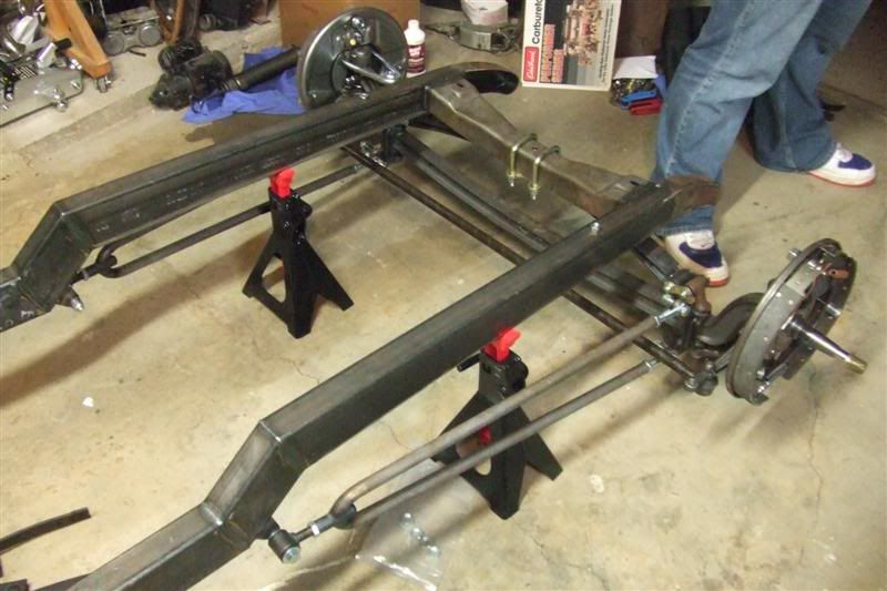

    OK, got some work done tonight.
    'Gotgas' came over and we took some leaves out of the front spring so we could compress it with minimal effort, mounted the spindles and set the frame to ride height, measured and got everything squared up, and made templates for the hairpin mounts.
    Tomorrow I'll CAD my hairpin brackets and have a friend in Lubbock CNC plasma cut them and hopefully get them to me by Sunday when I get back in town.
    Sunday, if I get the brackets, I should be able to finish up the front end, minus wheels and tires.

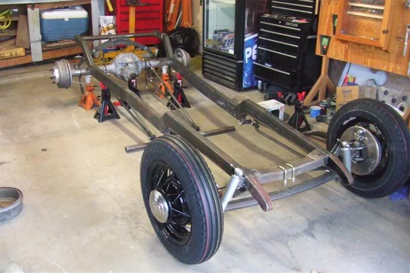

    Cut down the P&J mounts and got the front end tacked in place. I just need to pack the bearings and put the hubs on... once the wheels are powdercoated the front will be ready to put on the ground.
    Oh, has anyone seen my rear spring u-bolts :eek:
    - Matt

    The front still needs drums but they are on their way. Other than that, steering is about all thats needed.

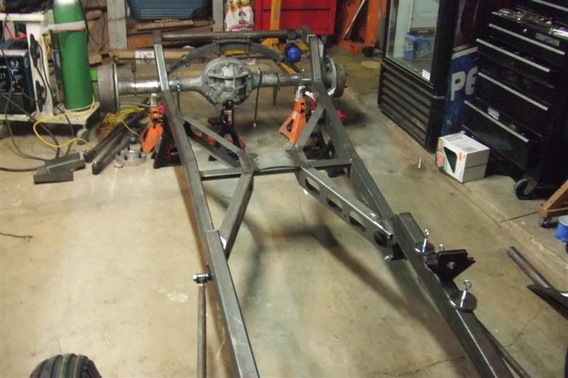

    The rearend has been blasted clean, and I cut off the old leaf spring perches and shock mounts. I got the 4-link and spring brackets on (but not mounted).
    My rear wheels have been widened and are in transit back to me (will be here Thursday). I am also waiting on the Dagel's crossmemeber. Once those two things get here I should be able to get the rear suspension and all bracing done.
    - Matt
