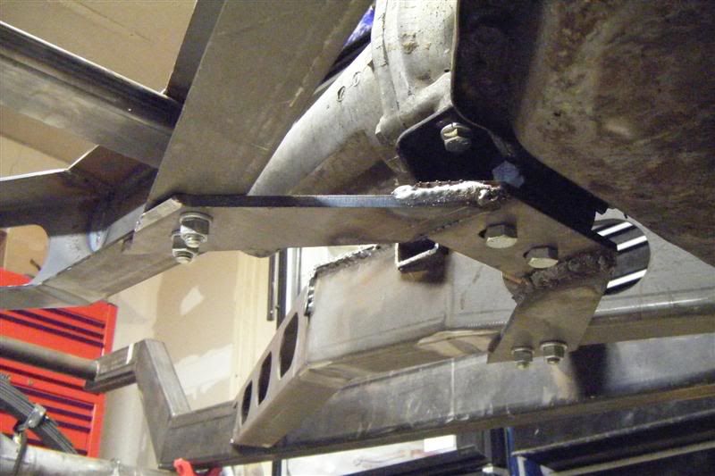

    When mounting the ladder bars, what kind of angle should I be looking for?
    I have the P&J ladder bar crossmember, but with the X that I am using it would involve a lot of cutting, notching, etc. I am going to try to come up with a more creative way of mounting the front brackets.
    How close together or far apart should these front mounts be?
    They should be close to level with (or maybe just a little below) the ****** output shaft, right?
    - Matt
  20. Rusty
    Joined: Mar 4, 2004
    Posts: 9,487
    Rusty
    Pete and jakes set theres up with with about a 4 degree rise slightly up hill. You can set them up however you wish. Try to keep them as close together at the front as possible without interfering with your driveshaft and farthest point (wide) on the rearend you can live with without any frame issues etc.

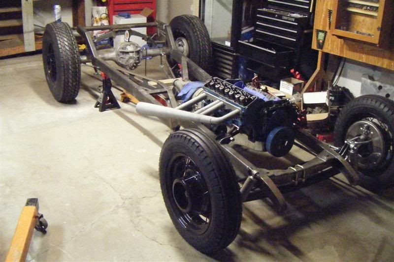

    Sooooo close to rolling... Got the front drums today, mounted the rear spring perches and gussets, hung the rear on the spring.
    Still need those damn ladderbar mounts though :eek:
    I think I know how I'm going to do it, but I need some metal first... that might be an issue.
    Damn those rear tires are big :eek: :cool:

    Guess what... NO JACKSTANDS! :cool: :D
    This mother rolls!
    It will have its first "roll out' tomorrow, but for now here are some pics of the ladderbars. I notched the X (a little too much, but I'll fix that easily :eek: ) and the ladderbar crossmember sits right up under part of the X.
    Better pics tomorrow! :D
