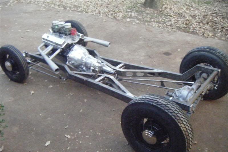

    Yeah, I'm excited as hell. :D Here's another pic. I'm headed back to the garage.

    Man those tires are killer where did you get them?
    Mark.

    Fronts are 5.00-16 "Ribbed" Firestones - Link
    Rears are 8.90-16 "Grooved" Firestones - Link
    Got them from Coker. 10% discount for Alliance members.

    where did you get that x member?...or did you fab it?

    I wish I fabbed it. The time crunch forced me into buying a lot of parts I would have normally tried to make myself.
    I have already planned another build in my head (roadster) and on that one I will not have a deadline and I'll take a lot more time and fab everything I can.
    Sorry... got distracted. LOL. To answer your question it is a "Super X" crossmember from Dagel's Street Rods. http://www.dagelsstreetrods.com/super_x_crossmember.htm

    hard to tell, but what kind of clearance do you have between the rear tires and the body?? looks a bit tight there in the pics

    Any particular reason (based on functionality, not asthetics)?
    I am not fully committed yet (90% sure though) and I think I have a few months before I get into any sort of body work, but my ears are always open to tips.
    It's tight! There might be 1/2" of clearance. I have a pair of Wheelkid's adapters (not spacers) on there. I'm going to get in touch with him soon and see if he can make me another pair, but about an inch thicker this time.

    youch! 1/2" is way tight. 1.5" still might rub on the quarter. panhard bar in the back might help ya keep the tires off the quarters....

    HA! Turns out my 1/2" guess was way off!
    I just went to take another look when I was home for lunch.
    Yeah... I'll deal with that soon :D
