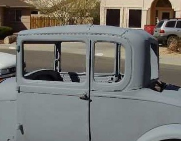

    I was taking a closer look at your body and I'm not sure that it is a Special Coupe. These cars have a unique roof with recesses for the trim (see attached picture) that I can't make out in the pix. You could certainly add the leatherback to a Standard Coupe, but it was a unique body.

    Somebody filled all that in - with bondo. lol
    And shaved ONE of the drip rails...

    OK, I see it now, no body line around the back of the roof!

    Yeah, like Gotgas said, the driver's side of this body has been "shaved and filled"... if you can call it that. The p***enger side has the stuff you're talking about:
    It will be an adventure, and definitely a learning experience, when I dive into that mess!

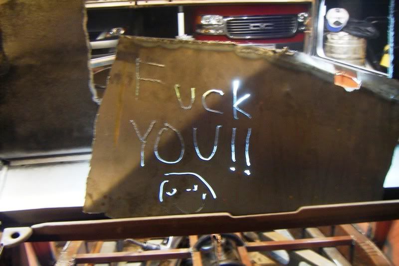

    Last night we started cutting and notching to mount that and then got a little sidetracked. It started with some small cuts then we had to take out some bigger pieces... then I finally decided I wasn't a big fan of the floor to begin with so we just cut it all out :eek:
    Look at all of that damn bracing under there! When I redo the floor it will be thinner than what I took out and probably have some beads rolled in it.
