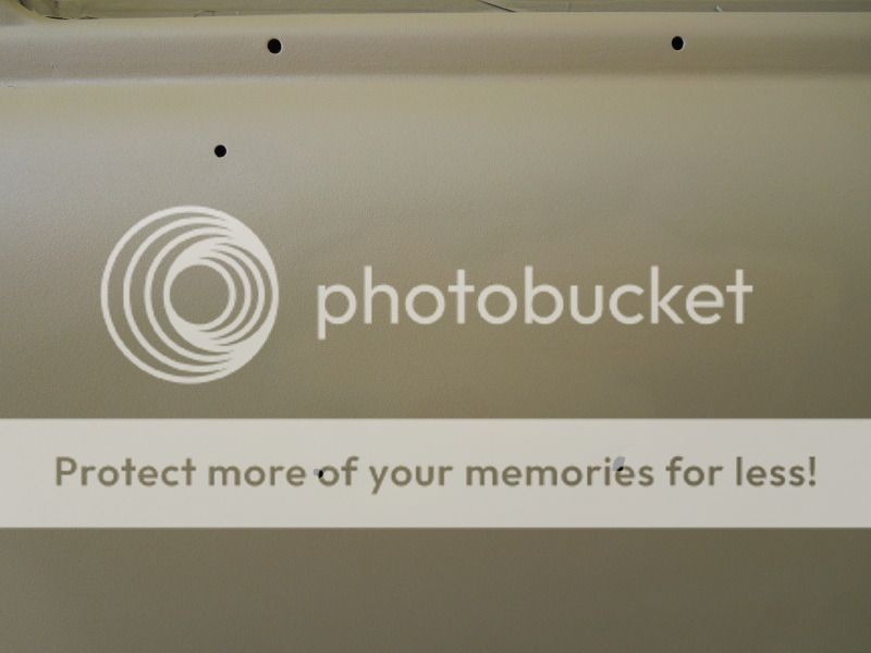

    Well after i got the patch finished I started on the other side, I ground out all the old body work. Looks like sometime during it's life it was sideswiped. I didn't see that on the carfax.
    ..[​IMG]
    I redid the door and 1/4 panel.
    Primed the 1/4, doors and trunk lid this morning. Used a product called Z-Chrome...Wasn't anything like on TV......Wasn't anything like I expected. I put on three coats and used 3 pints... I can still see through the primer.. It has a LOT of orange peel
    after it dries I am going to block sand it and see if I have any imperfections. I see one already and after I repair that and any others, I am going to scuff it up and reshoot some more.
    The sun came out and the humidity dropped, so I just rolled it outside and shot it put there.
    I have no experience doing any of this, First time I have ever even used a spray gun..... I don't get it, on tv they have the car ready in an hour..:rolleyes:
