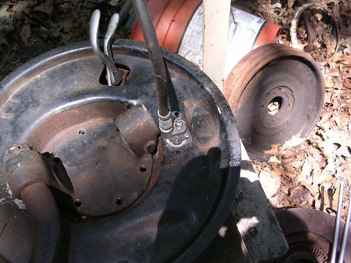

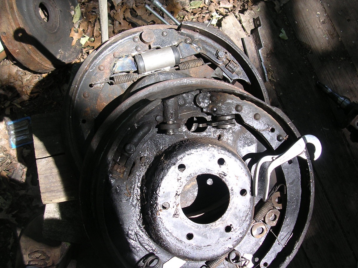

    I never did a Ford mech to hyd, but I just did a weird one and the freaking thing works awesome so far.
    The only reason I post this is to inspire others to try stuff. Please don't give me the "don't experiment with brakes" because you ain't me,...or.... stay out of my way :)

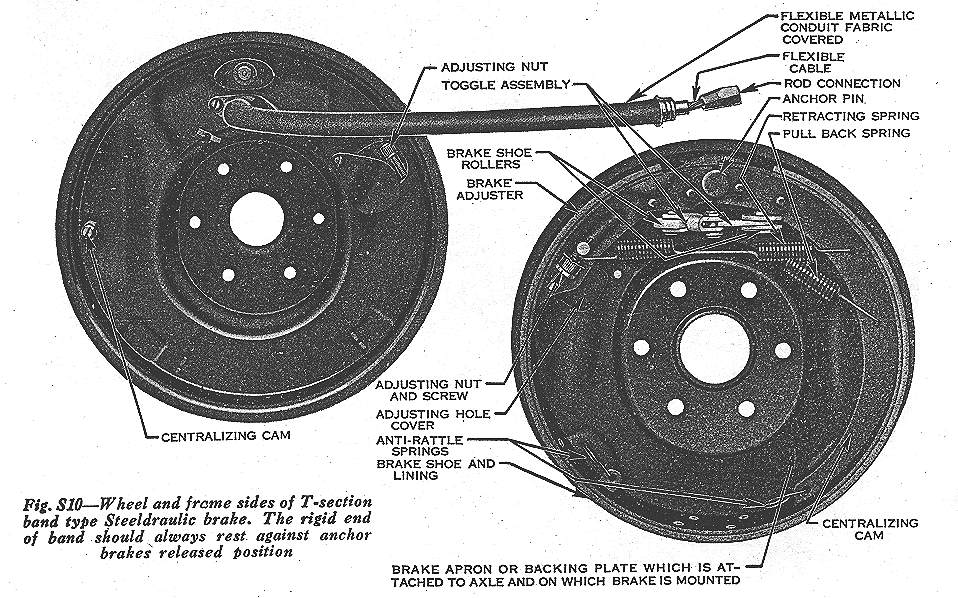

    Late 20s to early 30 Midland Steel Company, made "Steel-Draulic" brakes. These are armored flex cables at 4 wheels, run by solid rods. They are the first? self-energizing brake. They are one large circular internal band shoe. 12" drum x 1-3/4" shoe width
    My antique car had 4.73 ratio which is good for 40mph. I could not change the chuck, so I used a 65 Mustang 8"..... so that I can go 55-60 ... (that has 10" drums).......
    I needed to keep the fancy wire wheels and the drums which show, so I had to convert the fronts to hyd. The Midland backing plates have a raised center, and there is almost no room for a cylinder. The only one that I could fit with a small bolting pad, was 80s Honda rear cyls which are 3/4" bore...
    ( I could not "make more room", because look at the backside showing how close the new cyl is to the king pin boss on spindle)
    I was sure 3/4" would not work, but no choice except try it. The car stops better/faster w/ less pedal pressure than my 32 ford with 40s fronts and 55 Olds rear brakes.
    I had to buy an old pair of "Steel-Draulic" brake adjusting pliers on ebay. less than 20 shipped DSCN0600.JPG dscn0602.jpg Image53.jpg
