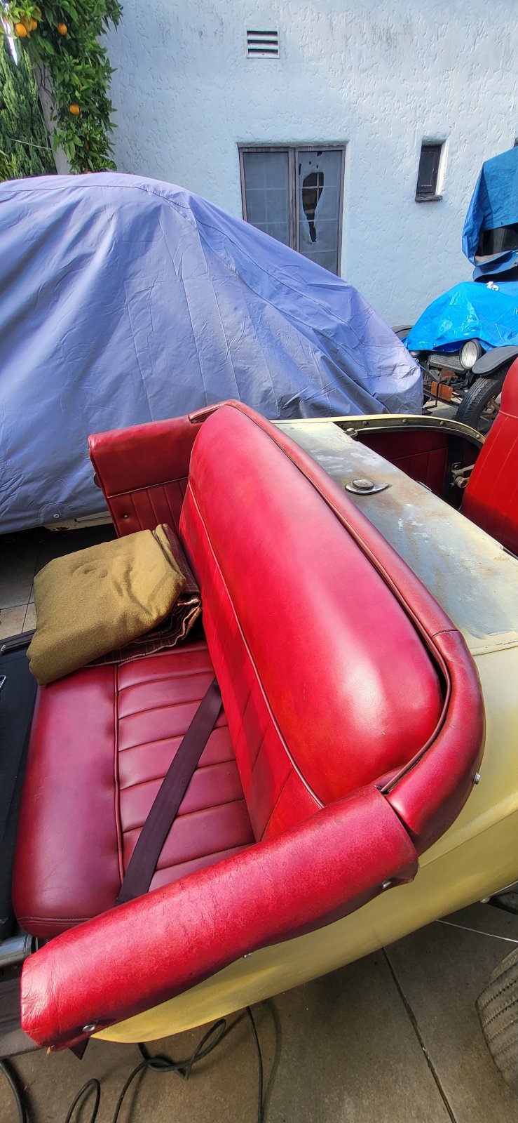

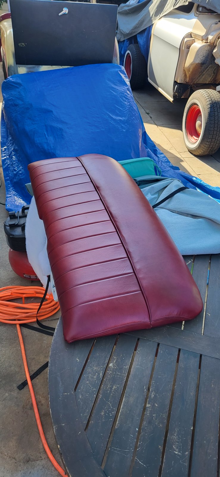

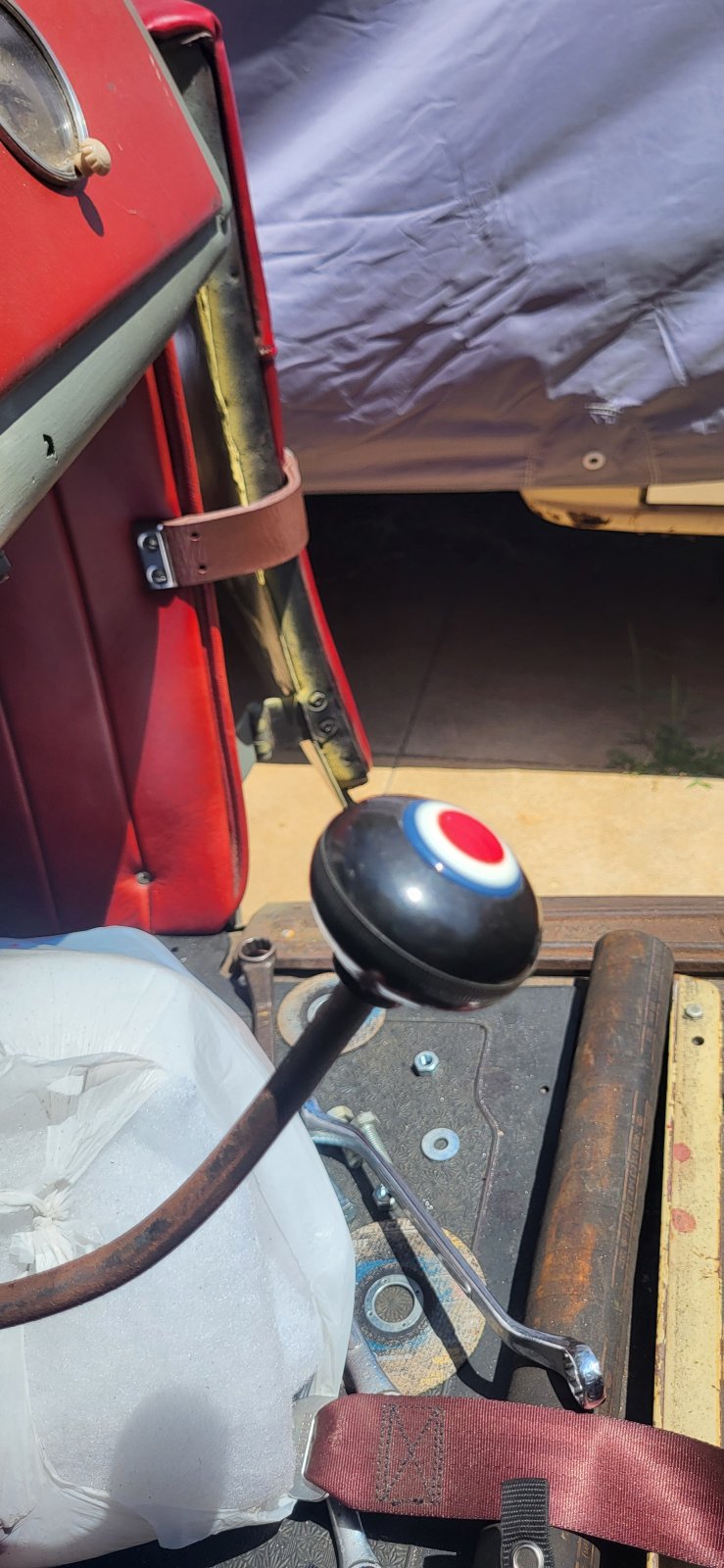

    So, Im back working on the hot rod again and I did a few more things that I've been meaning to do. I put a piece of angle iron across the floor to keep the seat bottom in place, mounted the seat belts and
    I finally finished putting the wood body blocks in, so the body is now officially mounted on the frame! It was a P.i.t.a. and I had been putting it off.

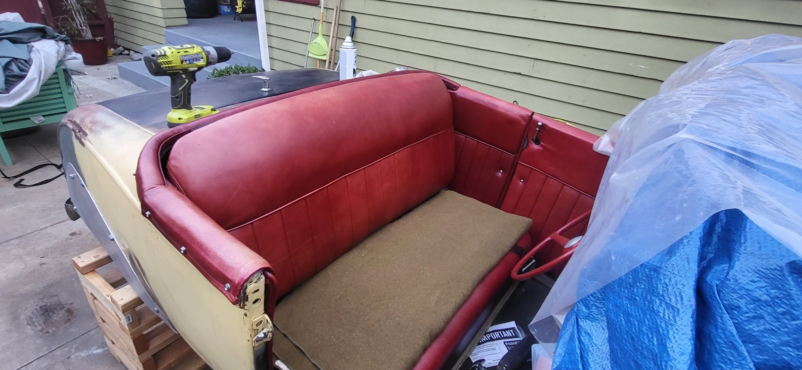

    Also, now that things are more "together", I was able to sit in the car and start to mock-up the steering wheel.
    I admit I kind of screwed up and the back of the seat was too thick. Im a bigger guy and the steering wheel was almost on my chest. So, I decided to make a thinner, plywood seat back so I can sit a little more reclined. I tried chasing down the upholsterer for a week or so, and I finally just decided to do it myself. You know what they say...If you want something done right!
    I bought a Harbor Freight Staple gun for like $30, and it's the best tool I've bought in a while! Totally worth it.
    I was able to re-use the upholstery from the springs and it actually looks really good IMO.
    Also, the rear end is getting re-built now by Dennis Lacy and it should be really nice. I sort of committed to that level when I did the front end.
    That will be huge when that's done, as it will be a roller. It will be all downhill from there!

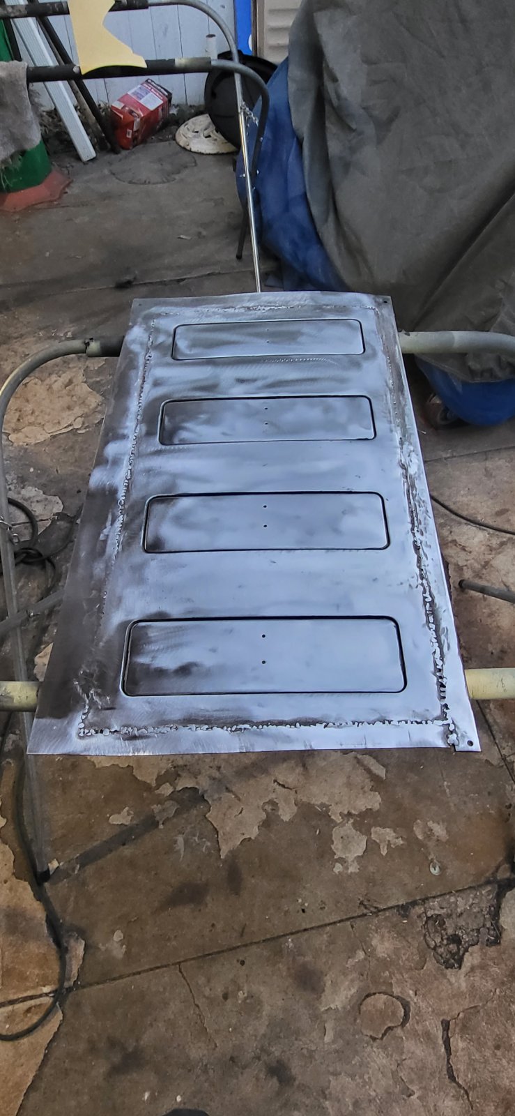

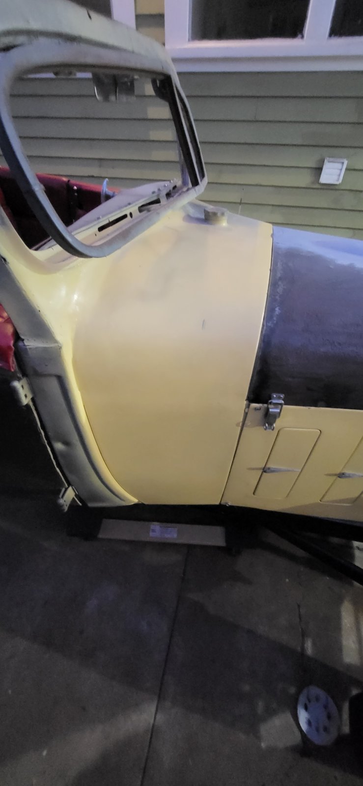

    I finally got around to finishing up the hoodsides. It was a sh@t ton of welding and grinding, and hammer and dolly work. It's far from perfect, but looks pretty good from 10'. I probably should have waited until I finished the hood top because I already scratched them up, but my goal is to get the front end ****oned up and "finished" before I go back to NM next week. I figured I will work my way to the back...
    I also put in the cowl lacing and 32 radiator shell lacing. There were some good threads here on the HAMb
    I also finished welding/ filling in the cowl gas tank. I had already done the other side, so at least it matches now.

    The hood was kind of a pain. I needed to put a little blister in the hood where the carbs go. I was going to use an air scoop thing from a vintage speed boat, but my buddies laughed at me and talked me out of it. they said I have 'a lot going on' already.
    I remembered so cal speed shop used to sell the blisters too, but I looked into it and they were way too big. So I figured I've already done everything else the hard way so might as well just make my own blister. The old school way, 'just like the 40's' bro
    I also made it through the entire "homogenized hot rods thread" and saved a ton of inspiration pics!
    Here's one I saw of it filled in 32 shell. The radiator shop must've moved the filler or something on the top tank, so I couldn't run a regular radiator cap, and I'm going to have to move it inside anyway, but I want to run a special hood ornament. It's kind of an inside joke with my buddies and I'm trying to win it on Ebay. But I filled the top. Came out ok i think.
    Also, I should have done this in the first place, but I bent some flat bar straps to match the cowl and radiator shell. I then clamped and welded them to the hood. It really helped 'stiffen' things up. It still needs some adjustments, but I finished putting on the toolbox latches, and it actually clamps down pretty good.
    Should work out fine...hopefully it won't fly off on the freeway or something.

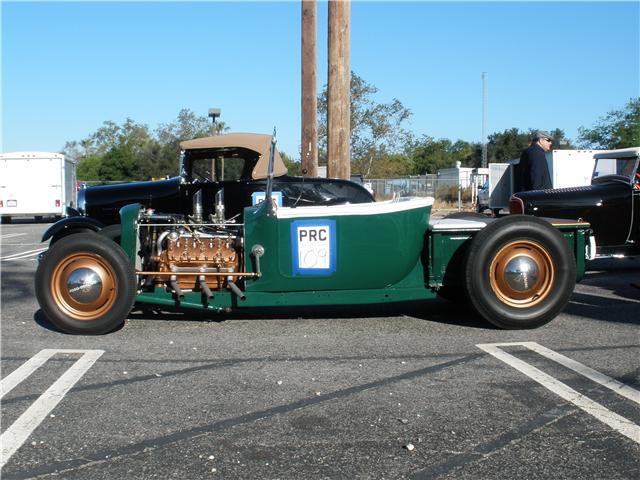

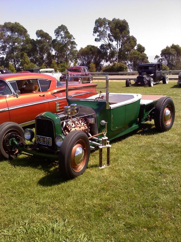

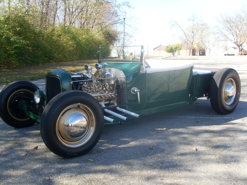

    I sold it to Marcus Edell up in norcal in 2010, and from there it went up to Tacoma? Then I heard it was in the south, like Mississippi or something? But I lost track after that.
    I bought it from Jimmy the Perch as a roller, and finished it and got it on the road. I saw they chopped the windshield and did a few minor changes along the way and it won a couple trophies. Sure miss that car, lots of good times, and lots of lessons learned on that one...

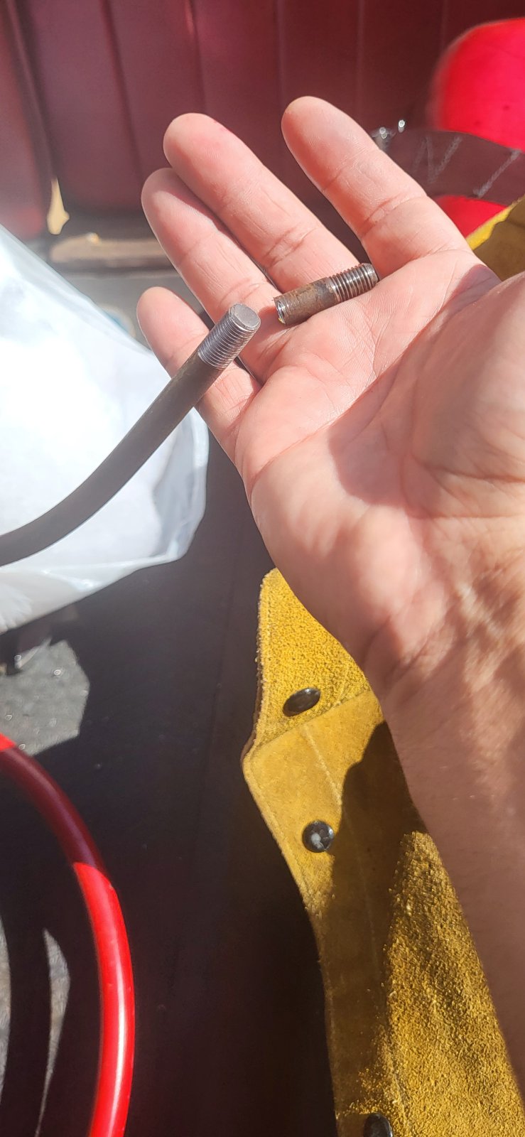

    Curious what you did to replace the springs that hold the small top marker light lenses on? Those seems to almost always be rusted and disintegrating. I'm trying to find a rubber ring that's just the right size to replace the original springs.
    Stogy and OLLIN like this.
  15. OLLIN
    Joined: Aug 25, 2006
    Posts: 3,150
    OLLIN
    So, I went to auto zone and bought the little ***orted spring pack they sell. There were some that were too big, and some too small. I ended up using the smaller spring and it fit inside of the old broken spring pieces. It should work out fine...

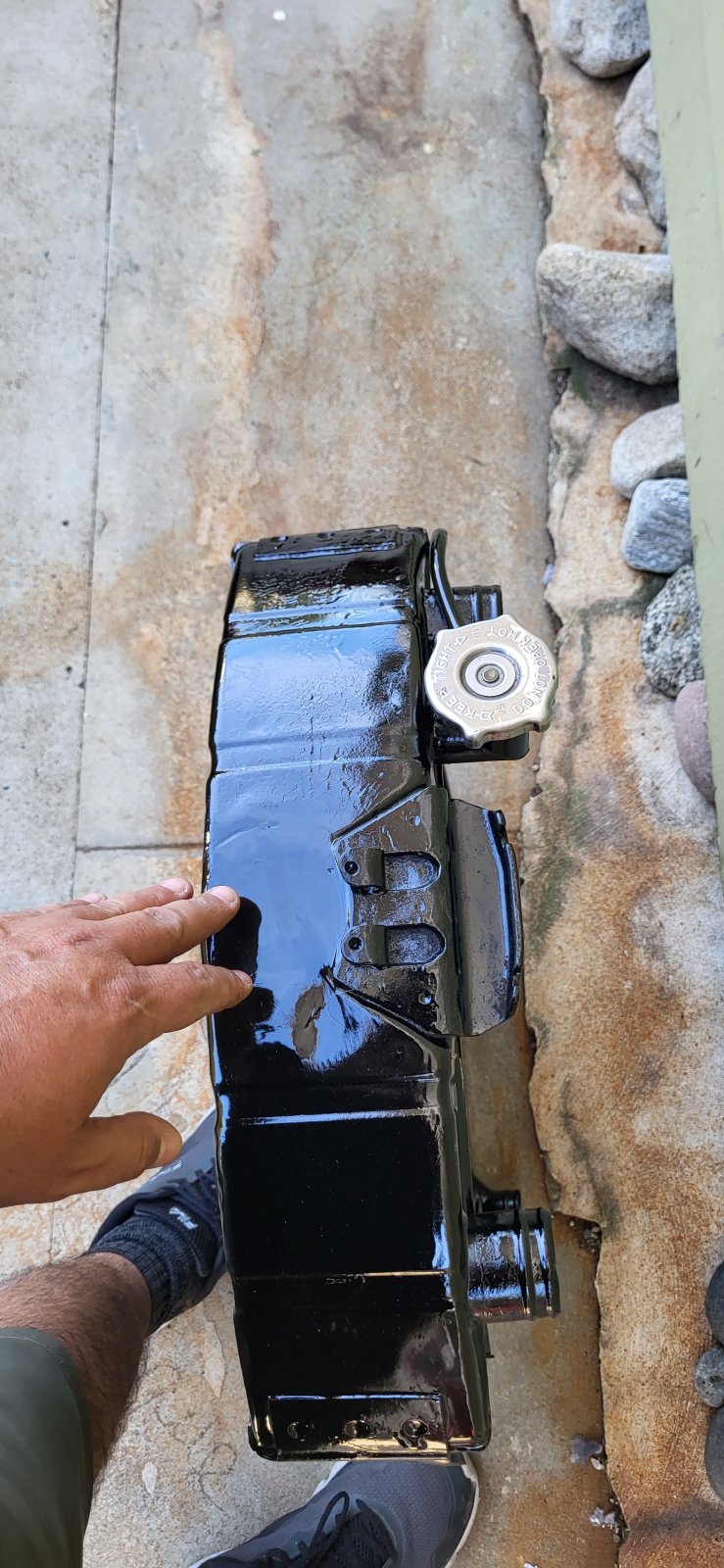

    I got around to taking the radiator back in to the shop to move the filler neck. Should be good to go now.

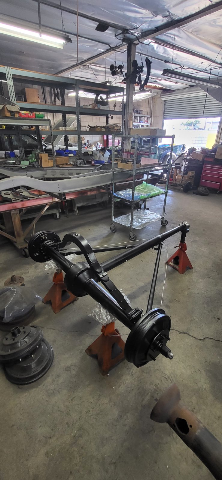

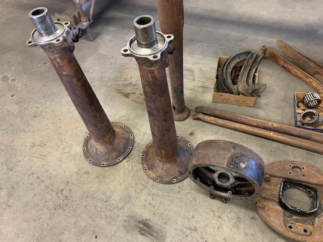

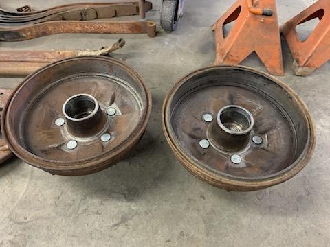

    Also, I picked up my rear end from Dennis Lacy. He did a great job, ot looks like new!

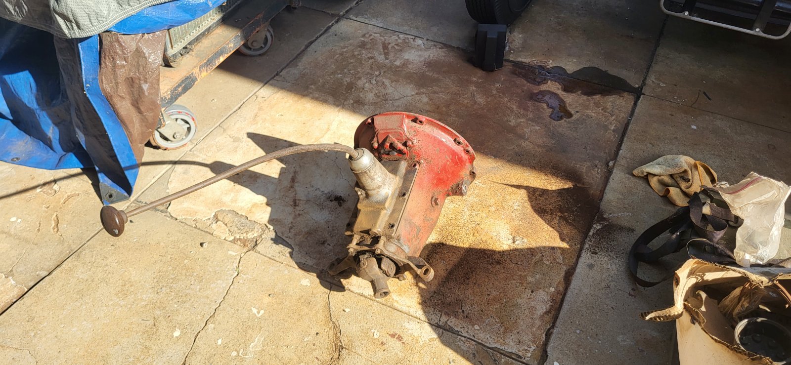

    So I dragged everything home and was going to put it all back in, but I got to thinking ... I kind of don't feel like figuring out the column shifter linkage right now. I just want to get this thing on the road asap and work out the bugs. I still have to do steering, wiring, fuel lines, brake lines etc. So I have another top loader I wanted to use. I pulled the engine and started to swap things out from the other transmission and then I noticed some broken teeth I had missed!!! F*****ck!
    So now the car is all blown apart in my mom's driveway and I was supposed to be leaving in like 10 days.
    So now I either have to find another toploader or take the gears out from the other side one and rebuild the toploader, or find another set of gears. Or I may just put it all back together and still have to deal with it next time I come and pull the engine/Trans again. I'm still deciding.

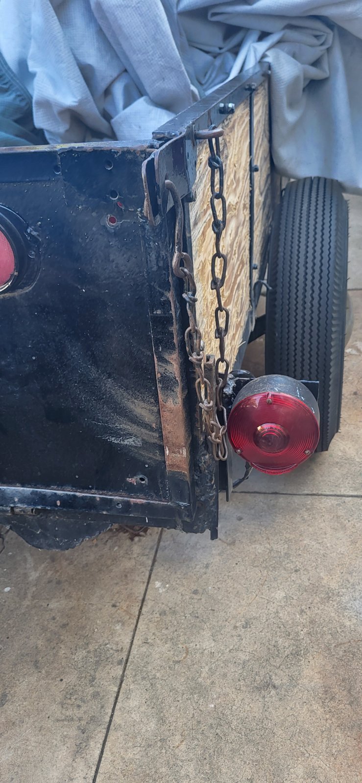

    Oh, and I figured I would fill that hole in the firewall where the heater hose thing was. I did it really quickly but it came out OK I guess...
    And I had to replace the lens on my trailer light. I broke it backing into the driveway
