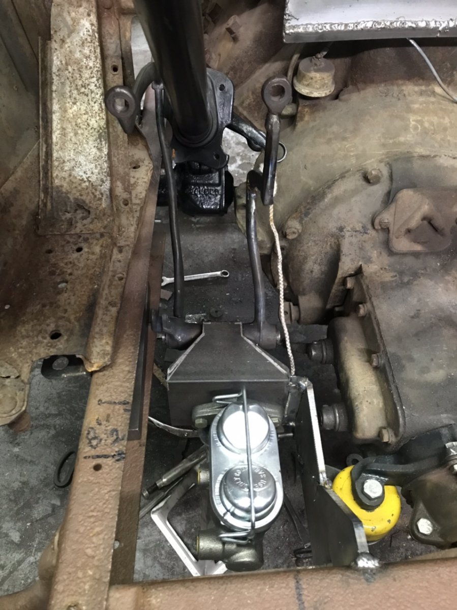

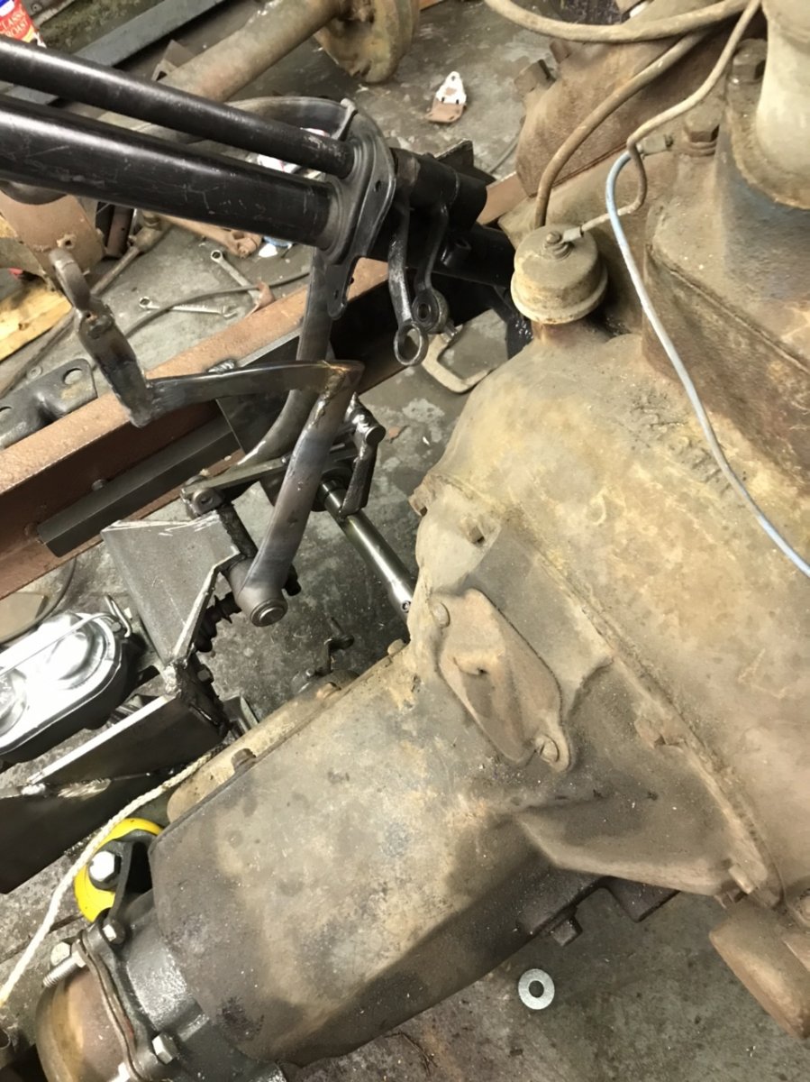

    Final location of everything! The rope represents shift rod....plenty of clearance! I cut the pedal ***embly off again and I made a new bracket to attach to trans mount, eliminated those hideous gussets and tweeked the brake/clutch levers with some heat. I think it looks cleaner now than it did yesterday. I welded the steering box mount more permanently, but it still needs some tidying along with installation of the wedge I made. I’m not far off from factory location of pitman arm ball, so I should be good to go! Column shift will work just fine now!! I’ll be welding everything up permanent during frame prep before painting it! Thanks to those who gave me honest feedback and input! I’m totally jazzed now and can finally allocate brain power to other waiting tasks......thanks for stoppin’ in fellas......Wooo Hoooo!!!! IMG_1847.JPG IMG_1848.JPG IMG_1850.JPG IMG_1851.JPG IMG_1852.JPG IMG_1849.JPG

    Cool. Once everything is settled, will you brace the forward part of the pedal support bracket across to the frame?

    Yes.....I'll be making a bracket that bolts to the frame to reinforce the pedal/master ***embly and removing the rivets for the crossmember and installing bolts to make the whole "unit" removeable.....I'll be able to remove the trans mounts, master cylinder/pedal crossmember all as one unit. Thanks for your input Mart!!

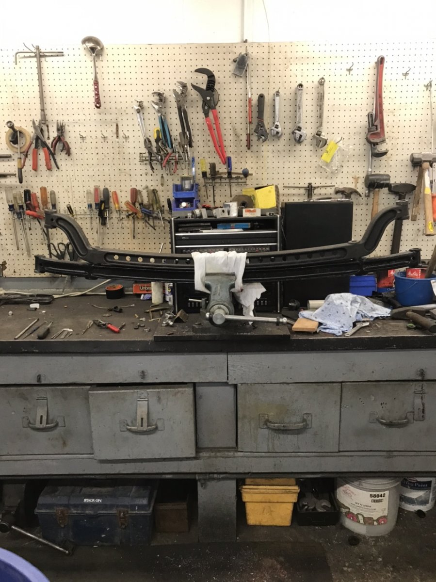

  6. Piewagn
    Joined: Mar 25, 2009
    Posts: 1,542

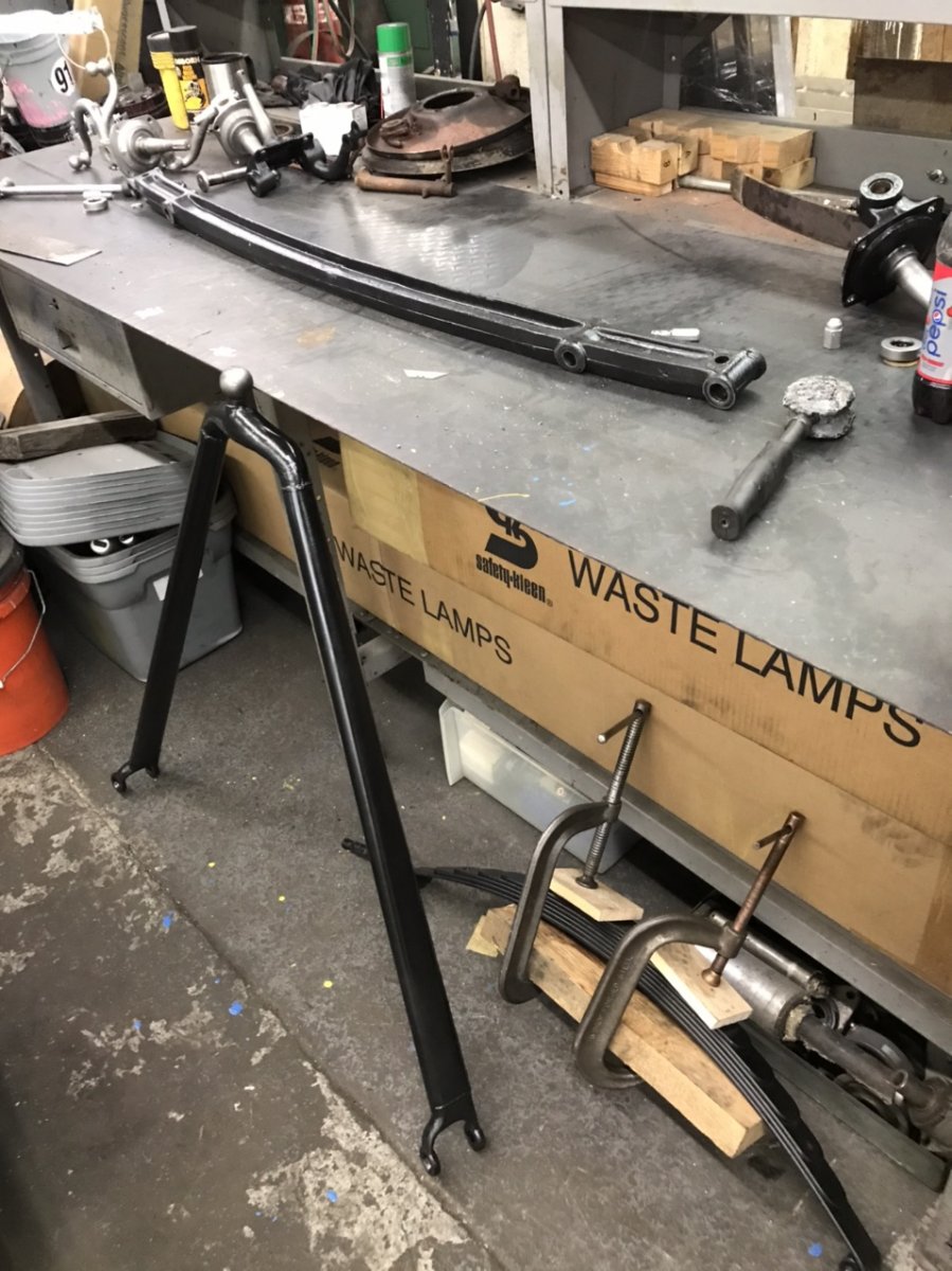

    Piewagn
    Which one to use? Is it common for a drop axle to be narrower? I was leaning strongly against splitting the wishbone.....if I use the drop axle, I would have to because the perch mount holes are narrower too! Thoughts? IMG_1854.JPG
  7. loudbang
    Posts: 40,351
    There was a post last week about dropping an axle and YEP narrowing is a result.
    1947knuck and Piewagn like this.
  8. RICH B
    Joined: Feb 7, 2007
    Posts: 6,300
    RICH B
    You don't have to split the wishbone with the narrower perch bolt centers; put some of that old H.S. trig to work to figure how much change in leg length and shorten as (if) needed. Could save $50-$75 worth of bungs and rod ends. Still need new spring, tho.
    Nailhead A-V8, Piewagn and loudbang like this.
  9. WTF really
    Joined: Jul 9, 2017
    Posts: 1,344
    WTF really
    I used a 36 axle reversed the original main spring and moved a couple leaf's around and dropped 3 inches from stock model a height
    Piewagn, RICH B and loudbang like this.

  12. Piewagn
    Posts: 1,542
    Piewagn
    Thanks Rich! That's what I was gonna do, figure out how much to shorten it but then the stupid light went off in my head.....the effing spring! I'm gonna stick the stock spring in and see how it sits. Snyders sells the wishbone bracket so you can use a later model trans. That me be the ticket for now.....thanks again Rich!!

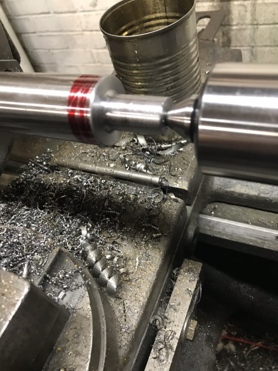

    This is the makings of my clutch linkage and actuator shaft....yes, I will be do***enting the process!

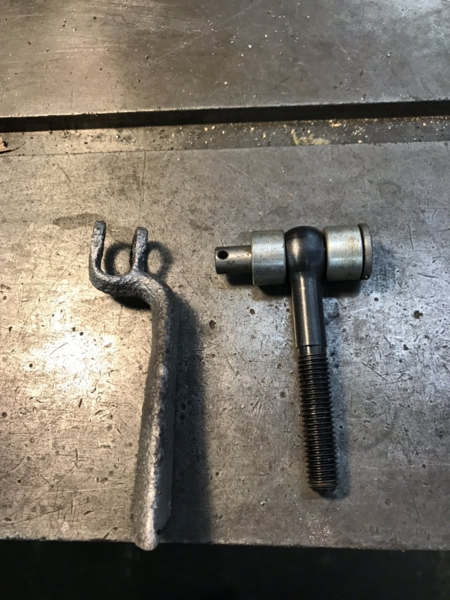

    Piewagn

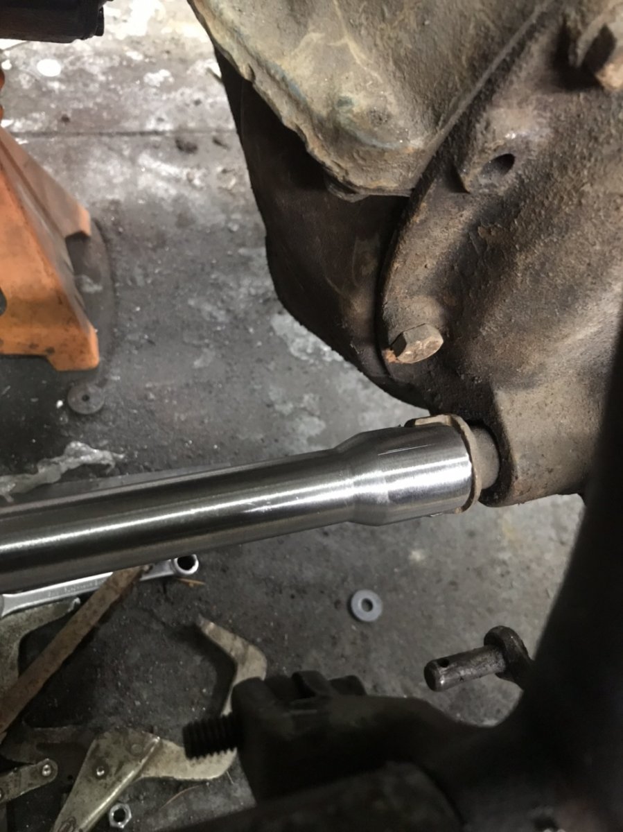

    Broke the edges, left a good radius in the corner. I’ll make a mount for the AR pillow block bearing on the frame. I was actually thinking, since I won’t be using the stock backing plates or brakes, I could use the stock lever/arm for the parking brake actuator as the lever for my clutch. I’ll take pics of course. Thanks for stoppin’ by fellas! IMG_1888.JPG IMG_1889.JPG

    Piewagn
    I’m thinkin’ I’ll use this lever for the clutch lever, just attach it to the shaft with some minor mods and VOILA! I have my clutch actuating lever! Adjustments.JPG

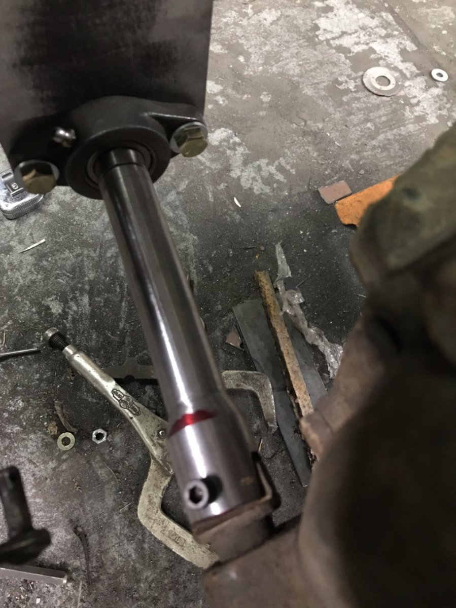

    Clutch actuator shaft basically done.....Just have to cut the 1/4” slot in the fat end and scavenge the park brake lever off of the existing stock backing plate. I’ll be making a bracket for the frame side out of 5/16.....Should be good ta go!! Hope all yer Monday’s went well...thanks fellas!! IMG_1898.JPG

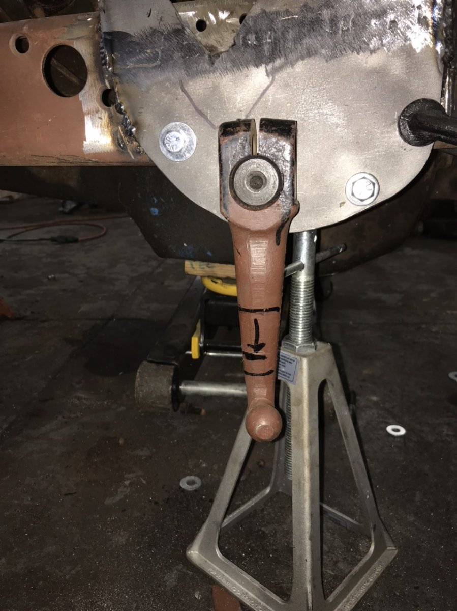

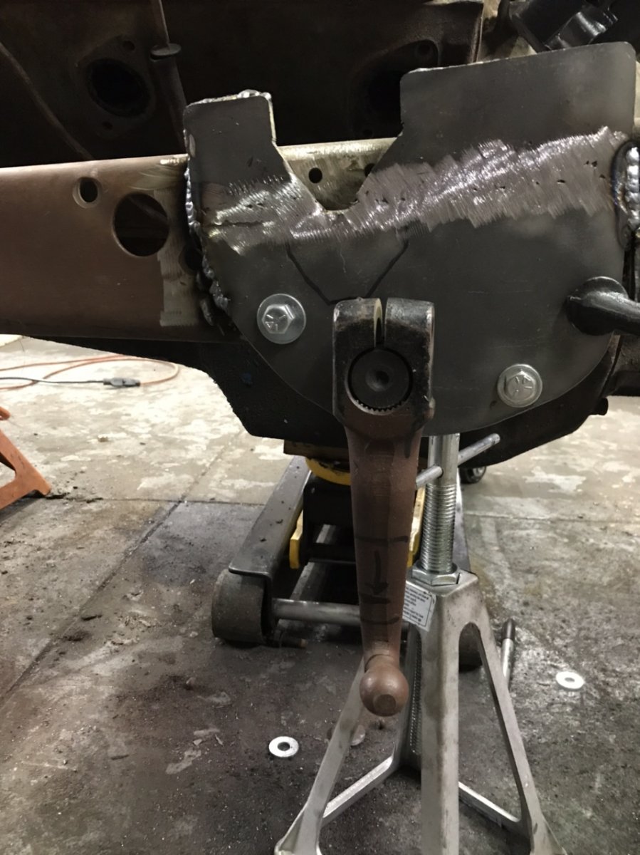

  22. Piewagn
    Posts: 1,542
    Piewagn
    Still have a few things to finish it off, but you get the idea.....
  23. Piewagn
    Posts: 1,542
    Piewagn
    Now I just have to attach the lever to the shaft after measurements then I can make final attachment to frame rail.....thanks for lookin’fellas!!! IMG_1909.JPG IMG_1908.JPG
  24. Piewagn
    Posts: 1,542
    Piewagn
    Forgot! I switched out from the idea of using the weld in ball studs to the tapered bolt in ball studs. This way I can use my original tie rod..... IMG_1910.JPG

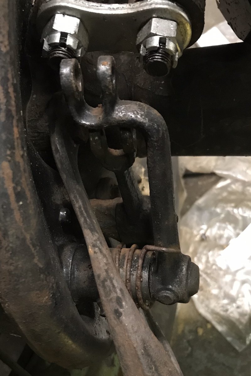

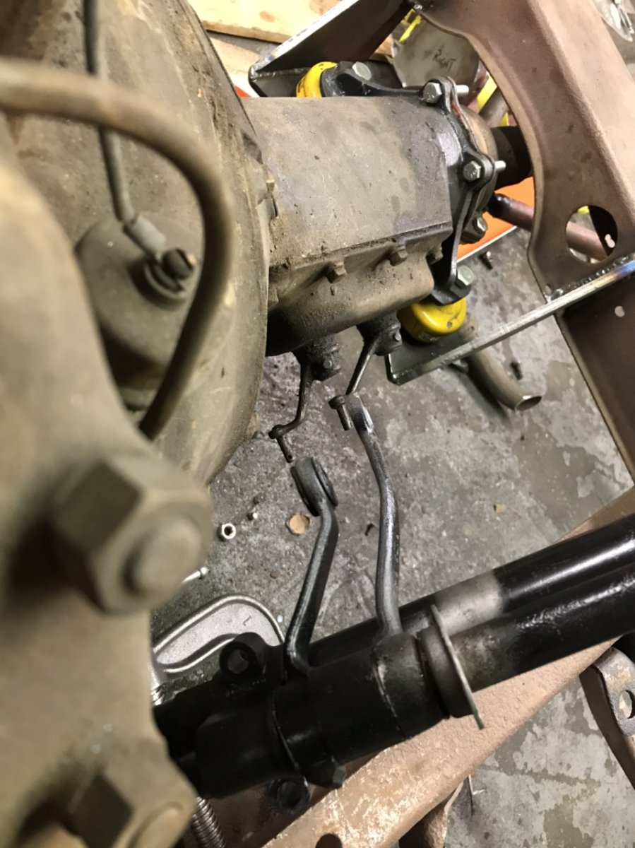

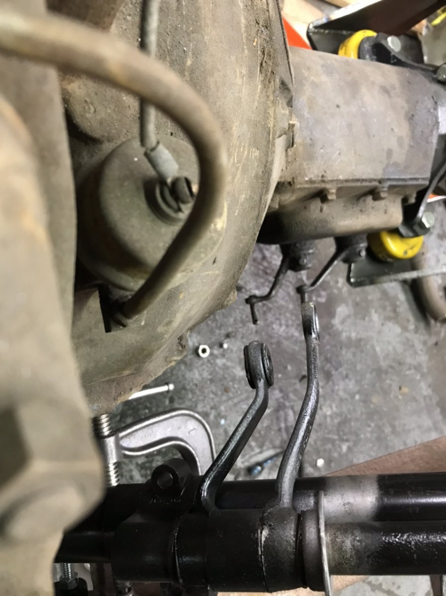

    Piewagn
    Another hurdle! Clutch actuator....just need to make the linkage. I moved the clevis/swivel mount to the other side of the clutch pedal to accommodate space and the modified park brake lever. Once again, the bracket is just tacked to the frame, I’ll secure it permanently during frame prep. Thanks for poppin’ in fellas and happy Friday!! IMG_1915.JPG IMG_1918.JPG IMG_1922.JPG IMG_1923.JPG IMG_1924.JPG

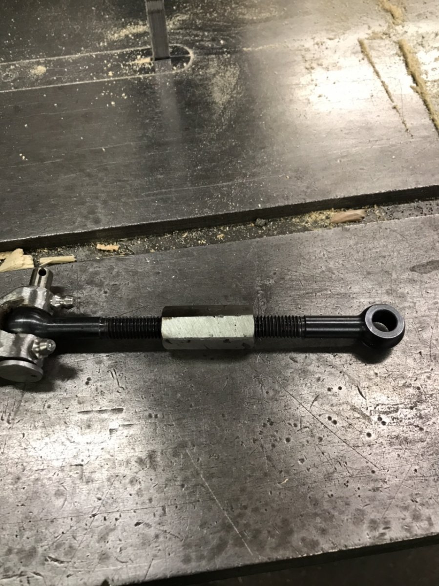

    Piewagn
    Making linkage and adjuster today....just gotta get the right length and leave room for adjustments....thanks for stoppin’ by fellas! IMG_1928.JPG

    Piewagn
    Adjustable linkage done.....need to tidy it up some and trim the pins, but it’s functional! I started on the bracket to secure the ***embly to the frame rail to secure and tighten things up.......thanks for comin’ by fellas!! IMG_1930.JPG
