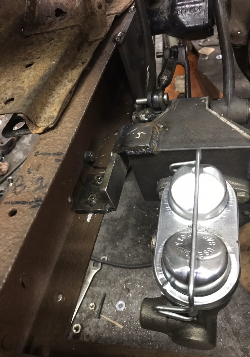

    Finished up the bracket to the frame rail.....I now have a fully functioning clutch! Thanks for all the support fellas!! Adjustments.JPG

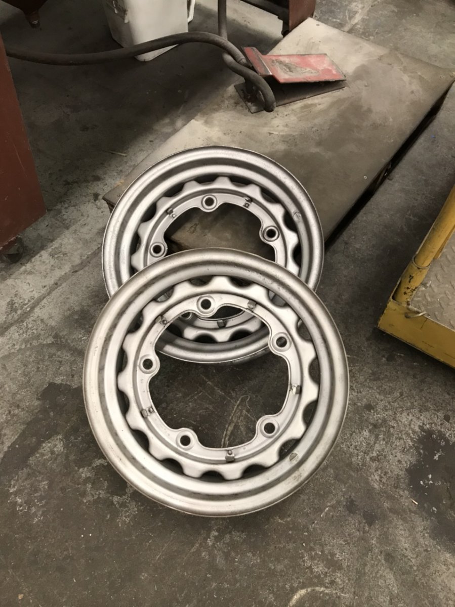

    Getting my wheels ready for paint so I can get my tubes and tires on. Waiting on some castle nuts so I can finish the front axle ***embly and get it under the frame....then I’ll decide if I’m gonna split the wishbone or not. Stay safe fellas snd thanks for your support! IMG_1951.JPG

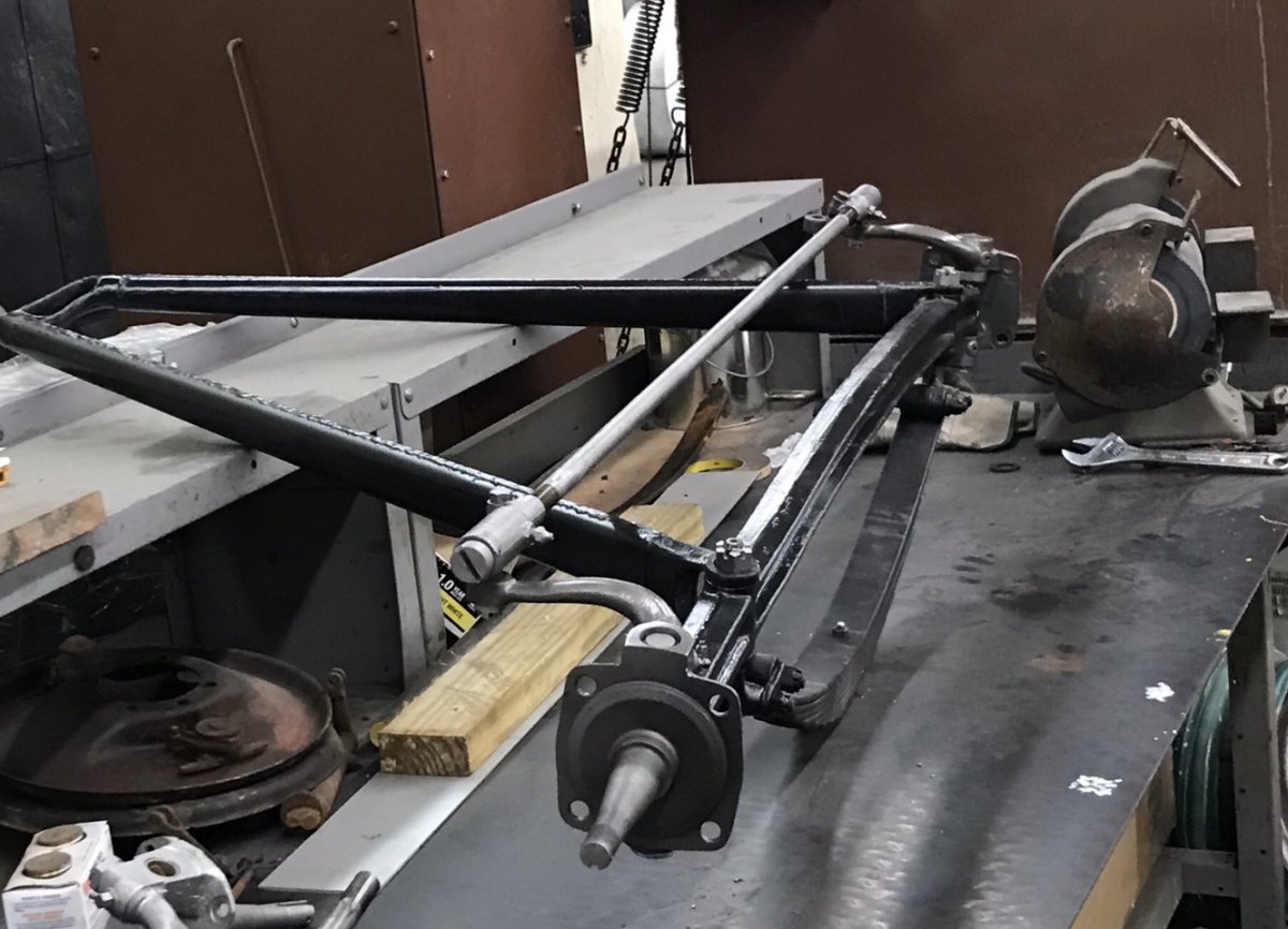

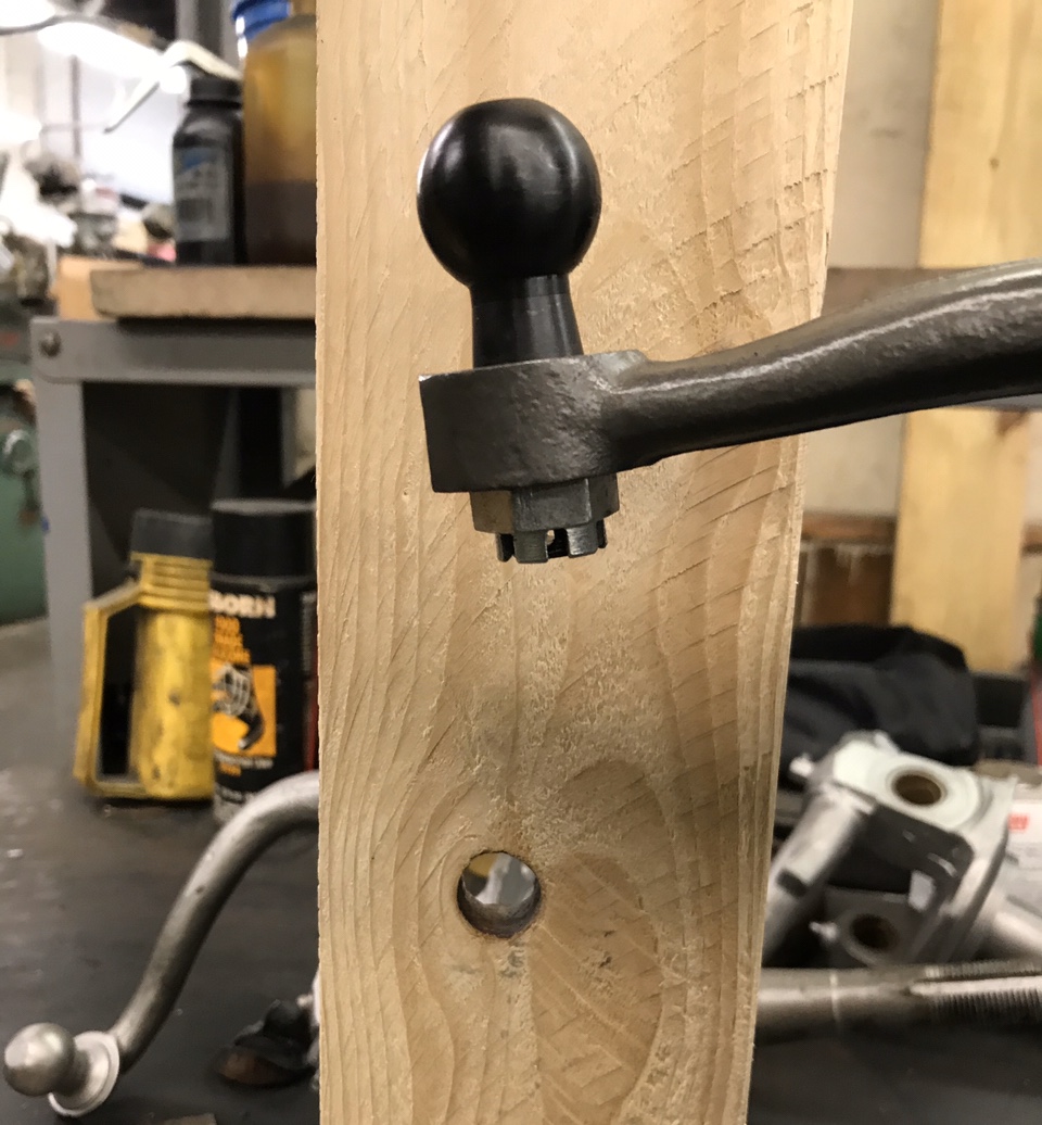

    Got my castle nuts but they were too tall, so I milled them down. My tie rod/center drag link is a bit too short, but I’m sure I’ll figure things out. Thanks for visiting fellas! IMG_1959.JPG Adjustments.JPG IMG_1962.JPG Adjustments.JPG

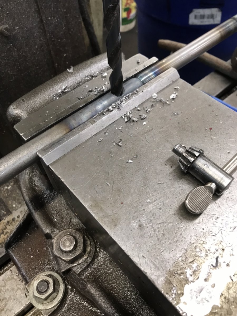

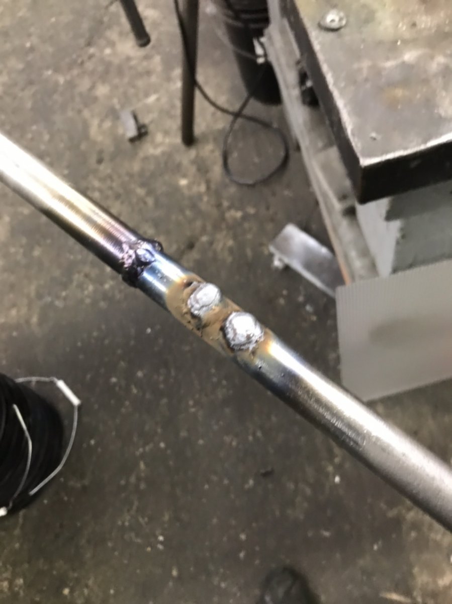

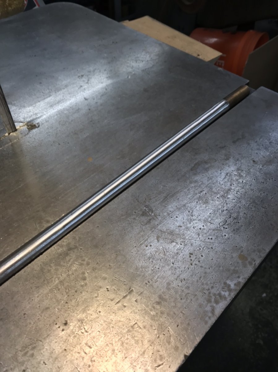

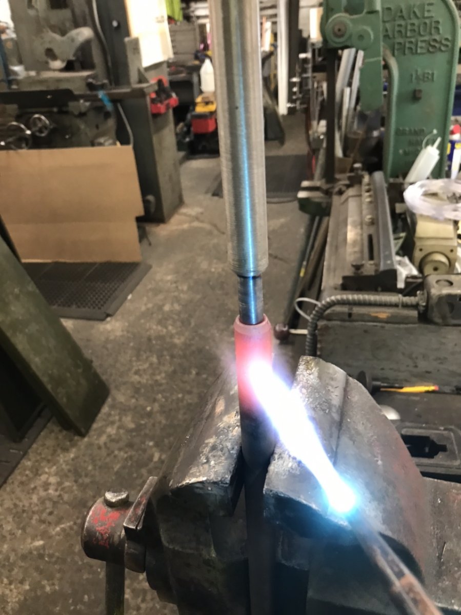

    Lengthened my tie rod....inserted...heated and pressed in so when it cools it will shrink and clamp down....double plugged and staggered on both sides....keep well fellas.... IMG_1993.JPG IMG_1994.JPG IMG_1995.JPG IMG_1996.JPG IMG_1997.JPG

    Thanks! I was beating my head against the wall thinking how I was gonna do this and when I cut it, I found out it was hollow.....that's when the bulb lit up! :D There's plugs at either end and I thought it was solid......I'm letting it cool naturally and I'll tidy it up in the lathe come Monday.....

    Good thinking and that looks very sturdy. :)

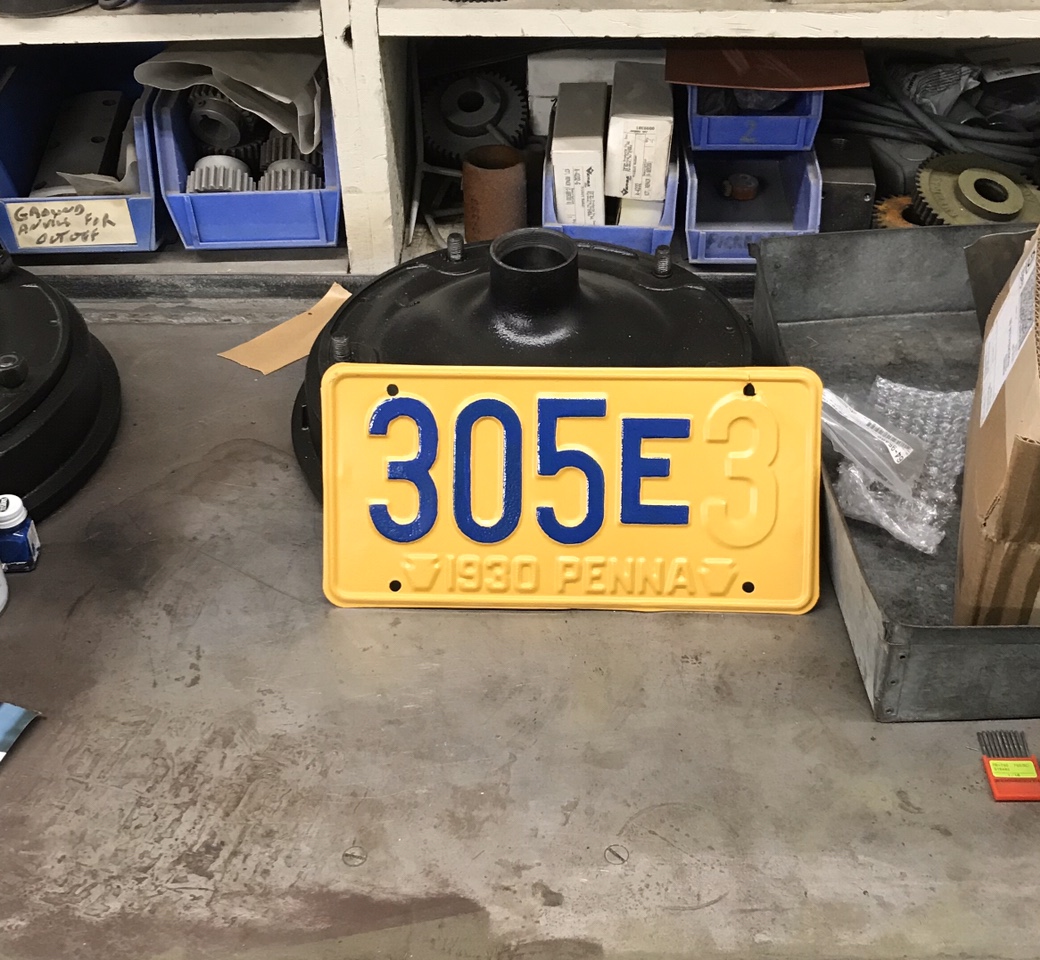

    Didn’t want to mark up the fresh paint on the wheels and try to mount the tires prematurely and I’m waiting for them to cure thoroughly, so I was playing around with my “year of make” plate today! Well, I’m fairly sure I got the colors right. Tedious for sure and want to take my time with it, so I’m doing a couple numbers at a time so I don’t lay my hand on the freshly painted ones. I think it’ll come put nice! Hope all is well fellas! Adjustments.JPG

    Double your progress. Paint one on one end then turn the plate around so the fresh paint is on the opposite end then paint the one under your hand. Unless you can't paint while looking at a letter or number upside down. :rolleyes:

    The makings of my steering arm....of course I’ll do***ent it. Also did a couple more digits on the plate. It kills my neck and back an I really have to take a break after two! [emoji16] Stay safe fellas!!! IMG_2021.JPG Adjustments.JPG

    :D:D It's just that I go 360 with it and by the time I'm done two digits my back is on fire from staying in one position too long. No hurry for the plate, just goofing with it between other things. Thanks LB!

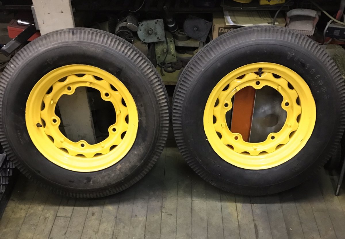

    Yay!!! Front tires mounted!! Holy **** were they stiff! I took my angle grinder to the sharp edge on the inside edge of the bead an rounded it off. The boss was breaking my balls for mounting them by hand....I told him that’s the way my Pop would’ve done it! Hope you’re safe and well fellas....thanks!!!
    Weird, just got home from work and looking at the pics, the camera angle stretches the tires out on my PC and make them look **** eyed.....they're true though, rolled them across the shop floor and there was no giddyup..... Adjustments.JPG

    If you look close, the 3 is even a bit crooked! :D
