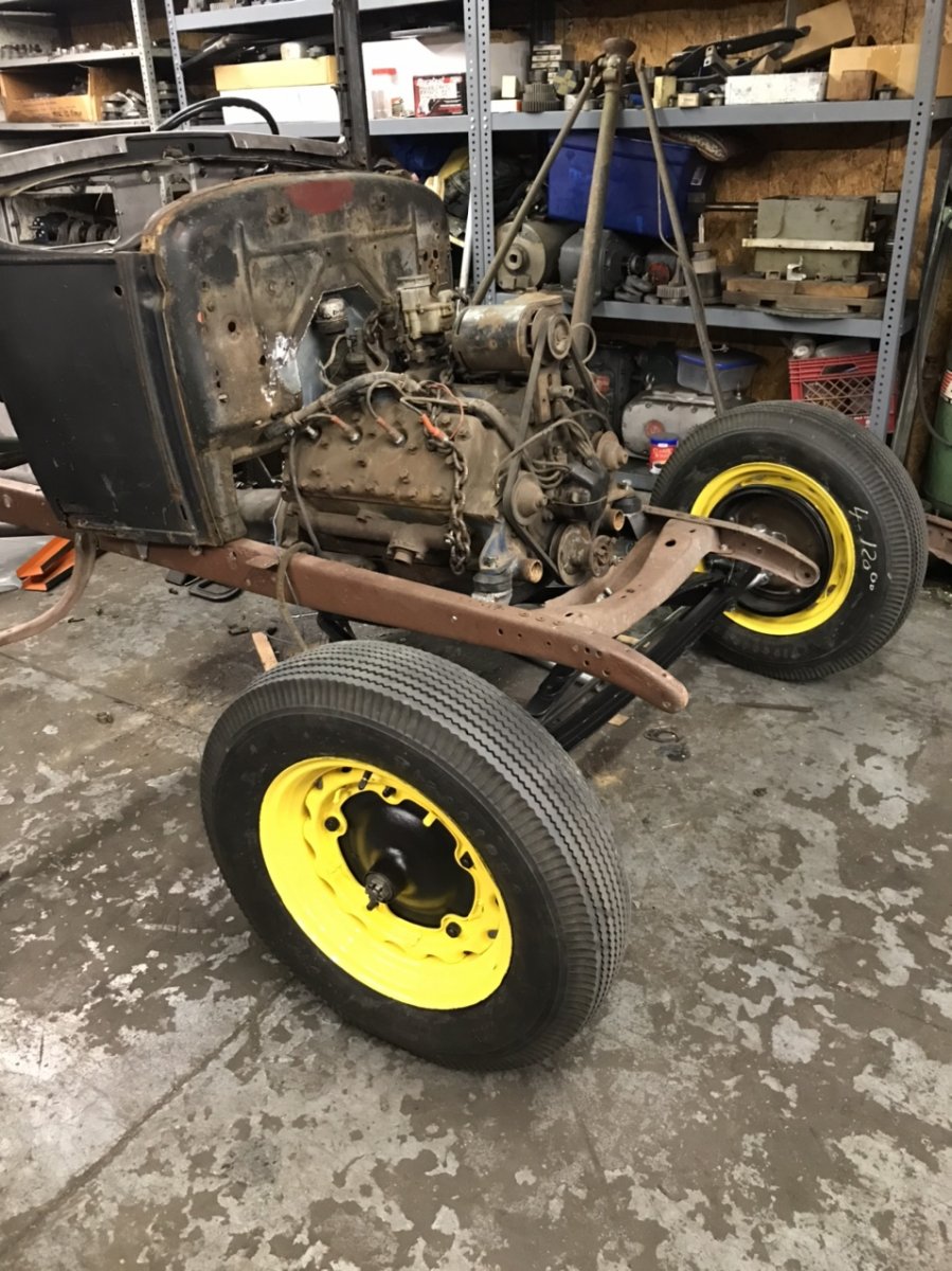

    Piewagn

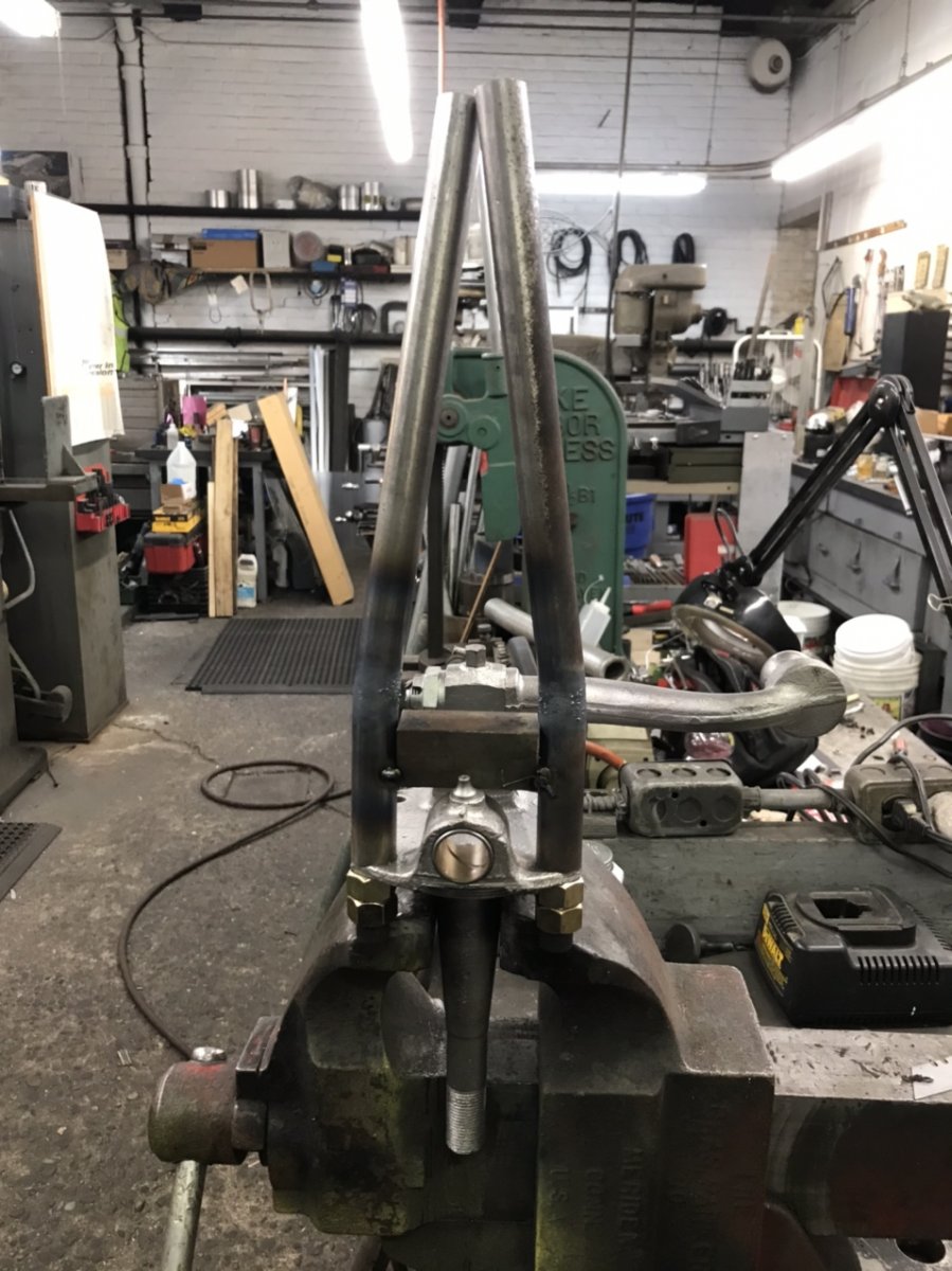

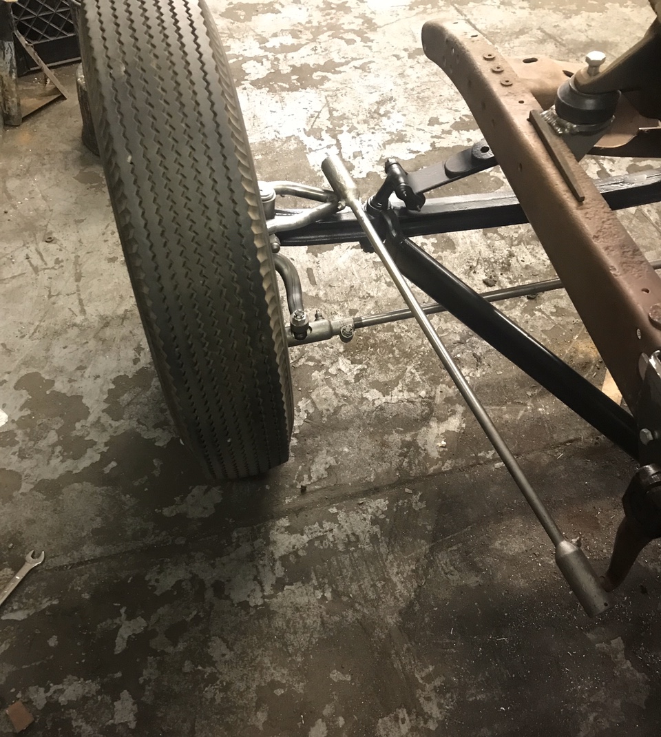

    Well...alot of things came into view today. I got the front axle ***embly under the frame and the rest of the steering came into focus. I will be splitting the wishbone and mounting them off the trans mounts on either side. I’ll make brackets to drop down and secure them there. Got most of the steering arm done....still needs to be tidied up. I’m VERY close to blowing this thing apart and prepping the frame for paint and re***embly! All the hard stuff is done....after the frame....it’s on to the body!! Hope all is well with everyone, thanks for stopping by fellas!! IMG_2030.JPG IMG_2042.JPG IMG_2031.JPG IMG_2033.JPG IMG_2034.JPG IMG_2035.JPG IMG_2039.JPG IMG_2022.JPG IMG_2023.JPG

    Well....pretty much have the steering wrapped up. I’ll finish up the rest of the welding after I blow it apart. The only thing left is the wishbones....I have several sets of rear trailing arms, I’m going to extend the wishbones after splitting them and make mounts back at the trans mounts. I’ll do***ent the process. Chuggin’ along..... Adjustments.JPG Adjustments.JPG Adjustments.JPG

    Looking good.
    A question: Can you take the oil filler cap off?

    Piewagn
    Yes Mart.....the cowl is just sitting directly on the frame and is actually forward of it's "home" location. Once I have the body mounts in place, there's plenty of clearance to remove the cap. I had one inch spacers, which is the thickness of the mounts, between the frame and cowl when I set the pedals up. Thanks for the input!

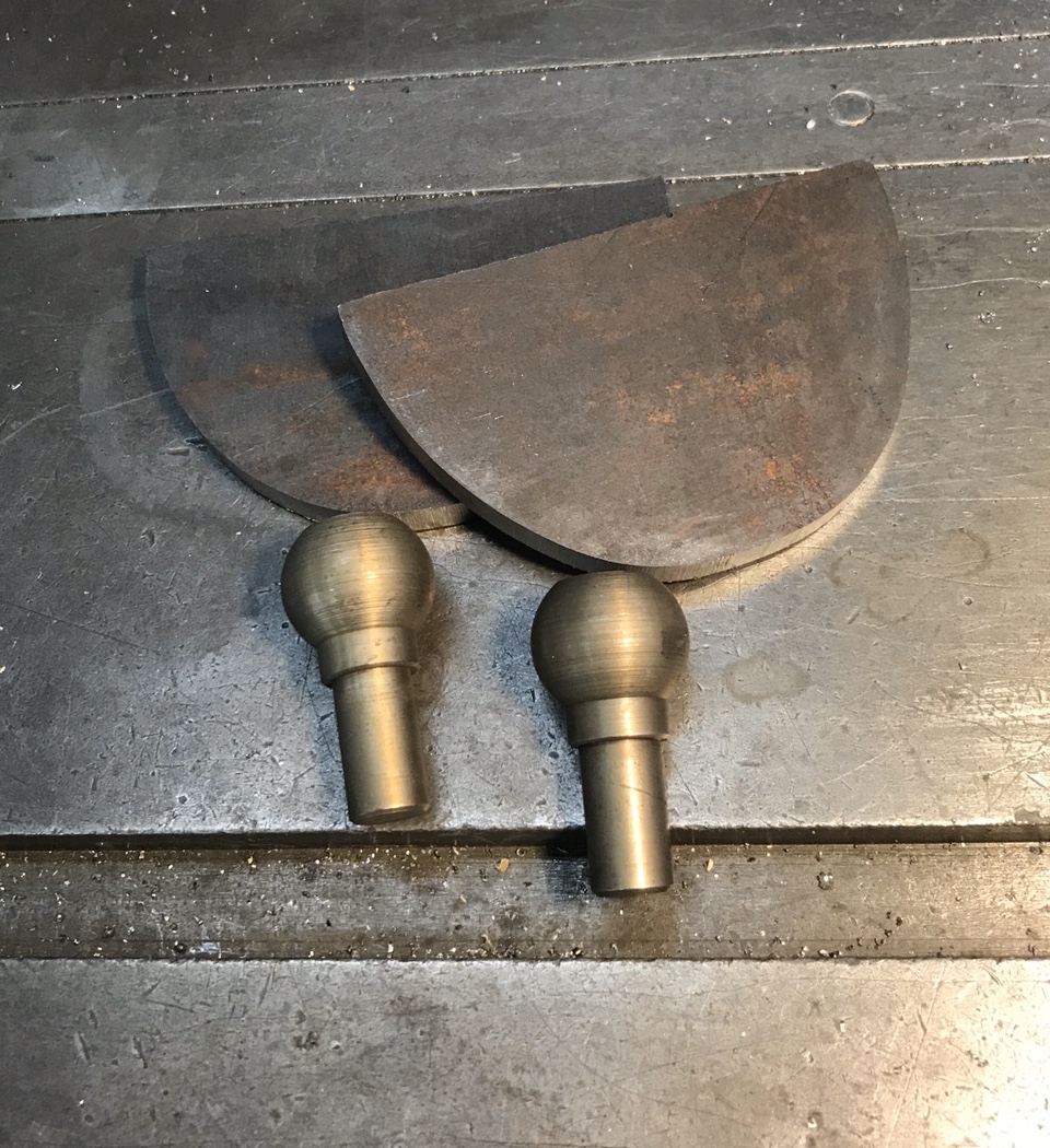

    Piewagn

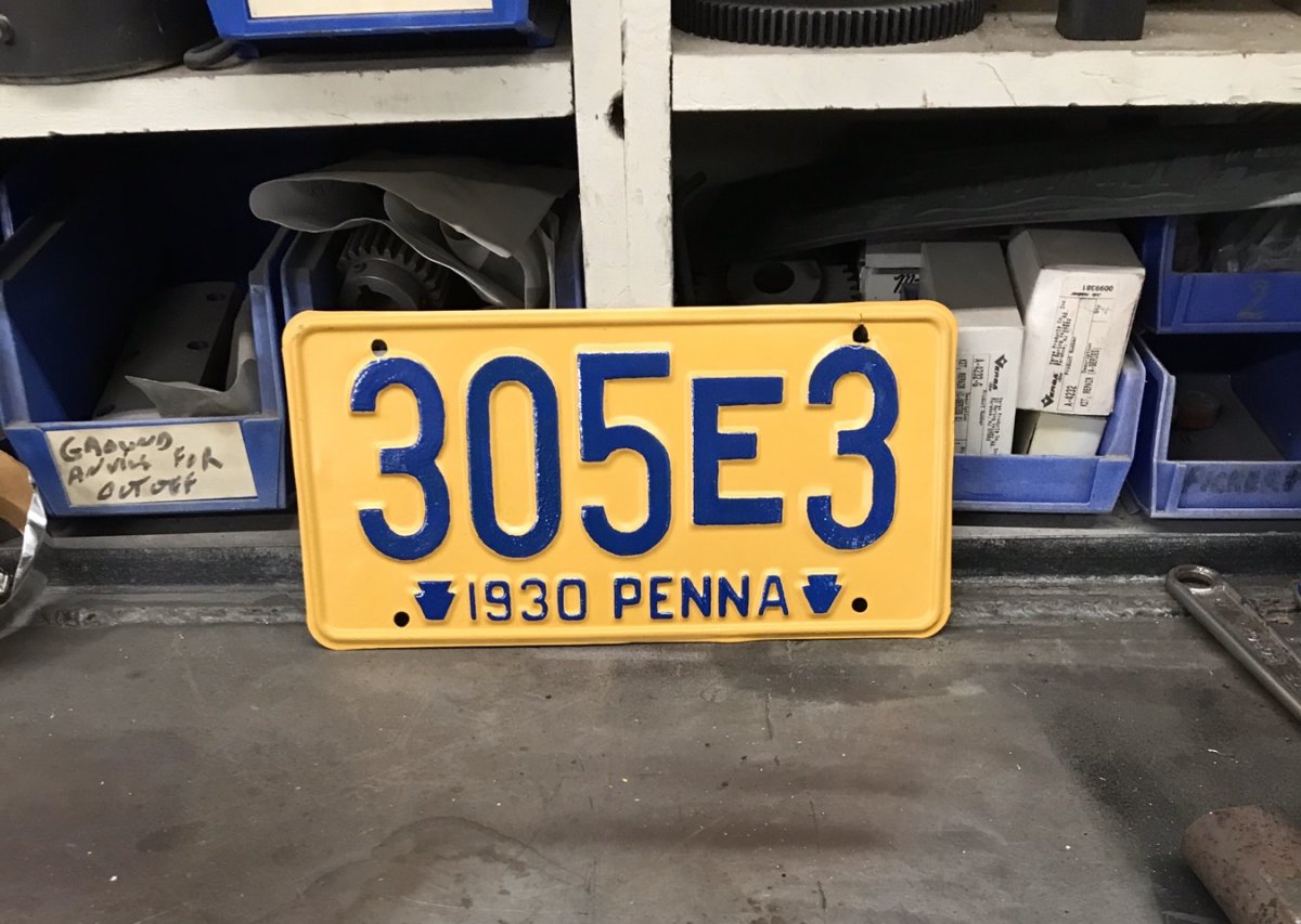

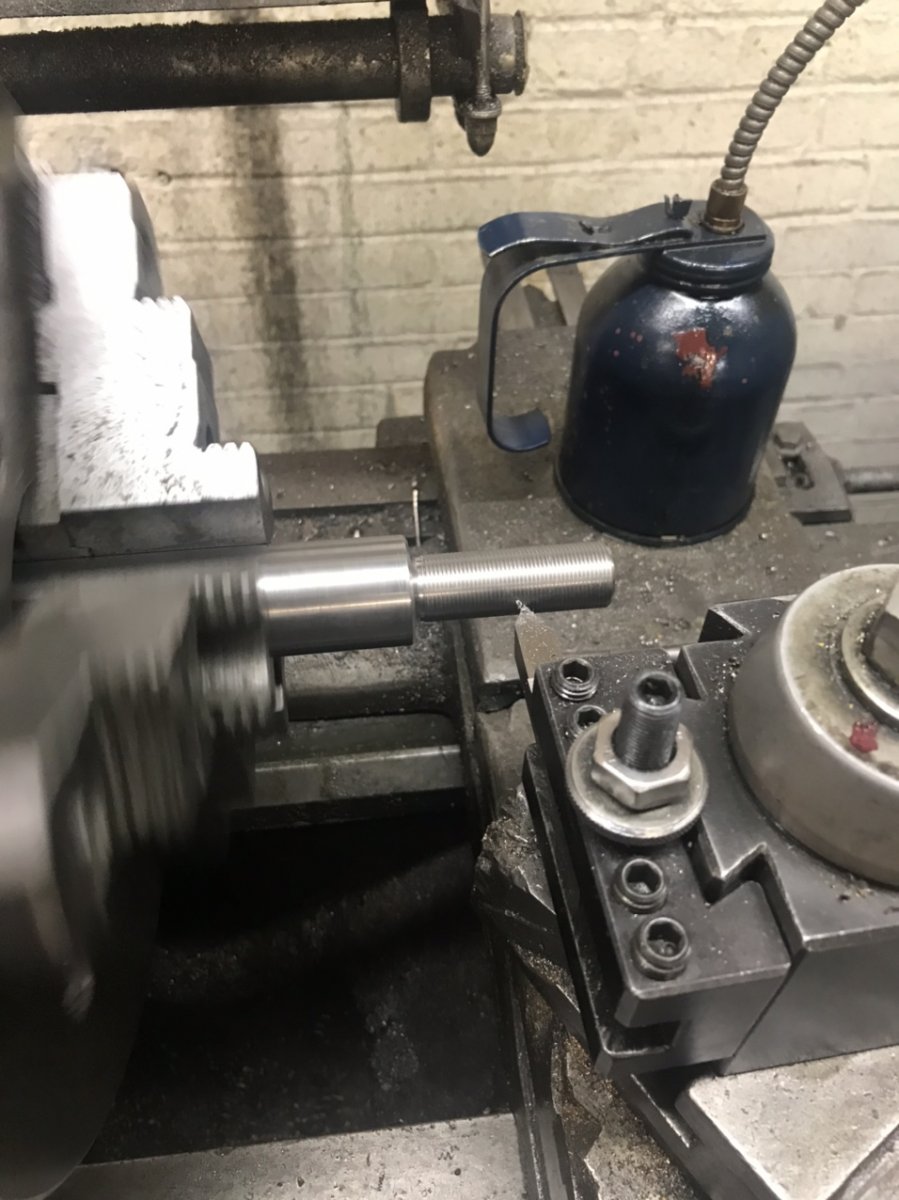

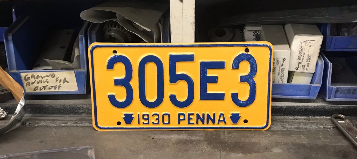

    Making bungs for my wishbones.....I’ll be using the stock A tie rod ends....did a little more on my YOM plate....we took a couple machines out of mothballs at work and are bringing production back home, some we’ve been extremely busy at work with overtime and it’s eaten into my coupe time.....but that’s a good thing! IMG_2074.JPG Adjustments.JPG
  7. loudbang
    Posts: 40,351
    Plate looks like it was freshly issued. :)

    Thanks LB! I still have to do the outline....that's gonna be a little more challenging. I may have to break out the fine line tape for that!

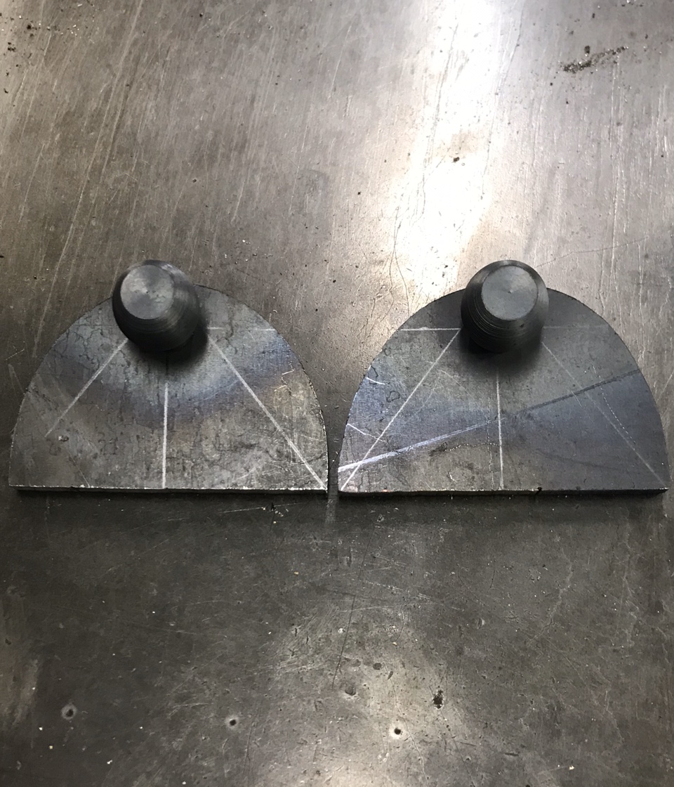

    Piewagn

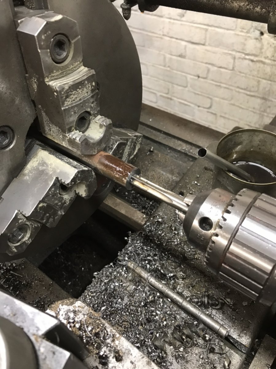

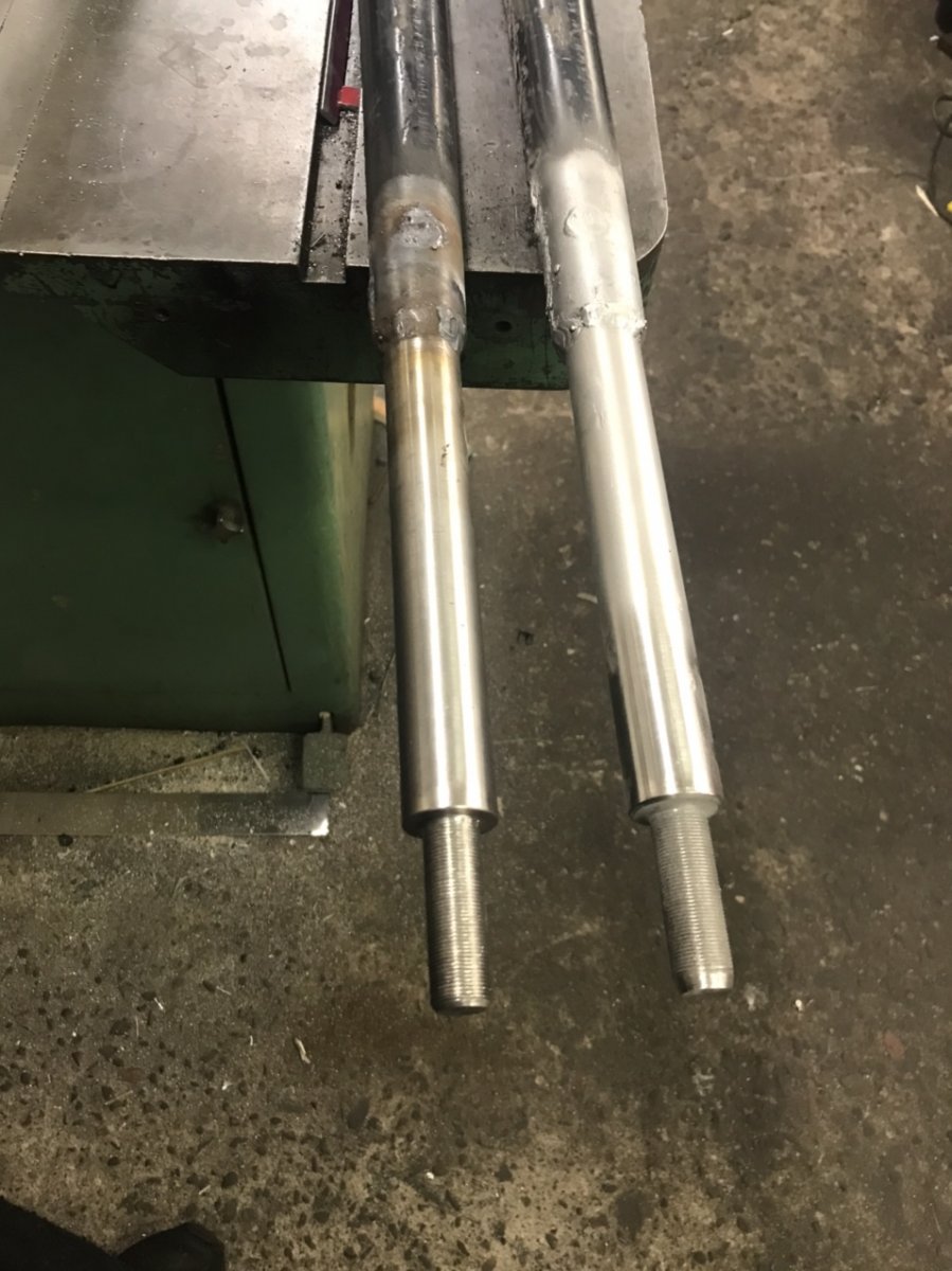

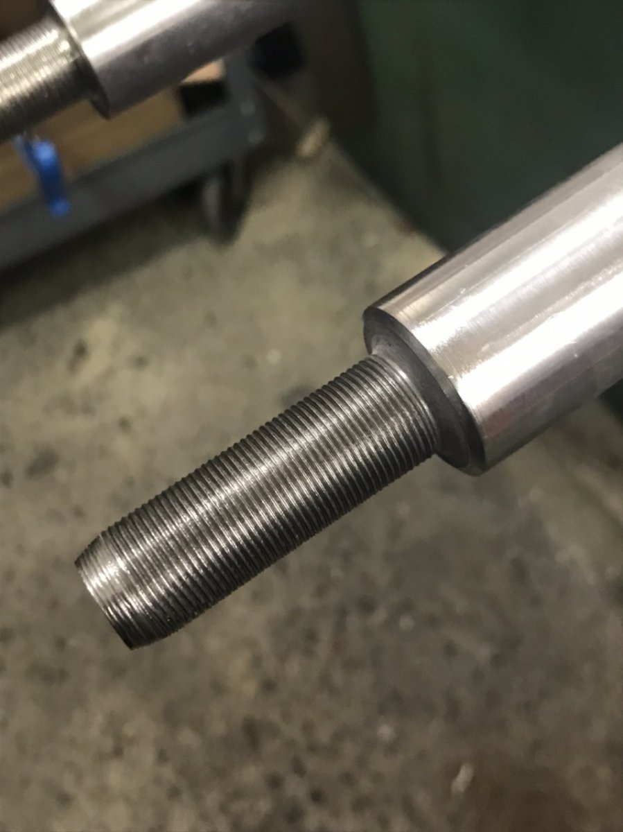

    Chasing threads for my wishbone extensions....sill waiting on my tie rod ends.....I’ll be fabricating a mount for them at the trans mount. Hope everyone is doing well! IMG_2100.JPG IMG_2101.JPG IMG_2094.JPG

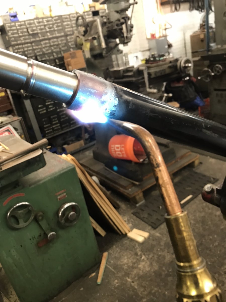

    Piewagn
    Still waiting on my tie rod ends because Fedex is goofy! You’d think after 3 time getting to my work after 6:00pm they’d figure it out and get there sooner.....

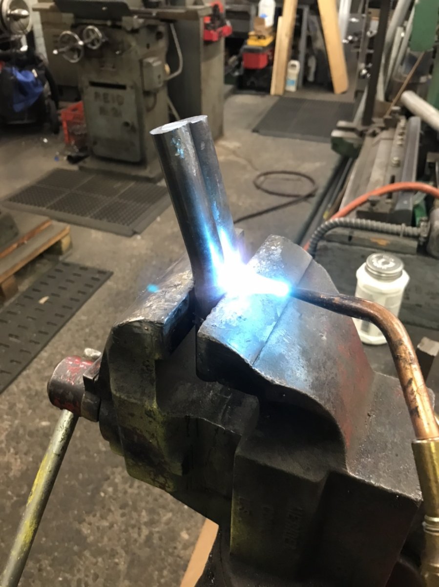

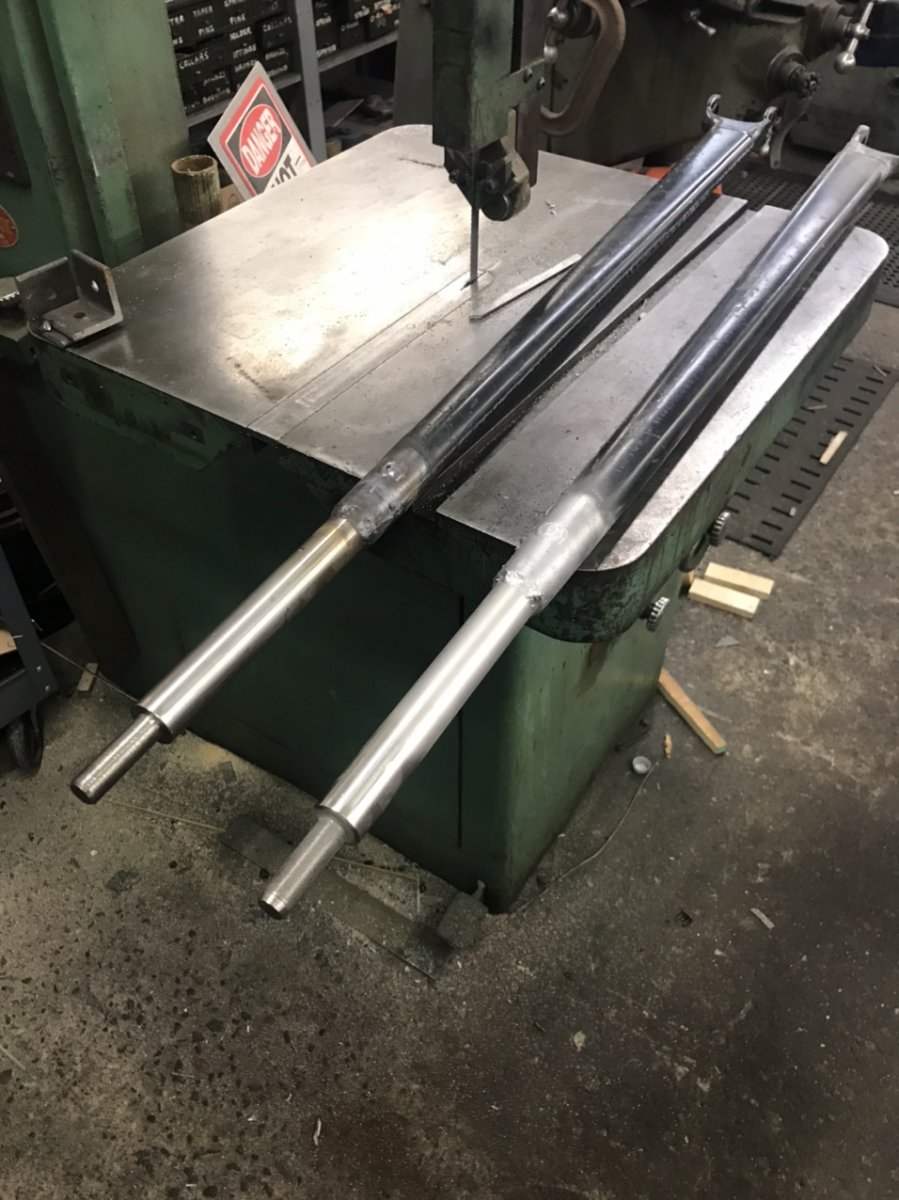

    Meanwhile, I finished up my extensions and the wishbones are ready.....heated and pressed in, cir***ference welded and plug welded.....now I need to fabricate the mount back at the crossmember/trans mount. I’ll be gusseting the crossmember and mount ***embly. Hope all is well you guys, thanks for poppin’ in! IMG_2094.JPG IMG_2108.JPG IMG_2109.JPG IMG_2110.JPG

    Meanwhile.....FedEx is still goofy! Trying to resolve an issue with someone you can barely understand is ALWAYS a challenge! Needless to say, still no parts! I was, however, guaranteed them this Monday. In the meantime, I finished up my YOM plate! Thanks fellas!! Adjustments.JPG
  15. koolbeans
    Joined: Apr 12, 2015
    Posts: 634
    koolbeans
    Plate looks great. Down yonder here we "supposedly" not allowed to doctor them up. Huh....I'll bet ya... IMG_20200411_110056744.jpeg

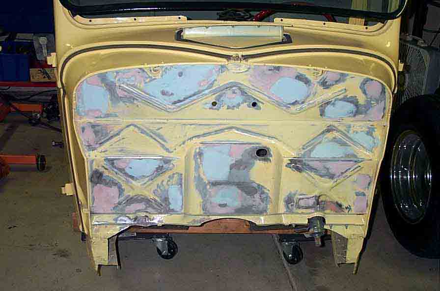

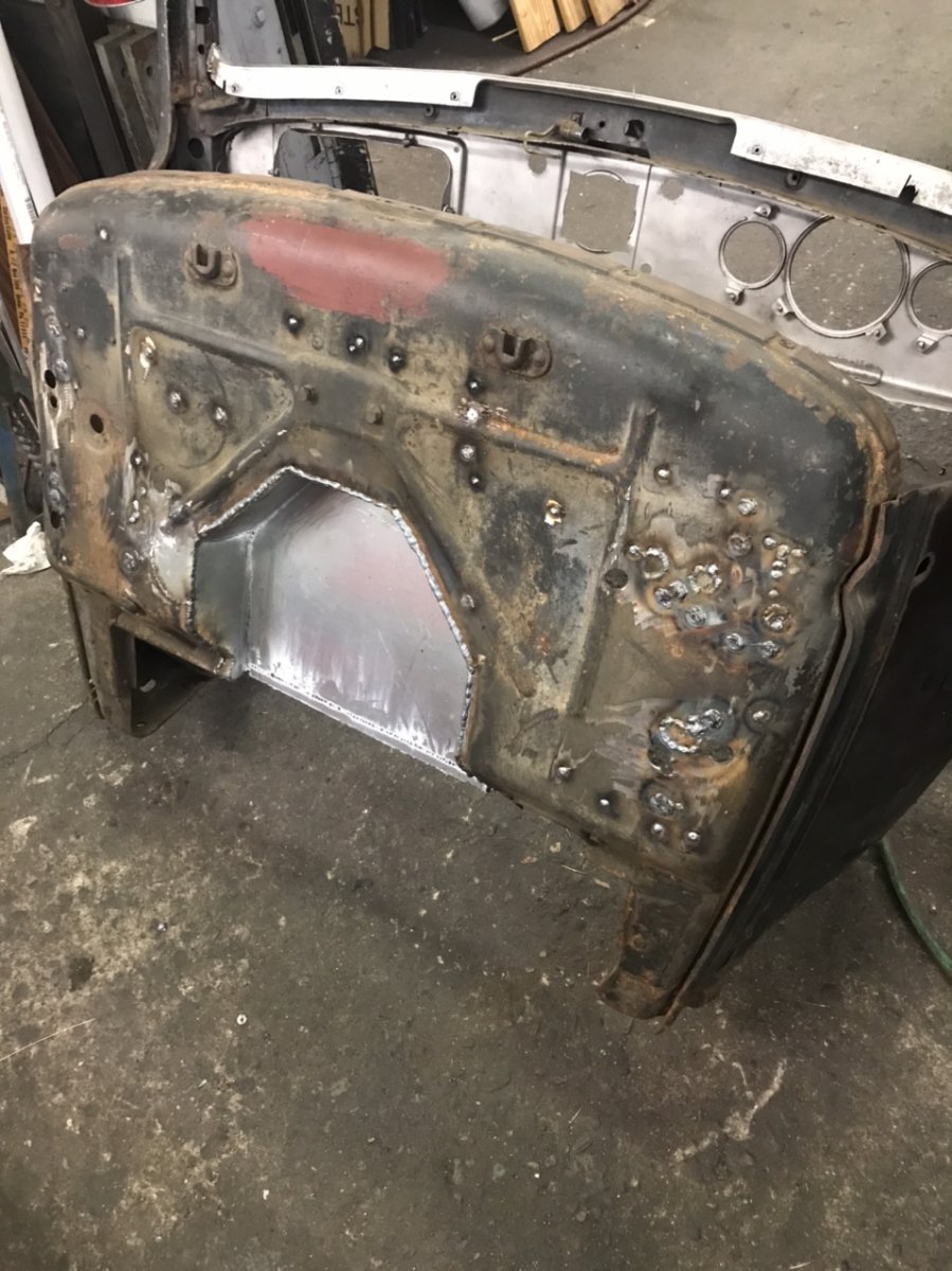

    Finished filling all the holes in my firewall.....I’m picturing Fedex driving around with my package in a little clown car giving the raspberry in my direction and driving off with it again! It’s been a MONTH I’ve been waiting for my tie rods ends due to their UTTER INCOMPETENCE! Tracking says tonight....I’ll believe it when I see it! Fedex blows.....geezus! IMG_2166.JPG

  25. roseville carl
    Joined: Dec 29, 2008
    Posts: 5,218
    roseville carl
    its amazing just how many holes get put into old firewalls had over 50 in the truck......what a big PIA

    Crazy huh.....on a budget though, so I'm usin' the old one! :eek::D
  27. Piewagn
    Joined: Mar 25, 2009
    Posts: 1,542
    Piewagn
    Makes you wonder just exactly which "accessories" were added over the years....:D:D
