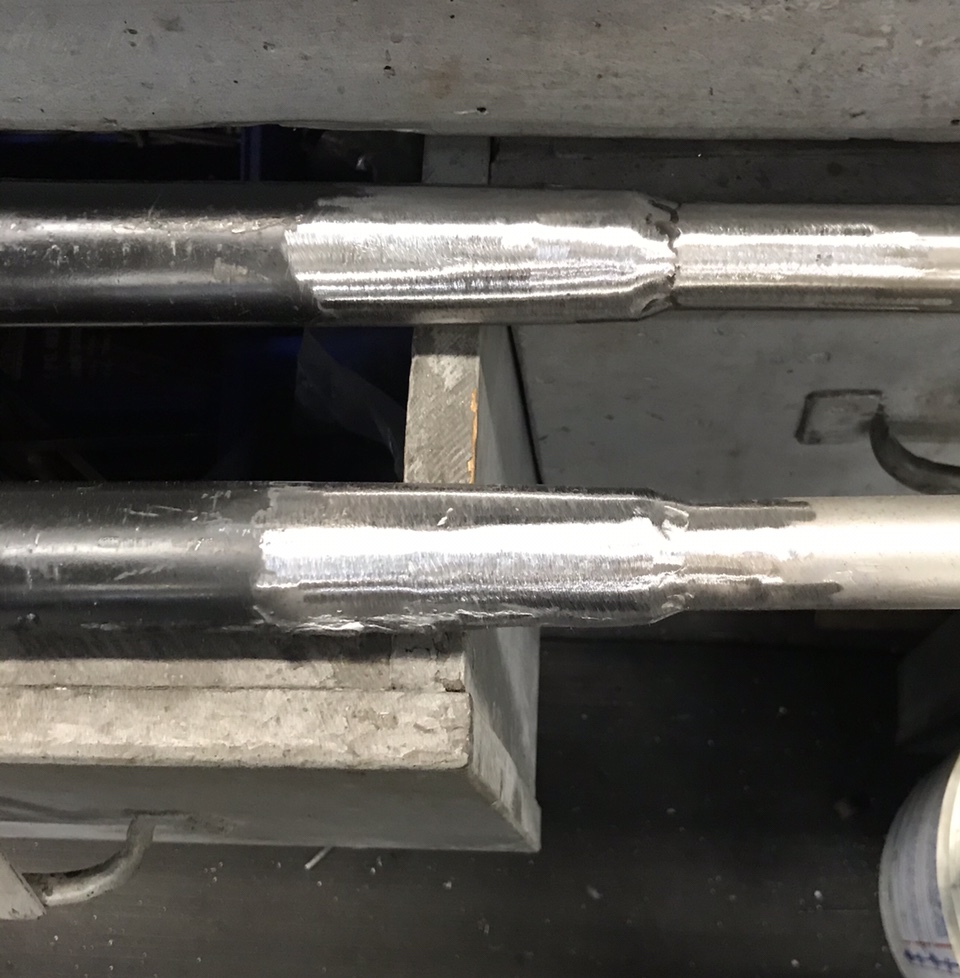

    Finally! Threads worked put perfect and I got the wishbone ends done! IMG_2182.JPG I think I’m just gonna blow it apart and set the axle in and weld the wishbone mounts in then....we’ll see how I feel tomorrow after work....

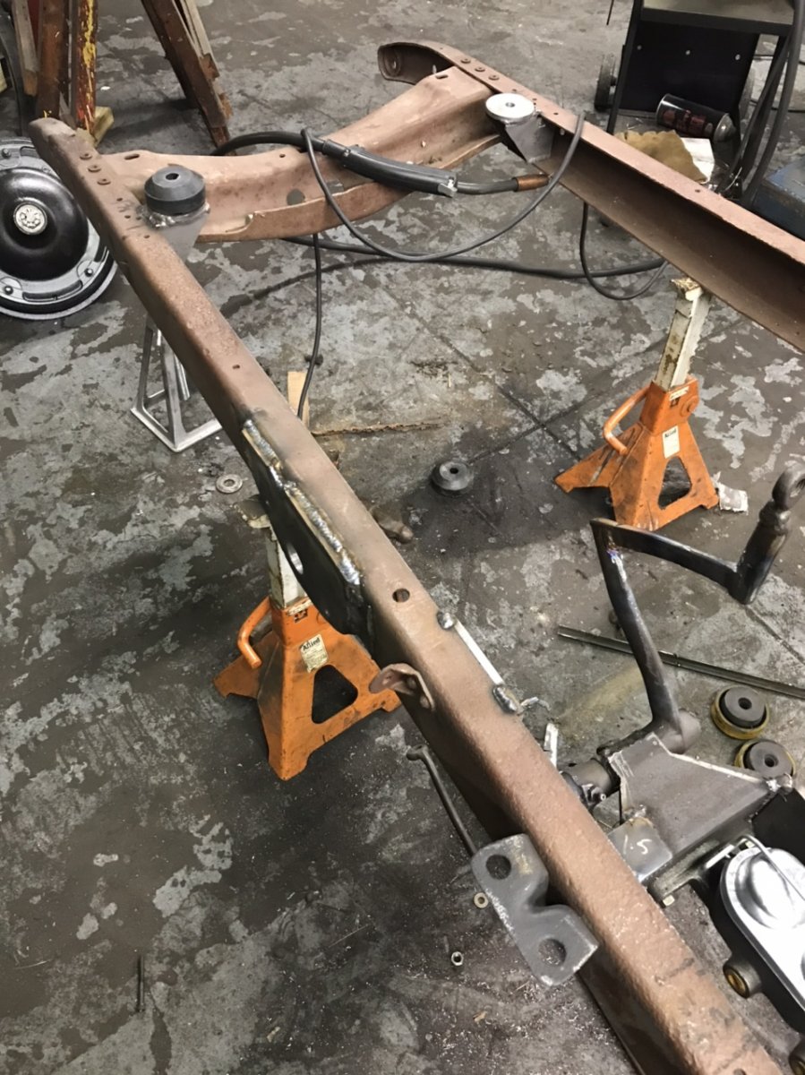

    Engine/trans out and started the welding....
    Of course I did something I tried to remind myself not to do....and that was to take gloves off and use my hand on a freshly welded surface to****ist myself in standing up...
    Did that 30 years ago....and today! But, I’ve always reminded myself “don’t put hand on fresh weld to stand up!”....well, my 30 years streak is over with a whiff of flesh and some flailing about....but I’m ok...
    A little input.....I want to make the center crossmember removable....but if I do, I can’t box the frame completely up to xmember...do you think it’s a big deal if I turn ends of boxing plates in at xmember and continue on other side? Or, is boxing absolutely necessary? Maybe some strategic reinforcements? Appreciate any input....thanks for letting me ramble fellas! Onward Hoe..... IMG_2238.JPG

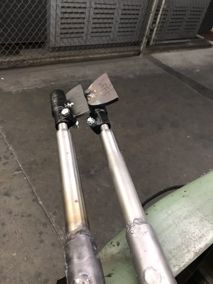

    Cleaned up the interface of my wishbone extensions....getting ready to****emble front suspension****embly and install..... Adjustments.JPG

    @Piewagn , I don’t think it’s gonna be a big deal if you don’t box the whole frame with a stock or mild flathead. Since you split the wishbones I would do as much as you can.
    On a side note, while my F1 crossmember is removable, to get the transmission out it’s just easier to pull the motor than to pull the rearend out of the car so it turned out to be a not really necessary.
    I boxed mine from the F1 crossmember rearward but I use unsplit wishbones and closed driveshaft like you so less twisting load on the frame.
    I’m glad you got the column shift to work for you and can’t wait to see the finished deal as I ran out of space on my car with the F1 steering column and the headers to run the linkage.

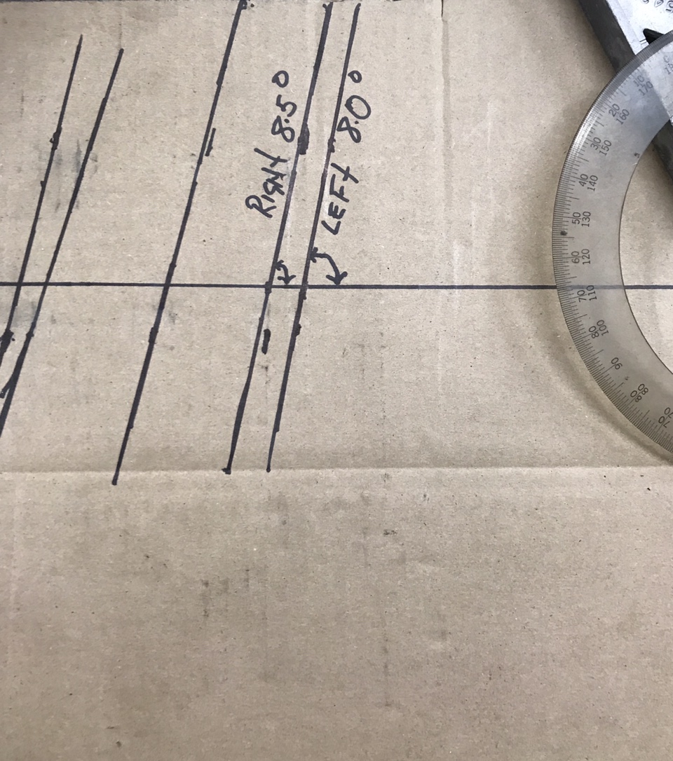

  20. Piewagn
    Joined: Mar 25, 2009
    Posts: 1,535
    Piewagn
    Laid the front axle****embly up and had nearly zero castor....So, I pie cut the wishbones and got some castor....gotta keep it goin’ straight!
    Thanks for stoppin’ in fellas....hope all is well with everyone! IMG_2286.JPG IMG_2288.JPG IMG_2289.JPG IMG_2290.JPG IMG_2291.JPG Adjustments.JPG

    I really did start to get discouraged on the column shift to the point I started looking for another trans. Persistence and actually doing something I told myself I wasn't going to do and that was notch the frame to move the steering box and bracket up and forward, I really thought I was in for some tweeking/twisting of the frame. But, I supported it and cut my notch and welded my bracket up and everything measures out nice. I think I will box from crossmember back and not make it removable, taking the engine out to do the trans was way easier on my Tudor like you said, than removing the diff and rear suspension. Againn thanks for the input and hope to see you around here again!

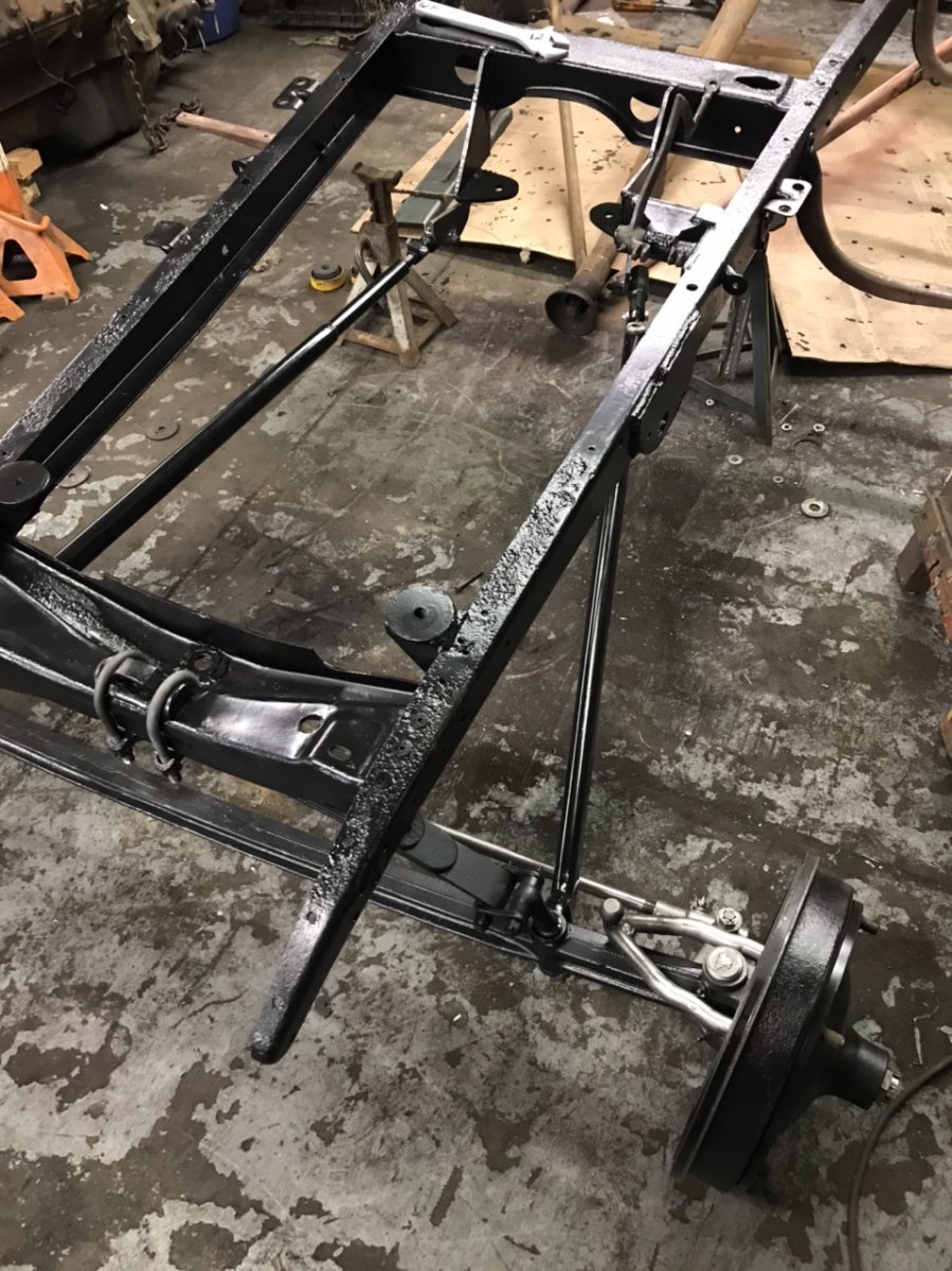

    More progress.....frame painted, except where I need to weld the wishbone mounts. Will be removing rear axle next and prepping for paint and painting the underside of rear crossmember......thanks fellas!! IMG_2310.JPG

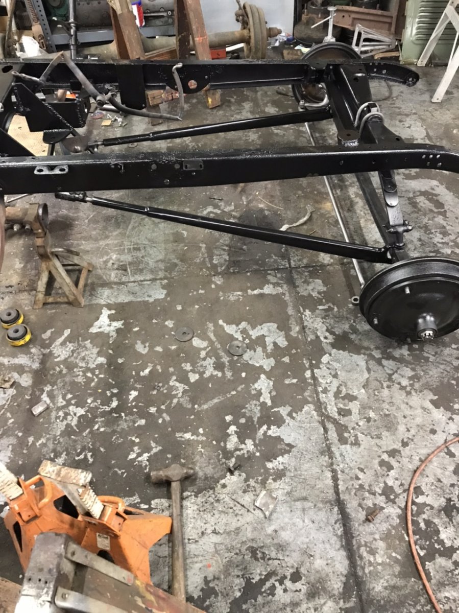

    Axle bolted in for the final time...it’s****embly time! Just need to make the brackets for the wishbones and paint the rear axle****embly and take a couple leaves out of the rear spring. Forward progress....YAY!!
