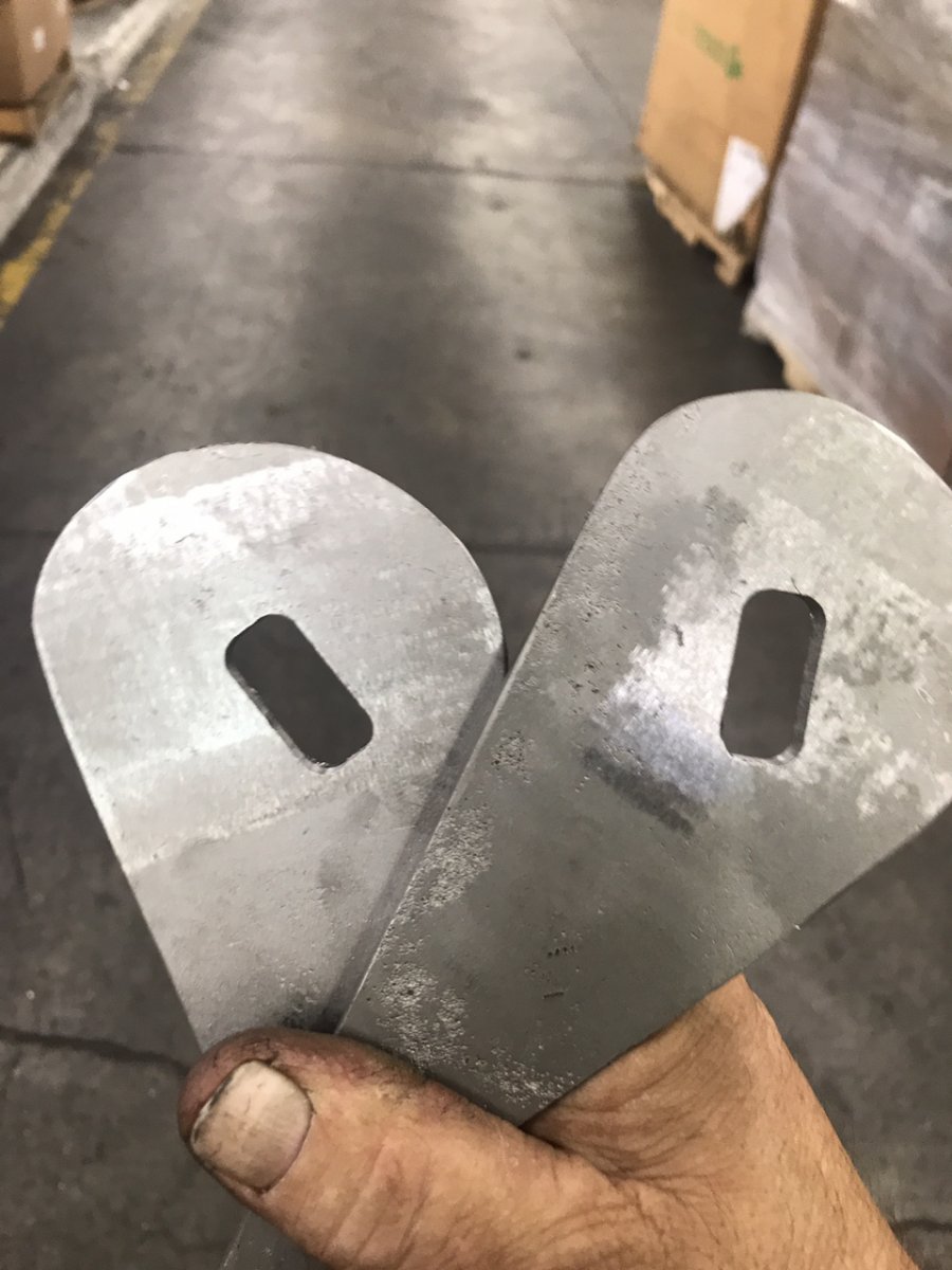

    Welded up my brackets.....I’ll have to take care of set back, thrust angle and all the other happy stuff once rear axle is done and engine is in place and yada yada etc etc....I’m very happy with how the wishbones turned out! Making progress.....thanks for stoppin’ in fellas! 61472063669__3B5D2FF2-5E65-494B-8498-0E9DEB52D785.JPG IMG_2344.JPG IMG_2346.JPG IMG_2347.JPG IMG_2352.JPG

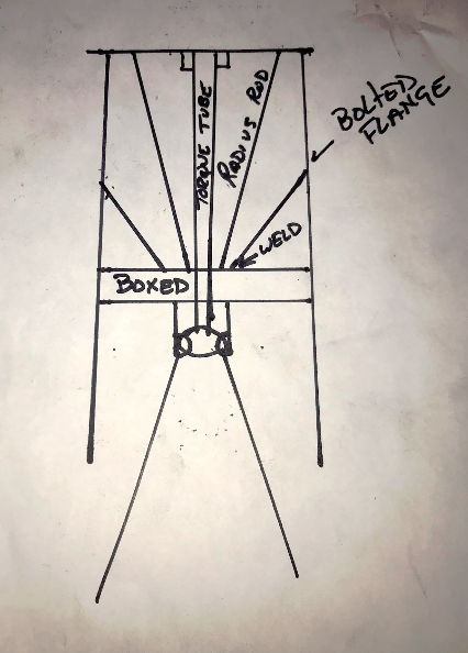

    Can you join the two sides together? It would stiffen it up a lot. Forgive me, but it is looking a bit "bitty", as if the radius rod mounts are an afterthought. The radius rod mounts need to be a lot stronger than the trans mount. Lots of heavy push pull loads under braking. Make sure it is all braced fore and aft.
    Mart.

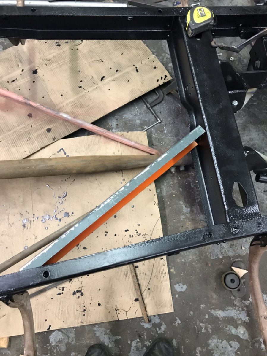

    Piewagn
    I'm making the Xmember removable and I'll be boxing it. I'll be making my reinforcements and tying the xmember diagonally from the center point to the rearward frame rails....Once I have the geometry correct, the wishbone brackets will be welded to the trans mounts. The trans mount itself will tie them together.....

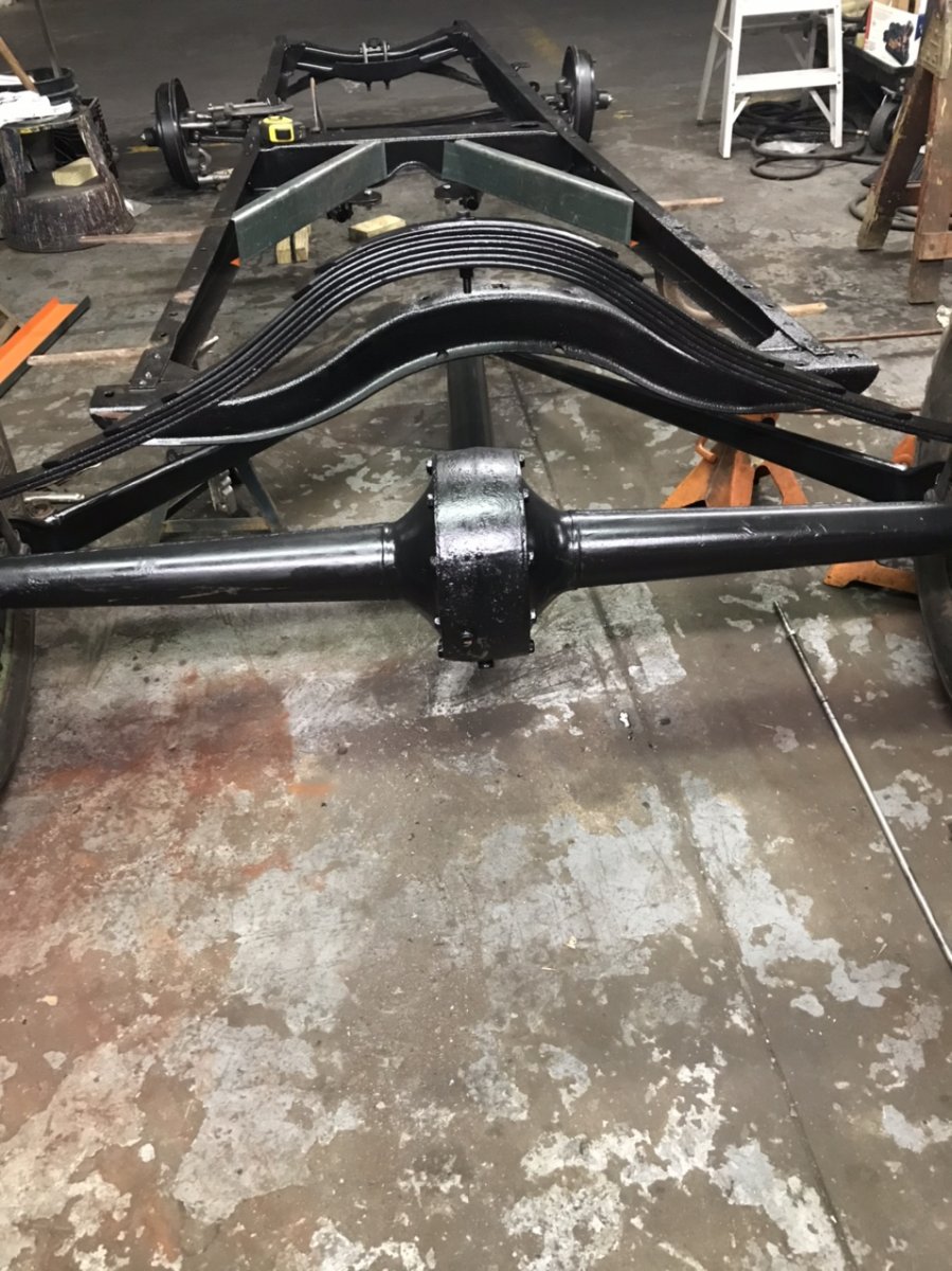

    Piewagn
    I’ve removed 3 leaves from rear spring ***embly...Spring back together and rear axle ***embly ready for final install! Guess we’ll see how it is once we get the body on and load it up..... IMG_2376.JPG IMG_2377.JPG

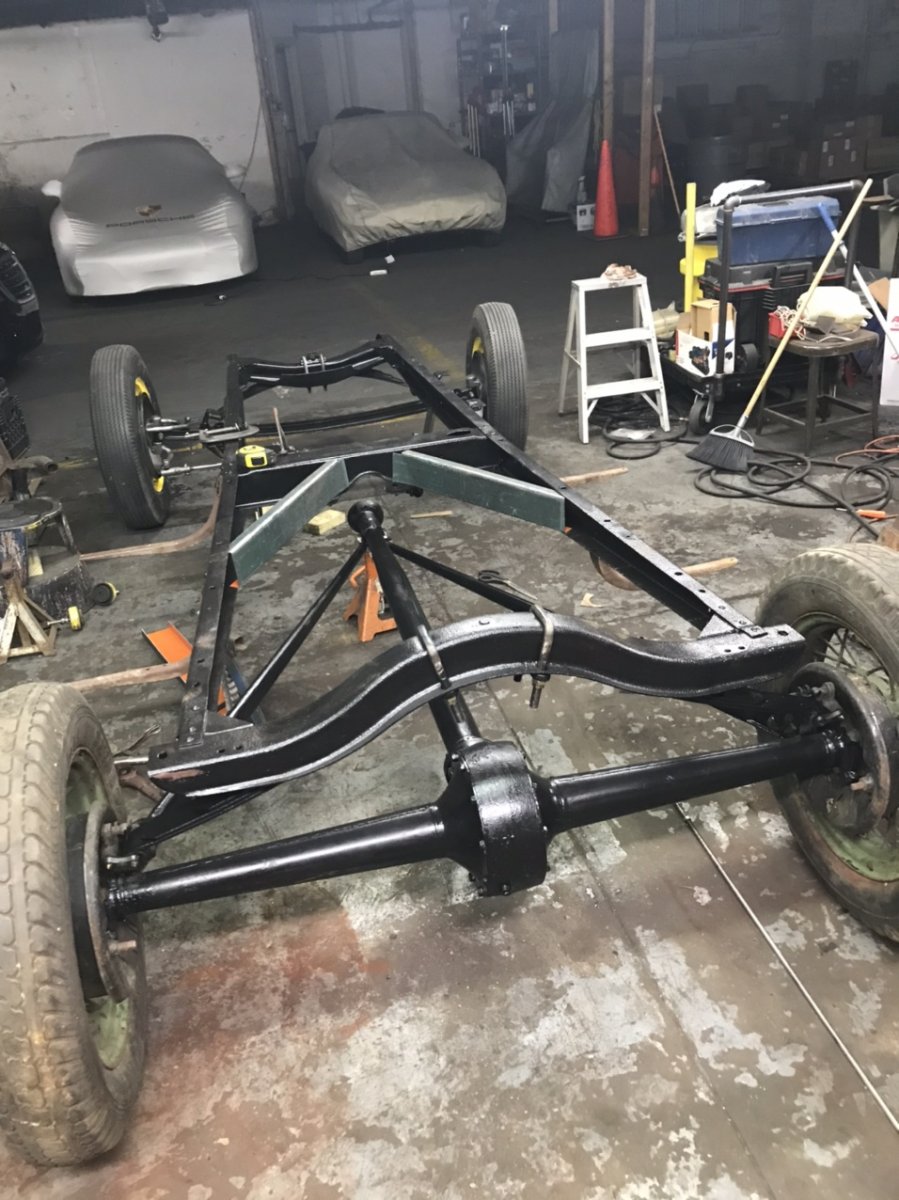

    Piewagn

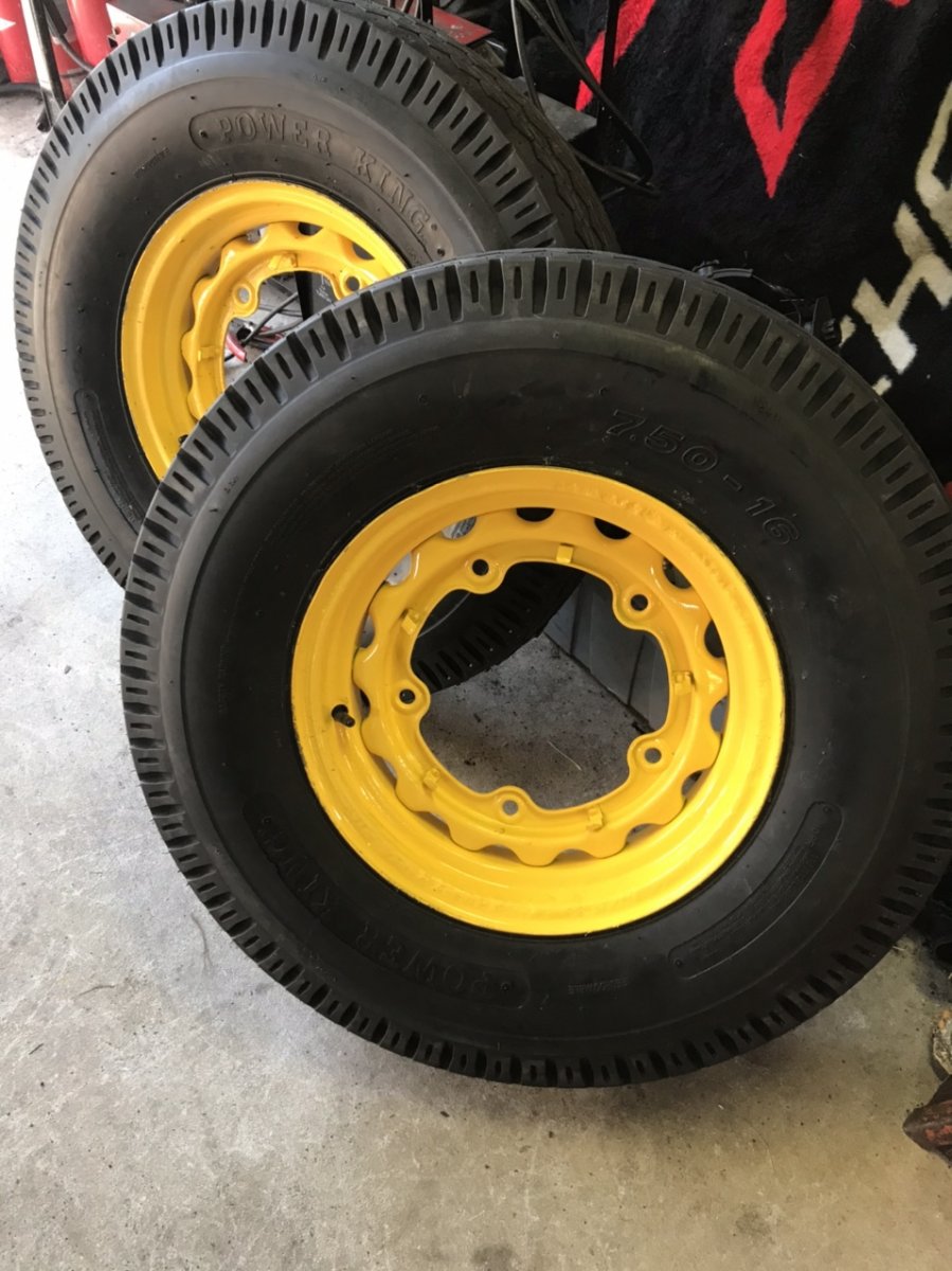

    I think I heard somewhere in the past that it’s a big day when your build at least finally becomes a roller....well, I think I’ve reached that milestone and to be honest.....I’m EFFING jazzed!! I’ve had my down moments when I just wanted to give up and sell it all.....but here she is so far! I’m very excited to be at this point in the process. Thanks for stickin’ with me fellas....plenty more to come! IMG_2380.JPG IMG_2381.JPG IMG_2382.JPG IMG_2383.JPG IMG_2384.JPG

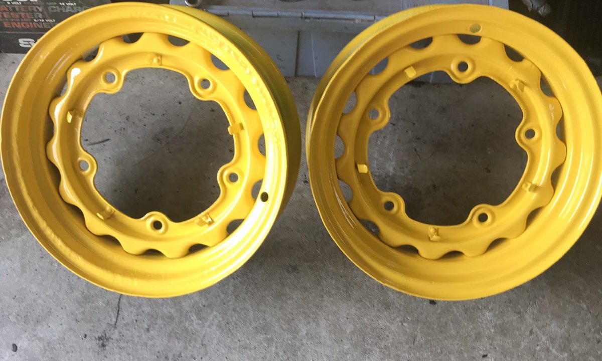

    Piewagn
    Rear wheels painted! I’ll be getting some real exercise while mounting the tires tomorrow.....gotta swipe the Wife’s baby powder when she’s not looking....[emoji16][emoji16] Adjustments.JPG

    I like the blackwalls and yellow wheels. :)

    Thanks LB! Body satin black and engine block same yellow.....

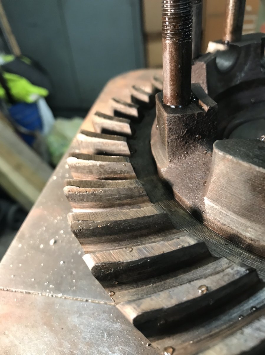

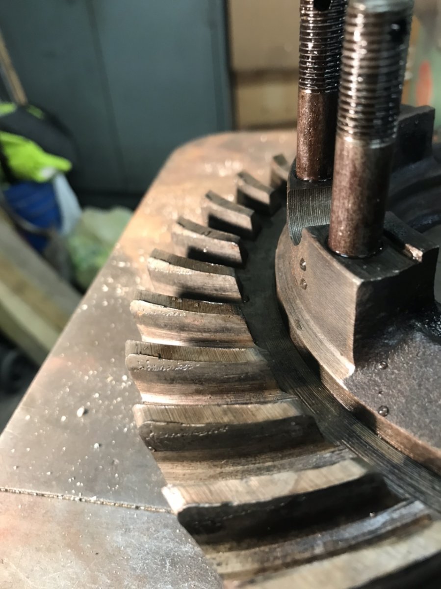

    Piewagn

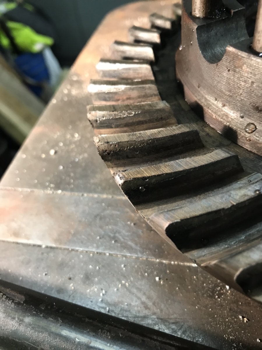

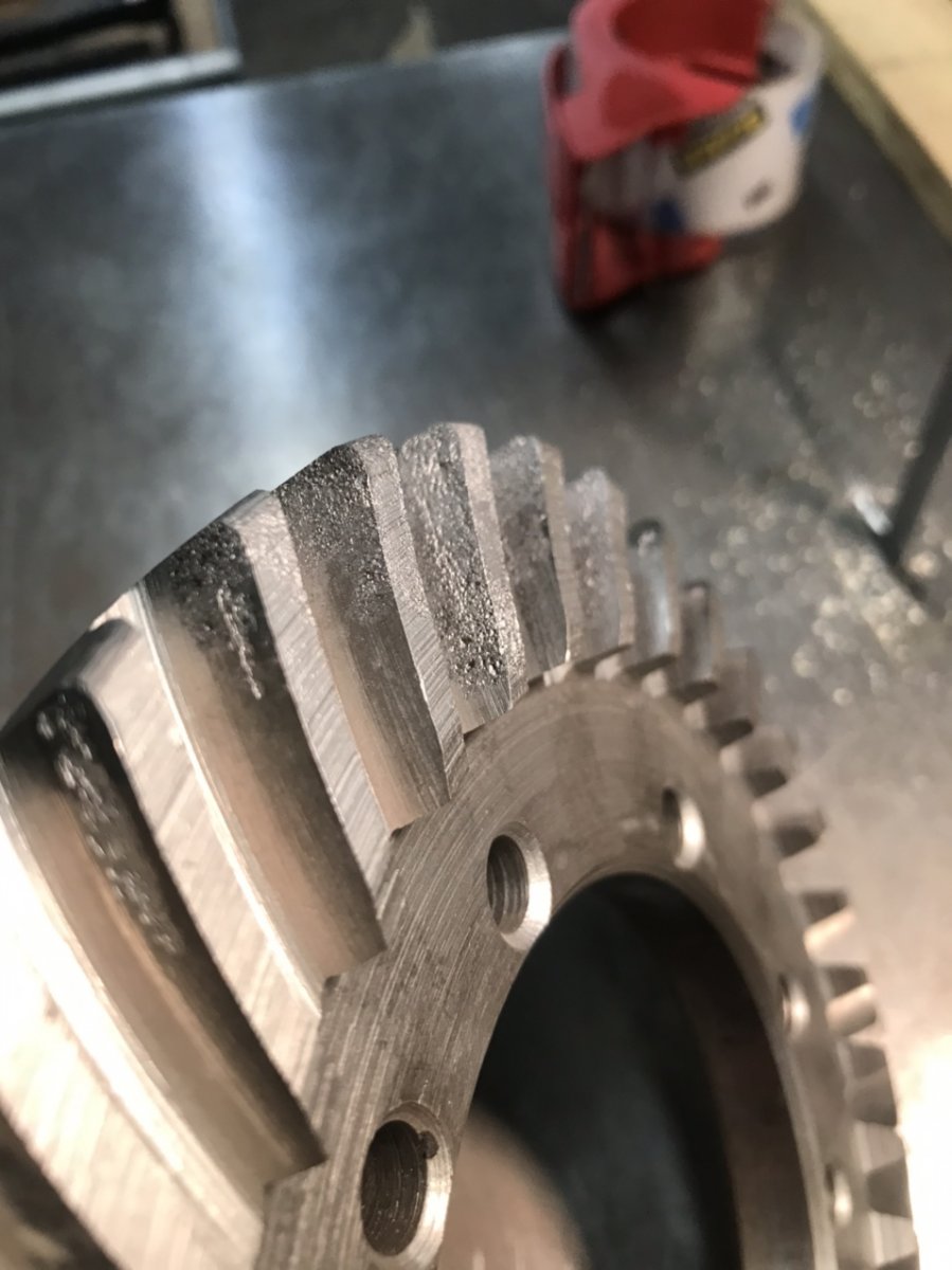

    Yeah....this is the best out of what I have....all 3 pics same gear....looks like pinion depth not set right wearing the toe of the teeth....I do have one that’s got some pits from rust and some wear on the load side of the teeth....I just don’t have 500.00 for a ring and pinion set.... IMG_2405.JPG IMG_2406.JPG IMG_2407.JPG

    Piewagn
    Now, I can manage to cobble together something with the sketchy ring and pinion. I would need to make a decision on which set to use. One is out of the question....too rusted. It's a shame someone left it out, because there's virtually no wear! Then there's the one with some pitting from rust and some normal wear, Or this one here with the abnormal wear on the teeth. Pinion looks good though. I could set pinion depth correctly and maybe get SOME life out of it. Odd the pinion doesn't show a goofy wear pattern like the ring gear. Any input is appreciated fellas! Thanks!!

    Aaron D.
    If it were me I'd use it and set the pinion depth correctly. Let it wear into the wear mark. Haha.

    Piewagn
    That's EXACTLY what I was thinking Aaron! I'm gonna wait and see if Koolbeans' APB shakes anything out.....

    This is the worst spot I found on the other gear I cleaned up....pinion looks good. I’ve decided to go with this gear unless Koolbeans’ APB produces some results ( thanks KB! )..... I’m still waiting on parts so there’s some time.....

    That ring gear doesn't look good, I wouldn't want to run that one! I would worry about whether or not that would hold up. Hopefully KB's APB yields a better choice for you.
