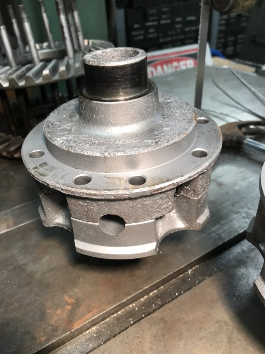

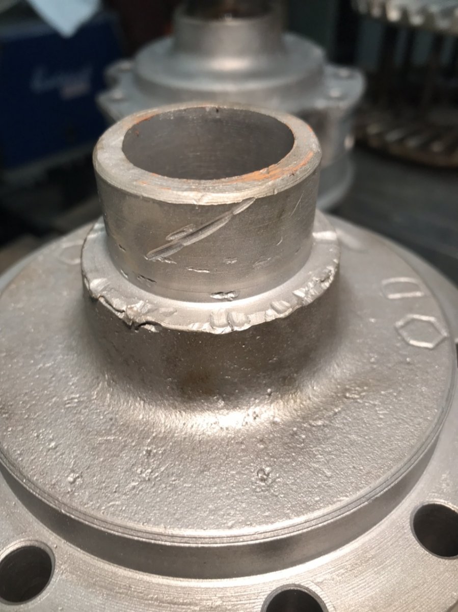

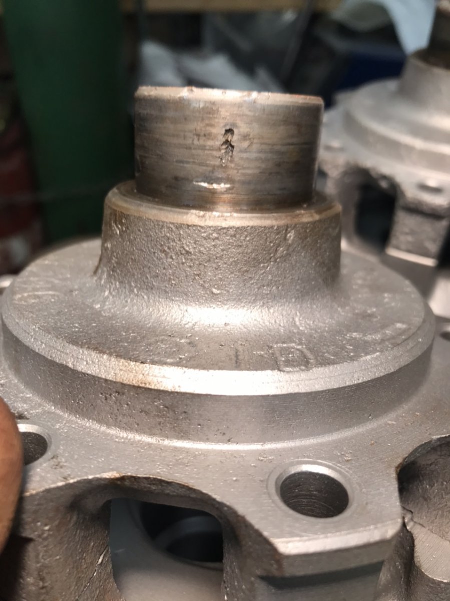

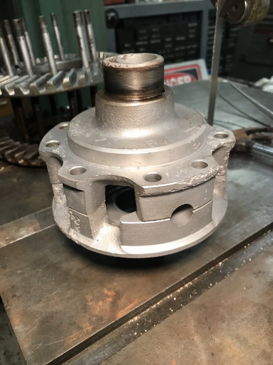

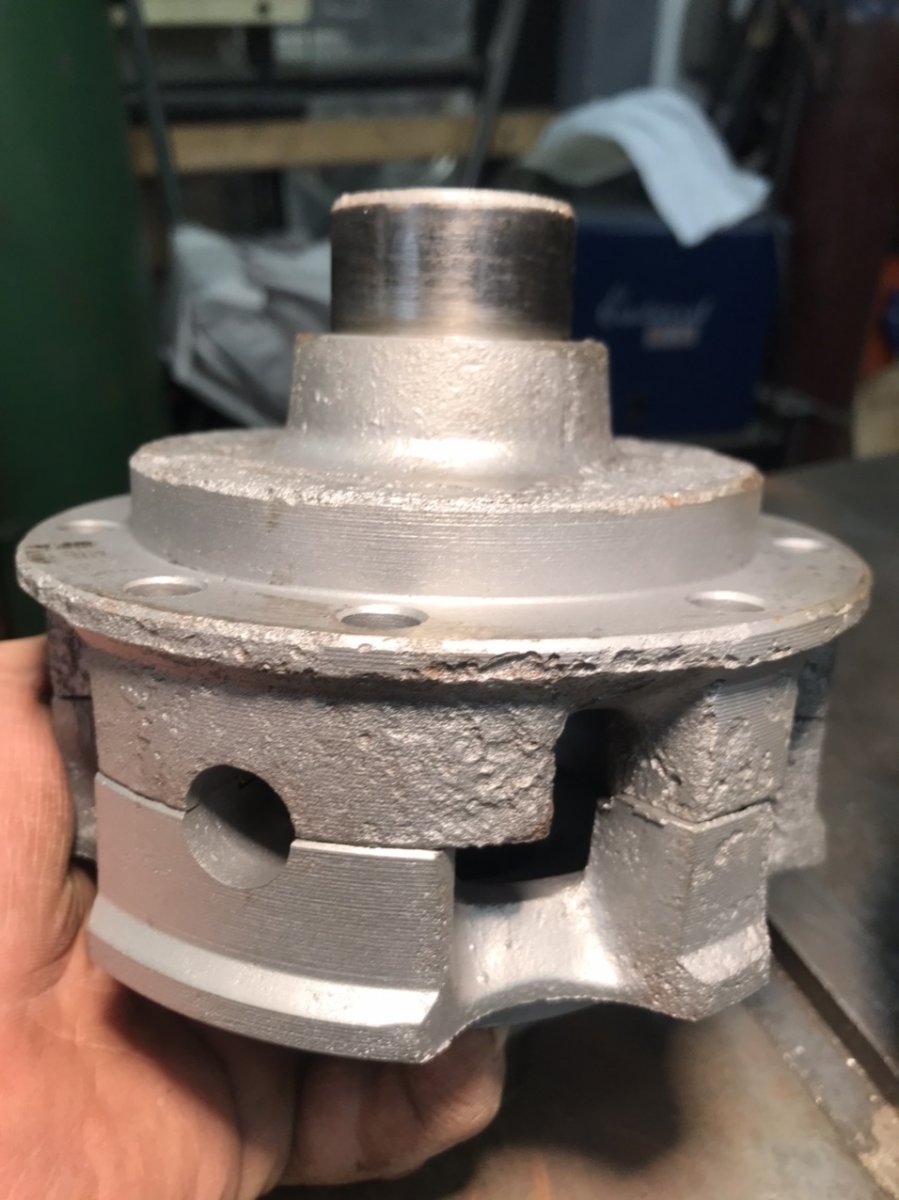

    Ok....I’ve got 2 carriers. One is more worn and the bearings basically aren’t a press fit anymore, they’ve been replaced so many times or from just plain hackery, that I can knock them on with a mallet! The other shows minimal signs of wear, but is pitted from rust because it was left in the elements. I’m leaning towards the pitted one because of wear and bearing retention. What do you guys think? Any input would be greatly appreciated.....thanks fellas!
    First 3 is the worn one....
    Second 3 is the pitted one....( inner axle and spider gear surfaces are virtually unworn )

  3. Dick Stevens
    Joined: Aug 7, 2012
    Posts: 4,175
    Dick Stevens
    I would use the worn one with Loc***e bearing retainer and it could be knurled which will make it press fit again.
  4. Piewagn
    Joined: Mar 25, 2009
    Posts: 1,542
    Piewagn
    I thought about the retaining compound, but my concern is the ******ed bearing land not allowing proper ring gear lash. I should've got pics of the inside where the spiders and the back of the axle gears ride. They're a bit wallered out and I'm also concerned with axle end play.....I'll take some measurements. We DO have some heavy duty retaining compound too....
    I've got some decisions to make..... Thanks for the input ****!!

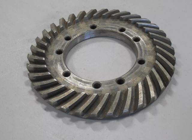

    Better pics of the ring and pinion I scored.....the Hotrod Gods were smiling upon me for that moment in time.....knowing my strapped budget, they put an $80 price tag on it too!! [emoji16][emoji16] I’m a happy camper!! Adjustments.JPG Adjustments.JPG

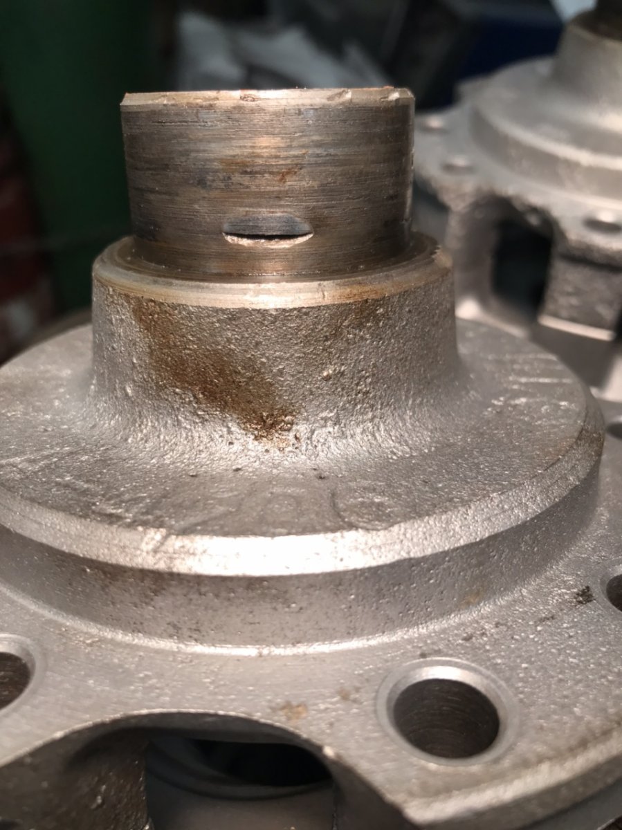

    Cleaning things up and gathering the best parts out of the 3 differentials I had. Good axle housings already clearanced for the hydraulic backing plates and wheel cyls! My bearings came today from Rock Auto! The one double race that’s priced at 60+ bucks at the Ford parts suppliers was priced at $22 from RA! Like I said, the hotrods gods smiled upon me when I was feeling a little down.... IMG_2431.JPG IMG_2432.JPG IMG_2433.JPG

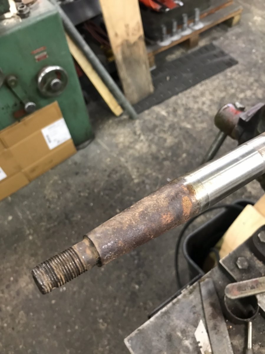

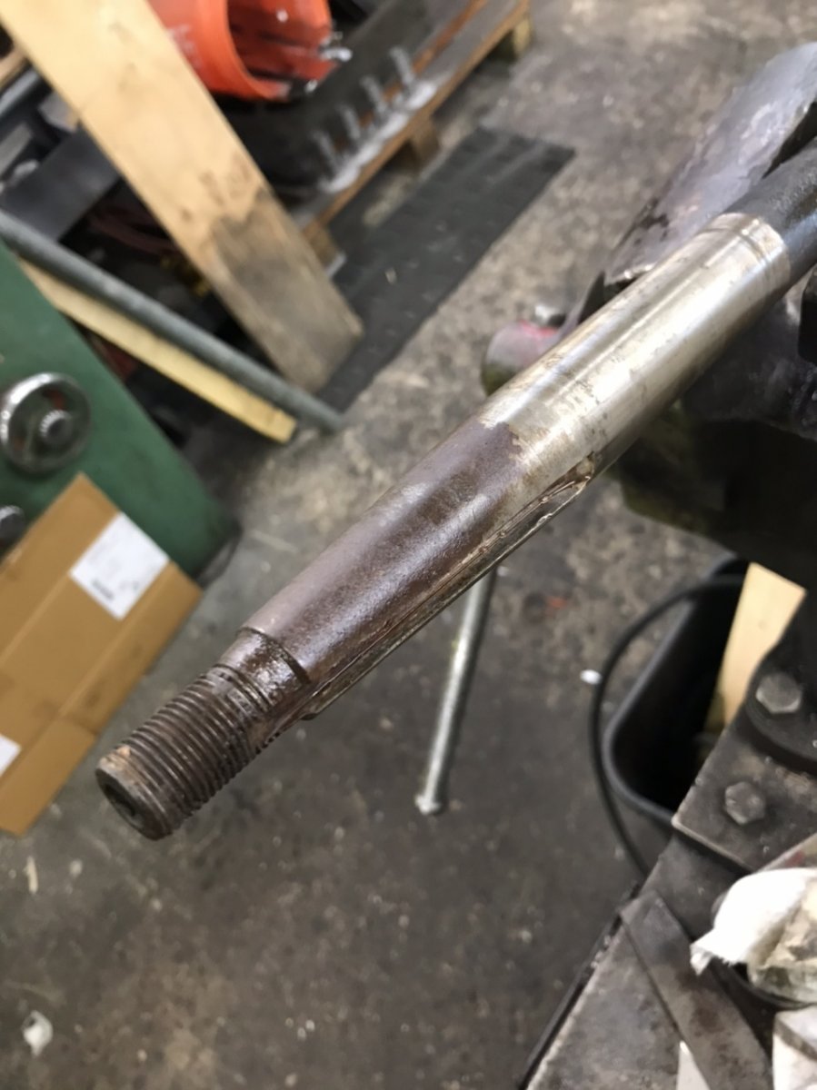

    The axles I chose came out nice, these should work just fine! Picked my torque tube from the 3 I had and getting that ready for seal and bearing....have a real nice speedo housing and gear as well. Ring and pinion is supposed to be here tomorrow, then I can get rolling putting this thing together and hanging it for the last time.....hopefully!! Thanks for stickin’ around fellas, you all give me motivation to keep rollin’! IMG_2440.JPG IMG_2441.JPG IMG_2442.JPG IMG_2443.JPG

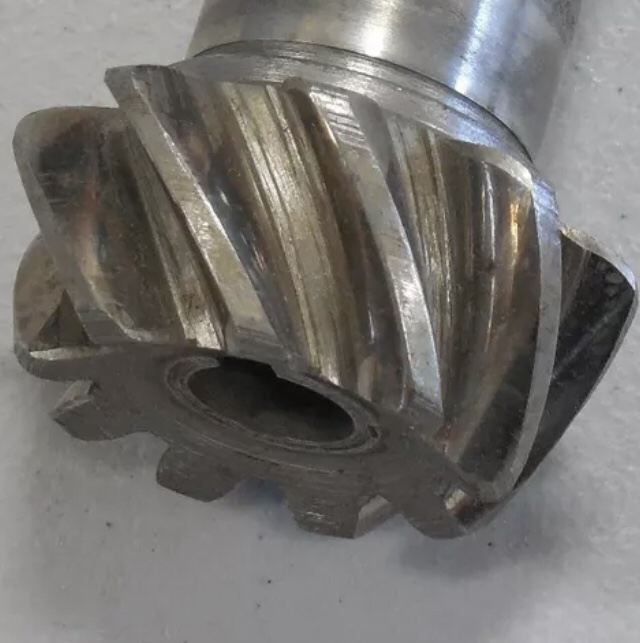

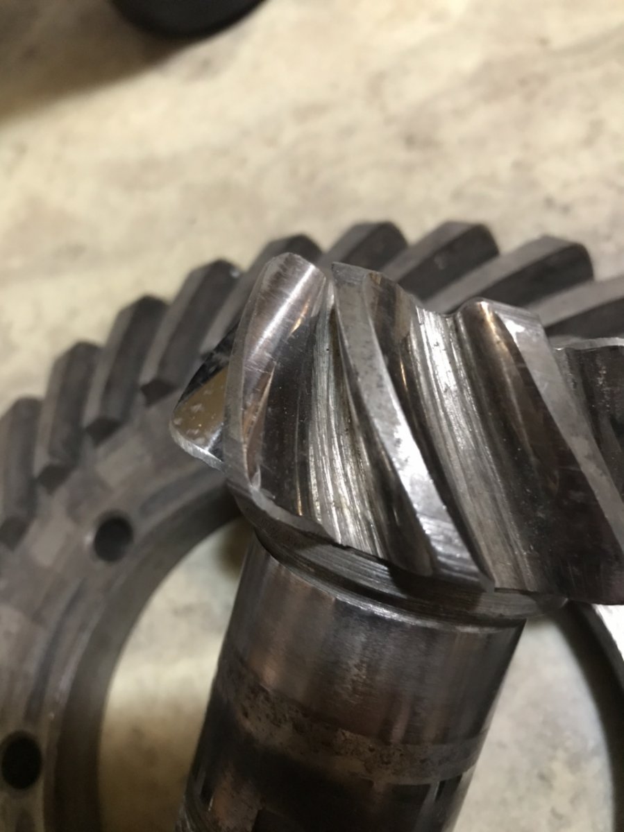

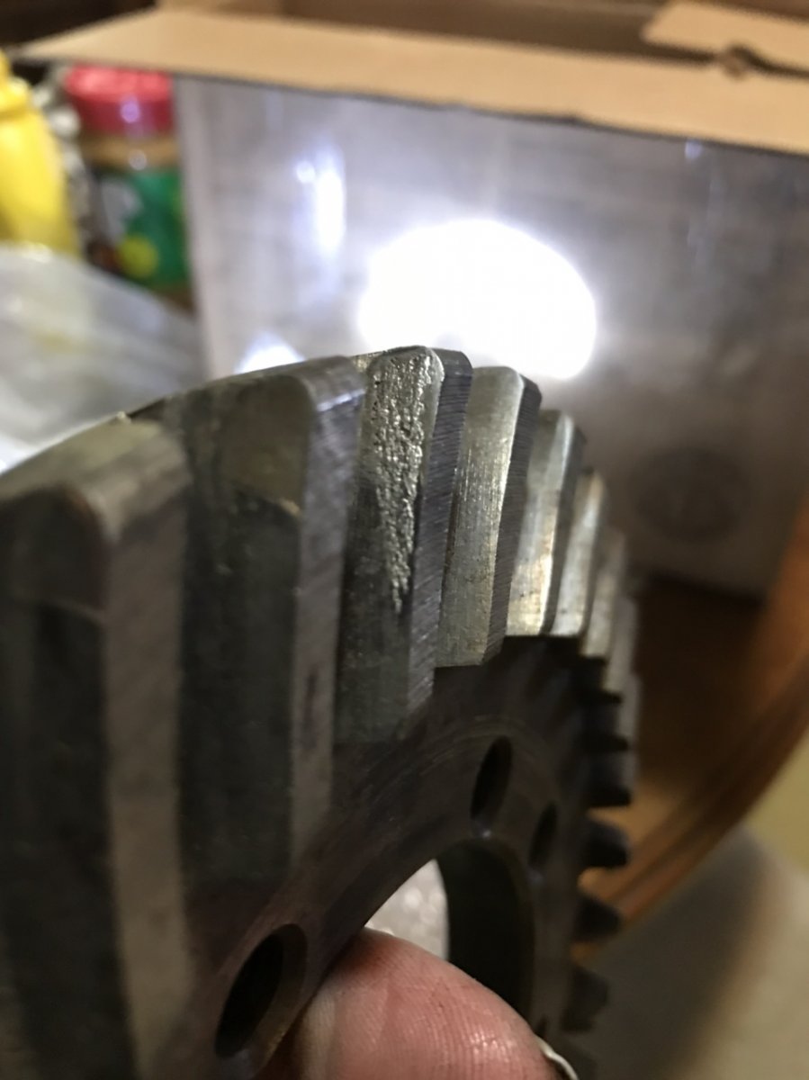

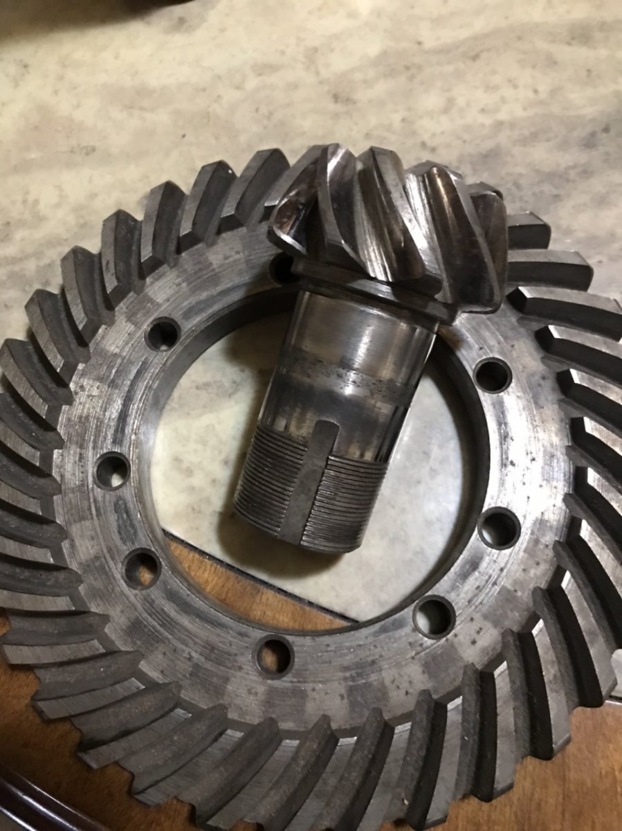

    Ring and pinion came today.....pinion looks great....the ring gear has ONE tooth that’s worn/pitted. The boss, just today, has offered to pay for what I need to get this differential done; that includes a new ring and pinion! I told him we’ll look at these gears together tomorrow and make a decision. What do you guys think about THIS ring and pinion? Would you use it in something? Thanks fellas!! IMG_2444.JPG IMG_2446.JPG IMG_2445.JPG

  10. Dick Stevens
    Joined: Aug 7, 2012
    Posts: 4,175
    Dick Stevens
    I would have to be desperate to use it with that pitting, I would gratefully accept your bosses offer and thank him profusely!
  11. Piewagn
    Posts: 1,542
    Piewagn
    Let me dig up the invoice treb and I’ll post a picture of it.....
  12. Piewagn
    Posts: 1,542
    Piewagn
    I think I am going to take him up on his offer....but that means the trade off for the cylinder heads he was gonna get....
    Although, I do have a feeling he’ll spring for those anyway! He said “you’ve got a fairy godfather that wants to help”......he’s not just my boss, he owns the company!
    Thanks for your input ****.....

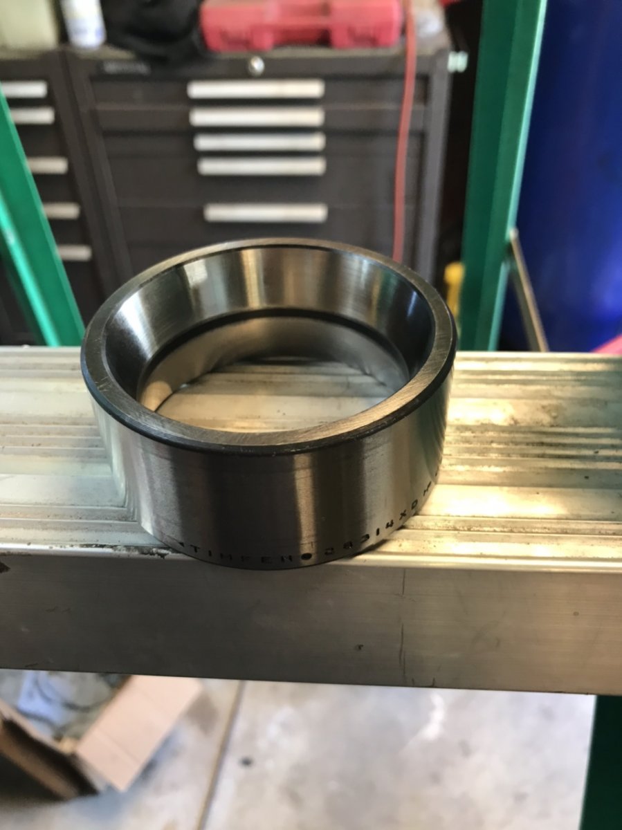

    4x 28156 bearing
    2x 28317 cone
    1x 28314XD Double cone/race
    Type the numbers into RA’s search feature and they’ll come up....

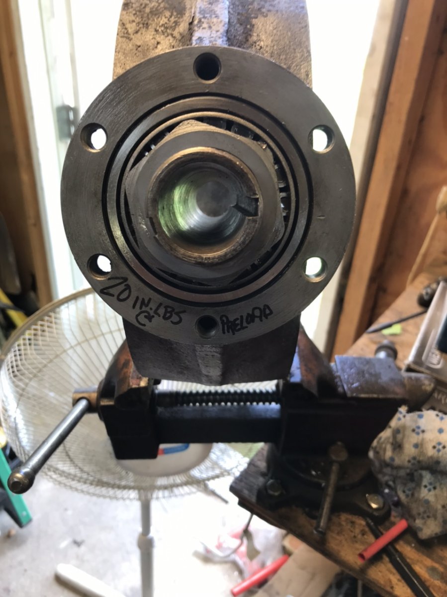

    Set my pinion preload. Spec call for 20 in/lbs. With a thin layer of gear oil, rotation starts at spec and maintains 18-20 in/lbs throughout rotation. I’m calling it done.... IMG_2469.JPG IMG_2470.JPG IMG_2472.JPG

    I don't see any sign of that lock washer that goes between the two nuts.
    loudbang and Piewagn like this.
  17. Piewagn
    Posts: 1,542
    Piewagn
    Well, the lock washer and jam nut went on after I finished up setting the preload.....just didn't get a pic....

    Shutt
    I installed one like that with 3 pitted teeth and a galled bearing; had trouble patterning it and it whined from 40-50. Replaced it.

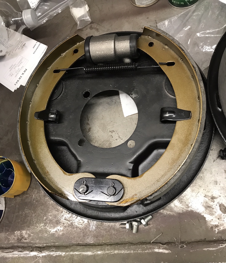

    Got all the brakes ***embled....Looking for park brake hardware, or I may plumb some type of hydraulic lock lever or something.....
    Book says to insert speedo gear with gear end towards the rear...if I do, the snap ring groove is not exposed...I checked witness marks on the other drive shafts I have and it looks like gear side was towards trans....I don’t remember how they came off....any input on this?? IMG_2492.JPG Adjustments.JPG

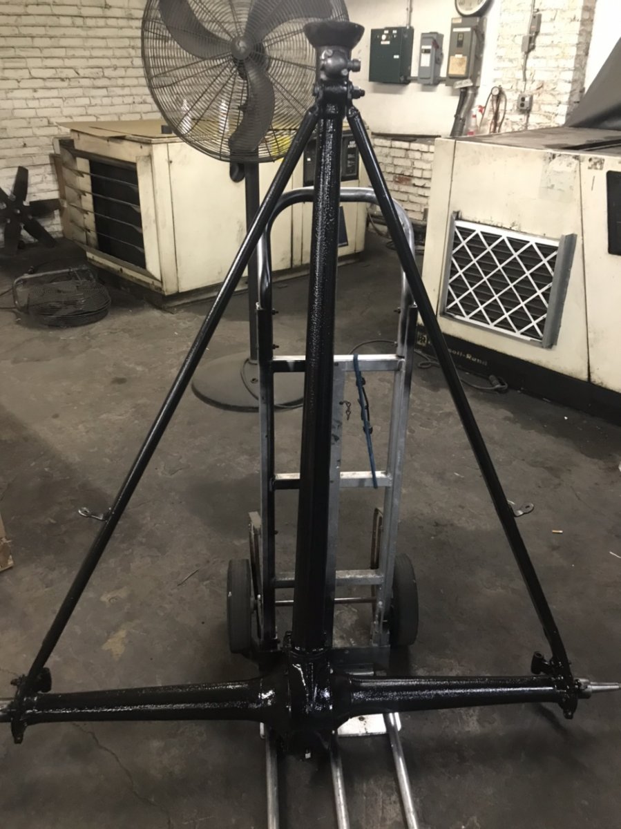

  30. Piewagn
    Posts: 1,542
    Piewagn
    Paint will be dry by morning then I’m ready to hang it! Thank God.....only ate up about 3 weeks! Hopefully things will hit cruise control for a while now, we shall see.....thanks for stoppin’ by fellas!! IMG_2493.JPG
