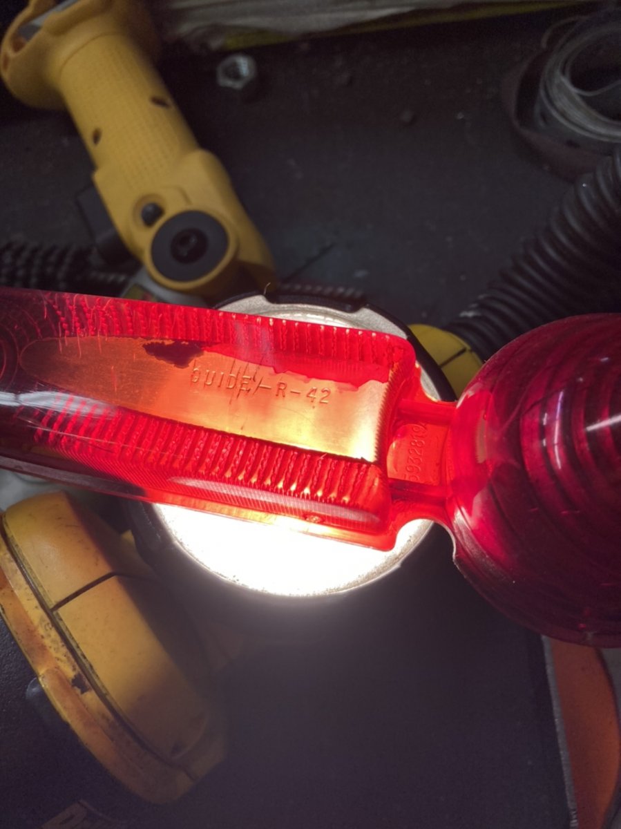

    Don’t know what made me think of it.....AND the solvent in the ****m kinda “etched” into the plastic, or it “activated” the plastic and the dye kinda like “melted” into the plastic....I was amazed....

    Did you paint that on the inside or outside? That is a great trick!

    Awesome change. Have you tried shining a light behind it to see how it looks lit?

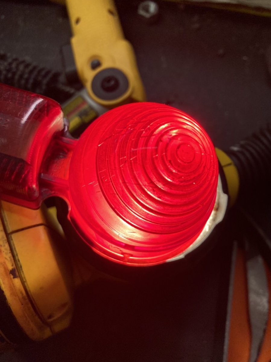

    I hit it with the rouge wheel first.....then did the inside and outside....buffing turned the white clear....then hit the inside first....then the outside. I took photo before I finished the entire lens. Unfortunately.....one lens was too crispy from sun damage and the rouge wheel broke it......buffing brings the white up as clear....then I hit it with the ****m....
    guitarguy and loudbang like this.
  6. Piewagn
    Joined: Mar 25, 2009
    Posts: 1,542
    Piewagn
    Looks awesome with a flashlight!

    Entire lens finished....looks pretty good to me!!

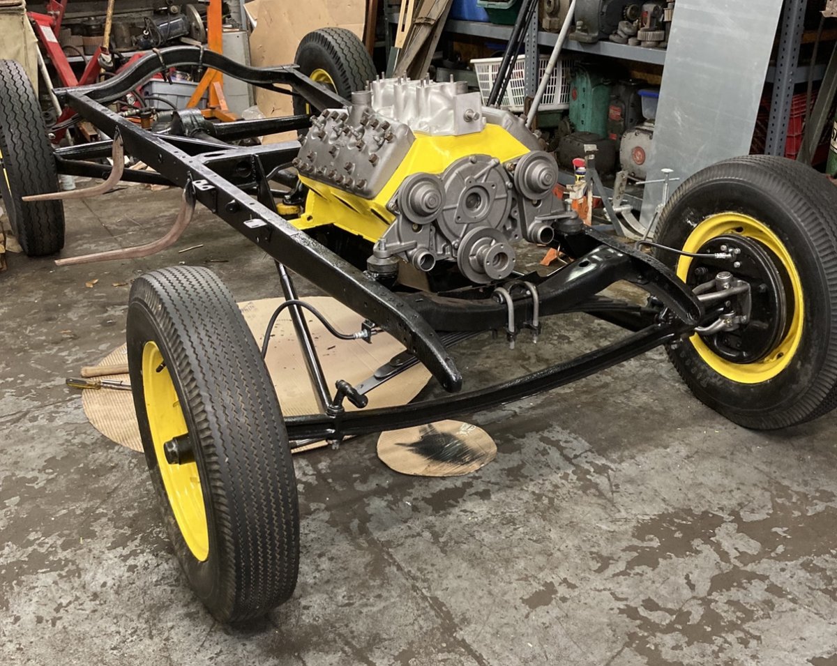

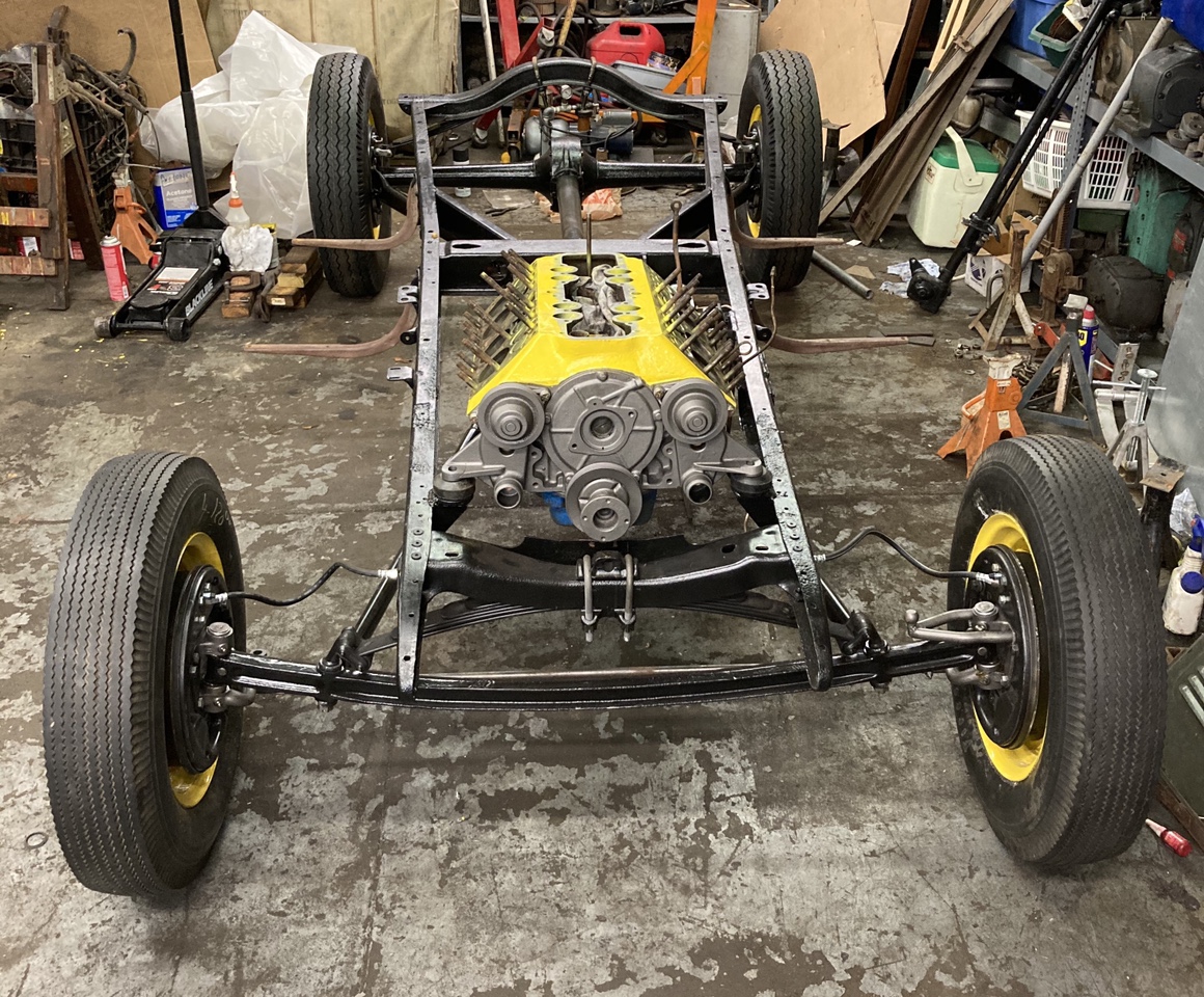

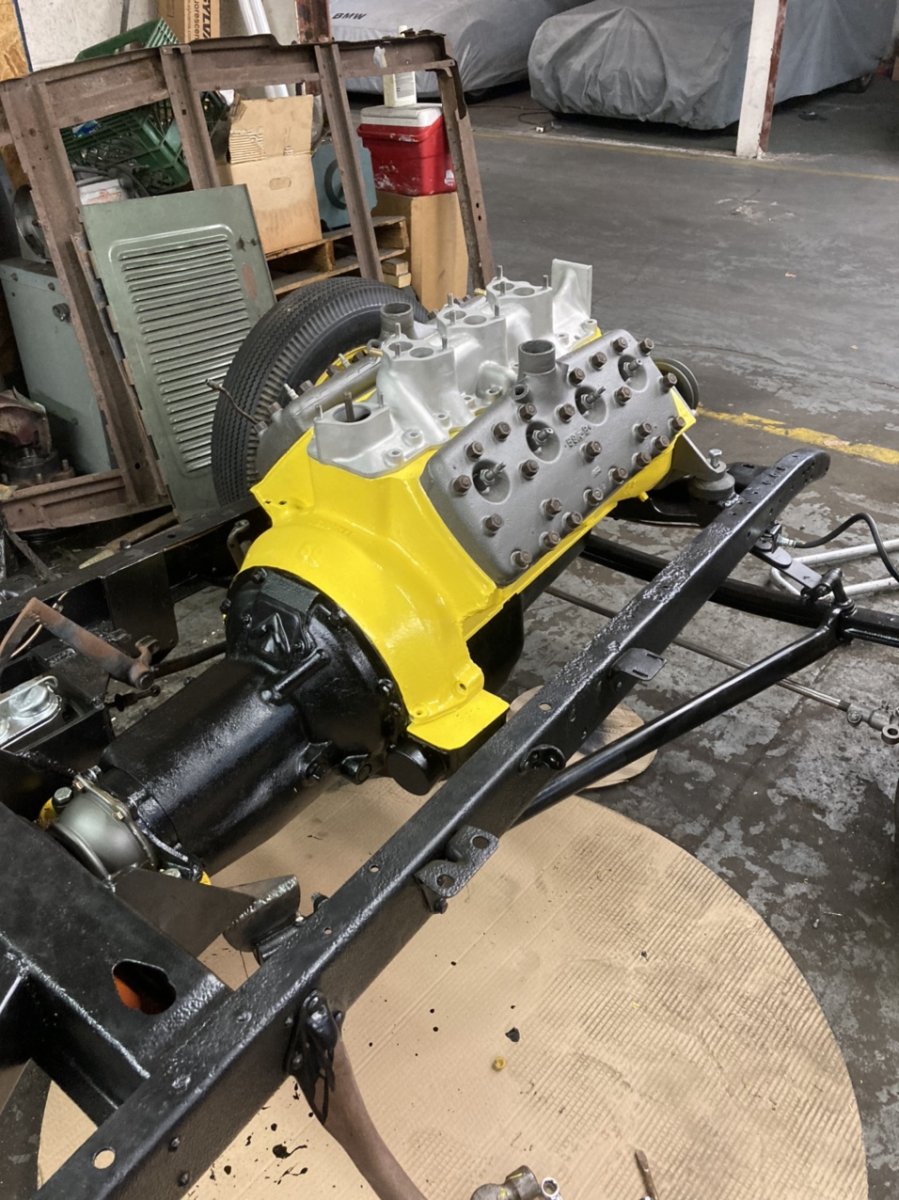

    Got my trans bearing retainer with new gasket bolted up....prepping to drop engine in. Finished the yellow portion of the eng/trans ***embly, the rest will be satin black. I painted the water pumps with the cast blast, along with the timing cover and crank pulley.....I’ll be painting the gen the cast as well....gonna look awesome!!
    Oh yeah.....picked up my manifold and carbs over the weekend! I had forgotten how the****utic and enjoyable a build can be....all else melts away when I’m workin’ on the coupe....

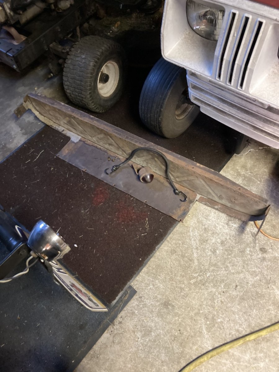

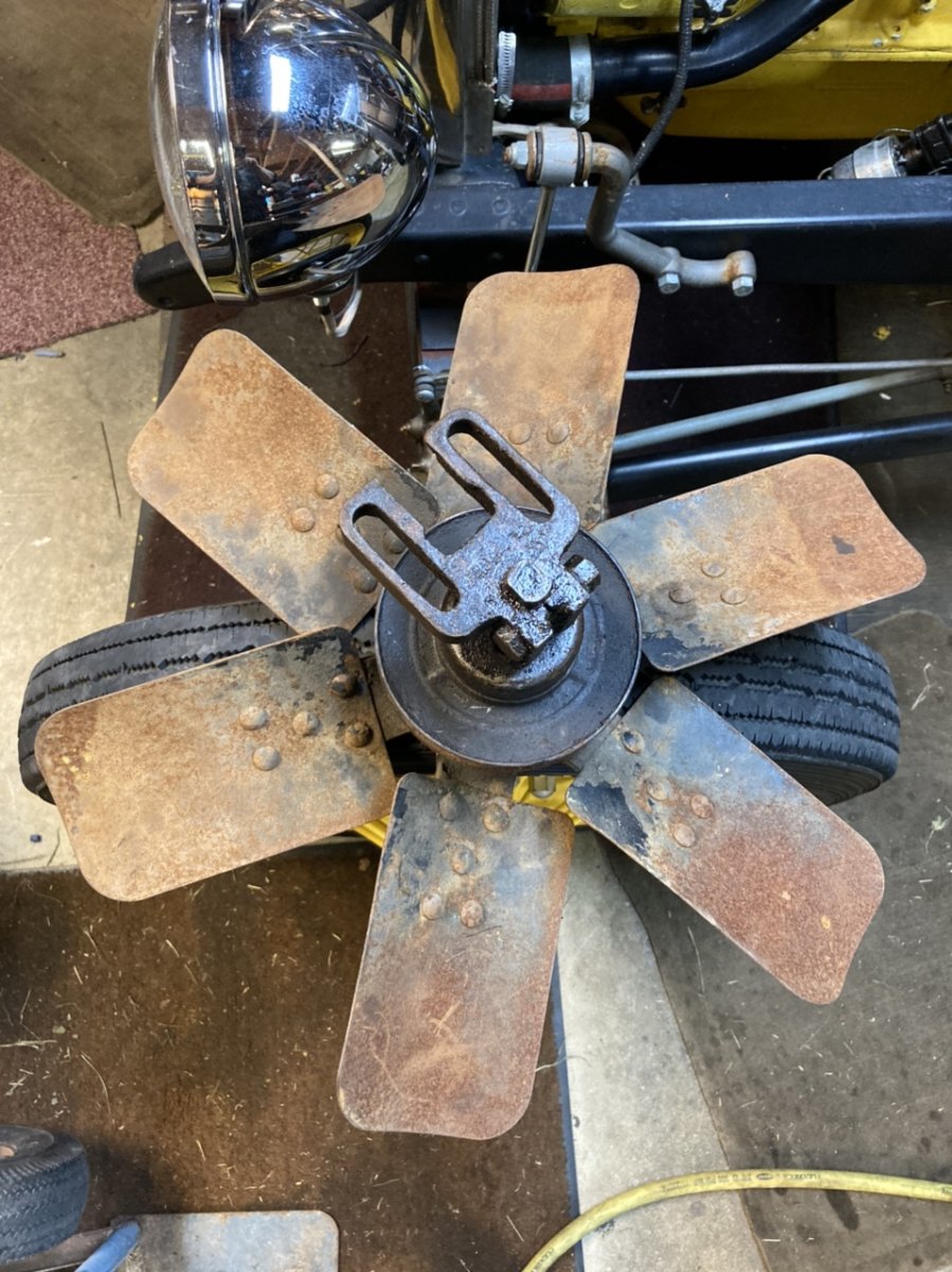

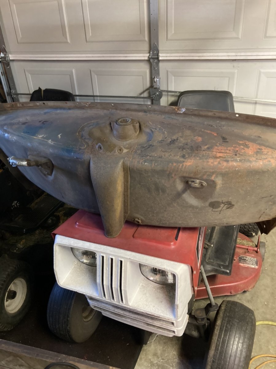

    Picked ip some goodies at Carlisle today! A ****py gas tank so I won’t have to feel guilty about hacking up a cherry one, a nice clean package tray, 6 blade fan and a fuel pump with the auxiliary vacuum pump! Some other odds and ends.....had a great time **** shopping!! IMG_0182.JPG IMG_0180.JPG IMG_0181.JPG 62334272882__7BEEA673-3E6E-4321-988E-097D9862CA31.JPG

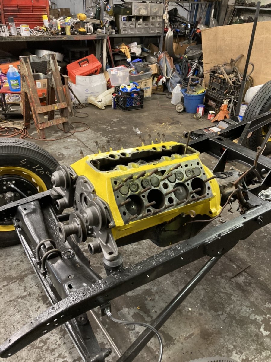

    Finished up some small things tonight. Painted the oil pan and trans, secured the rear mounts after scavenging for some nice long 1/2” bolts and bolted up the u-joint housing.....comin’ along.....little by little.... thanks for hangin’ out fellas!! IMG_0211.JPG IMG_0212.JPG IMG_0213.JPG IMG_0214.JPG

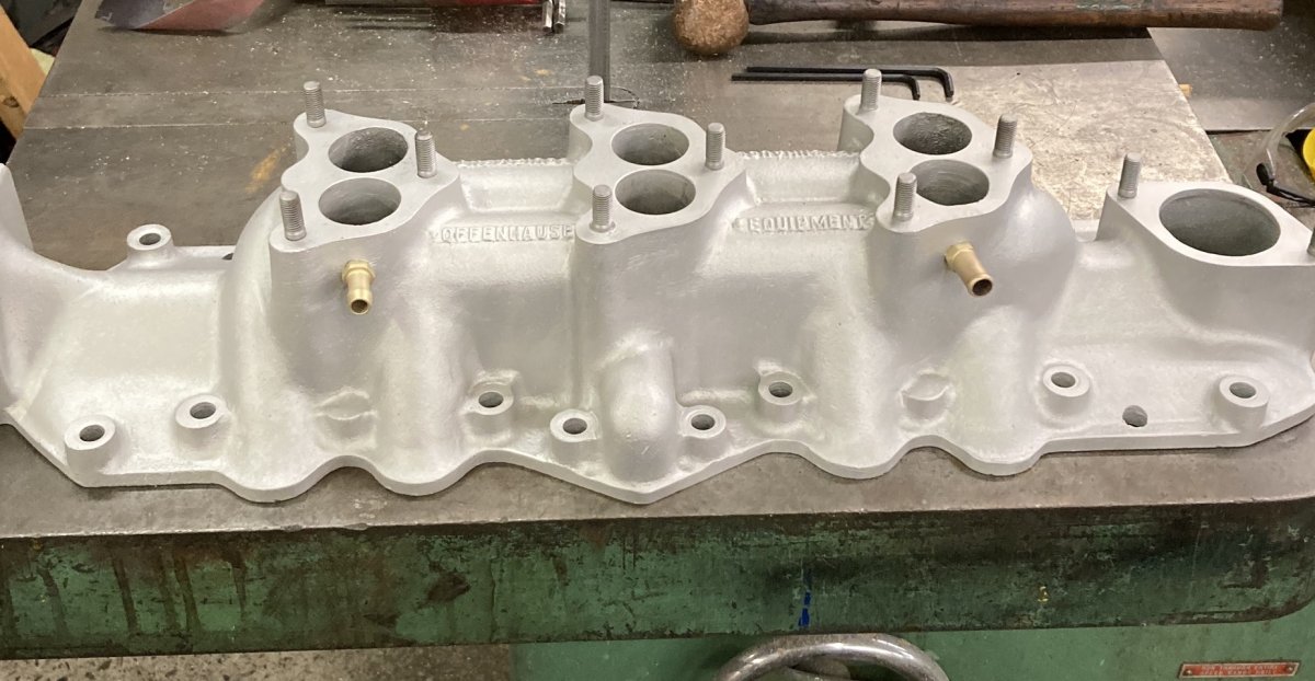

    Just curious.....why the two vacuum fittings on the intake manifold instead of one?

    That I couldn’t tell ya Norris....it’s the way I bought it....I’ll plug what I don’t need. Thanks for stoppin by!

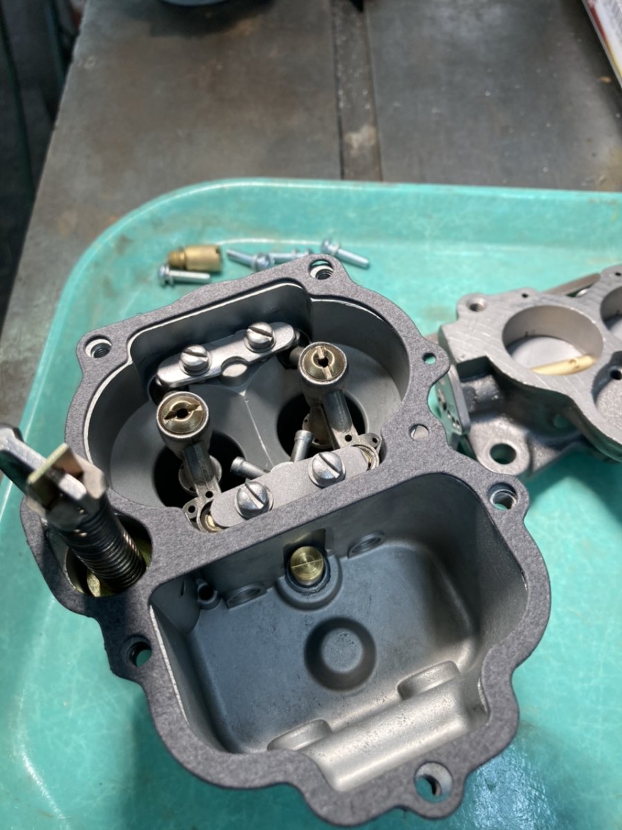

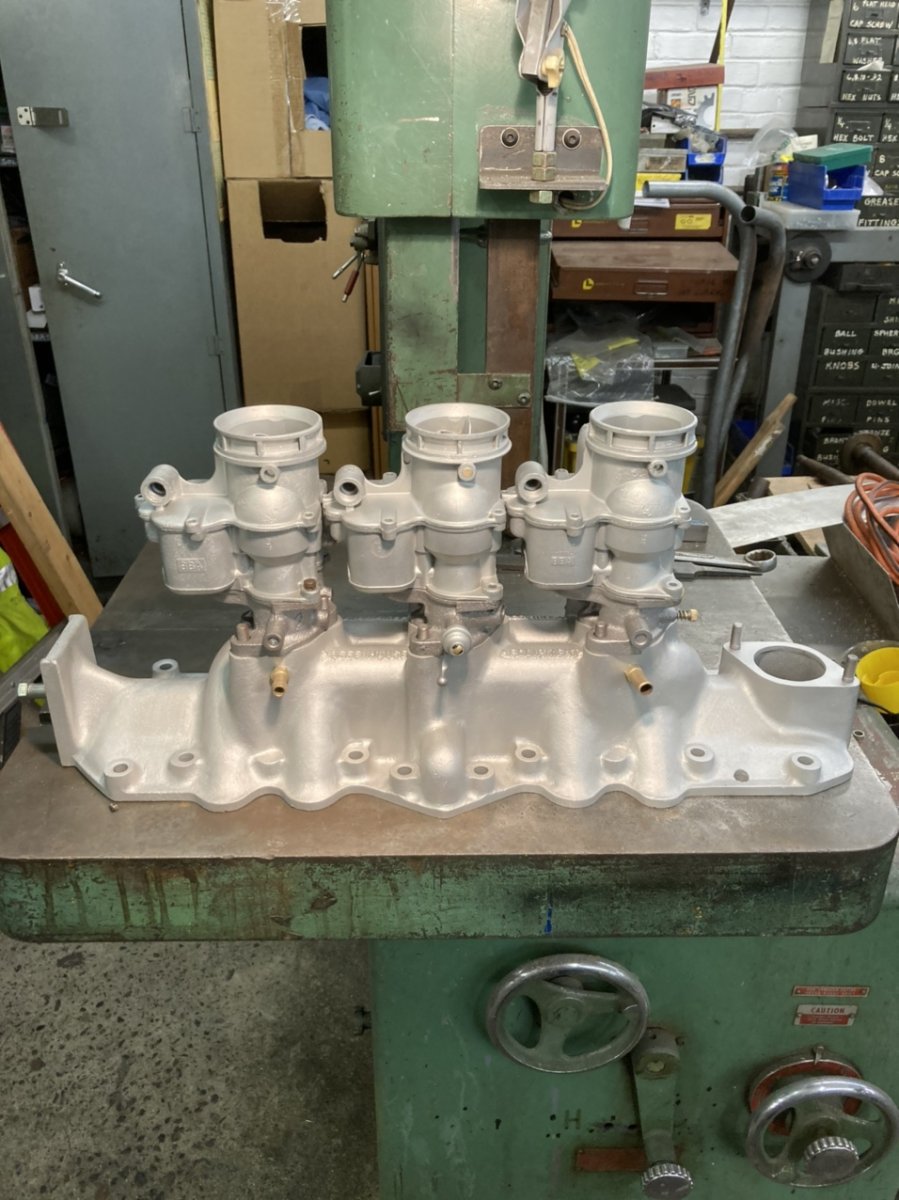

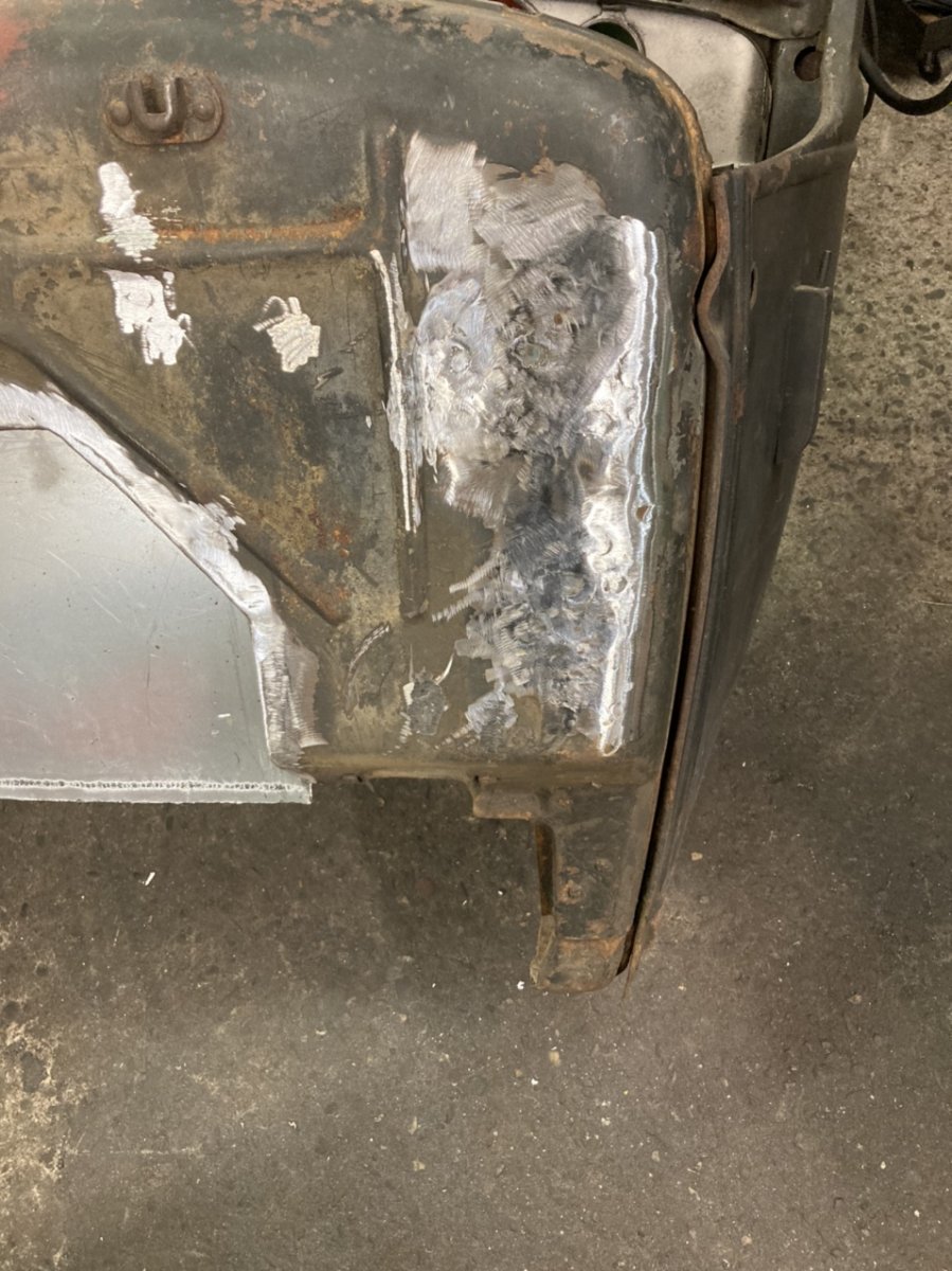

    Finished up one carb in my spare time today.....and....my favorite of all time....grinding....ech! I’m gonna price out recessed firewalls....it may just be worth it..... IMG_0231.JPG IMG_0232.JPG
