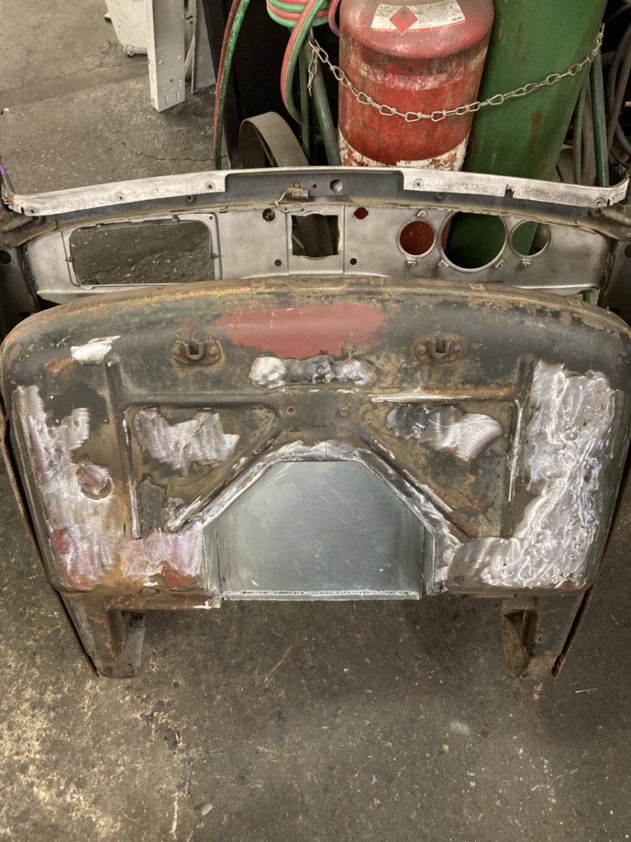

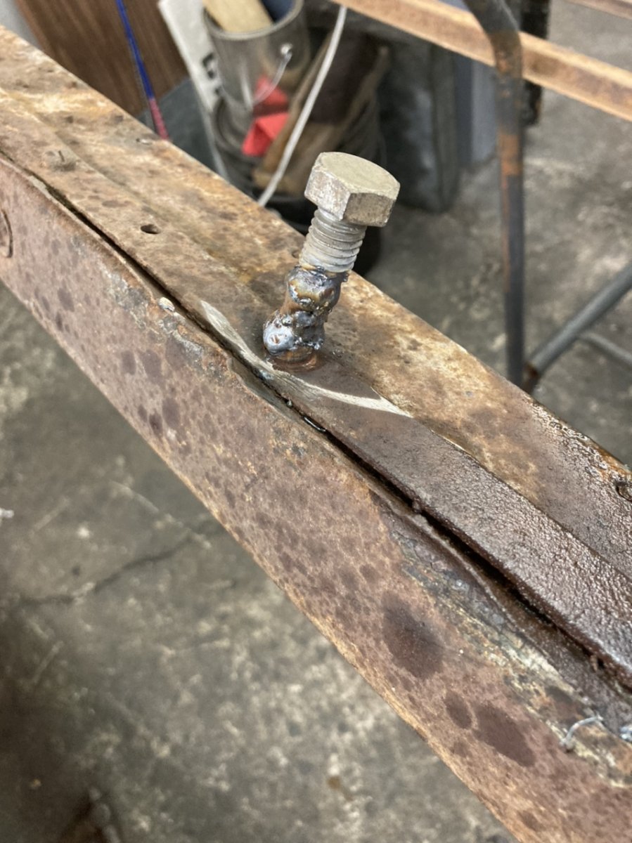

    Ok....major grinding done on this thing.... I was close to packing it in on this....BUT.... I’m sure I can work this and it’ll look great! There was a huge dent on the driver side that had me leaning away from this one....but I pounded it out and it’s actually square....it’ll work! IMG_0235.JPG

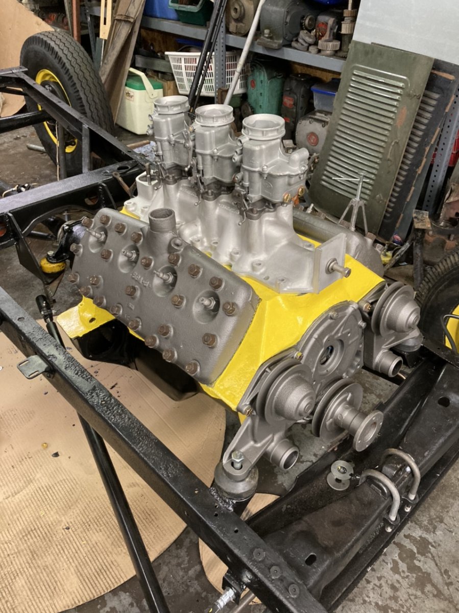

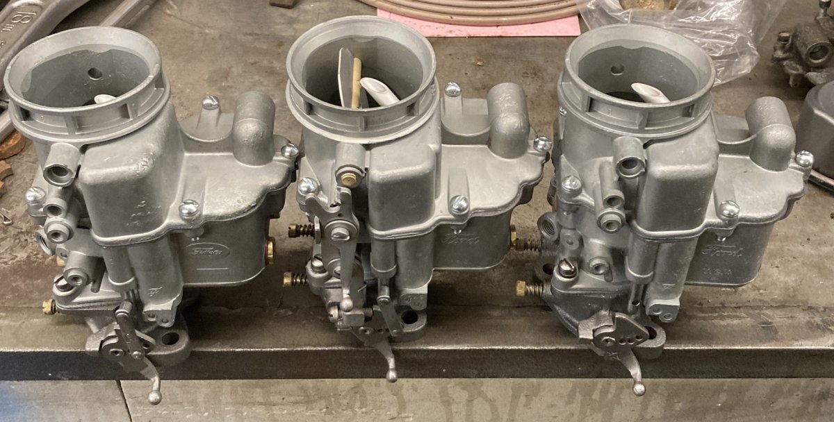

    Carbs done....oops, forgot the accel pump linkage on the end carb....[emoji16] I’m finally starting on the body! Subframe needs some work, but nothing I can’t handle! Of course all the bolts across the back end broke, but it’s all part of the game. I’ll figure something out.....Thanks for hangin’ with me fellas!! IMG_0238.JPG IMG_0239.JPG Adjustments.JPG Adjustments.JPG

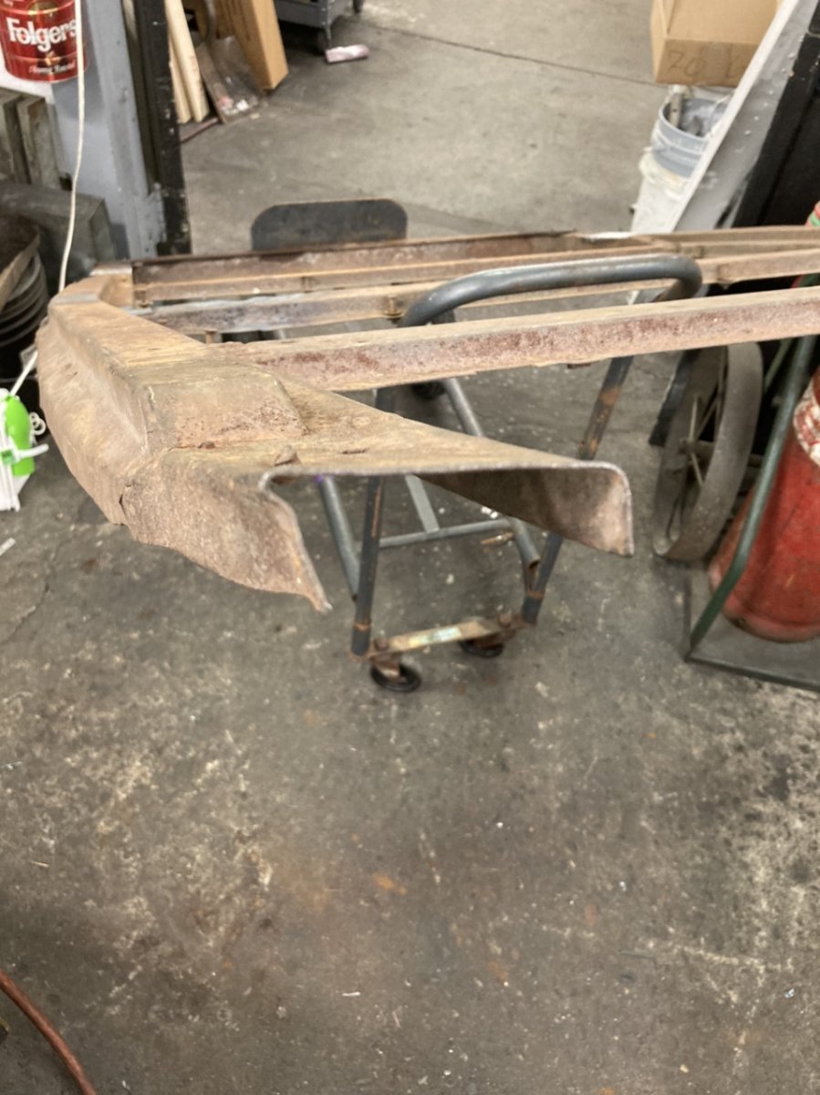

    Worked on the subframe today....by all of MY deducing, I’ve gotta a ******** sedan subframe!
    Aaron has the rear piece I need and I’ll have to make this work ....I just can't afford a subframe.....I can handle it....it’s just another wrench in the ******** gears! IMG_0251.JPG IMG_0252.JPG IMG_0248.JPG IMG_0249.JPG IMG_0250.JPG

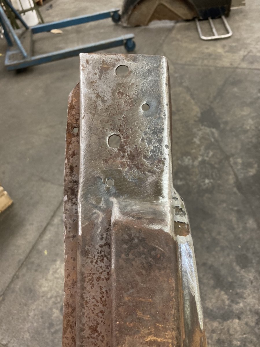

  6. Piewagn
    Joined: Mar 25, 2009
    Posts: 1,542
    Piewagn
    Goofing around at lunch today and threw the carbs on just to see what it looked like..... I like it!

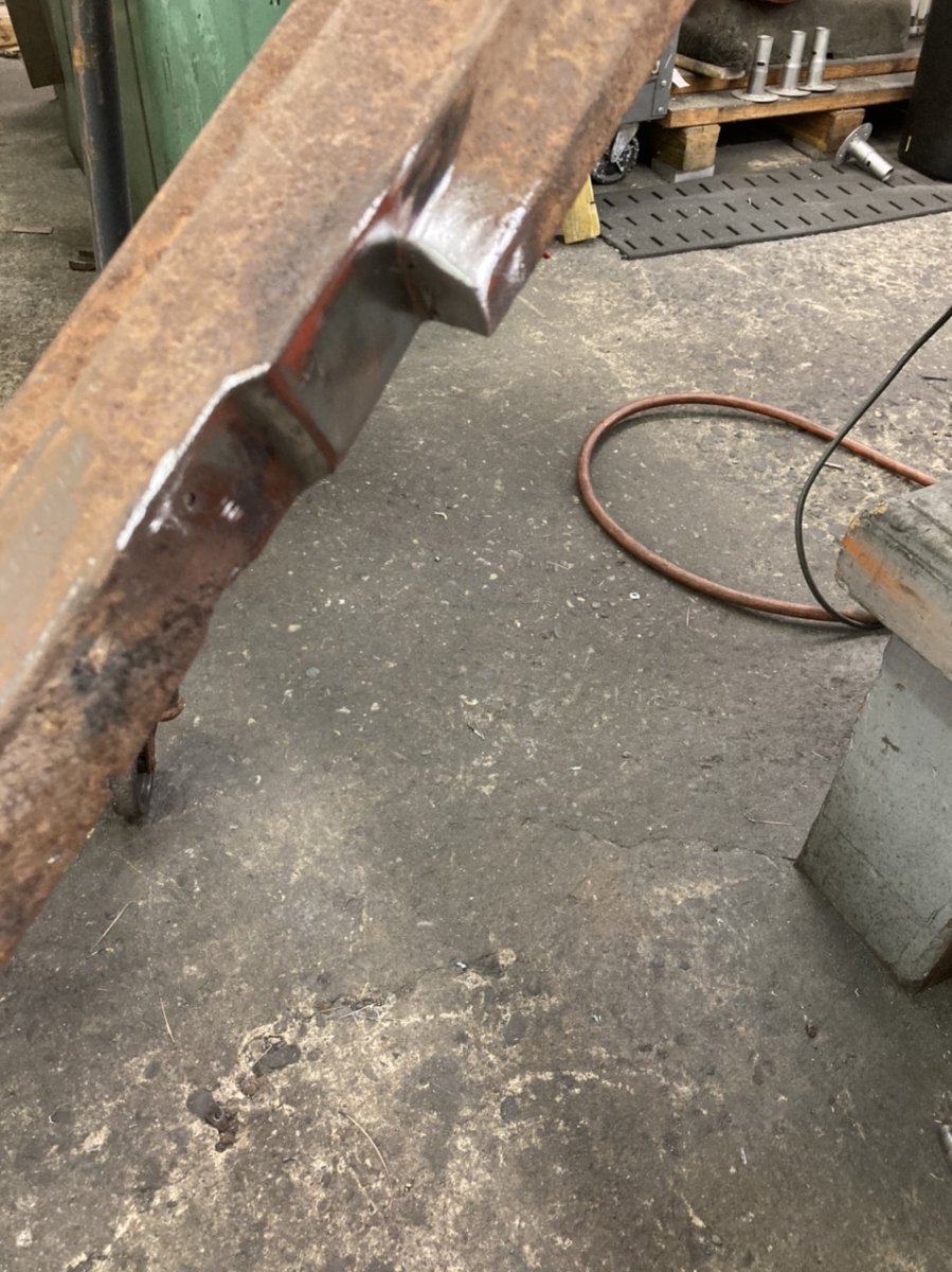

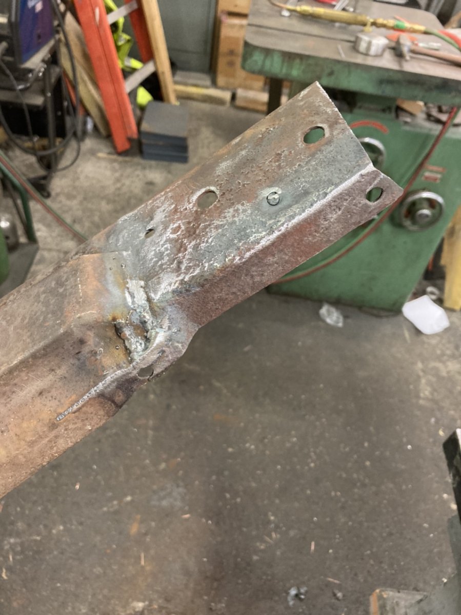

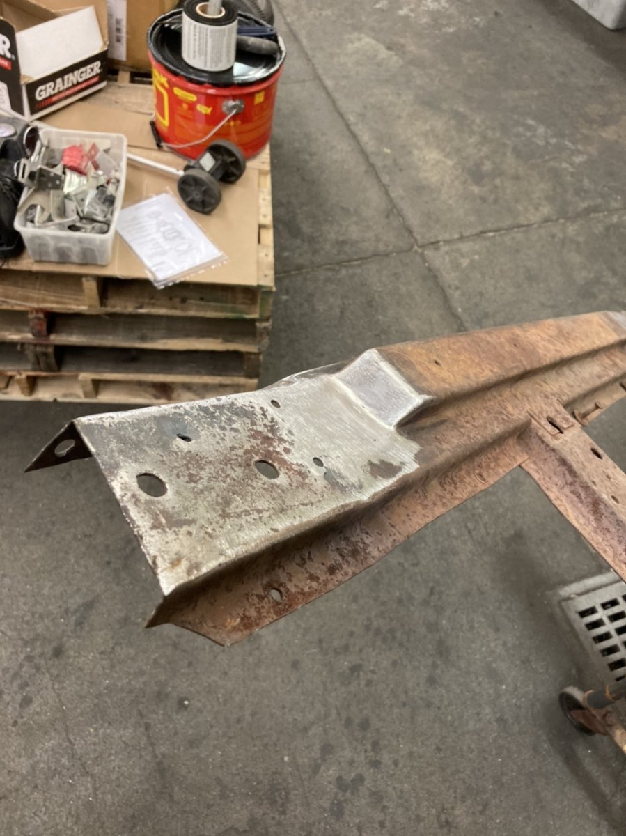

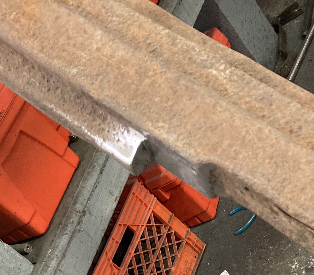

    Also....more work on the subframe. The front ends were mangled and cracked, so I spent some time welding and straightening. I forgot to get a before pic of the driver side....boy was it mangled! Much worse than the p***enger side.....but I managed to get it relatively straight.....I thought it came out nice.
    I was scrutinizing the subframe and looking to see the differences between the sedan sub and the coupe sub to give me an idea of what I need to do. Looks like I’ll have to widen it in the rear where the wheel wells are and probably fabricate some bracketry, but it’s nothing I can’t handle. It just mucks up the works a wee bit! Thanks for letting me ramble, hope all had a nice day.....thanks fellas! IMG_0256.JPG IMG_0258.JPG IMG_0261.JPG IMG_0262.JPG IMG_0263.JPG IMG_0264.JPG IMG_0265.JPG IMG_0266.JPG IMG_0267.JPG

  8. loudbang
    Posts: 40,349
    Engine looks great with those colors. :)
    Piewagn likes this.

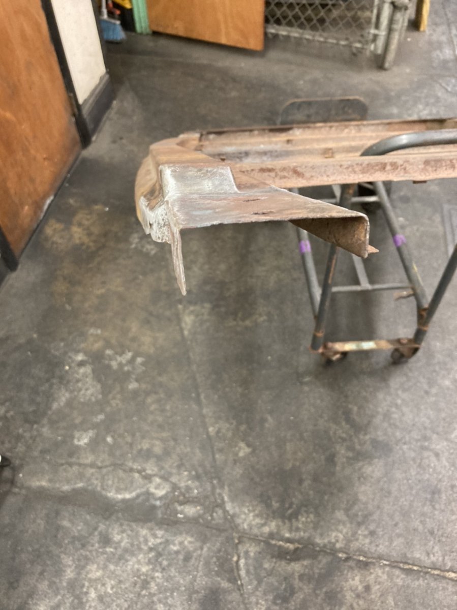

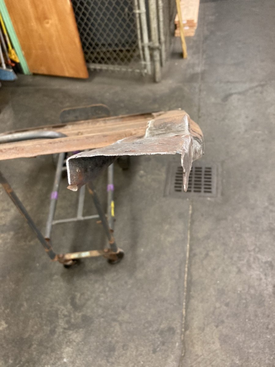

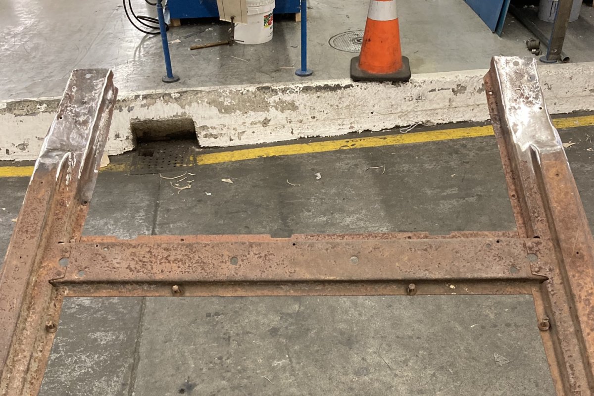

    Well....laid things out this evening and here’s what I’ve come up with.
    Just a few mods that I started....add 5” to the rear section and trim a couple spots that I have marked in the pics.....trim a small portion off near the rear wheel well and modify the front ends where it meets the cowl/firewall ***embly, which I’ve already done....see in pics! Everything will be just fine!!!
    Man.....do I feel a WHOLE LOT better!!! Thanks for stoppin’ by fellas!!

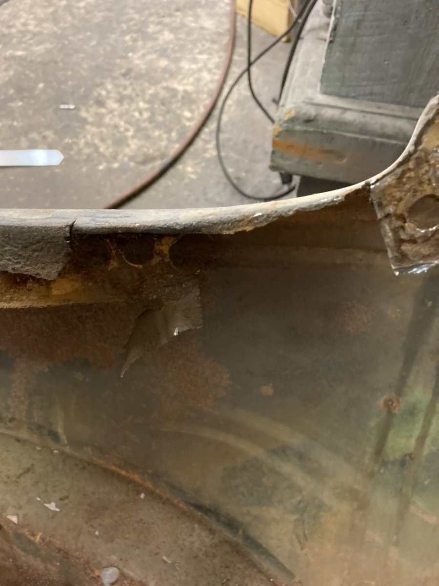

    Little quarter work today....
    I’ve ordered the “T” strips and I need to order the trunk rain gutters....

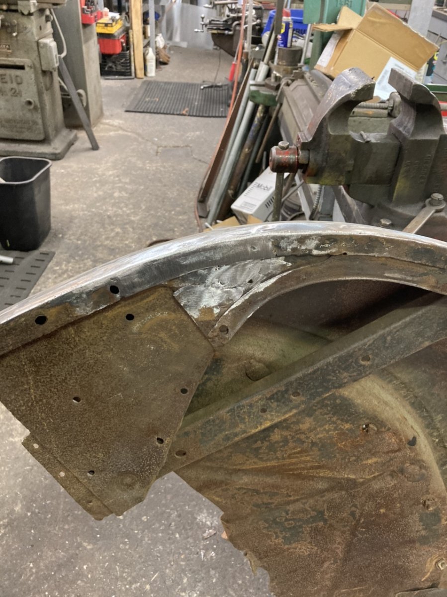

    Who the $@&# cuts out the rain gutters??? FFS! Anyway....here we are for today....have a great weekend everyone! IMG_0301.JPG IMG_0302.JPG IMG_0303.JPG IMG_0304.JPG IMG_0305.JPG

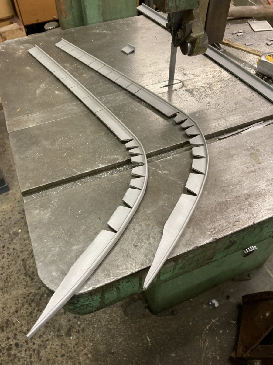

    Since I couldn’t find coupe “T” strips anywhere, I purchased the sedan strips and modified to fit....
    Should look ok once everything is cinched up. Still waiting on my rear coupe subframe section from Aaron....I’m itchin’ to get this body ***embled!! Thanks for checkin’ in fellas!! IMG_0319.JPG IMG_0321.JPG IMG_0323.JPG IMG_0324.JPG

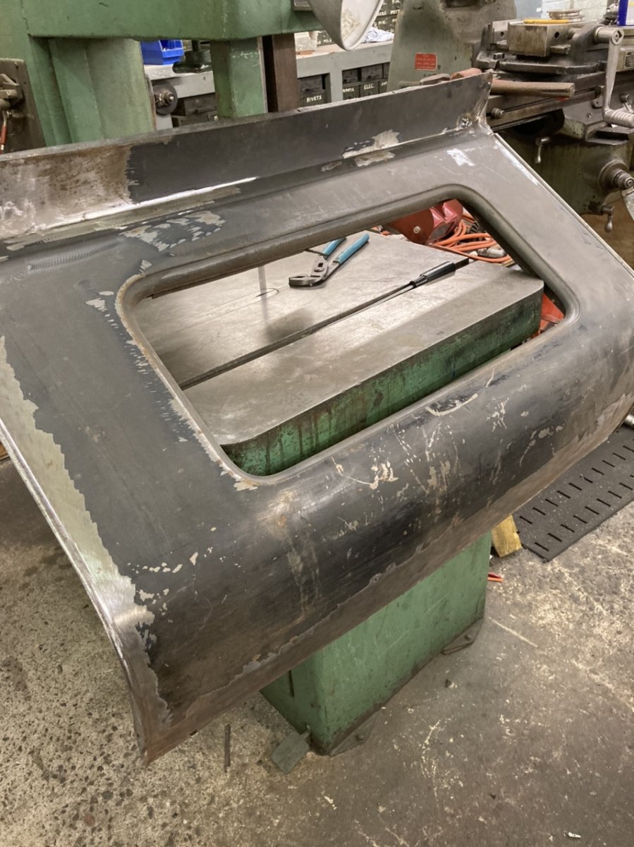

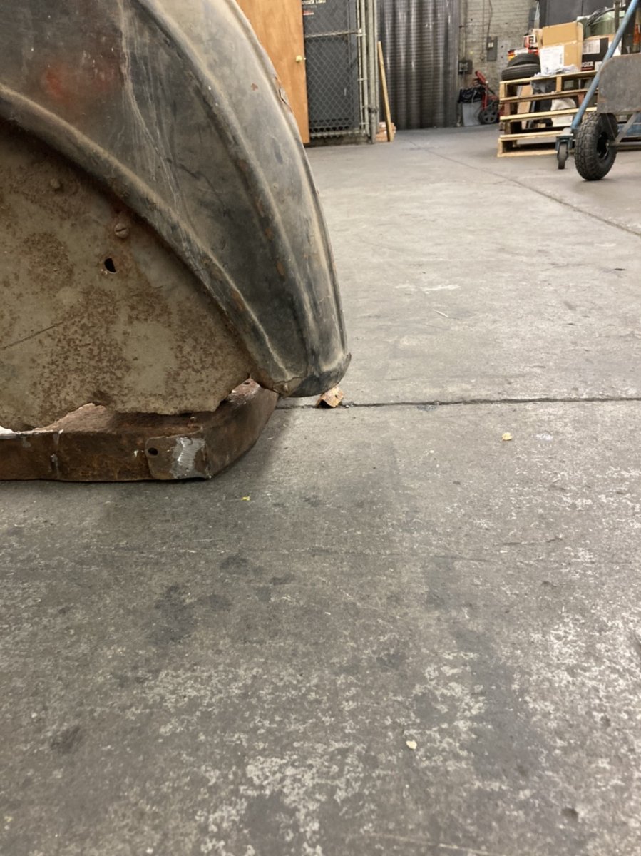

    I thought I’d never get this crown back....it was mashed in pretty good. Hammers, dollies and a body file got me here.....now basically a skim coat will finish it off nicely! But I’m waiting until the body is ***embled and all my patch panels are installed before I do any plastic work. Thanks for hangin’ out fellas! IMG_0331.JPG IMG_0332.JPG IMG_0333.JPG

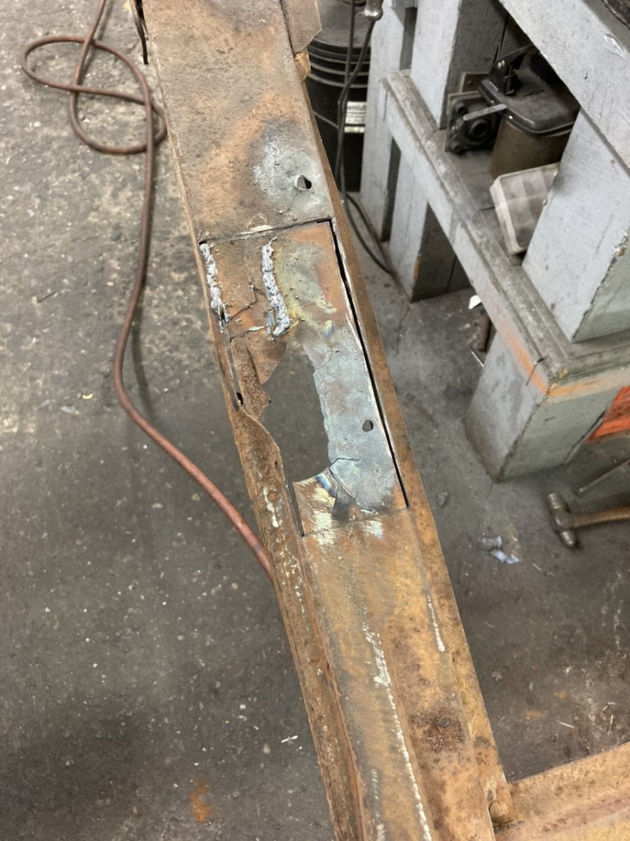

  25. Piewagn
    Posts: 1,542
    Piewagn
    Just taking care of some rust structural issues until my subframe section arrives that Aaron shipped out. Post office called snd they did find it in a corner of a Washington state facility.....thank God! So, it’s now on it’s way to Lansdale!
    Working the quarters and things....thanks for stoppin’ by fellas!

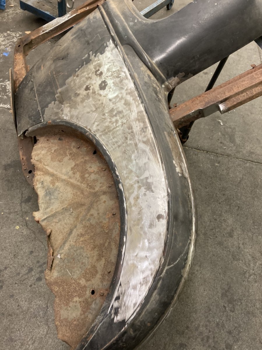

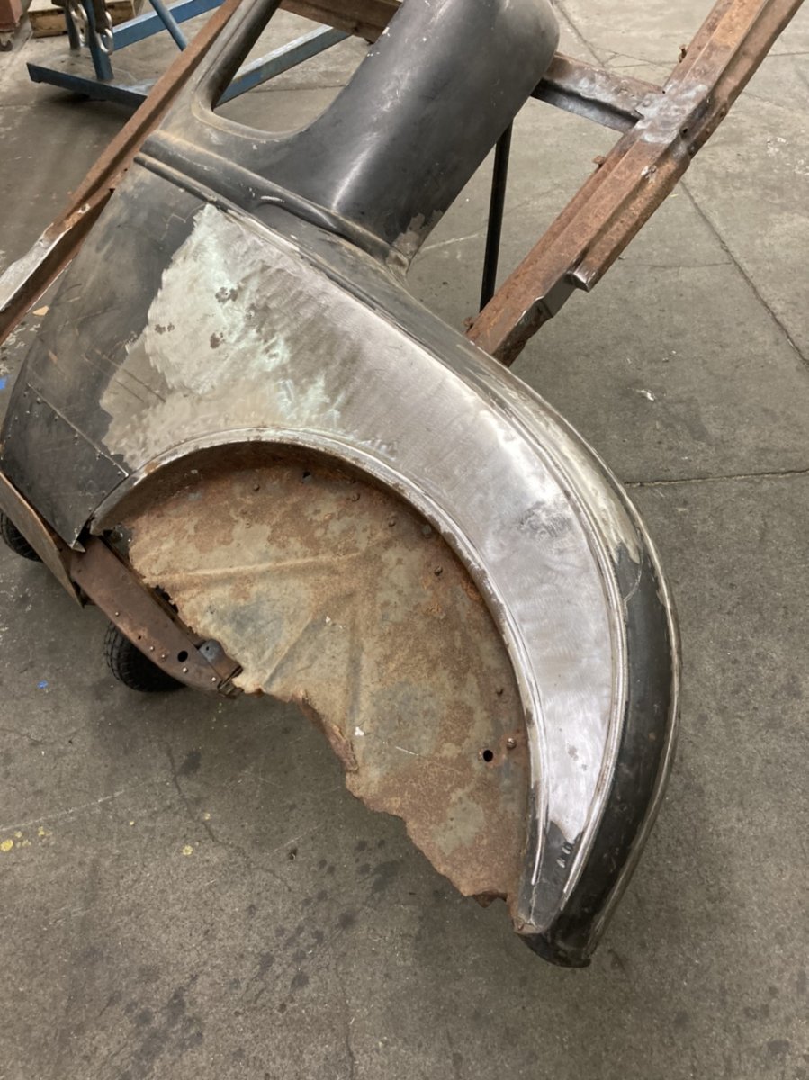

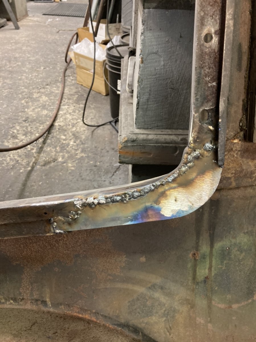

  28. Piewagn
    Posts: 1,542
    Piewagn

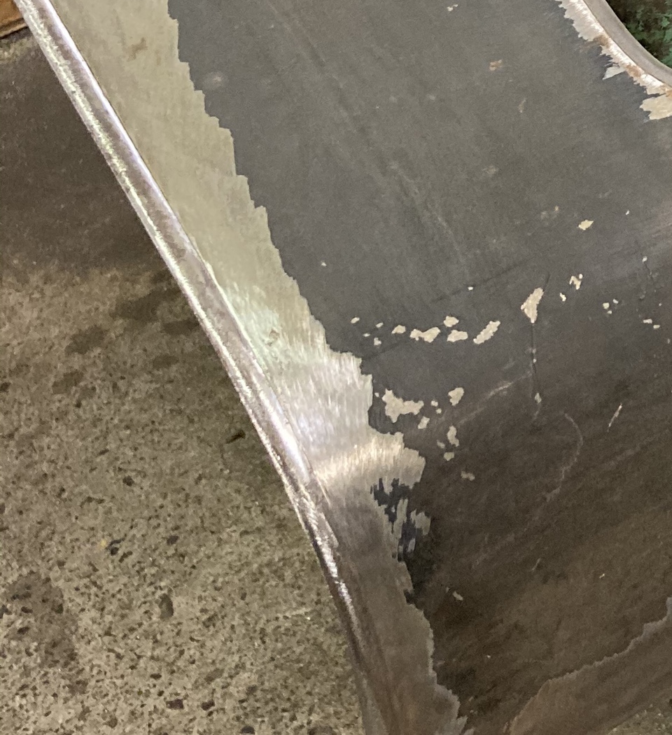

    Left side quarter had a bunch of annoying waves.....someone pounded a spot out from the inside and stretched the **** out of the metal....I shrunk it down some, but I’m gonna order a shrink hammer and maybe a shrinking disc....
    I did manage to get it decent, but still needs some m***aging....thanks for poppin’ in fellas! IMG_0344.JPG

  30. Piewagn
    Posts: 1,542
    Piewagn
    Kinda made my own shrink disc and it worked a treat! Geezus this thing was stretched! I’m happy where it came in....couple swipes of filler after I install the patch panels and we’re good! Thanks for hangin’ out fellas! IMG_0345.JPG IMG_0347.JPG IMG_0348.JPG
