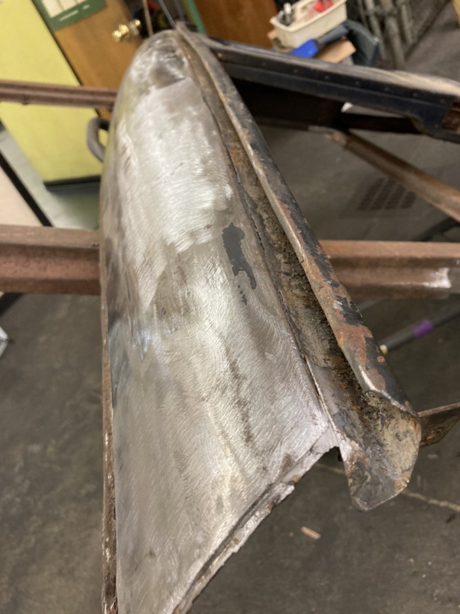

  6. Piewagn
    Joined: Mar 25, 2009
    Posts: 1,542
    Piewagn
    Brought this crown back too with the help of the shrink disk.....caved in with a crease down half the length....just a little tweaking with the slap file and it’ll be ready for a thin swipe of filler.....have a great weekend fellas!!! IMG_0354.JPG

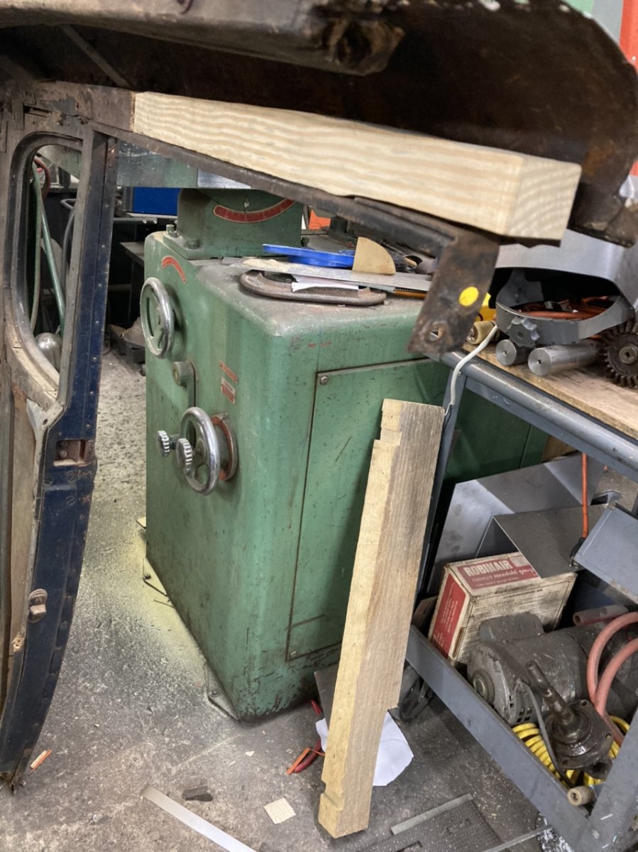

    I’m splicing in the wood over the door....money saved will go towards other things needed for the project. Old skids all over the place, so I made up a piece using the old one as a template....it’s offset and I’m going to dowel it.....thanks for stoppin’ by fellas!!! IMG_0366.JPG IMG_0365.JPG

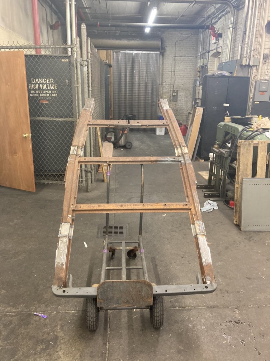

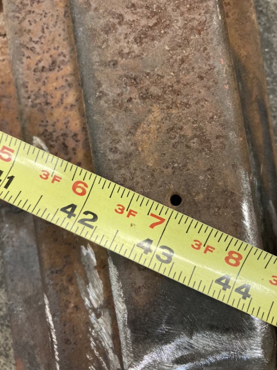

    Worked on the subframe tonight.....got the measurements I need for cutting and stretching.... IMG_0374.JPG IMG_0375.JPG IMG_0373.JPG IMG_0378.JPG IMG_0382.JPG

    Piewagn
  15. Piewagn
    Posts: 1,542
    Piewagn
    Need some tweaking...but you get the idea......happy Friday Eve!!!

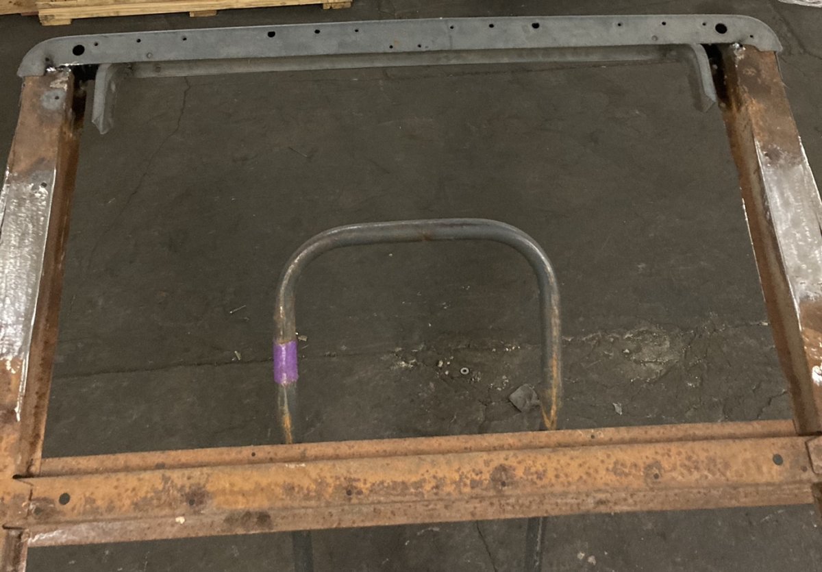

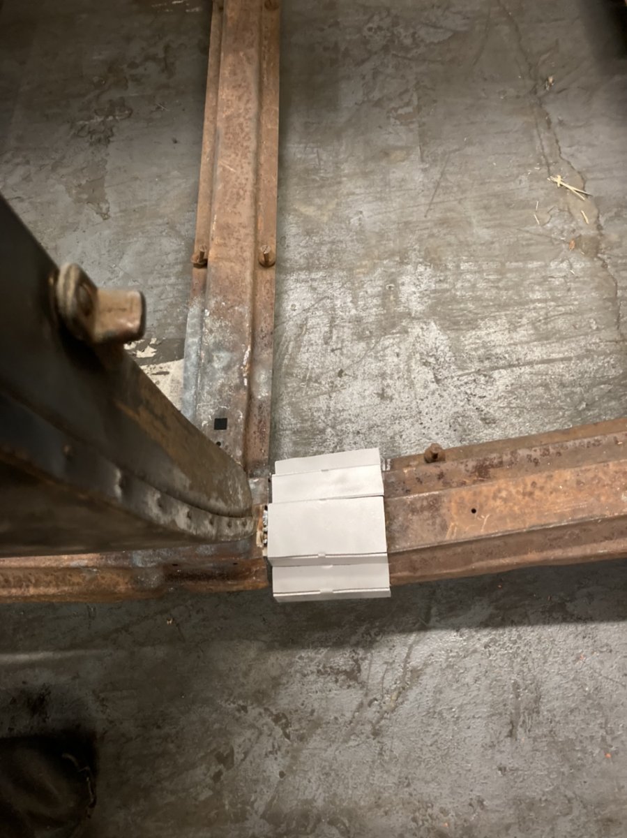

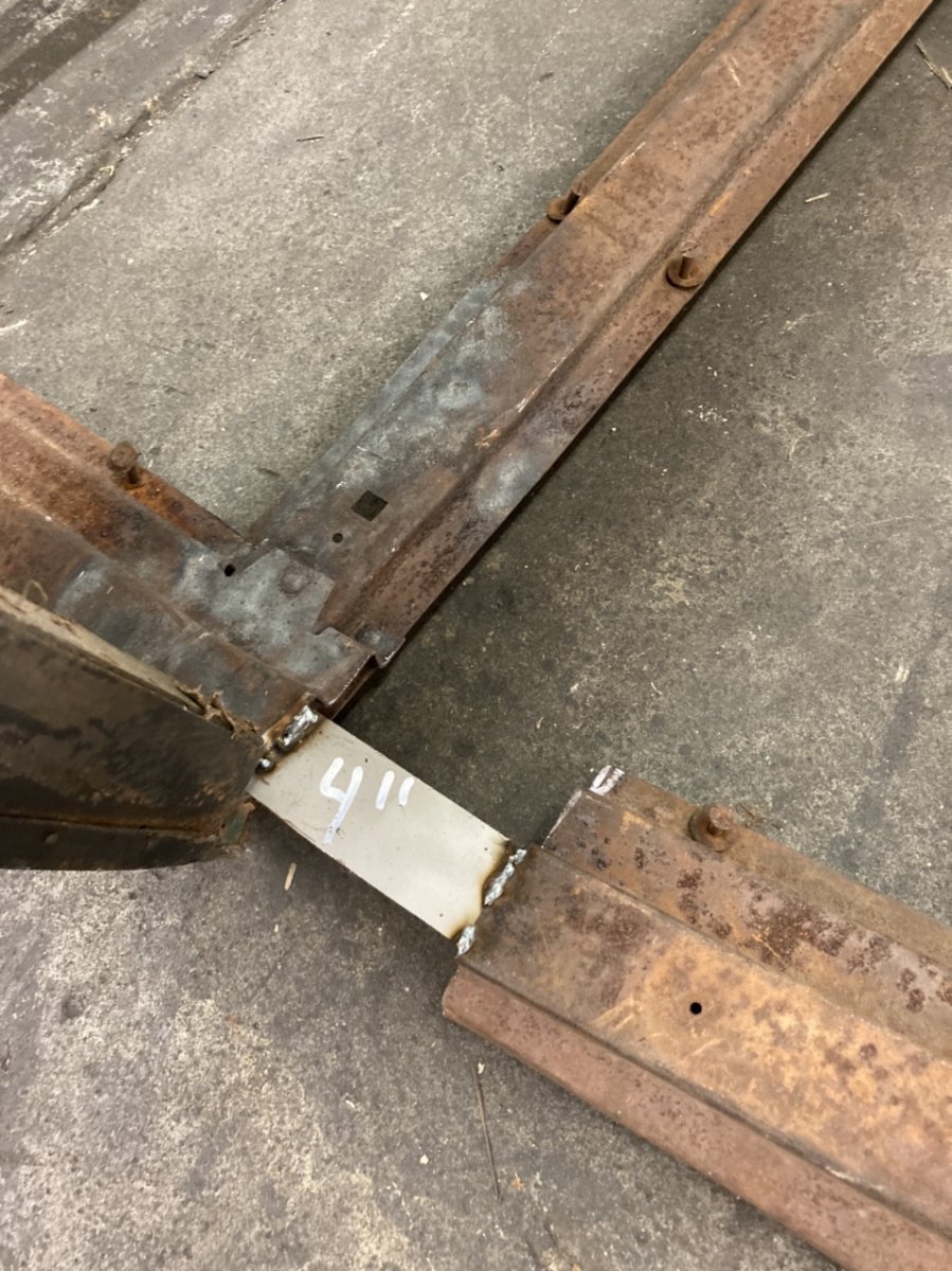

    Need to do the rear extensions and then finish up all the welding....
    Got it right on.... IMG_0389.JPG IMG_0393.JPG IMG_0394.JPG IMG_0395.JPG IMG_0396.JPG

    I now have a subframe with needed dimensions for a coupe! Need to finish up the welding and grinding.....then it’s time for body ***embly!! IMG_0404.JPG IMG_0405.JPG

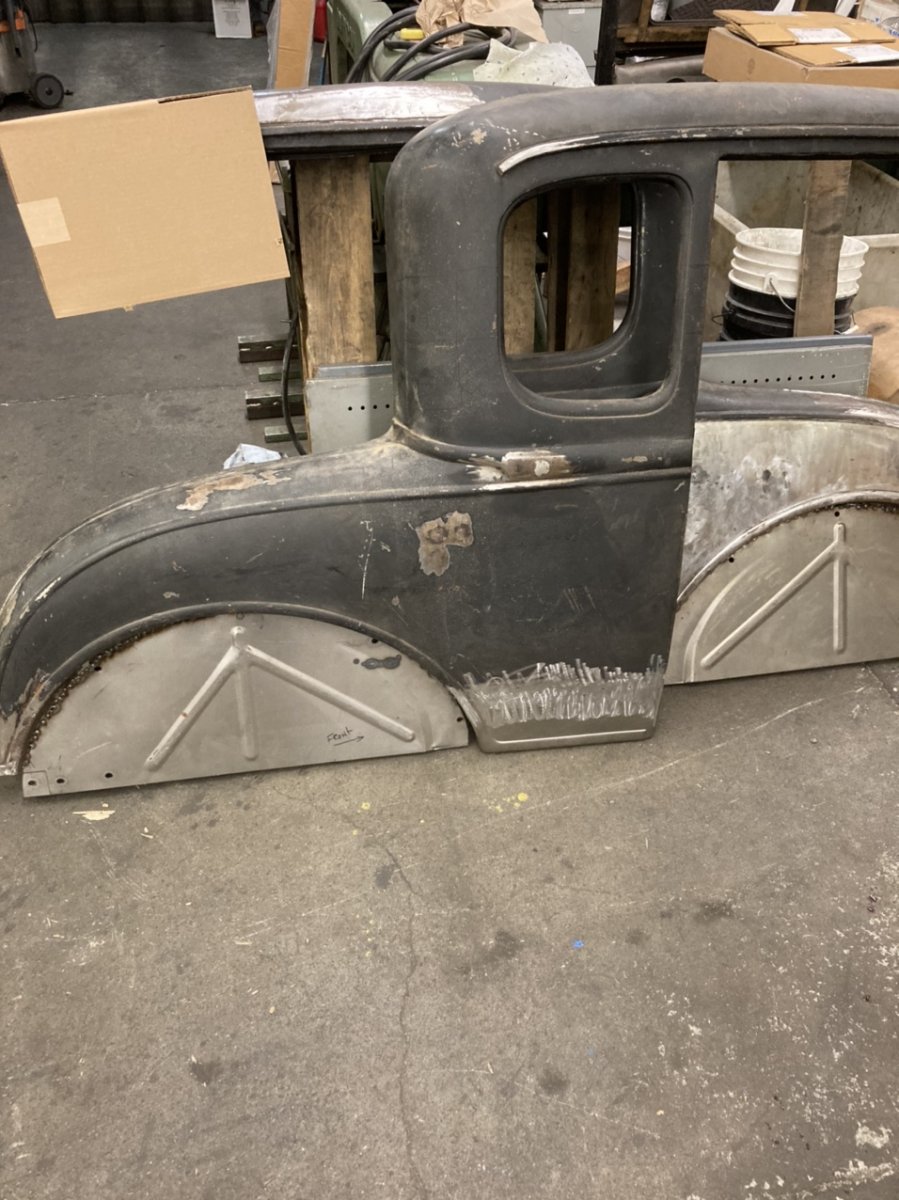

    Got some sheet metal work done tonight.....and got my ****py rusted gas tank cut off.....moving forward! Thanks fellas! IMG_0423.JPG IMG_0424.JPG IMG_0425.JPG

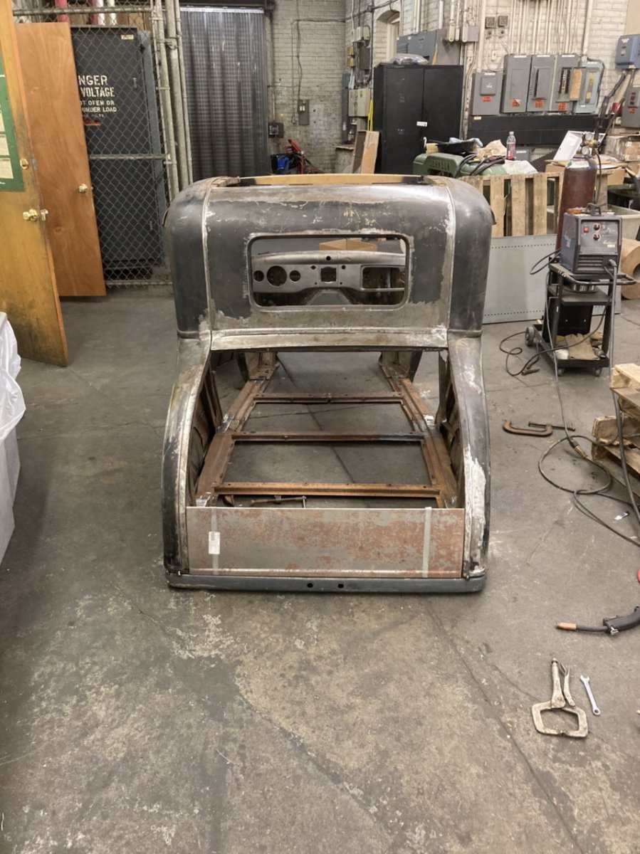

  23. Piewagn
    Posts: 1,542
    Piewagn

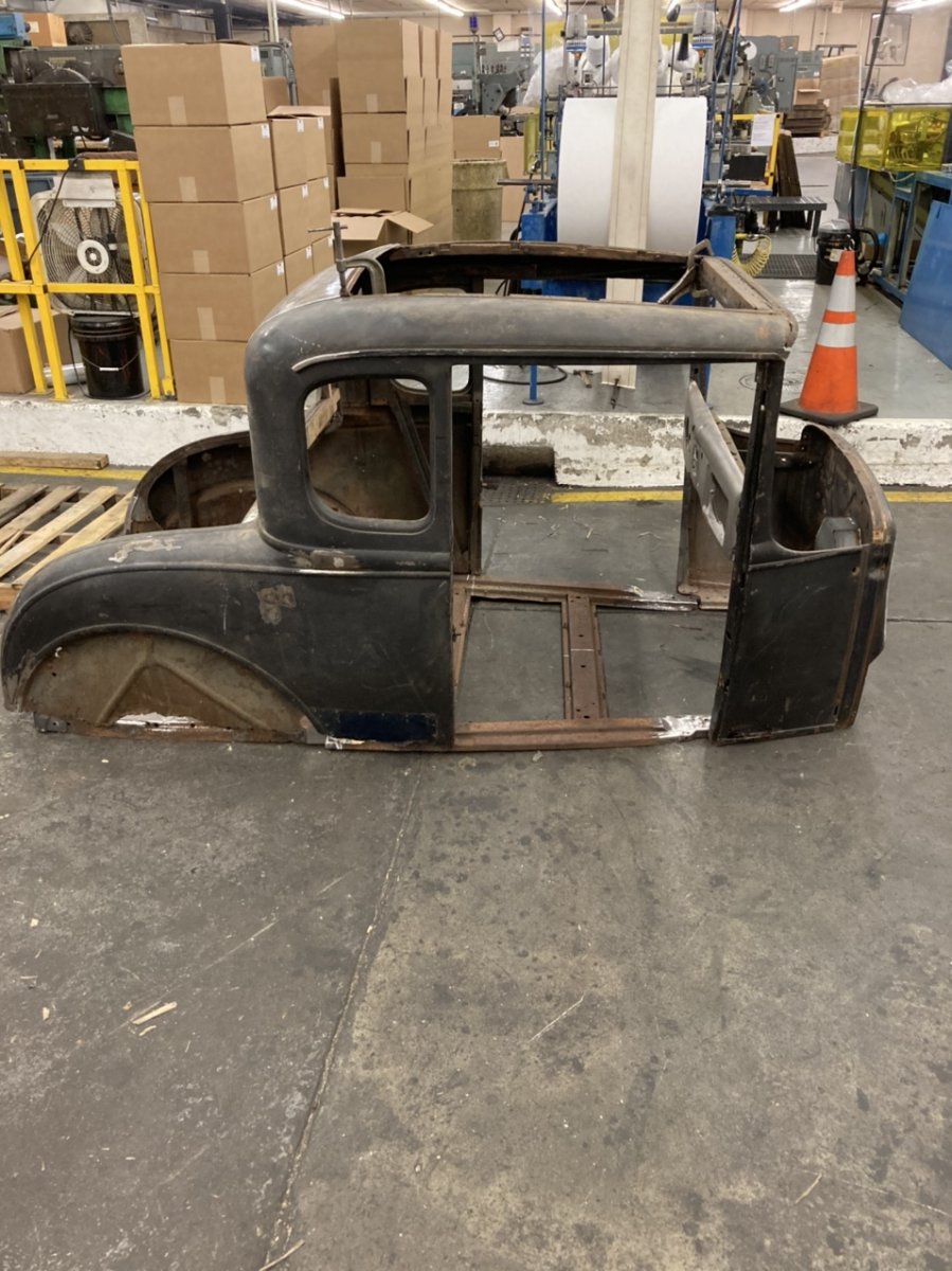

    More sheet metal work! The floor drops off, that’s why the gap towards the rear.....I’m starting ***embly of the body tomorrow......any other work can be done after it’s together! There’s light at the end of the tunnel! Thanks for hangin’ with me fellas!! IMG_0427.JPG
  24. Piewagn
    Posts: 1,542
    Piewagn
    Got some tweaking to do.....but it’s not coming apart again! IMG_0430.JPG IMG_0432.JPG
