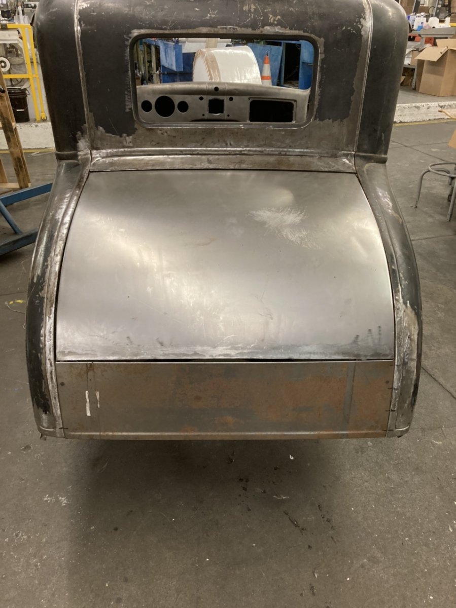

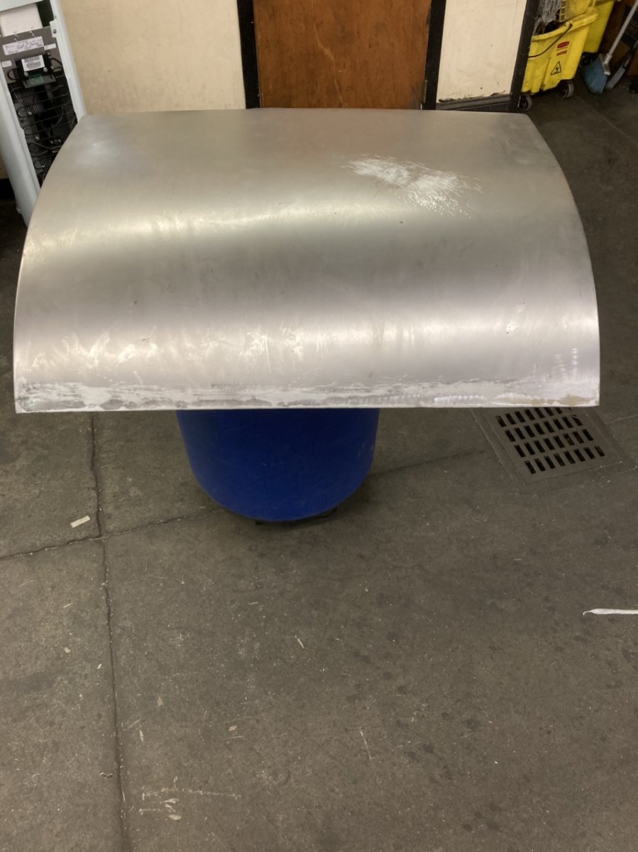

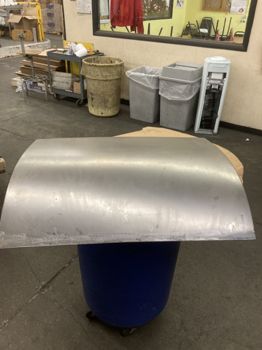

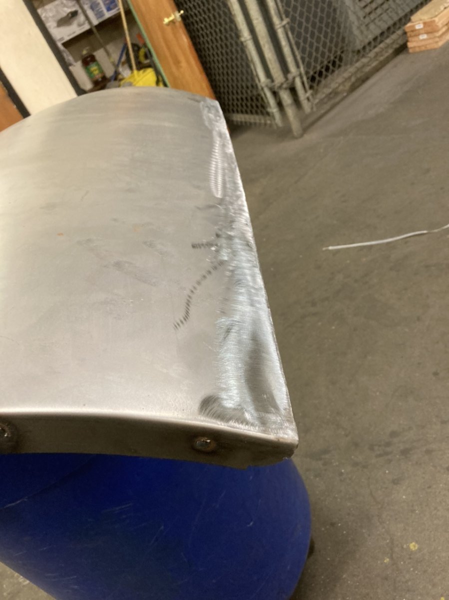

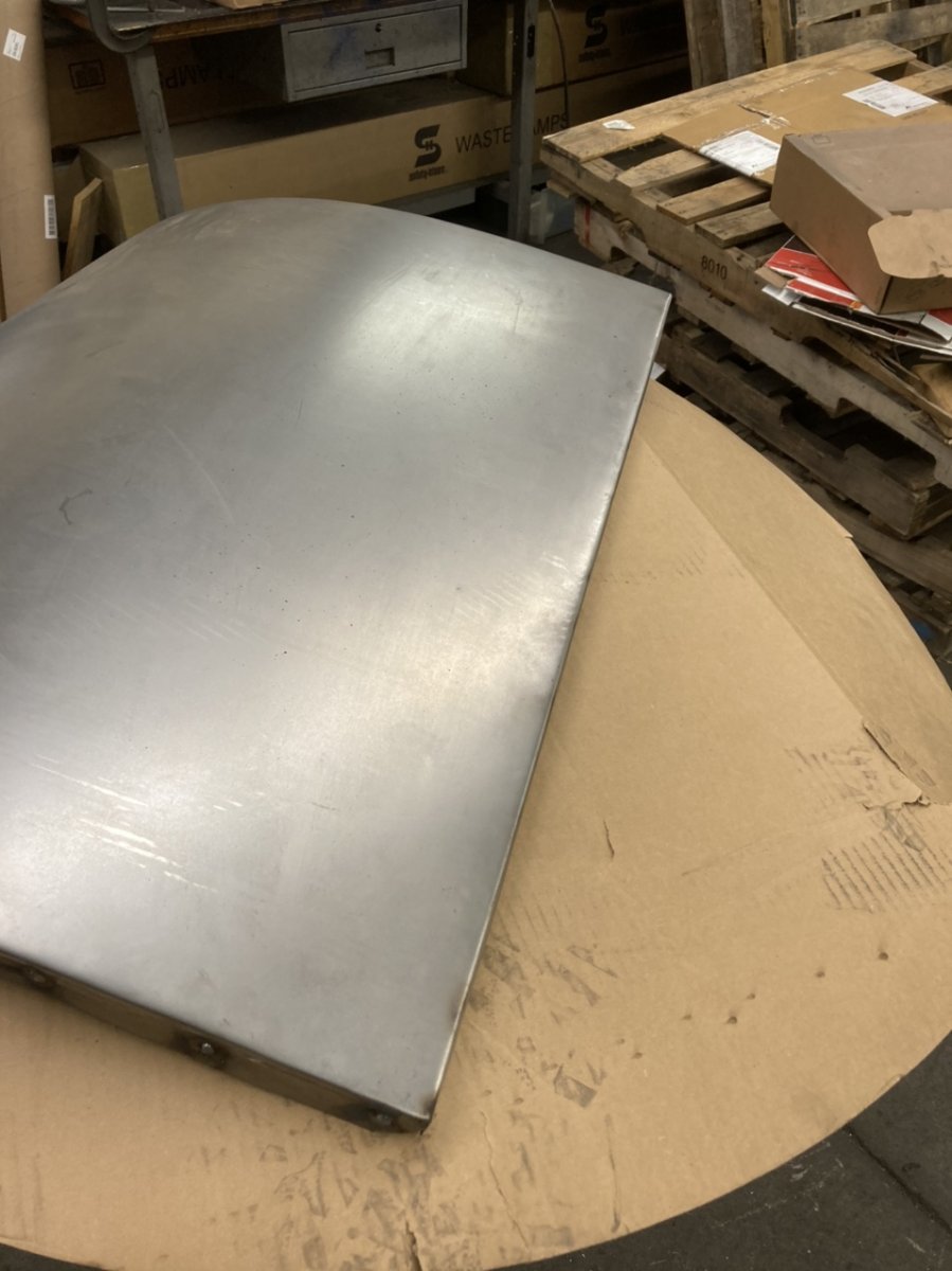

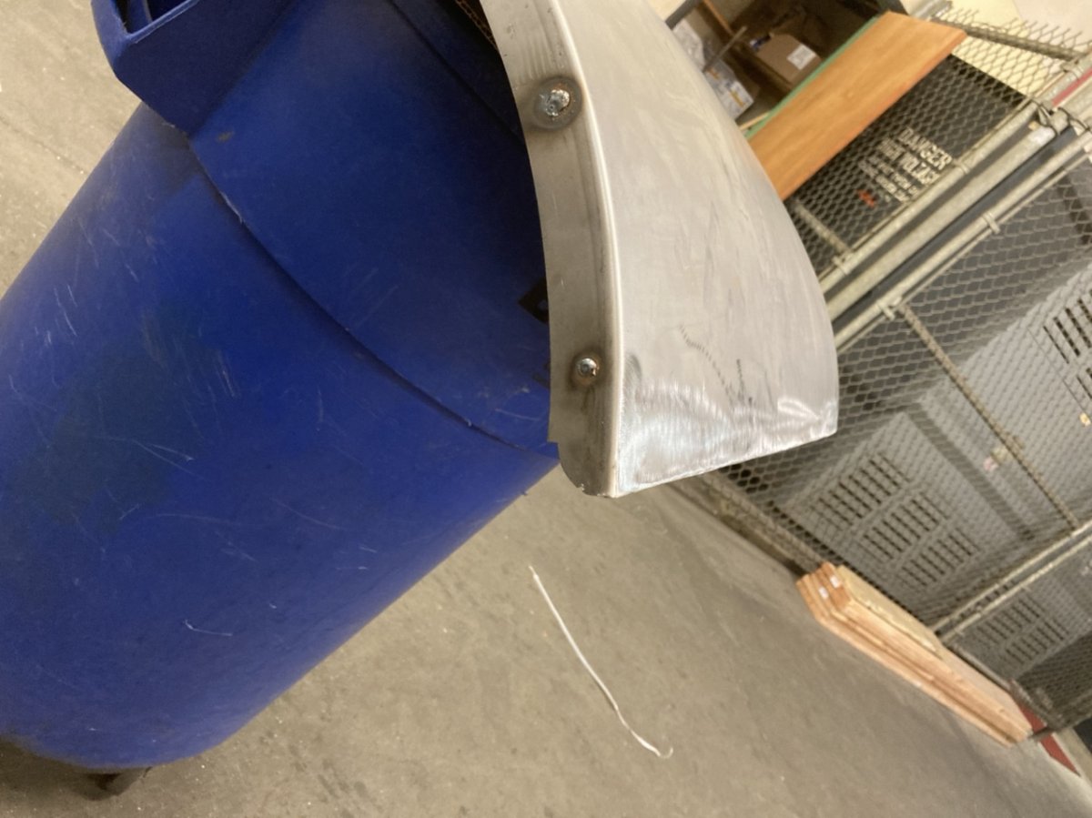

    Ok.... I’m calling the skin done! Finished rolling the final edge and knocked down a small zingo with the body file...I’ll do the filler portion when I’m ready for all the filler work.....I’m gettin’ there fellas....thanks for hangin’ with me! IMG_0530.JPG IMG_0532.JPG IMG_0533.JPG

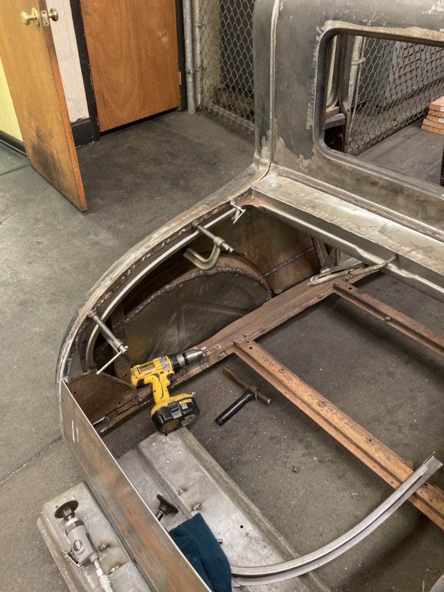

    Inner fender brace done except for some tweakage....I got my remaining vacation pay in one lump sum this week and that means only one thing......HOTROD SHOPPING!!

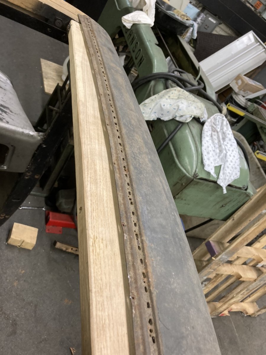

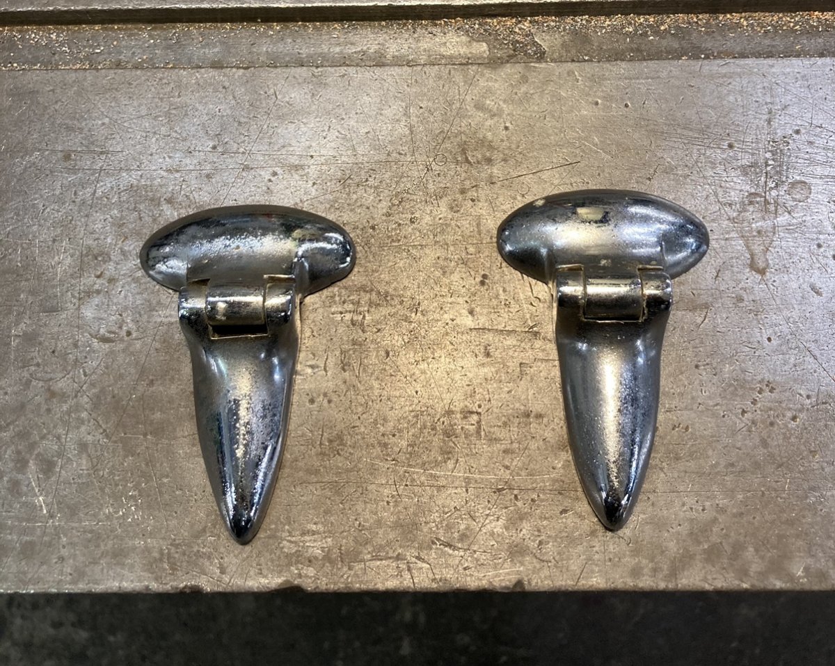

    Workin’ on the woods.....psin in the ***! Of course some of the holes don’t line up! My hinges and trunk rain gutters cam too! Will be getting to those next week..... IMG_0570.JPG IMG_0569.JPG IMG_0572.JPG

    Just can’t find those damn spot welds! Rust and not that my eyesight is really that good.....it’s frustrating.....a Spottle would be nice to have too....but....I’ll clean it up nice after I weld the gutters in....some seam sealer and I’m good ta go! I’ll tack these in place, then fit the deck lid! Thanks for stoppin’ by fellas!! IMG_0577.JPG IMG_0579.JPG

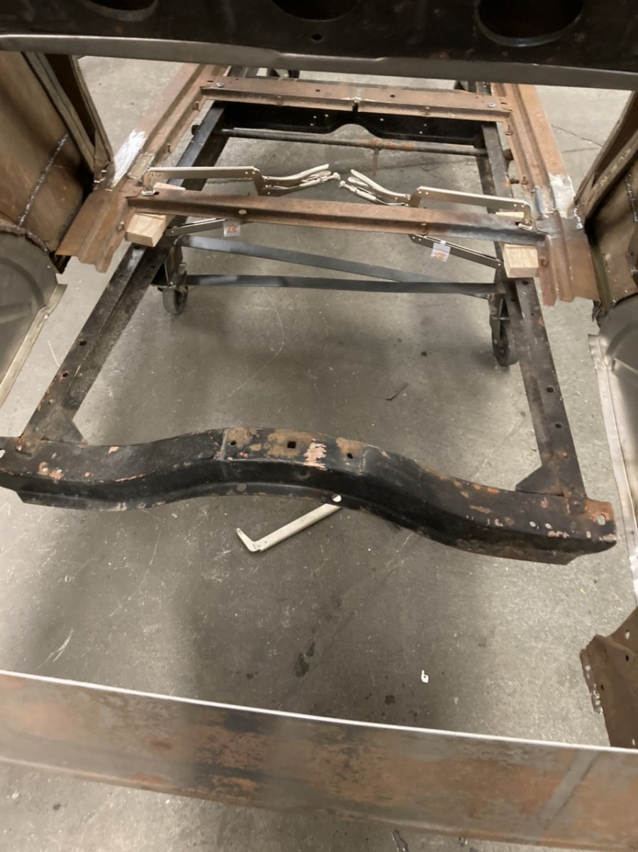

    I scooped up a free frame and made a body jig....I tired of fighting with this thing! I was supposed to pick one up already done but disaster struck.....so, cash flow ain’t so good right now....but free is for me! Had the casters here at work too. No more dragging it to the shop!!

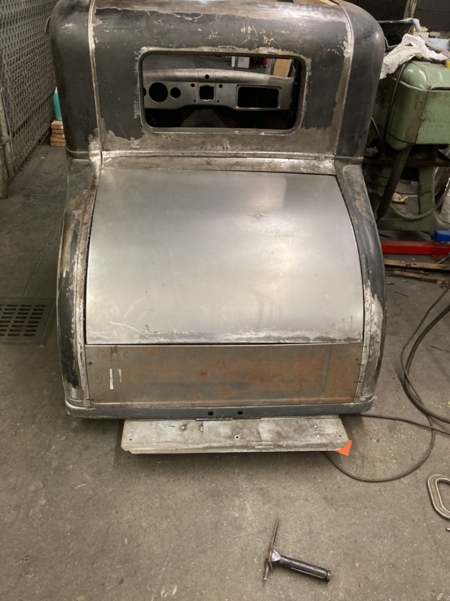

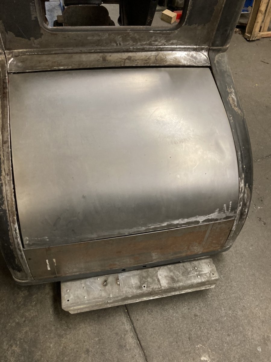

    Progress....FINALLY!! Getting the deck set. Still some tweaking....gotta cut the tack welds I put at the bottom of the B pillar and the left quarter should drop the 3/16 I need. I’ll brace it all up so I can get the rear subrails set in place that I managed to pick ip CHEAP!!....this has been making me crazy, but there’s light at the end of the tunnel here.....YES!! IMG_0653.JPG IMG_0655.JPG IMG_0654.JPG
