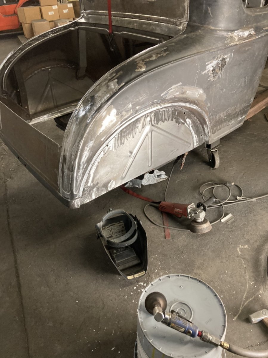

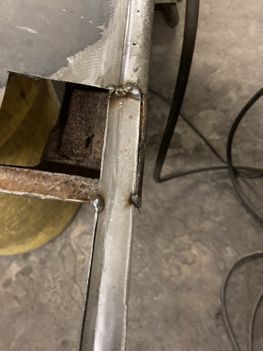

    Took half a day today and spent some Q time on the coupe! Majority of structural welding is done.....wheel wells are close....
    Things are slowing a little at work and I may just take a week of vacation to thrash and get the majority of remaining body issues completed....thanks fellas! IMG_0829.JPG IMG_0828.JPG IMG_0826.JPG

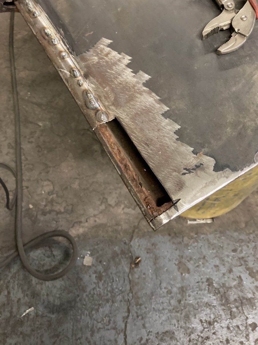

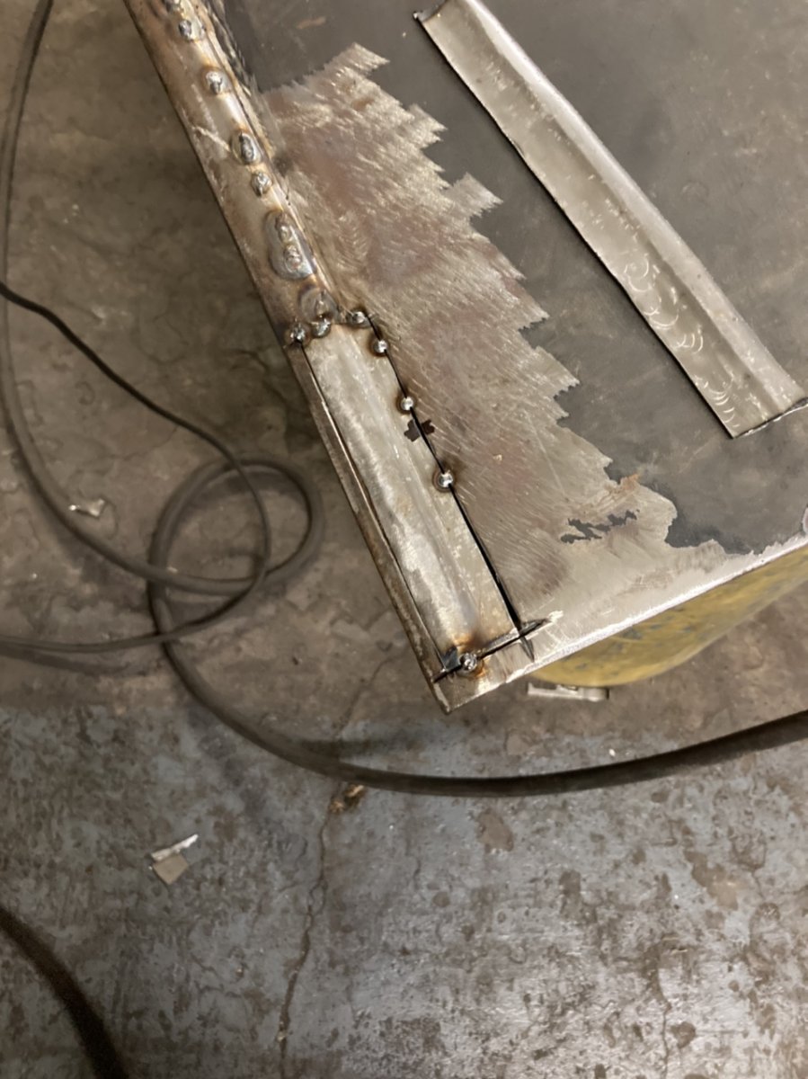

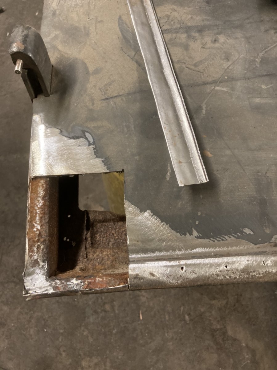

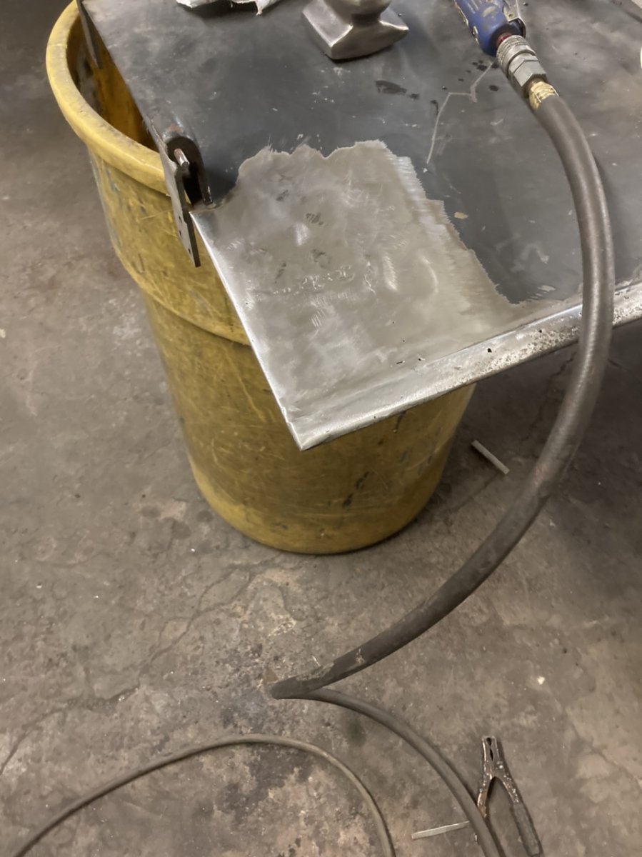

    Started on the doors....surprisingly clean doors with not much rust through! P***enger side is even BETTER!Used a bit of the leftover cowl panel.....unfortunately...I need more, but I’m out. I’ll scrounge something up...thanks fellas! IMG_0833.JPG IMG_0834.JPG IMG_0835.JPG IMG_0836.JPG IMG_0837.JPG IMG_0838.JPG

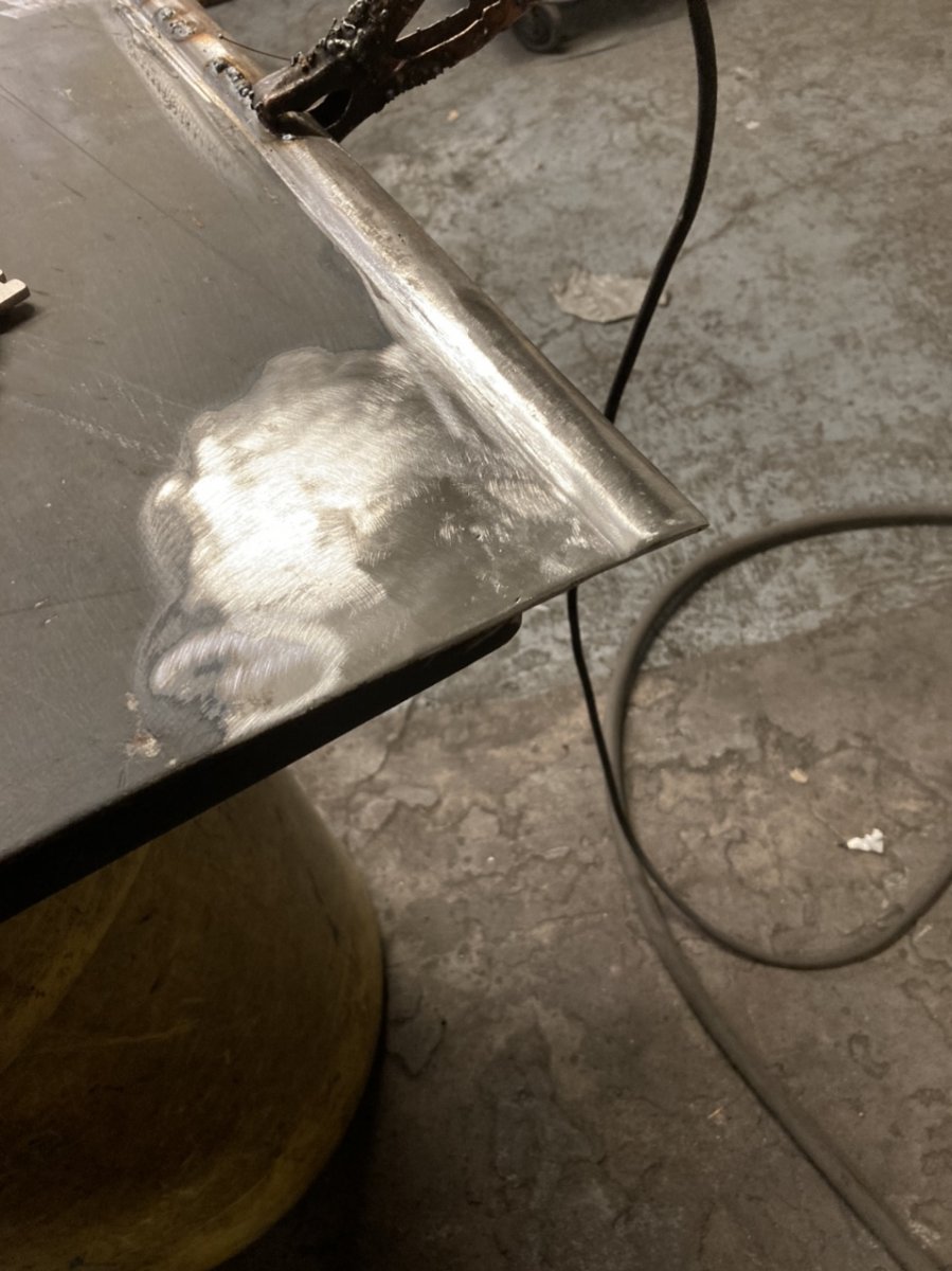

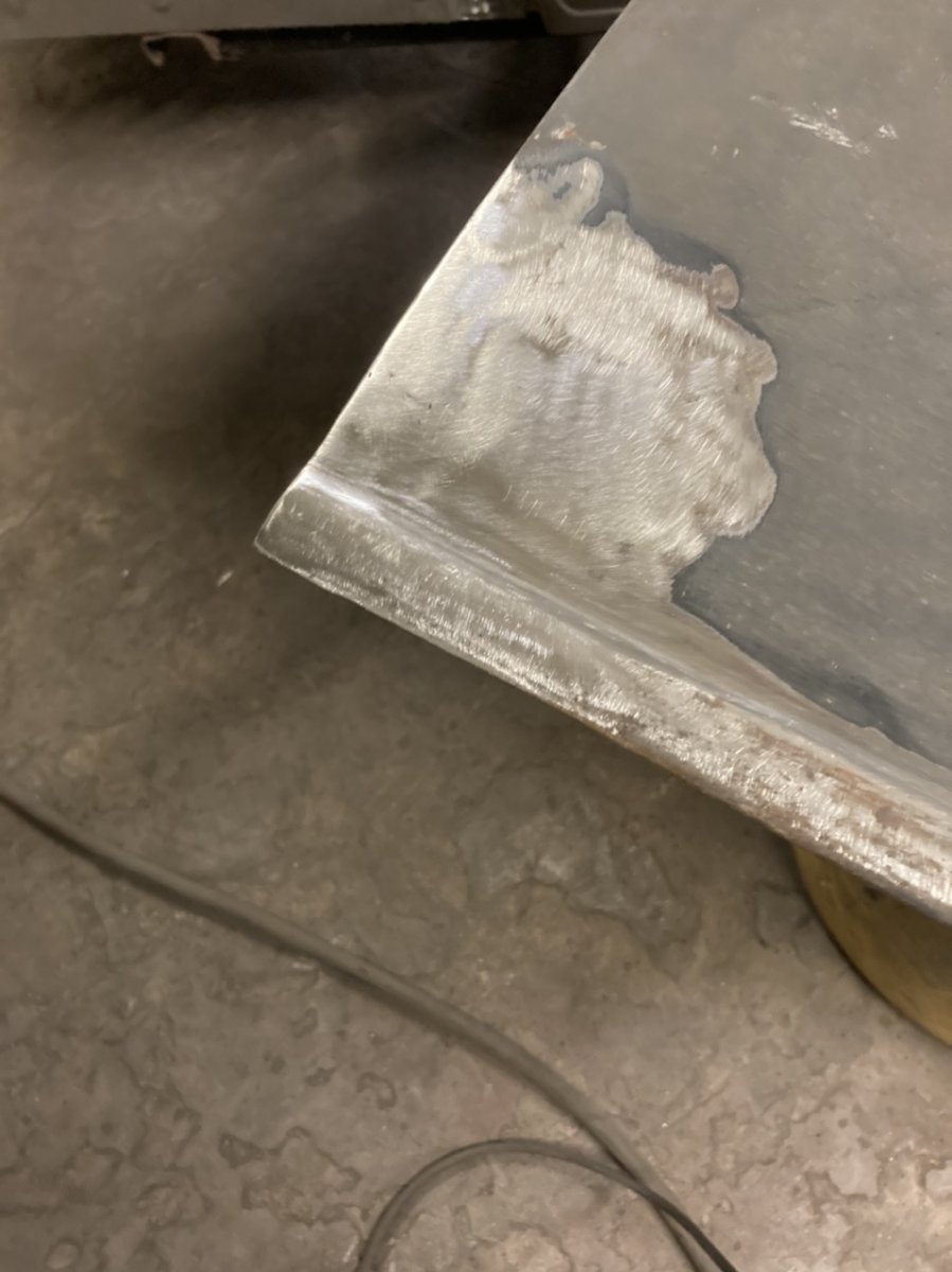

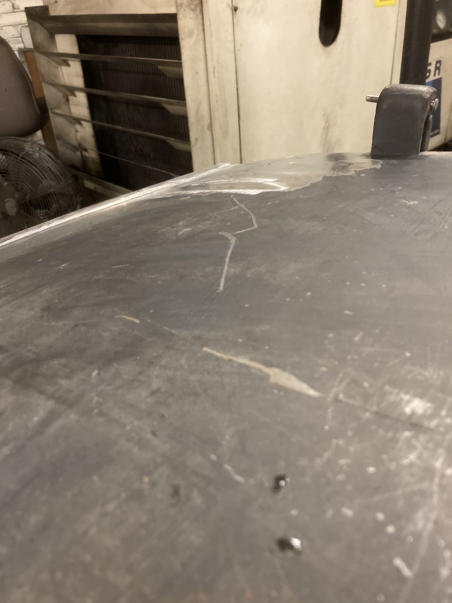

    Used some heavier gauge steel for this patch.....that and having to pee like a horse had me rush a little....it ****ed the panel in slightly, but no worries....I heated the welds a little, them hammer and dollied them and it came out. Not my best work though, but it’ll do.....hope everyone is well, thanks fellas!! IMG_0845.JPG IMG_0846.JPG IMG_0847.JPG IMG_0849.JPG

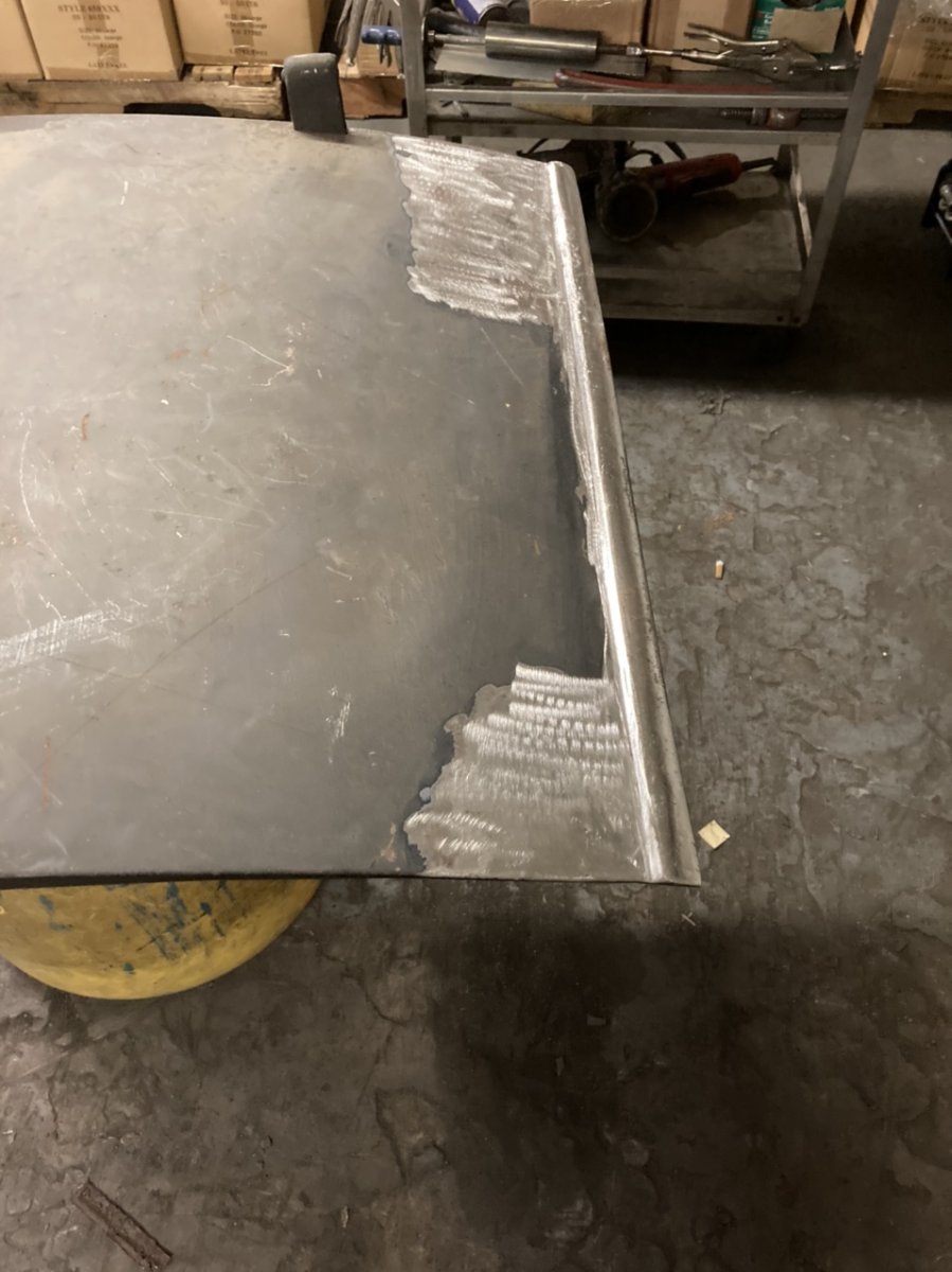

    P***enger door patched. I don’t have fancy metal shaping tools other than hammer, dolly, grinder and a block of wood. I ground the lower door edge shape into a block of wood and pounded some sheet metal into shape. Came out good! Little bit every day! Thanks for hangin’ out fellas! IMG_0868.JPG IMG_0870.JPG IMG_0871.JPG IMG_0872.JPG IMG_0873.JPG IMG_0874.JPG IMG_0875.JPG IMG_0876.JPG IMG_0877.JPG IMG_0878.JPG IMG_0879.JPG IMG_0880.JPG

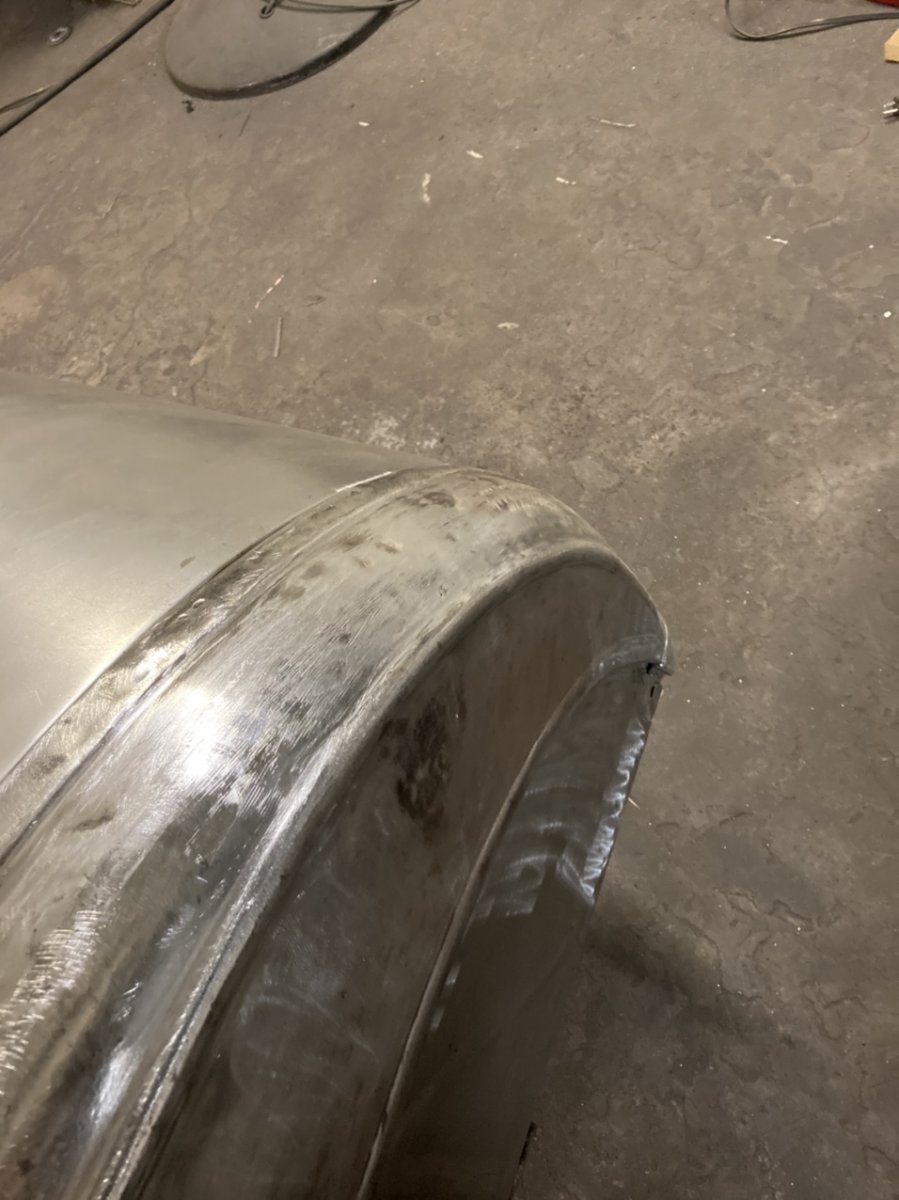

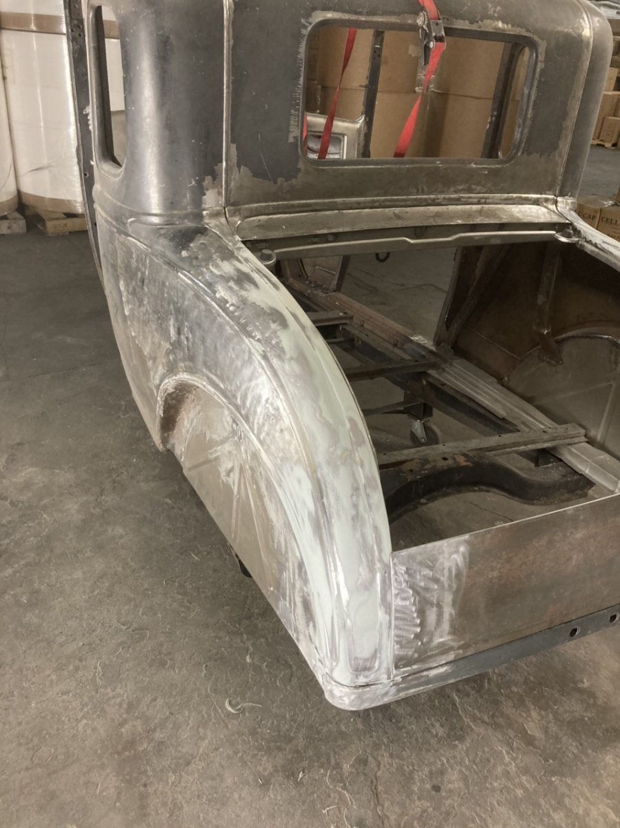

    Just some prep work today and some metal filing....wanna keep filler to a minimum! Still have a wee bit of hammer, dolly and shrink disk work to do....but I’m gettin’ there....thanks fellas! IMG_0883.JPG IMG_0884.JPG IMG_0885.JPG IMG_0887.JPG IMG_0886.JPG

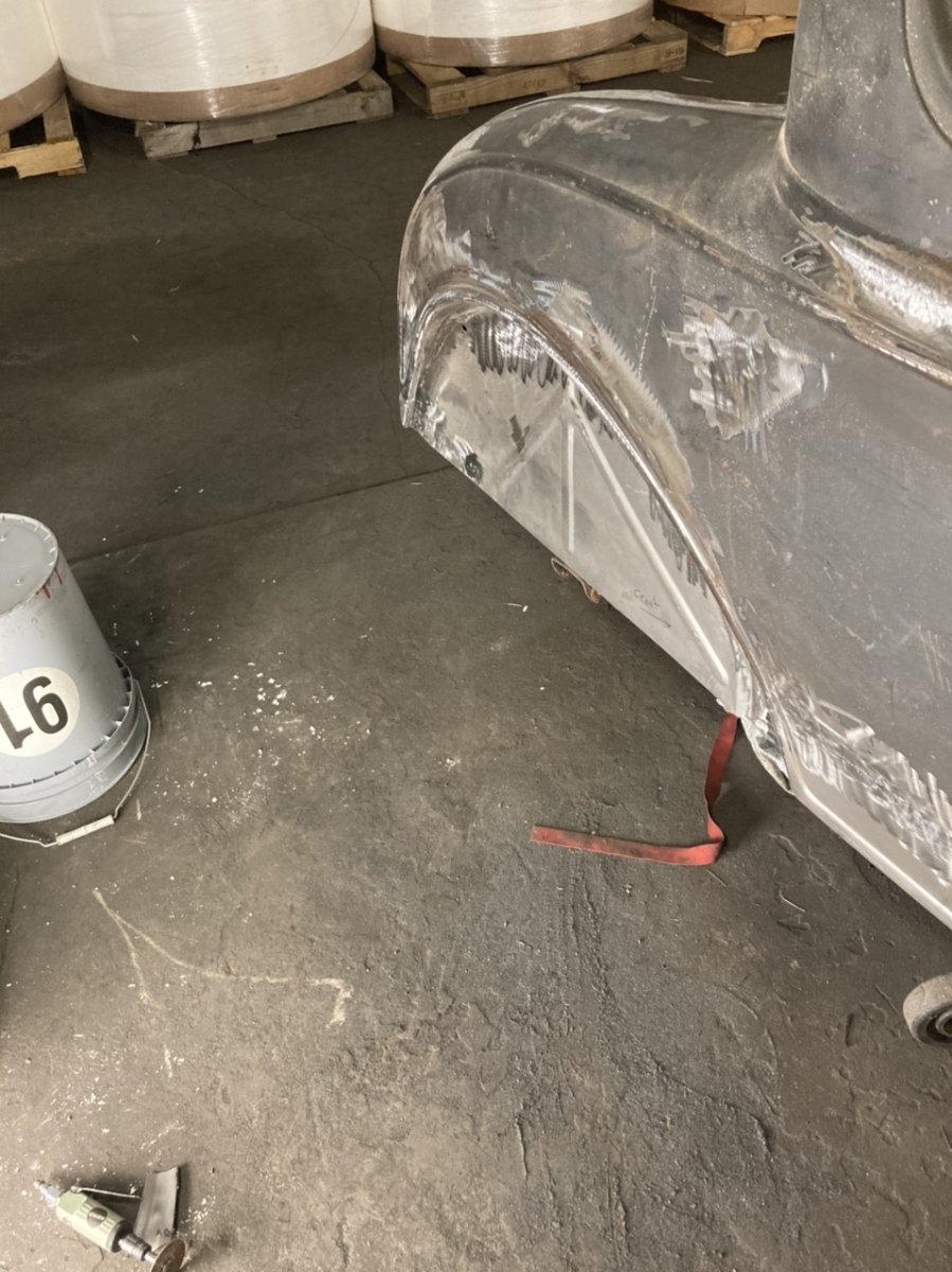

    Started the filler work today! I got this Evercoat filler that was fairly inexpensive and left hardly a pinhole! Nice and easy to sand too! Thanks for stoppin’ by fellas! IMG_0892.JPG IMG_0891.JPG IMG_0890.JPG

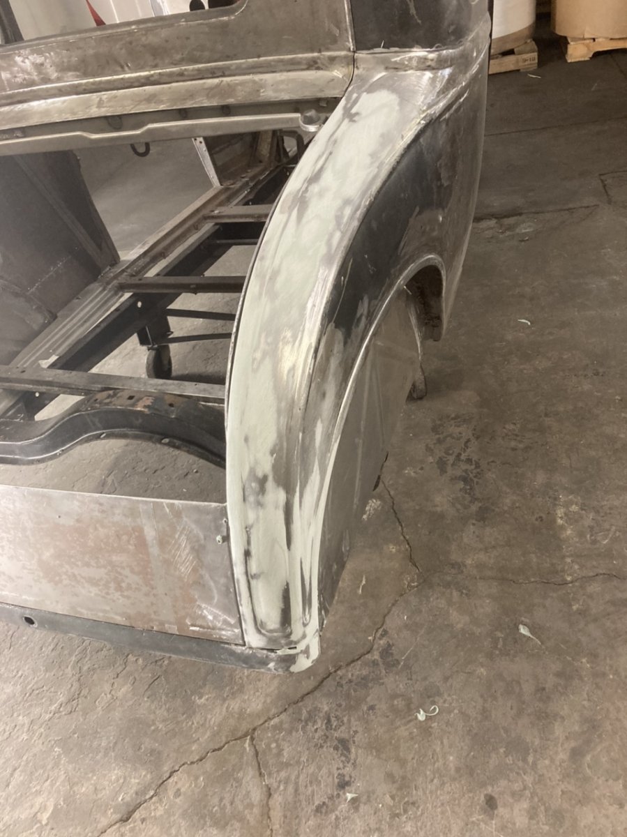

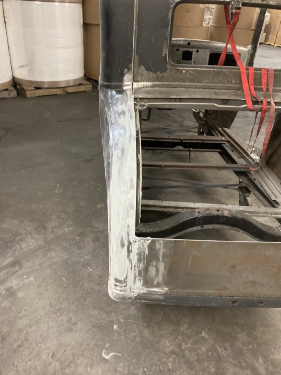

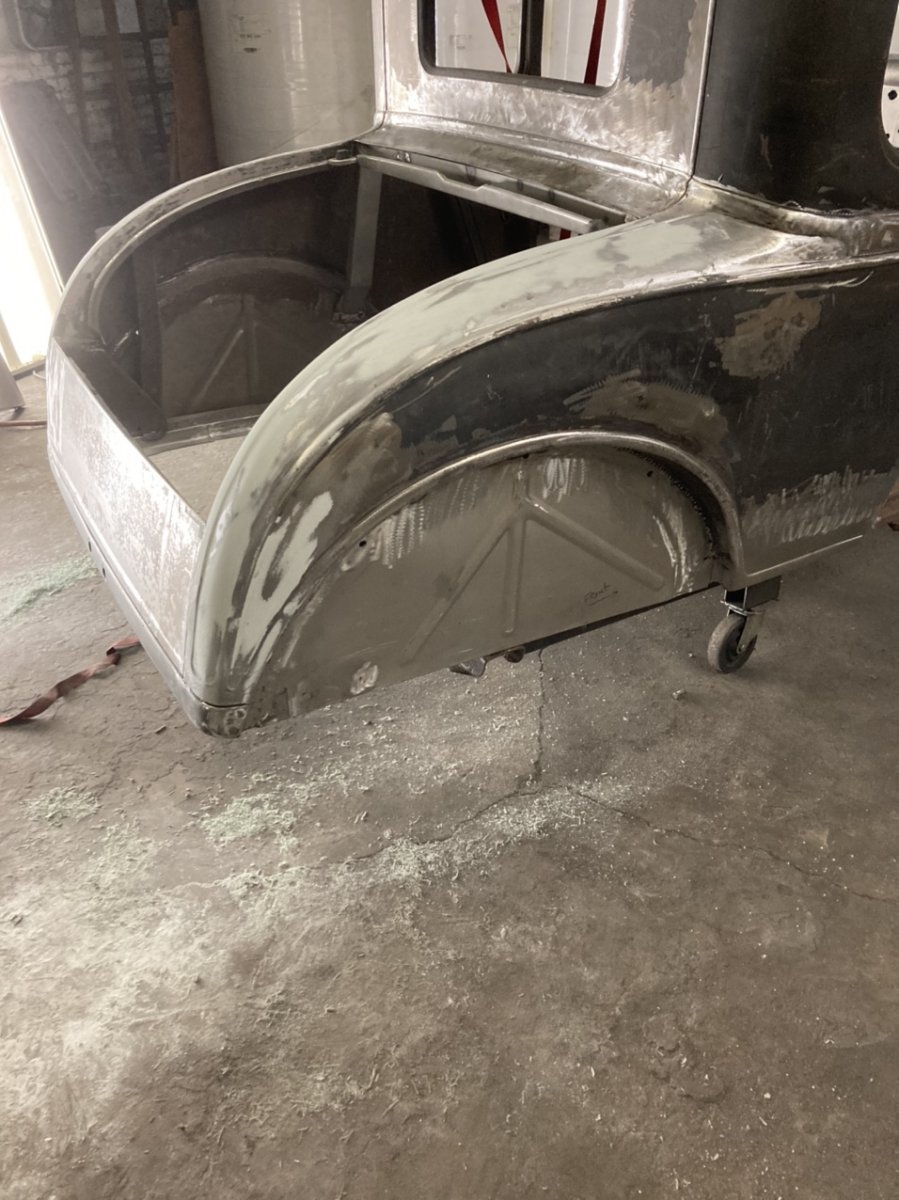

    Corners and quarter tops are done...other than tidying up some gaps....now to move on to the left lower quarter.....happy weekend fellas! IMG_0896.JPG IMG_0897.JPG IMG_0898.JPG

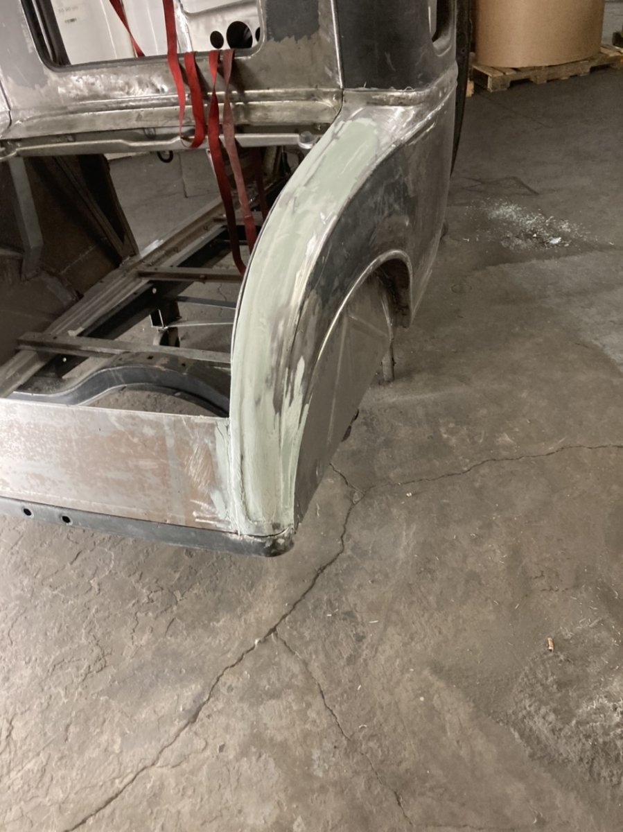

    This quarter was crushed....I’m surprised I got it this straight! Just need to tidy up edges and gaps. Quarter is ready for primer and putty thank god! The rest of the bodywork is downhill from here! Thanks for stoppin by fellas! IMG_0905.JPG IMG_0908.JPG IMG_0909.JPG
