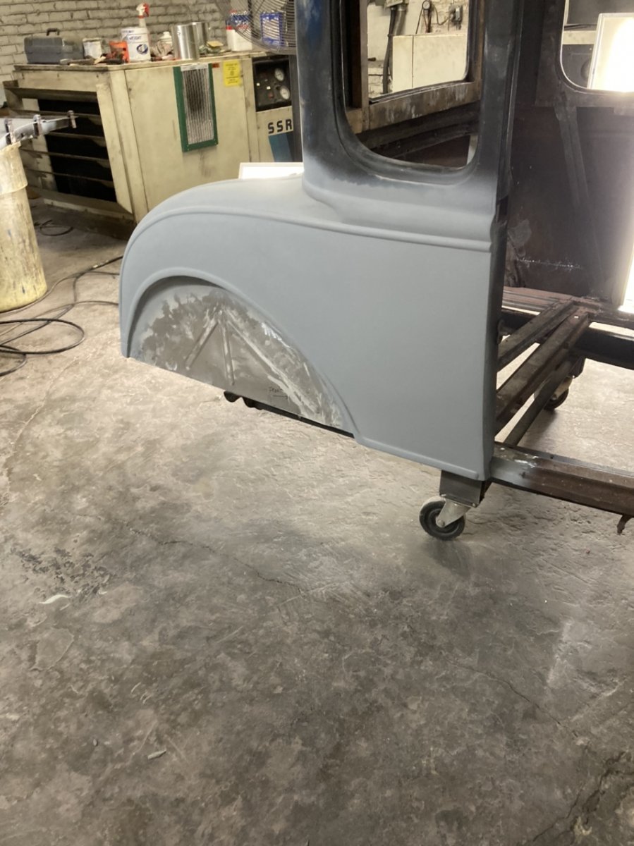

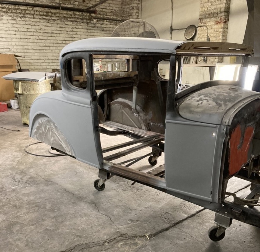

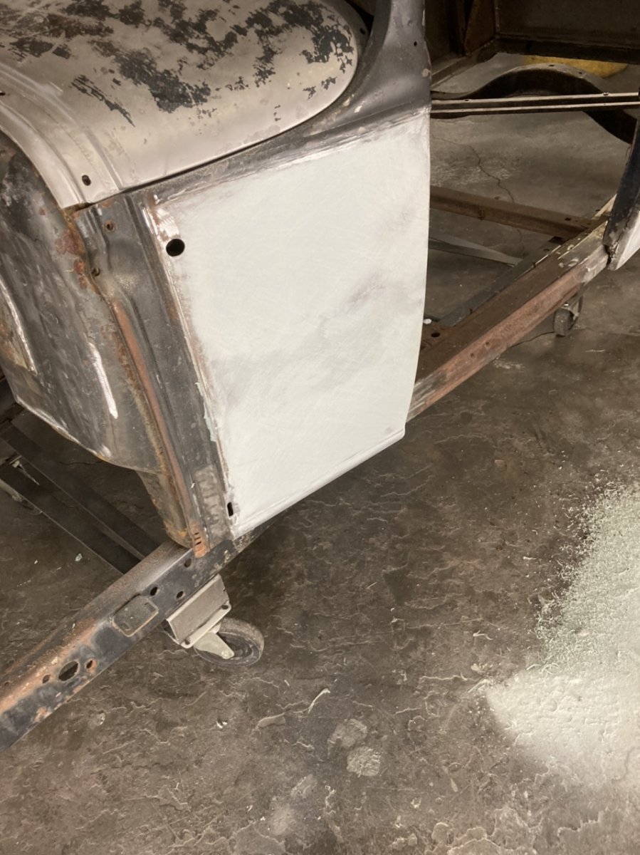

    Wasn’t happy with the driver quarter.....so I m***aged it a little more....NOW I’m happy with it! Just have the doors to do now and I’m off to the races!! Dropping the top probably 31/4”-31/2”.....I want to leave the windshield swing locks in the factory position......happy weekend fellas!! IMG_0920.JPG IMG_0921.JPG

    Gettin’ close to final glaze!! Thanks for everyone hangin’ with me! IMG_0939.JPG IMG_0940.JPG

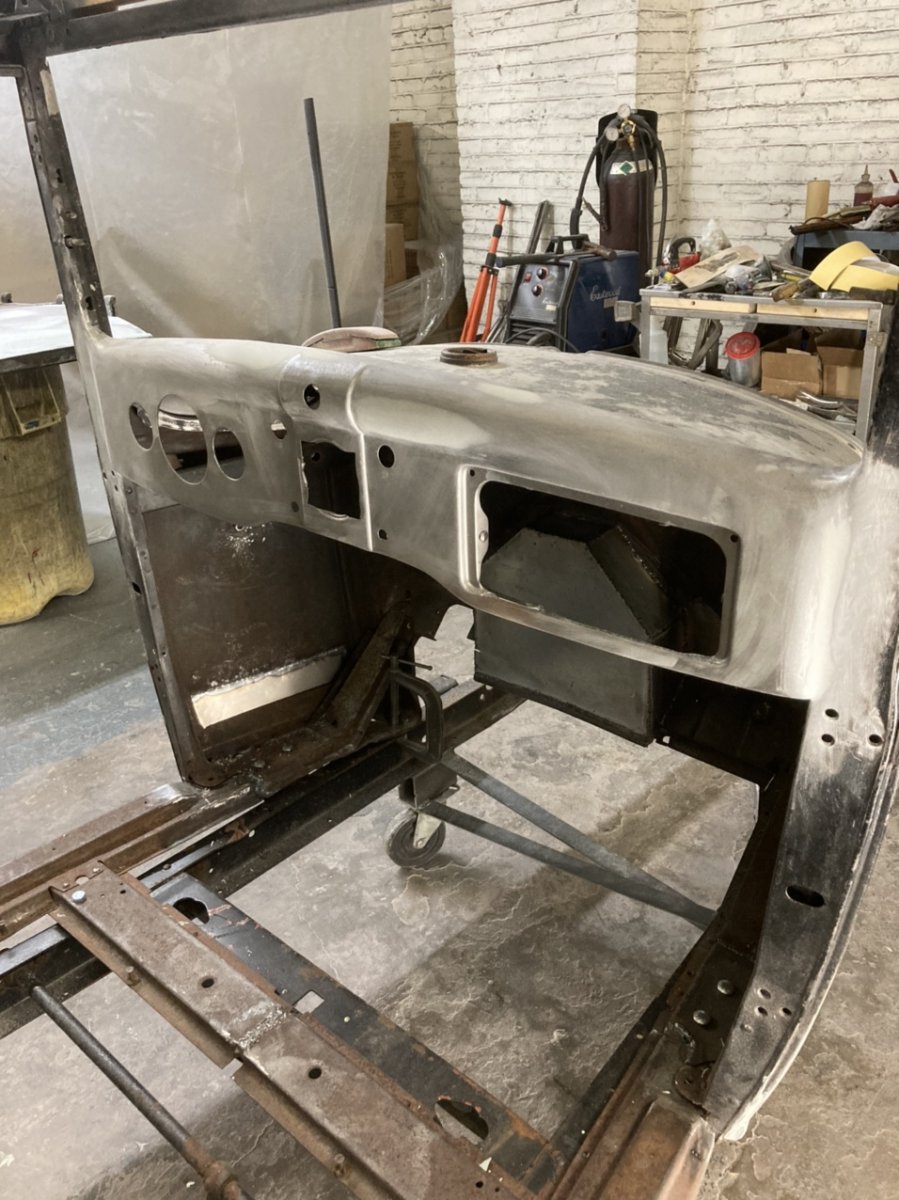

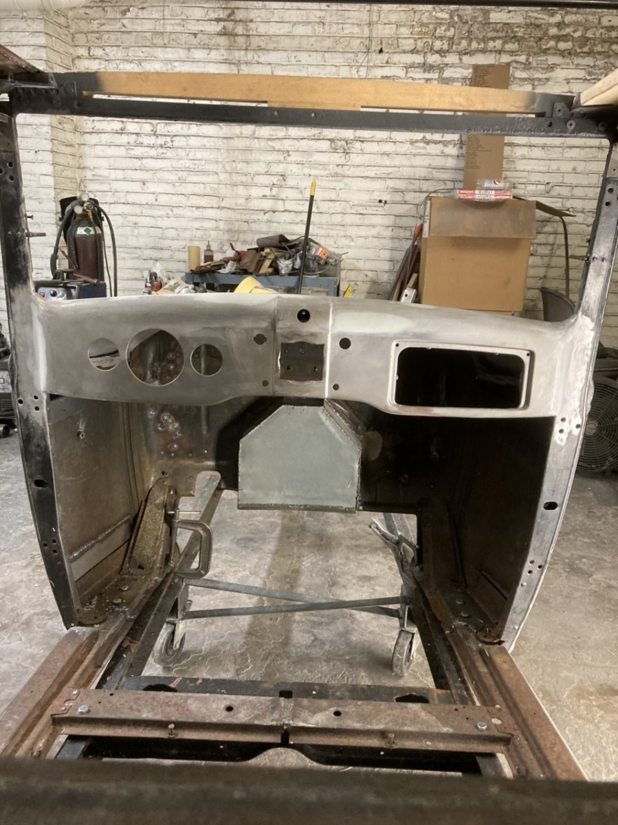

    Started on the dash tonight....just alot of little things before I hit everything with final glaze... IMG_0944.JPG IMG_0945.JPG

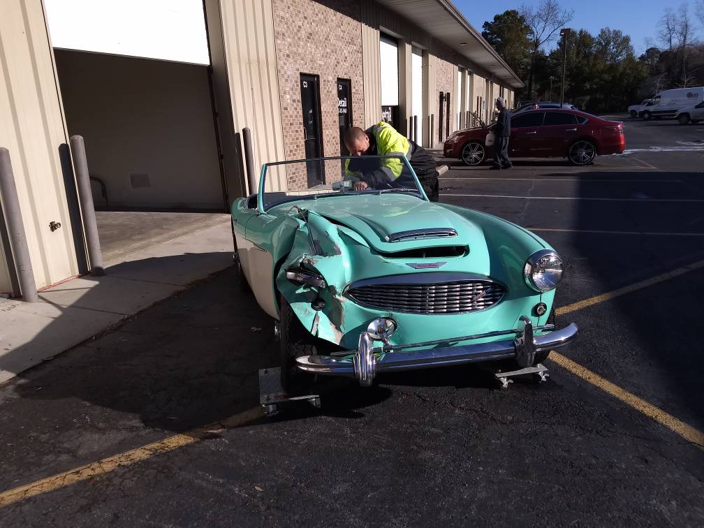

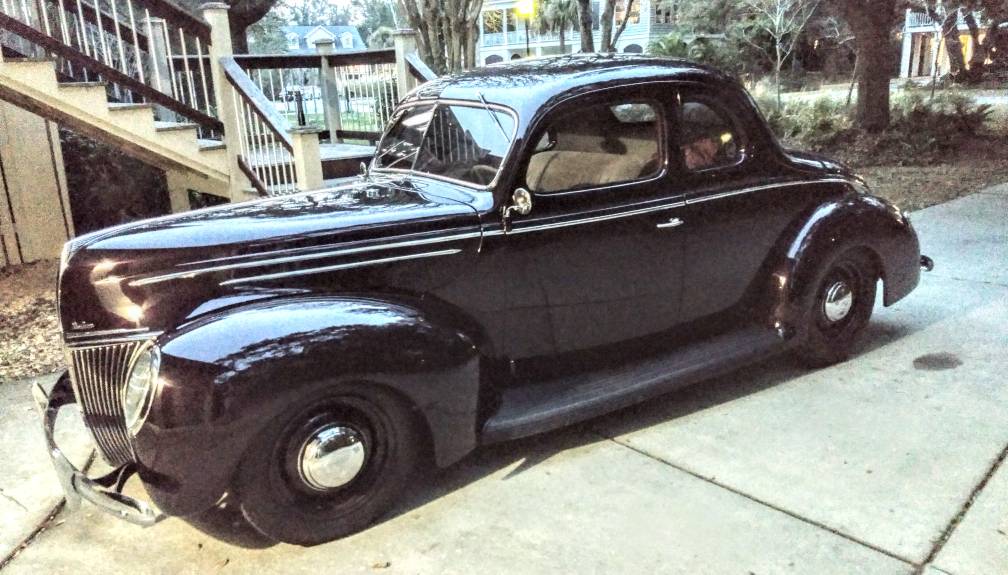

    Been away playing with new toy. My prized Healey got wacked/totaled by a kid running a stop sign. My long time lust for a "shine" car fulfilled by default. '39 deluxe, 350/350, just a plain jane really nice driver.

    First time for tapping insurance with 77 clicks on the pavement. The underinsured line item/clause sure paid dividends. Healeys are complex, right front hit trapazoided to left rear.
    Be sure of your insurance.

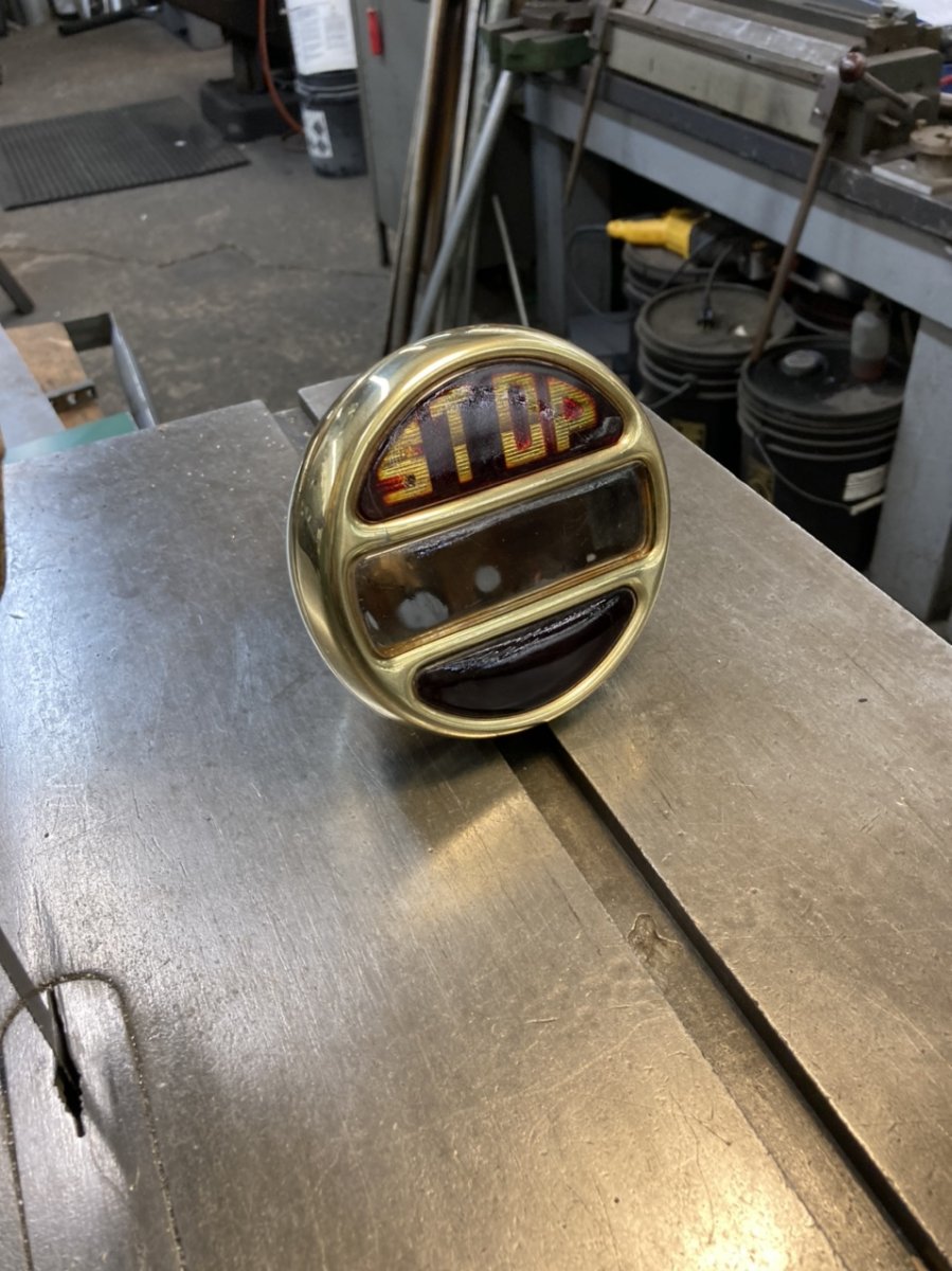

    Don’t know if I want to put this on the Tudor or the coupe....hmm [emoji848]
    Finishing up the firewall too....

    I’m experimenting with 2 different types of glaze....one is lacquer based and the other polyester. The lacquer based is way easier to sand and there’s no mixing hardener....I’ll probably use a combination of both. IMG_0961.JPG

    That would be the stuff called "Nitrostan".....that stuff is waterborne.... I used the lacquer based stuff on my truck when I built it in '04.....still looks great! We're filling 36grit scratches here.....not dents....:D

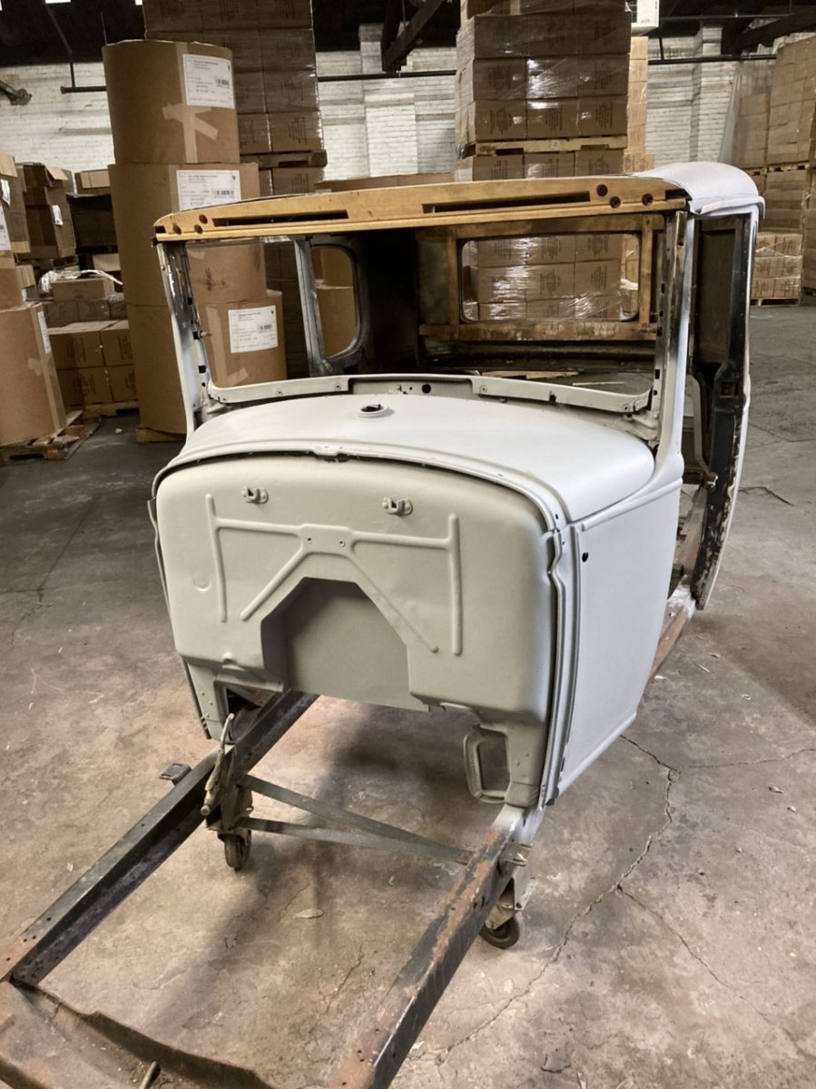

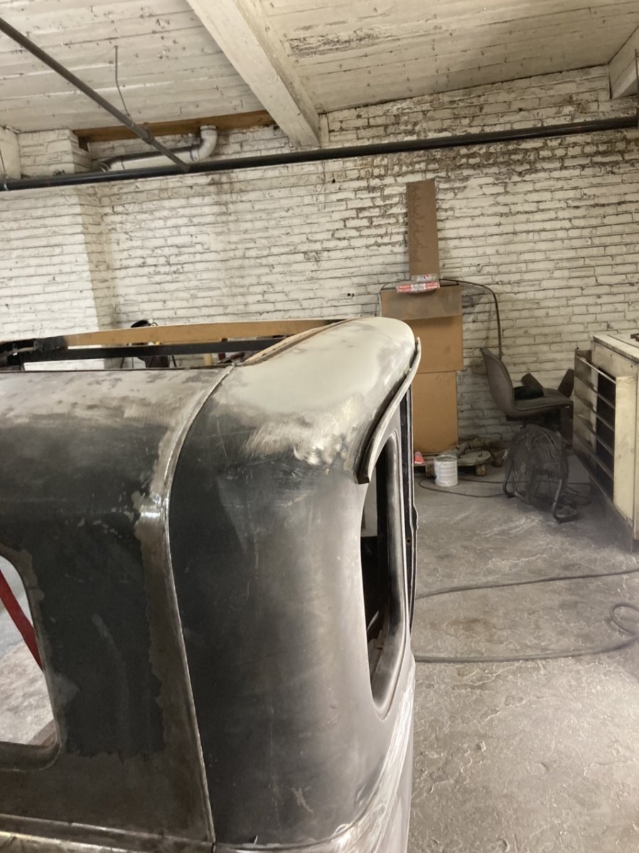

    Holy moly.....sanding and more sanding! I still have to drop the top and do the deck lid too.... I just want to get this thing in fill primer so I can sand some more.... It’ll be worth it in the end.....

    PRIMER!!! Wooo Hooooo!
    Still have to drop the top, then I can finish up the rest of the bodywork....Gettin’ there! Thanks fellas!! IMG_0977.JPG IMG_0978.JPG IMG_0979.JPG IMG_0980.JPG IMG_0981.JPG

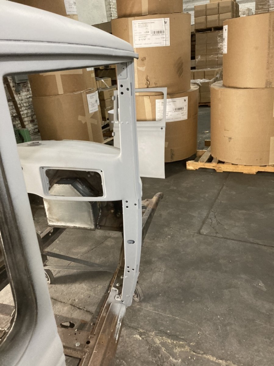

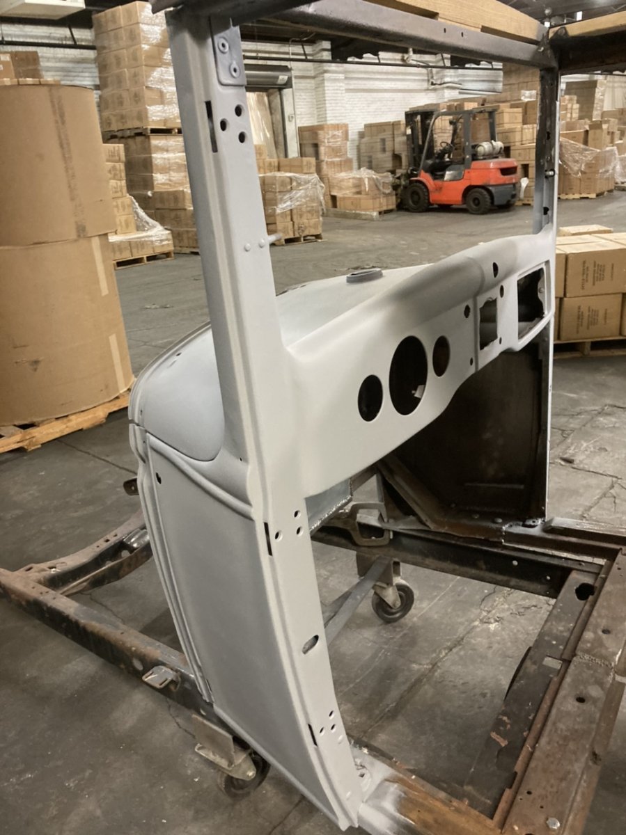

    Dash work finished, rear panel done and a better shot of the driver side..... IMG_0991.JPG IMG_0987.JPG IMG_0990.JPG

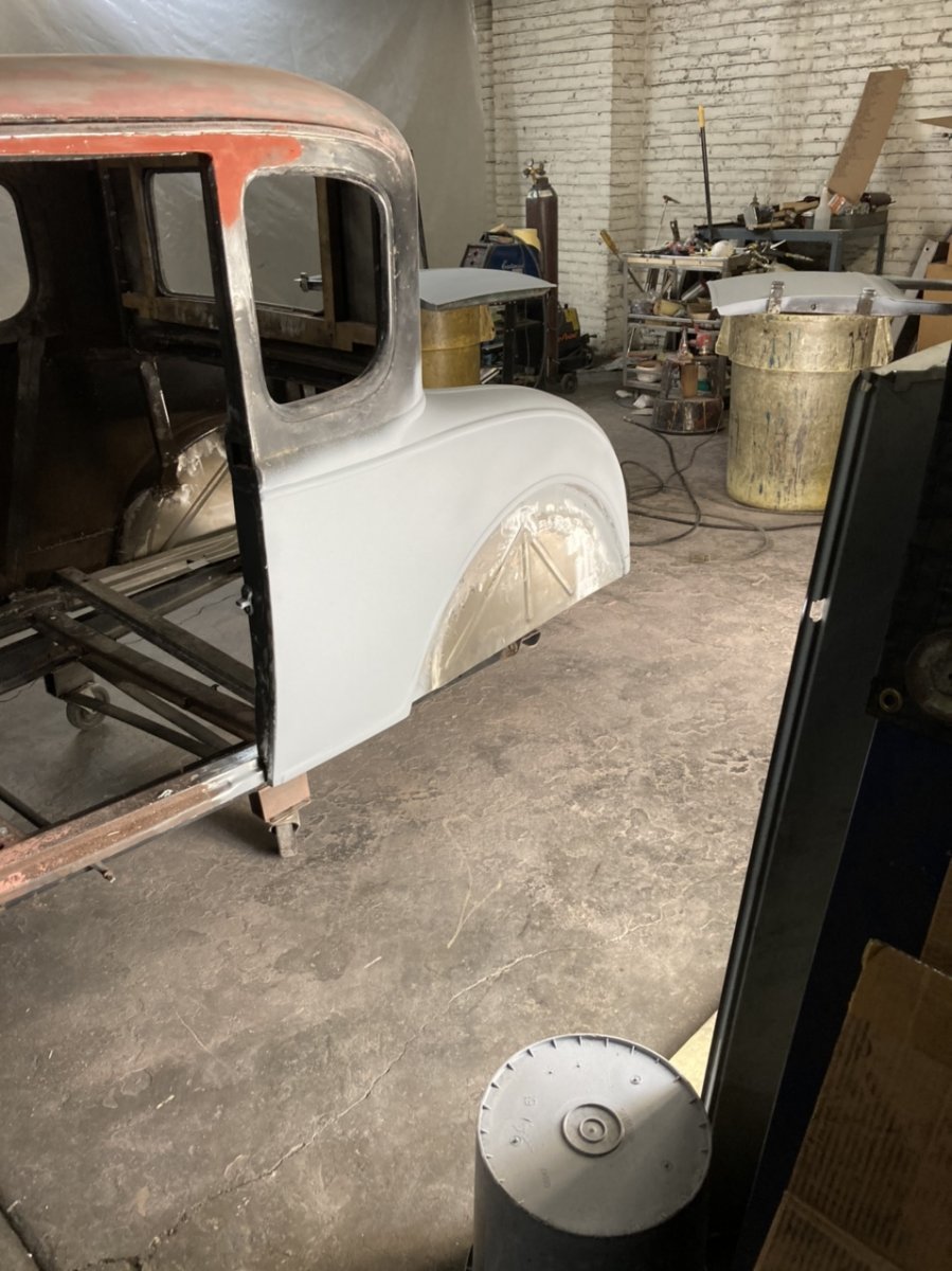

    Outter deck lid done, jambs done and wheel wells done! I can almost taste it!! IMG_0996.JPG IMG_0998.JPG IMG_0999.JPG IMG_1001.JPG IMG_1002.JPG IMG_1003.JPG IMG_1004.JPG IMG_1005.JPG

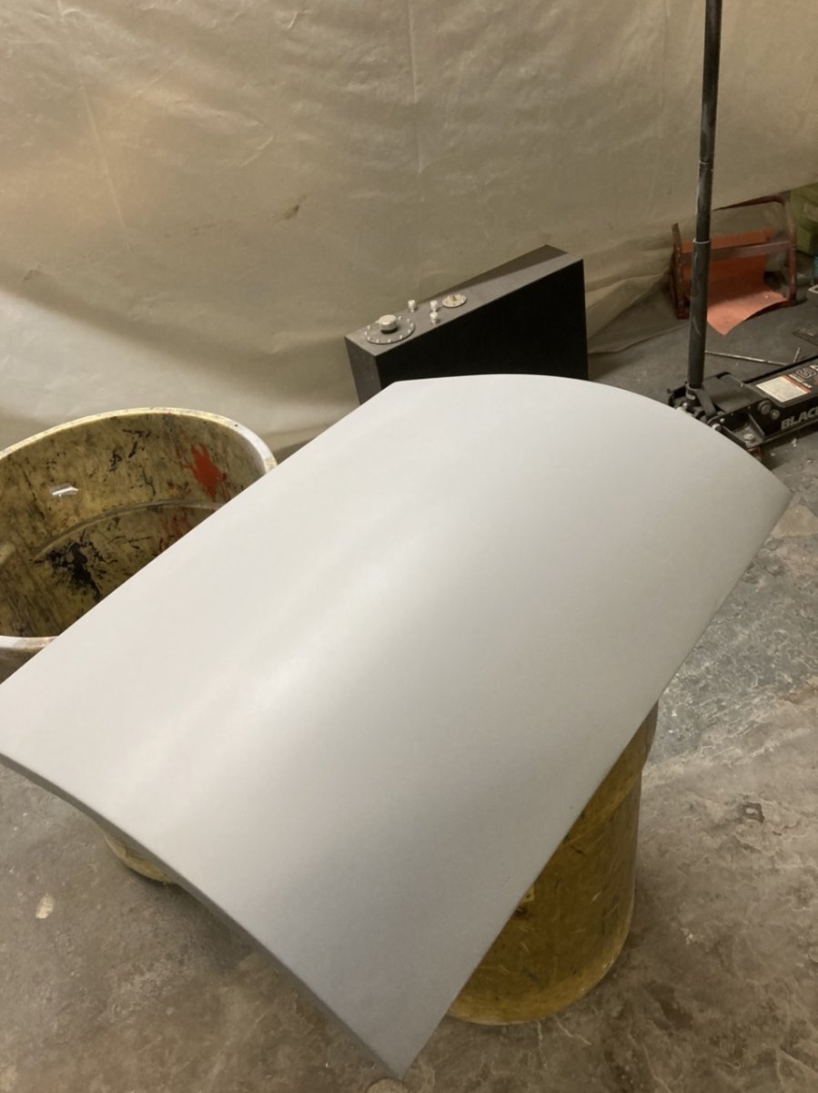

    Painted the inside of my deck lid tonight.....nothing spectacular but serviceable....time to chop! IMG_1020.JPG

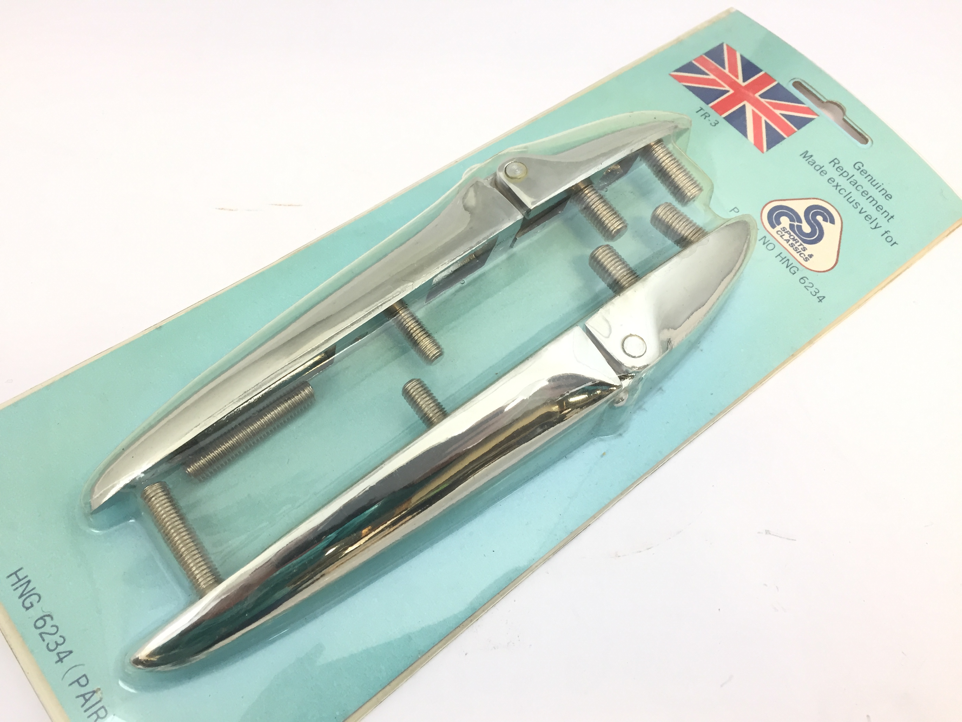

    Got my hinges installed! They’ll still have come off again, but that task is finished! Picked up some hinges from a Triumph TR model not sure if it was a 3 or a 7.....either way, they kick ***! Thanks fellas! IMG_1022.JPG IMG_1028.JPG IMG_1027.JPG IMG_1029.JPG IMG_1024.JPG IMG_1032.JPG

    Yes....you are correct! Here they are.....I can't believe I only paid around 20 bucks for these. The subtle contour fit perfectly! upload_2021-4-1_21-15-28.png
