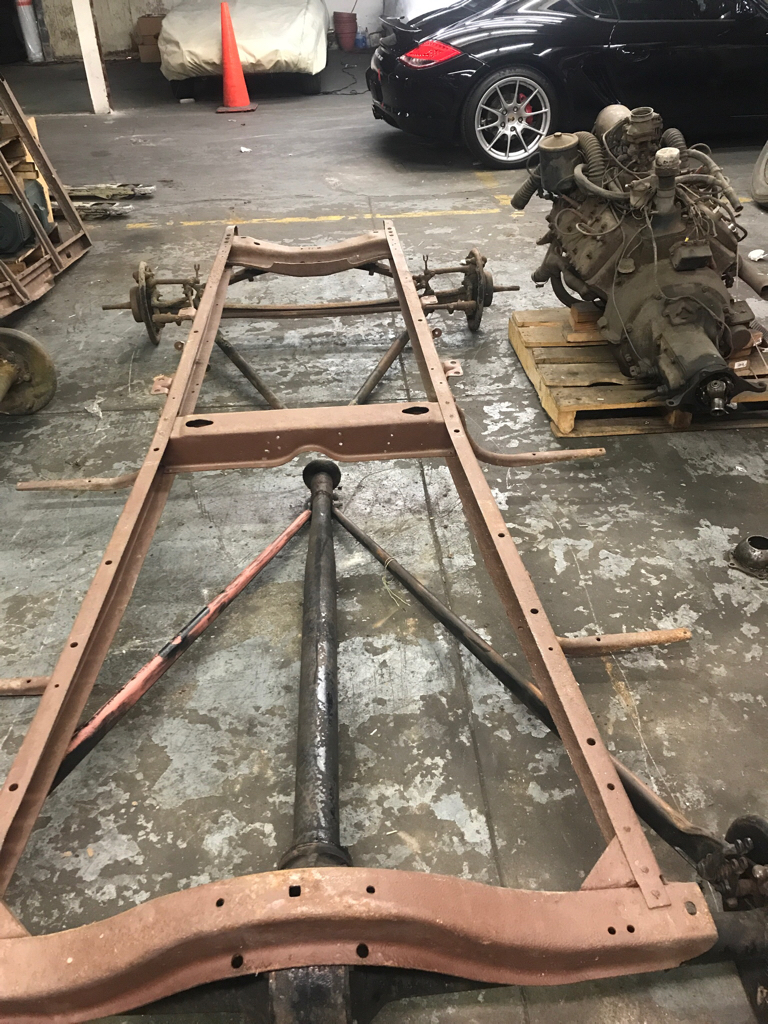

    Yeah.... I know I can get new corners, but I’m on a budget! And since I got my old welder working again it’s like ****a I tell ya! I picked up 2 front wide 5 drums today and the pitman arm I needed thanks to Matt at Irontrap....the dude was clutch! Now I have all the basics for my wide 5’s and juice brakes.....it’s goin’ slow, but it’s goin’!

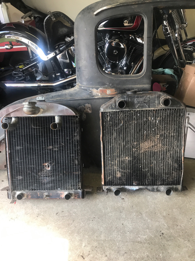

    Well, I picked up 2 radiators from fellow HAMBers not knowing condition. Took both to the radiator shop ( seems like the only one left in the country ) and they were able to repair both. He said small leaks, the one on the left needed lower bungs installed. Now to decide which one I’m gonna use, I’m leaning toward the one on the left. It has the nice big tank, it’s been shortened and has the offset filler neck. Whaddya think??

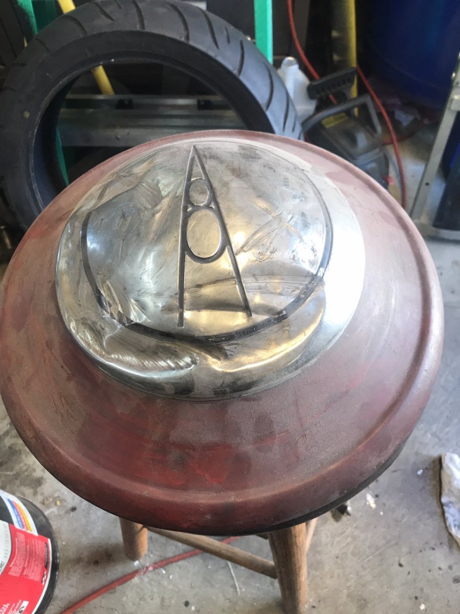

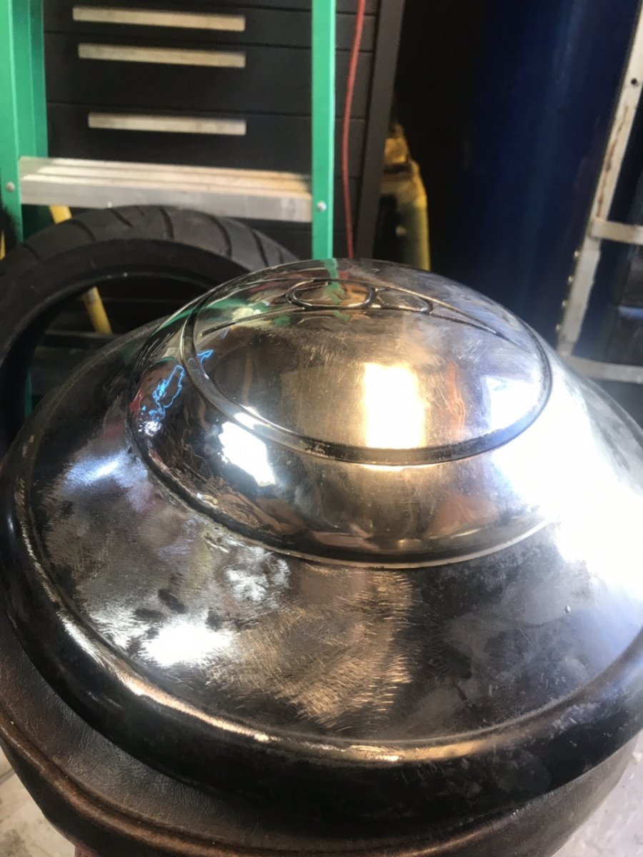

    Since the big stuff is at work, I’ve been putzin’ around with some of the smaller stuff at home. Picked up a set of wide 5 caps with the wheels. Some are a little sketchy so I start some work on them....thought it came out pretty good! Of course I’ll prep and finish it up for painting, but I thought that stainless was surely finished! It’s presentable now for someone on a budget..... IMG_1236.JPG IMG_1237.JPG IMG_1238.JPG IMG_1240.JPG

    Nowhere near done, still have to heat and shrink it, it’s coming out better than I thought.....callin’ it quits for the day IMG_1241.JPG IMG_1244.JPG

    Still not finished.....was goofin’ with it at break today....it’ll be presentable when I’m done and it’s buffed out with compound.... IMG_1241.JPG IMG_1249.JPG

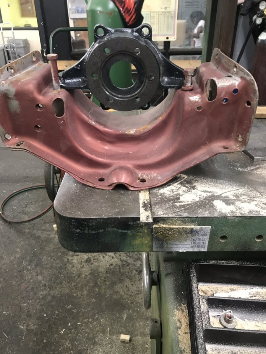

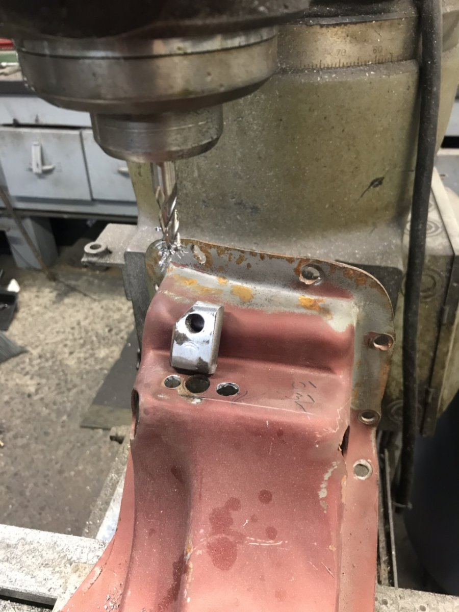

    I have to move these captured nuts in about 3/8” on both sides....I didn’t know there were different widths! I’ve got the spot weld milled out and I’m gonna mill out material to get to necessary locations and weld them back in...no biggie, just a hurdle on your way to the finish line. [emoji16] IMG_1260.JPG

    Roughed in. After I finish the othe side I’ll worry about the finish and of course once the frame is all mocked up I’ll be painting it black...lots more to come! IMG_1260.JPG IMG_1261.JPG IMG_1262.JPG
